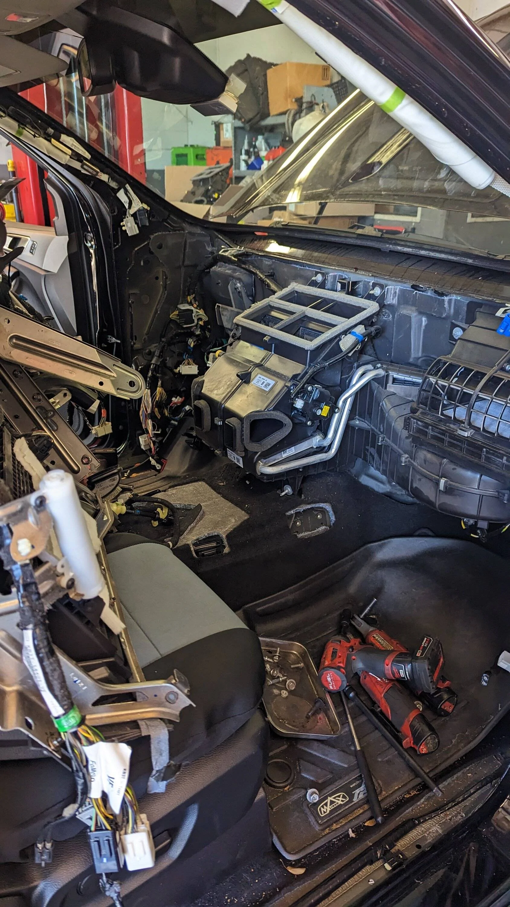

For those of you getting this repair completed (or those who already have) I'd love to know if your invoice/paperwork shows part numbers that were replaced/installed. I'm planning to do this one myself, and want to make sure I order all the correct stuff before I even start the job.

It's hella more expensive to have a dealer or independent shop do the whole job. I've chatted with a pro mechanic who has done this job, and he says you don't absolutely have to discharge the AC, or drain the coolant. If you replace only the part number that Ford calls out in the shop procedure, I'm pretty sure you stay away from the actual heat exchangers. Most shops simply replace the entirety of the heating/ac system, but only the blend box actually needs to be replaced - as I understand it, this is a separate component.
Still - even if I do have to evacuate the refrigerant, it's a pretty simple matter to take it to a certified shop to recover the freon before I start the job, then take it back and have them re-charge it for me after the job is done. This will cost a few hundred bucks, but that's much, MUCH cheaper than a few thousand in labor to do the whole job.
I have a little more than 40k miles on the truck, and am out of warranty, so I'm paying for the entire repair. May as well save the labor cost by DIY.

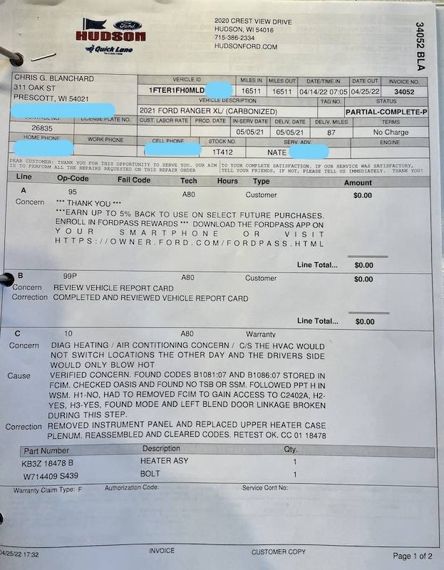

My invoice shows the part#'s but not the cost as mine was done under warranty:

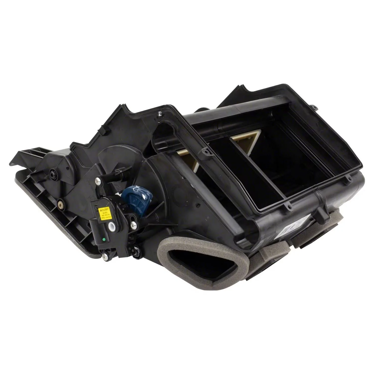

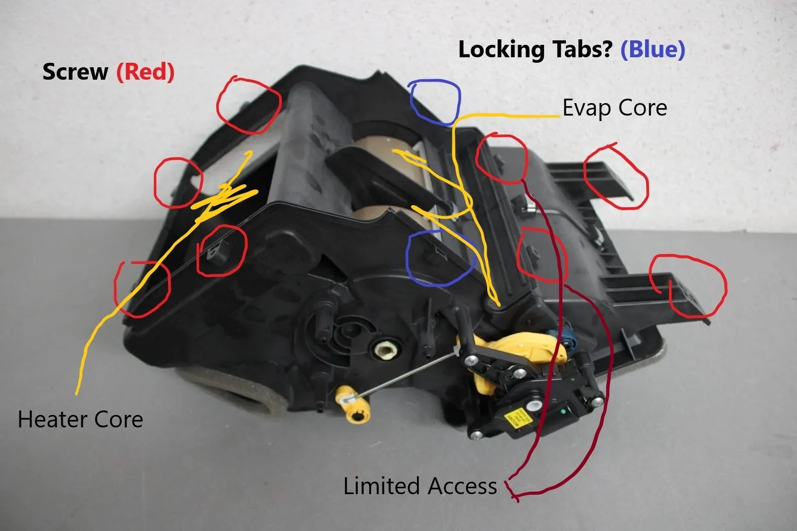

While it is possible to do this without removing the whole assembly, you may have to disconnect the whole assembly to get access to the rear attaching screws (Limited Access)
To allow the assembly to move back far enough off of the firewall to get your hands / tool in that tight area.
It appears you can possibly clear the EVAP Core without disrupting the lines but the Heater Core mounts in the space at the bottom of this part of the assembly, I think this is going to be a road block for a short cut.
It appears the Heater Core will have to slide out of the assembly and out of the way to allow this to raise up and out as it is encased.

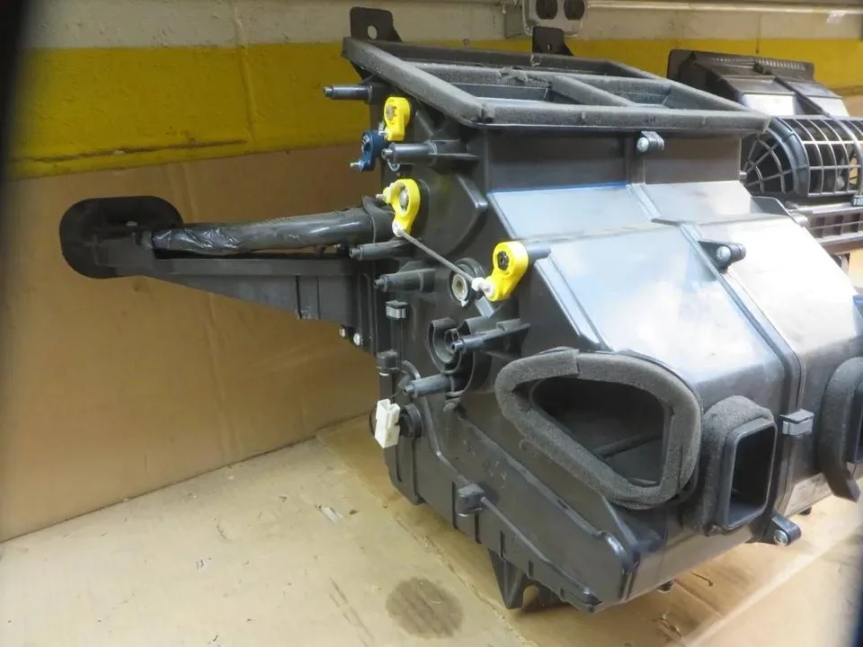

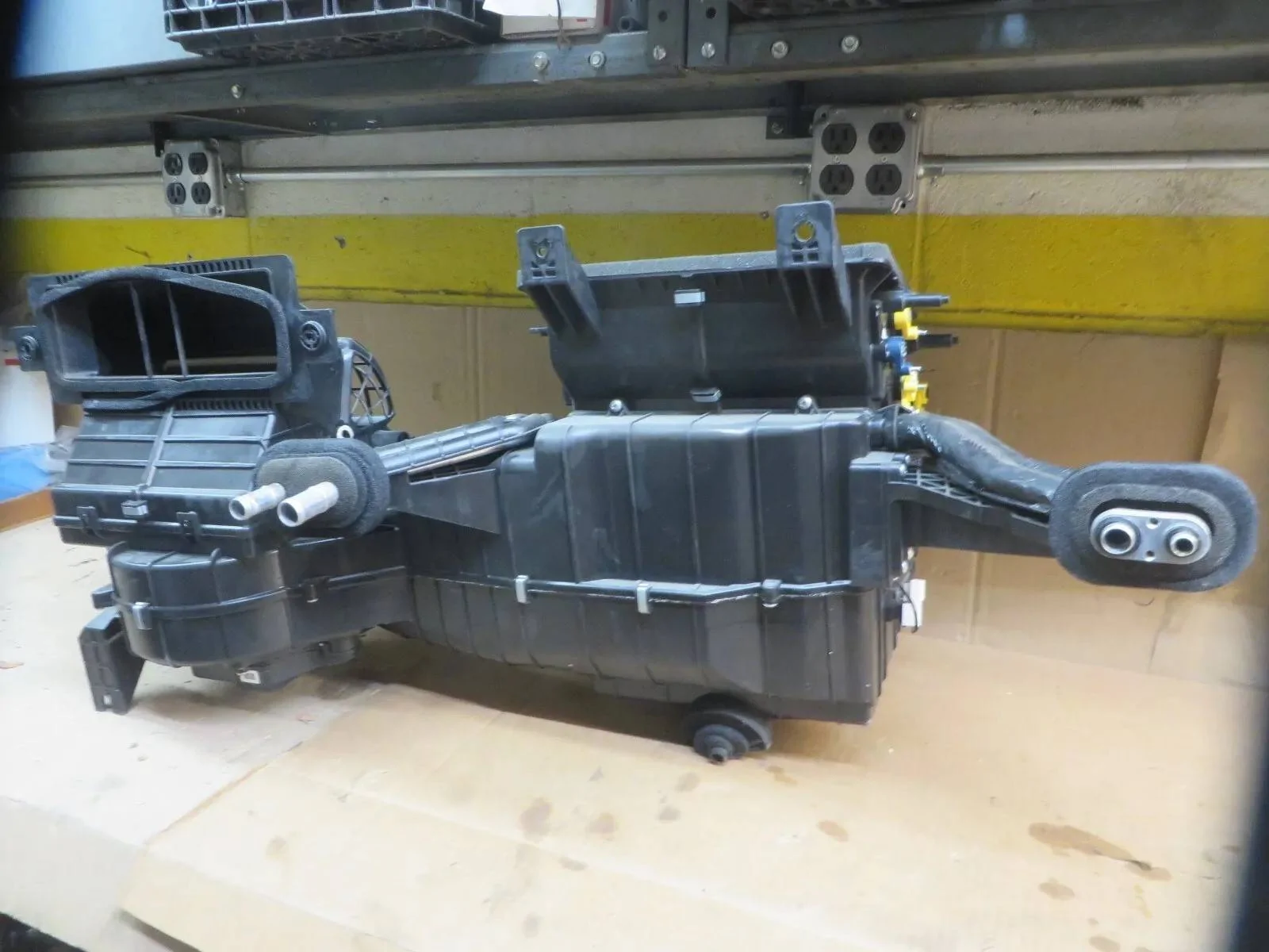

Example Pic of Part that is replaced on the most current SSM.
