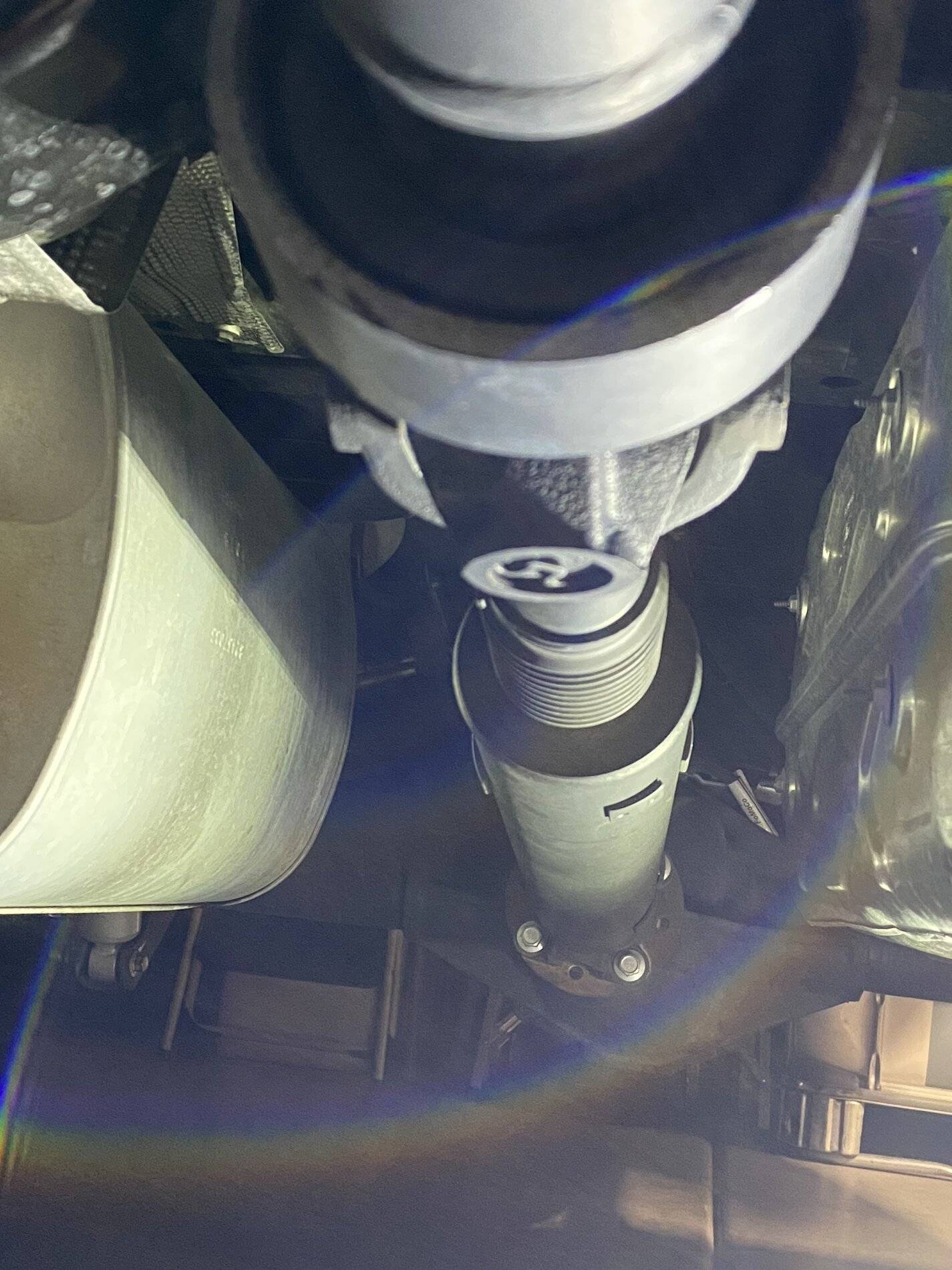

Phil I’ve been doing a lot of research on drive shafts angles and phasing, and I noticed mine is slightly out of phase. Is it normal for these to be out of phase on these rangers? Mine is definitely out of phase. The first drive shaft coming from the transfer case to the center carrier is perfect, but from the center carrier back, the one on the rear axle is slightly out of phase on mine
I think that's been about the norm for the Ranger. Some people have pulled theirs apart and reindexed them. Driveshaft Phasing | 2019+ Ford Ranger and Raptor Forum (5th Generation) - Ranger5G.com
Also, I could be way off base here, but that driveshaft seems to have a lot of balancing weight welded to it, doesn't it?

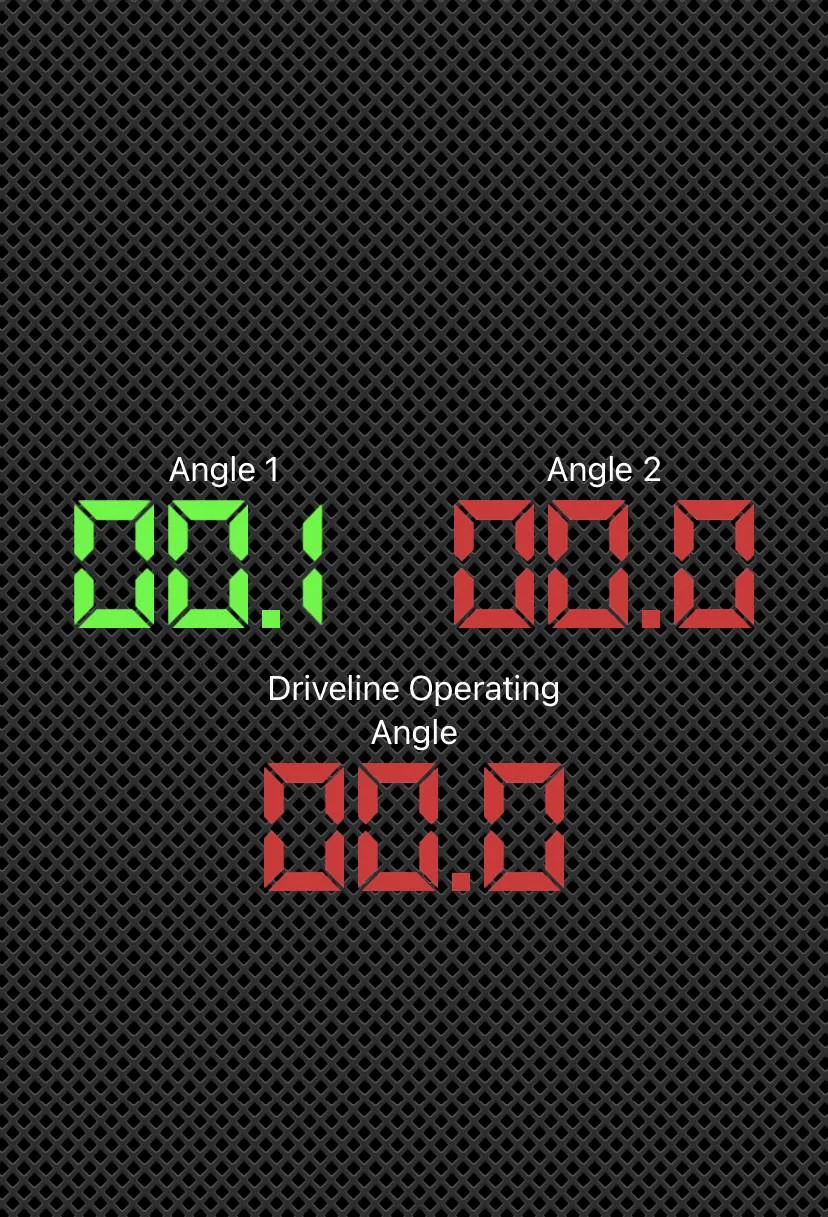

I ordered the one you recommended, but for now I used an app called TREMEC, according to this app I am nearly zeroed out which is no good. Took the measurements 4 times to confirm and same results. Followed instructions per driveshaft specialist. I know it’s not super accurate, but still interesting

I have to check that app out, does it measure through the camera or is it a physical measurement?
What joint is that measuring, pinon or center? either way zero is less than optimal.
With the gauge, always double/triple check the zero, let it stabilize for quite a few seconds, and check the driveshaft tube in several locations, top and bottom, mine seemed to have about 0.01 degree variation, so I used the number that repeated in multiple locations.
Also dont pull or push the driveshaft, I grabbed it and pulled myself under once as I was crawling under, the center support is so flexible it changed the numbers.
