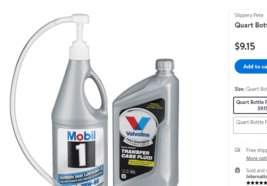

I cracked my nut cold. Then just snug it. Drive until warmed up and it loosens up easy. Let it cool off and snug it back down. Really need a piston pump to add or remove fluid though
I am going to try your technique tommorow morning. For a fluid pump I typically use...
