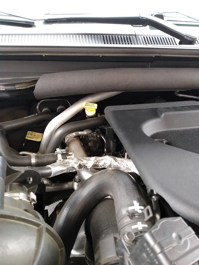

3 Comparision shots of the Short Harness Run to the EGR Backpressure Sensor
This shows that the sensor final torqued position will vary and change the length of the harness.

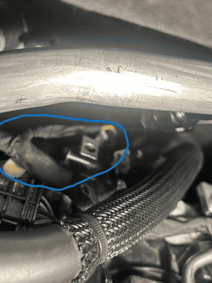

Mine - Not the clearest picture but you can see the connector is also clocked differently.
I want to highlight this to reiterate what Mike has instructed and that is to ensure the wire harness is not pinched under the MBS mount, but I would like to add an important note and that is the short wire run (Length) will vary depending on where the final rest torque of the sensor is.
If you are not paying attention to this, it may cause issues down the road due to the stress on the harness at the connector.
You may have to adjust the harness some to get enough play in it to allow zero stress with the tube installed.

Well, I took another look at the short harness and took a better (more lighting) pic.
It turns out mine is clocked as the install video. I did verify that the Backpressure connector is solid and will not rotate as I was thinking of that as an easy option. But no joy there.
So, this leads to only one thing and that is the branch out from the main harness is slightly different.

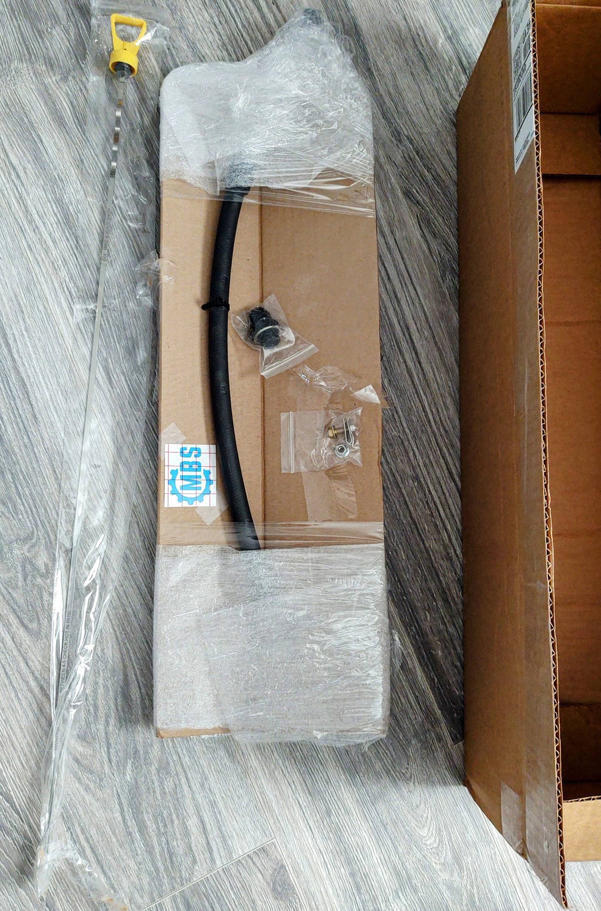

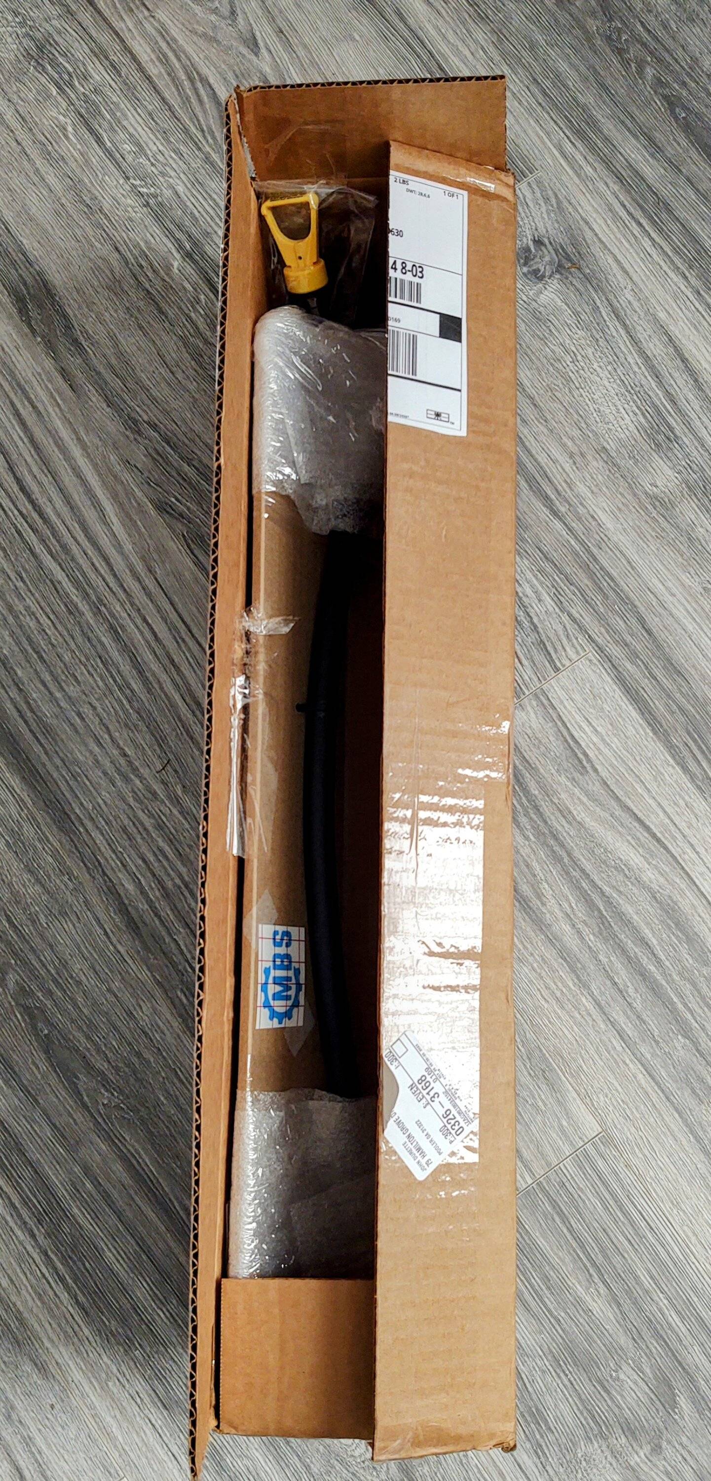

Got mine. Unboxing:

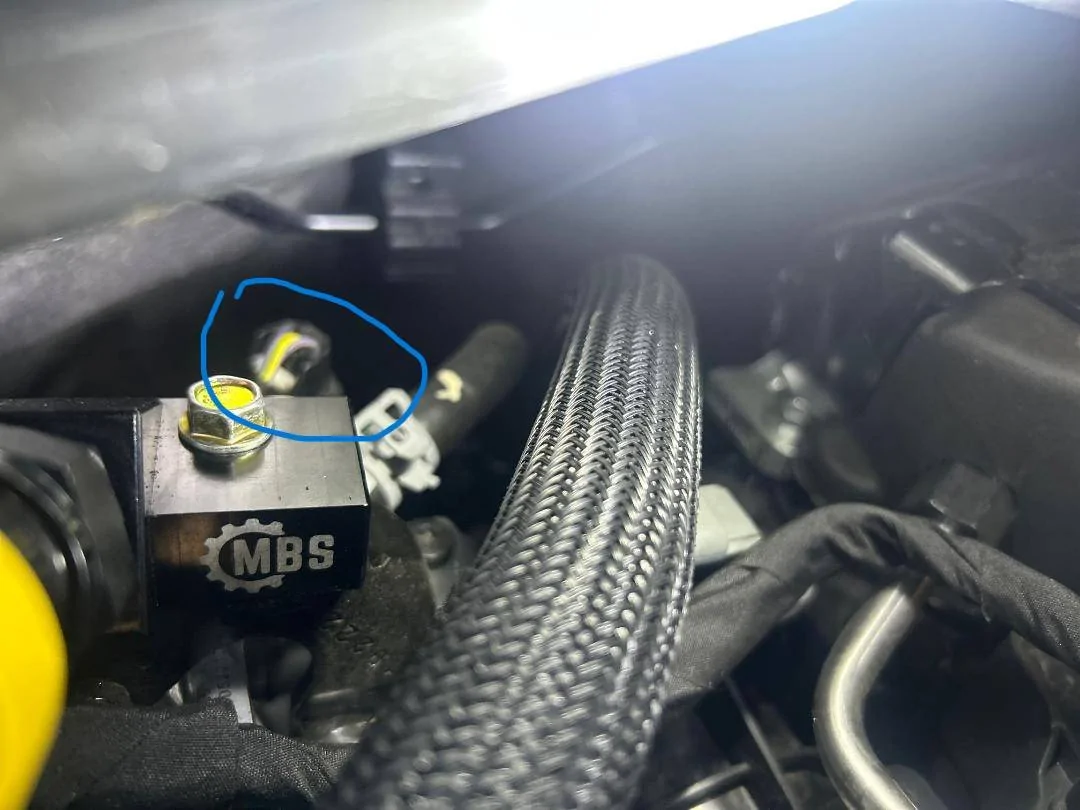

Let me try to better explain what I experienced.
Below is my OEM at rest position of the short harness, now at the nylon fastener which will pivot side to side will allow the harness to shift.
So, when you take the short harness and push it towards the mount bracket, it does not have enough length to reach the bracket without causing the main harness to raise upwards towards the top of the bracket.
So, with tube installed the short harness will wrap along the inside of the tube but it is under strain and pulls the short harness tight and if you run your finger along the harness, you can tell its taught and no movement is felt.
This also creates another issue; the main harness is now raised and wants to position itself across the top of the mounting bracket. (Thus, interfering with the install)
So, I believe that bending down the (Nylon Support) bracket would only help with the main harness.
The main issue here is the position of the (Nylon Support) on the main harness and the branch out placement of the short harness.
By pulling the nylon fastener out, this allows the main harness to shift farther towards the driver's side.
If you move the main harness about 1 inch or so towards the driver's side and use a zip-tie in its place at the original support point accomplishes 2 things.
Note: I chose to move the main harness to the bottom of the support bracket vs the OEM Top, IDK if really required, I just chose to do it, due to my original issue of it wanting to pull up and over the MBS bracket mounting point.
1. Puts a natural slack in the short harness run, so with the tube installed the harness will wrap around the inside of the tube and still have a natural slack in it.
Verified by running my finger along the short harness and gently pulling out on it, I can still move it - Freely.
2, The Main harness will lay naturally without wanting to pull upwards
Using OEM position, I tried to run the tube in between the Main & Short harness, but due to the diameter of the tube, it put even more strain on the short harness than going behind it.
I hope this gives you a better understanding of the small little issue, easily rectified.
But from a builder standpoint, it does take away the OEM support.
Might need a deeper look at the harness to see if there is any way possible and nearby just to take the harness and pull towards drivers' side (about 1 in) and secure with a zip-tie.
Another spot vs the nylon support.
This would accomplish the same result, without having to break the nylon support (Tree)
As that nylon support will pivot side to side.
This would keep a OEM look, and a cheap (1-Zip-Tie) solution
