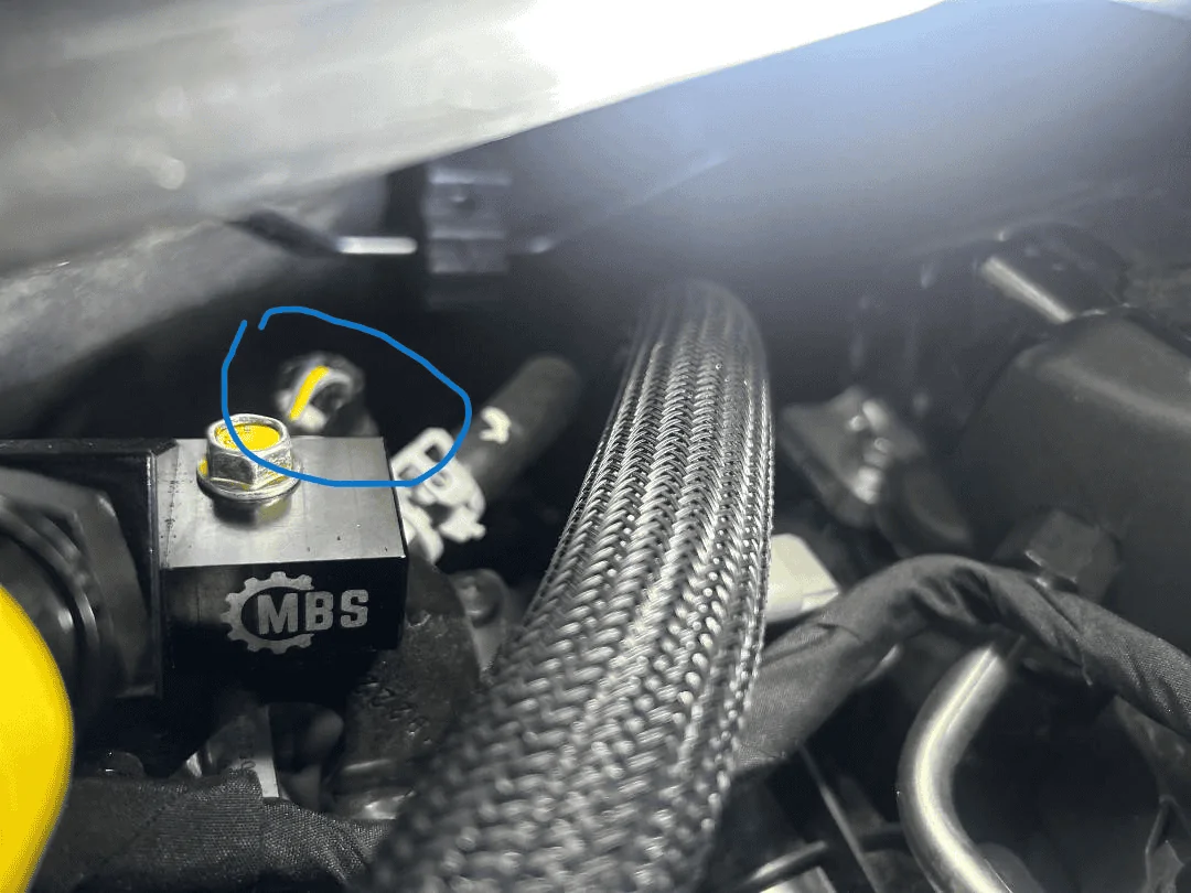

That looks shorter as well, even the top two dont look identical.
Your yellow connector looks twisted in that direction as well.
You have a 2022, what's the build date on your truck? I have to start trying to track the differences, it's Lariat, I wonder if the loom is a different part number than my XLT with some subtle difference in that area of the loom.
Or it's just the mass produced wire loom variance effect.
Thank you very much for taking the time to post this up, this is so valuable to me!!

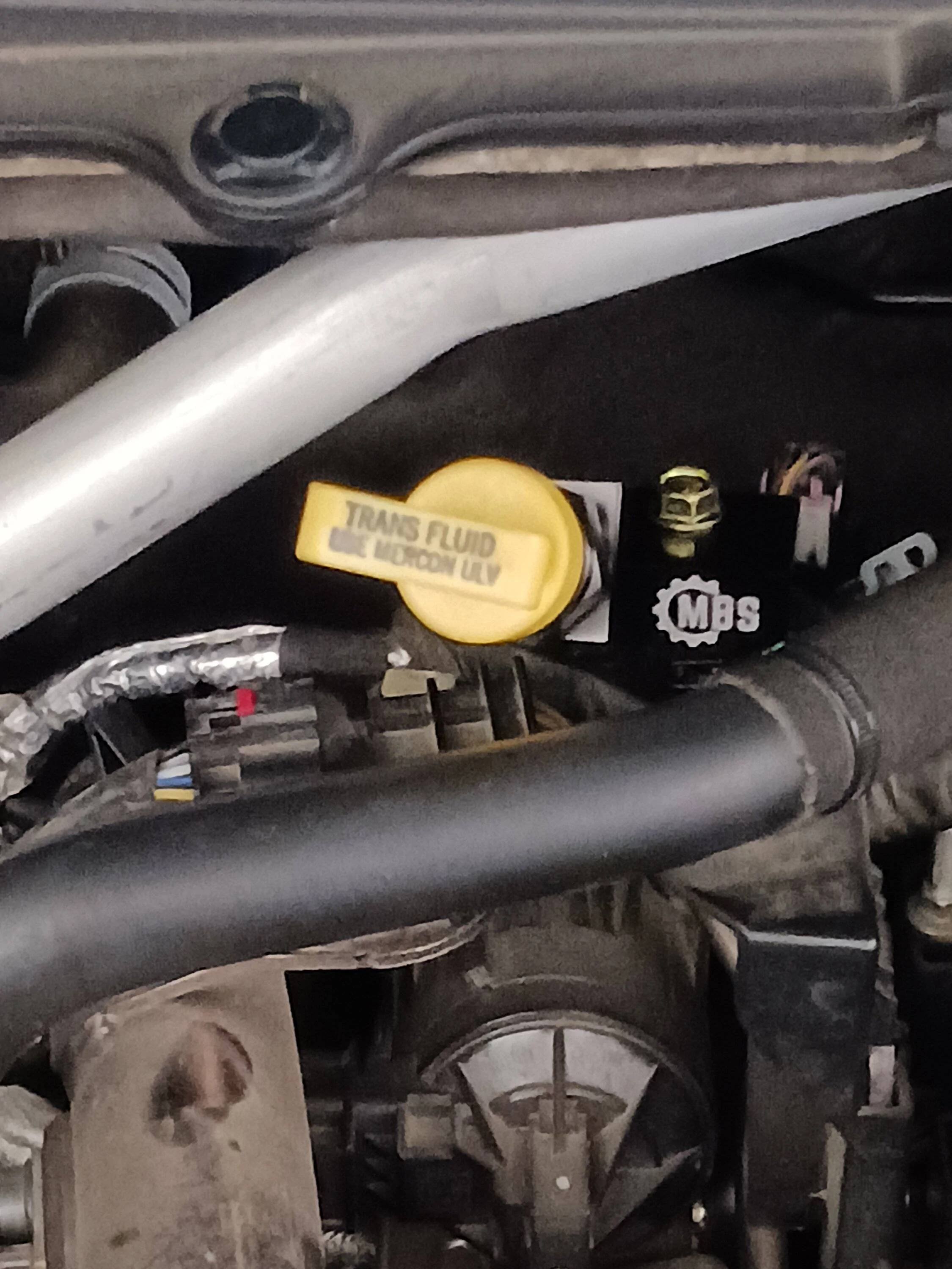

My above pic is misleading - as far as the connector position is concerned.
Here is a clearer pic,
I have a 2022 Lariat with a Aug 2022 Build.

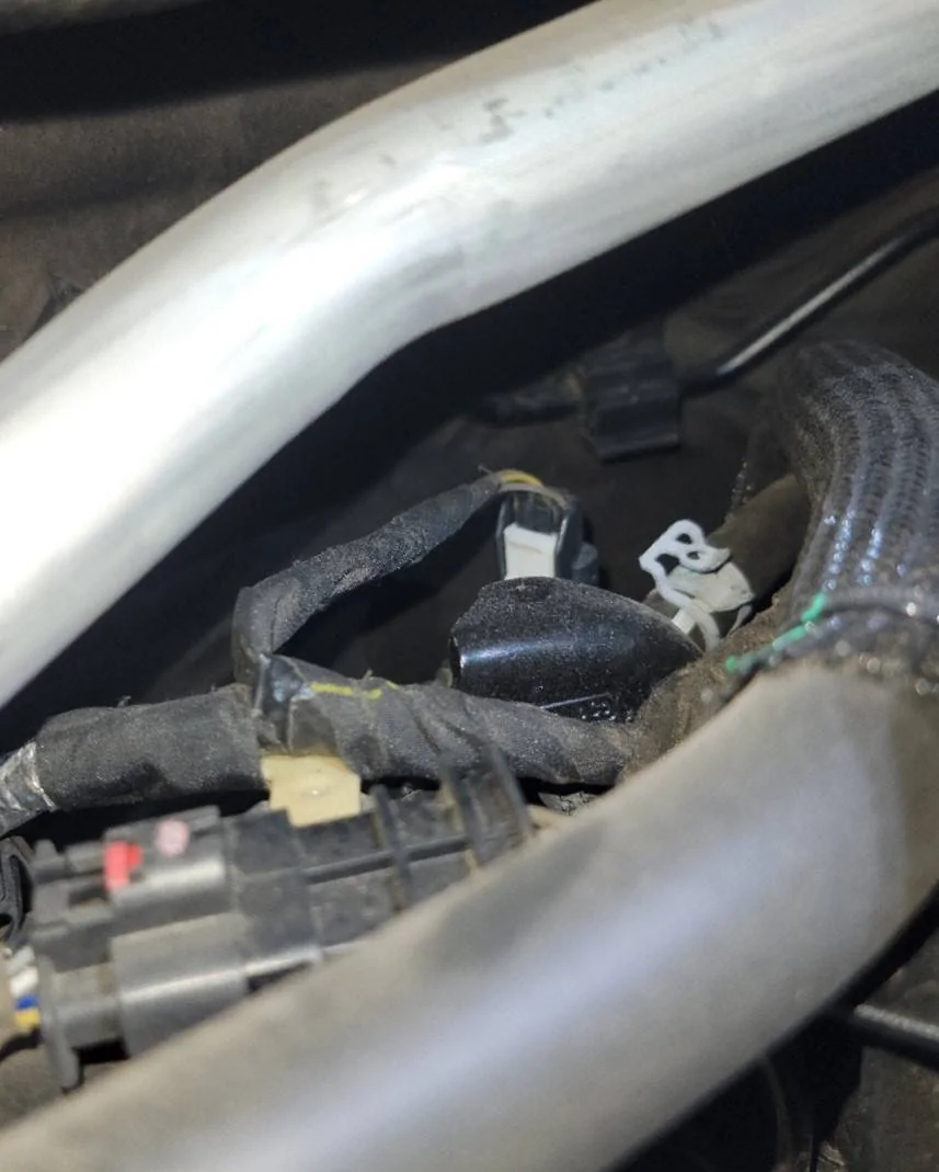

Fitz, here is a picture of my 2020 Lariat as a data point. Looks like I might have to do some harness adjusting.

Before you do any loom adjustments, adjust the L shaped tab that comes off the water pipe that holds the connector, push it down a little, about 1/4” it should allow enough room.
The hose should go over the top of the looms, but some looms won’t allow it.

What Fitz is saying might work - it is basically rotating the main harness towards the firewall, giving more slack to the short harness.

It should be further away, that's the suction side of the A/C I think.
On hard acceleration or accelerating towing or with a heavy load the engine may rock over and touch the pipe, grab the pipe and push it away a little, you will be surprised how easy it moves.
