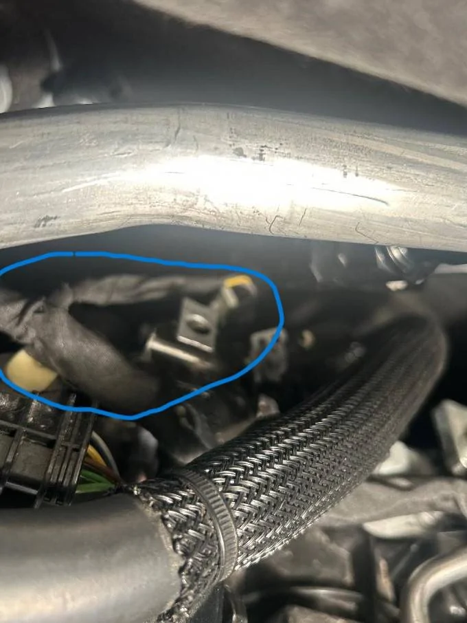

The same as another member - On rerouting the wire harness.
I had to reroute mine as well.
I tried routing on both sides of the harness, it would work but put some stress on the short wire run, plus with the MBS mounted it pinched the main wire run in front of it.
While still following the routing directions and as seen in the install video, you may have to slightly modify the routing of this wire harness.
Easy fix though, remove the support nylon fastener (Christmas Tree) and reroute harness to the bottom of the bracket and resecure with Zip-Tie, but before zip it down push harness towards drivers' side to give you some play in the wire harness.
Check and ensure before you tighten down the MBS bracket that the main wire harness and the small wire harness are not pinched under the MBS bracket. This can be verified by running your finger down along both the main and small wire harness runs. They should both still be able to move freely with zero strain on them.
Other than that, install went great, Dipstick goes in and out like butter, and fluid level is exactly between 4 & 5, the exact level it was when I checked the OEM stick.
Excellent Job Mike
My OEM Wire harness routing.
The short wire run was the issue,
And after watching the install video, I can see that my short harness run appears shorter than the video, so there appears to be some variance in where the harness branches out of the main harness and placement of the nylon support.
If tube was placed in between the two harnesses, it put a strain on the short run and also made the tube difficult to move around to proper resting position.
If tube was routed behind the short run as depicted in the install video it put a strain on the connector and it also pulled the main run closer and upwards at the bracket, which interfered with the resting position of the Dipstick (MBS) bracket.
EDIT: I will take another look at this to see if it is possible just to pull the short harness run up and over the EGR Backpressure Sensor, as after seeing it in a pic my sensor seated position has changed the clocking of the connector and it is wrapped around the sensor. I think this is the reason for having a shorter wire run.

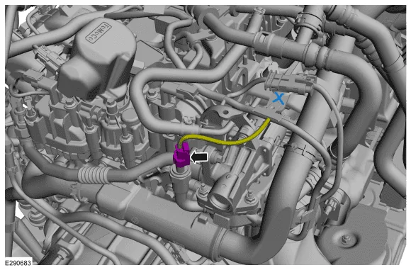

And a little dig, here is the service manual pic.
The sensor that the short wire harness connects to is the:
EGR Backpressure Sensor.
Note the position of the connector in the pic below, final seated position of the sensor will change the length of the harness.

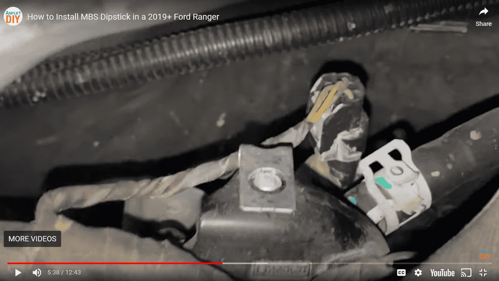

3 Comparision shots of the Short Harness Run to the EGR Backpressure Sensor
This shows that the sensor final torqued position will vary and change the length of the harness.
First - Install Video Snap

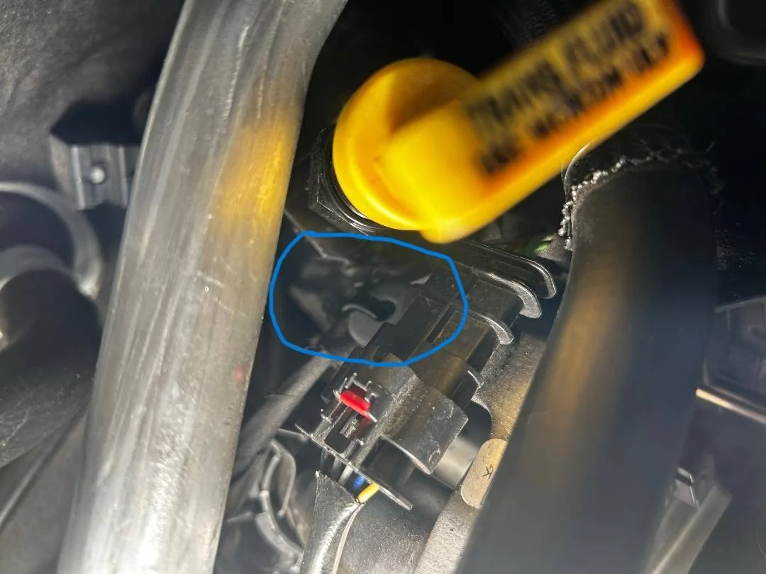

2nd - Another Member Install
Note: How the connector is installed and the wires are about 180 deg difference from video

I want to highlight this to reiterate what Mike has instructed and that is to ensure the wire harness is not pinched under the MBS mount, but I would like to add an important note and that is the short wire run (Length) will vary depending on where the final rest torque of the sensor is.
If you are not paying attention to this, it may cause issues down the road due to the stress on the harness at the connector.
You may have to adjust the harness some to get enough play in it to allow zero stress with the tube installed.
2 Options Here:
1. Pull the support out - (White Nylon) Plastic Fastener - It may break getting it out, and push the main harness towards the driver's side, as this will give more slack to the short harness run.
Reroute the main harness to the bottom of the bracket and resecure with zip-tie using the open hole from the nylon fastener.
or
2. Carefully unwrap the main harness at the branch out of the shorter harness to give it some slack. be very careful here if you use a knife to cut the protective wrap, you do not want to cut or Knick a wire.
For me the less invasive and safest way is best so just use option #1 for the average owner who has not had experience cutting into a wire harness.
Again, strain relief is important here, so during install and after install, run your finger along both the main and short harness runs and give a gentle tug on them to ensure you have play in both harnesses.
As this will verify you are not pinched under the MBS bracket and also verify you are not stressing the short harness run between the main harness and the connector.

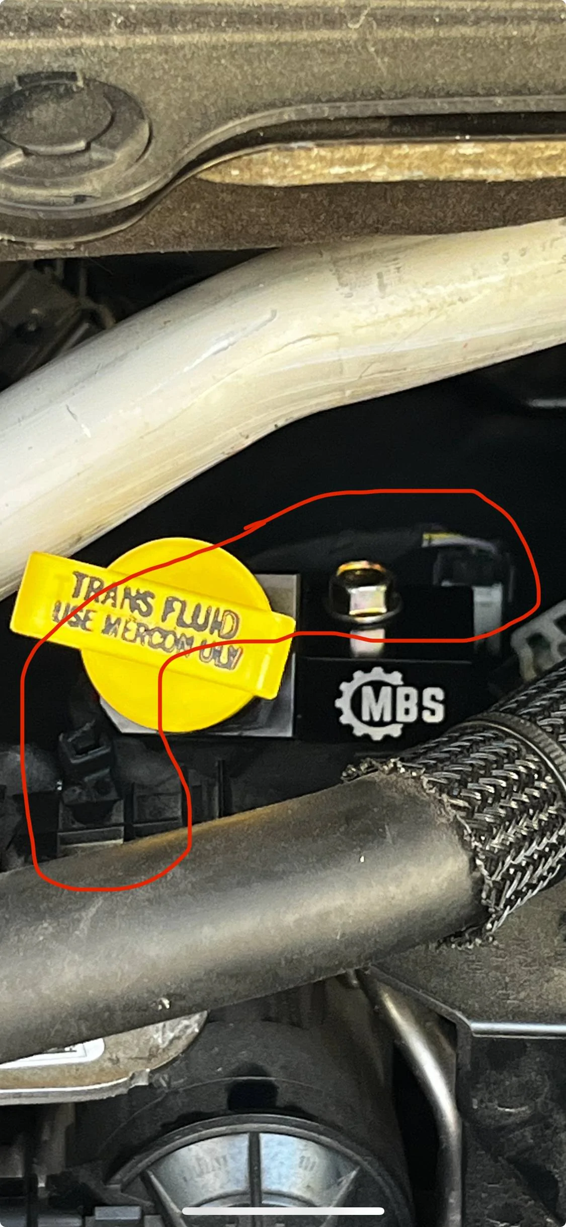

So a few of you have had to remove the Christmas tree harness clip from the end of this bracket then you zip tie it.
The next install where the installer thinks that is needed, try this, where the blue x is, gently bend that bracket down maybe 1/4 inch maybe a little more but not much and see if that allows enough room to leave the harness clip in the bracket.
That bracket holds the looms up off the water pipe, but there is enough room to lower the bracket and still keep the looms off the pipe.
Let me know if anyone else has wire loom issues, I will have to come up with some kind of additional instructions or extended clip to move the loom.
