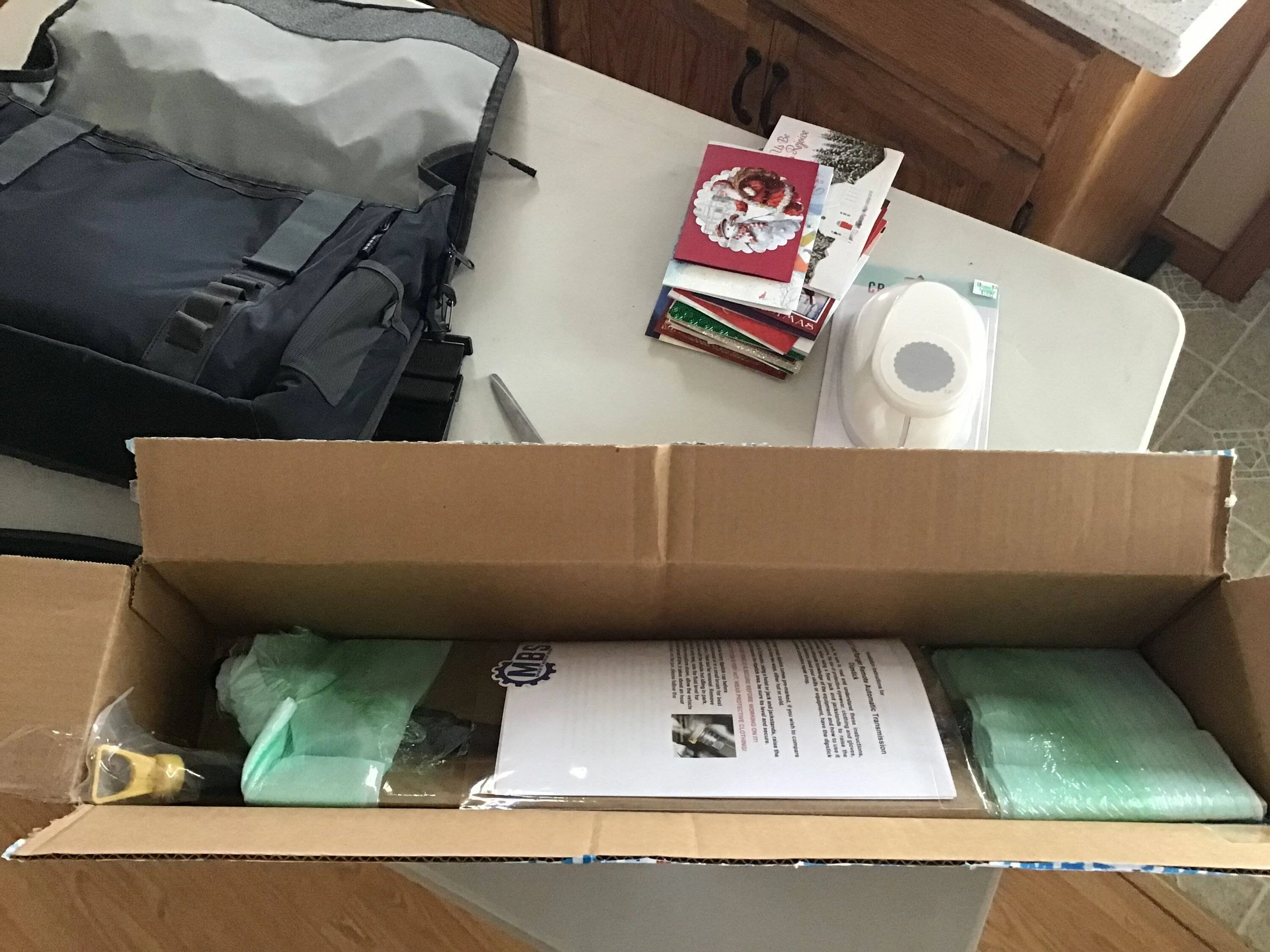

I'm as happy as can be. Mine came in today. Weather is crap but I don't care. Mike has outdone himself on this bad boy. Packaging was superb. Very finite details. All items taped in place.
If any of you are hesitant about it, don't be. You will not purchase anything else that didn't have as much thought and care go into a package. Mike, you are a scholar.
Thank you, sincerely.
