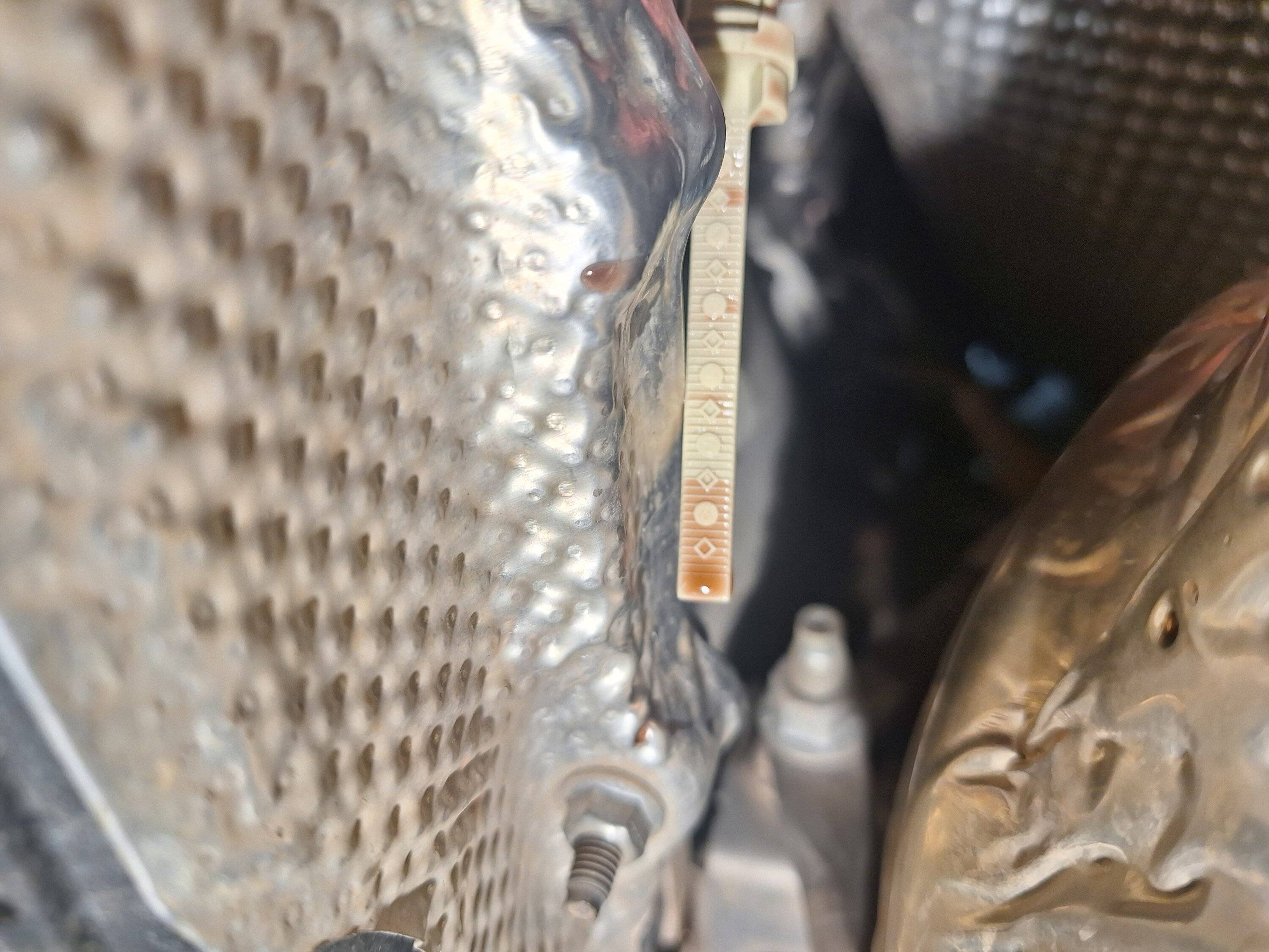

Extremely cold over night and started the dipstick removal/replacement. Stock dipstick between 5-6 dead even with second diamond. Checked it at least 8 times. All same reading. I'm not an expert but won't that drop even more once to operating Temps?

Checking the fluid level when dead cold, engine not running is going to vary on the reading on the stick from truck to truck.
It varies due to the internal valving on the transmission when the truck was shut off.
Where was most of the fluid at shutdown?
Torque Convertor - Pump Etc.
This is a HUGE factor in how much fluid will drain back down to the pan as it sits overnight.
The more fluid that drains back into the pan - the higher the level will read on the stick.
Now when doing the Fitz Install, one could use this as a reference to compare the OE vs Fitz
But only if the truck has not been started.
For correct fluid level check - Engine Running (Trans Hot) and Gears Cycled Through
Now the Operating Temp for the Coolant is about 195 Deg.
The Transmission Oil Cooler will maintain this temp as the transmission fluid is COOLED by the Engine Coolant.
If you put the transmission under a heavy load, (Towing - Steep Upgrade - driving it hard- Etc)
The transmission oil temp will climb above 195 Deg.
Now I know the manual STATES to check the transmission fluid level when the transmission temp is between 206-215 Deg.
THE REASON: For that NOTE in the manual, as the temperature of the fluid gets hotter it expands, so they want the fluid level to be at its most expanded state.
So, this is partly the reason we DO NOT have a FULL, level on the stick, Temperature Expansion
Variance. (Between 4 & 5)
But it should not make much of a level variation if the Transmission Fluid Temp is matching Engine Coolant Temp @ 195 Deg or so
As long as you are between 4 and 5 on the stick at 195 Deg, is going to be good, as that is what the transmission fluid is going to be (or near that temp) with normal driving as that is what it is designed to do.
