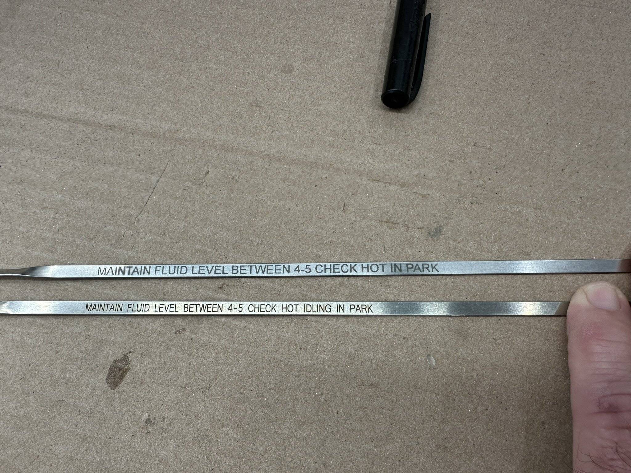

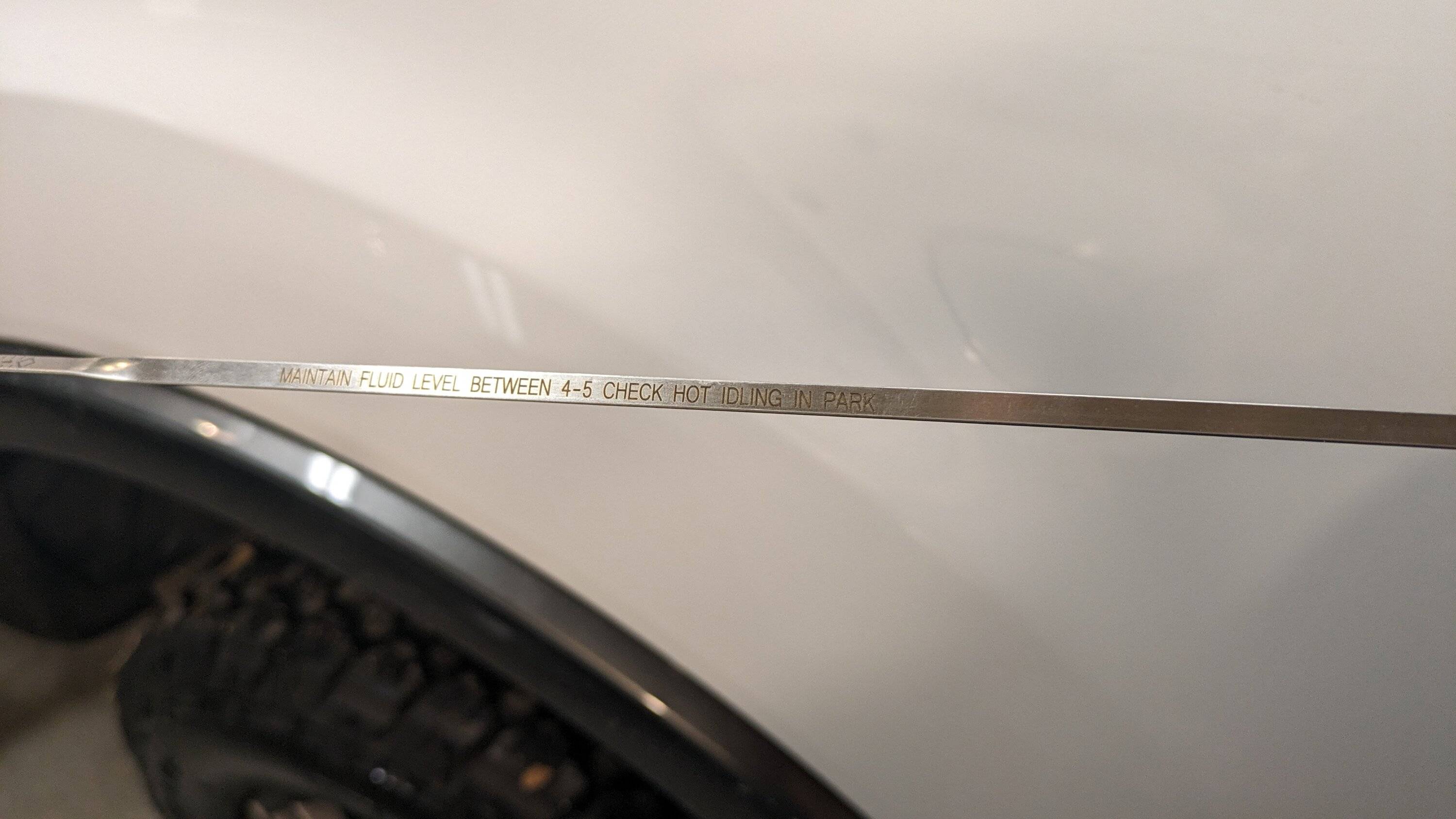

That's the backside of the stick, the front where you read the level it has the text a few inches up the stick.
The top one is your stick, the bottom one is the updated stick, the same one I will send you to replace your original one, but I have to figure out the shipping.

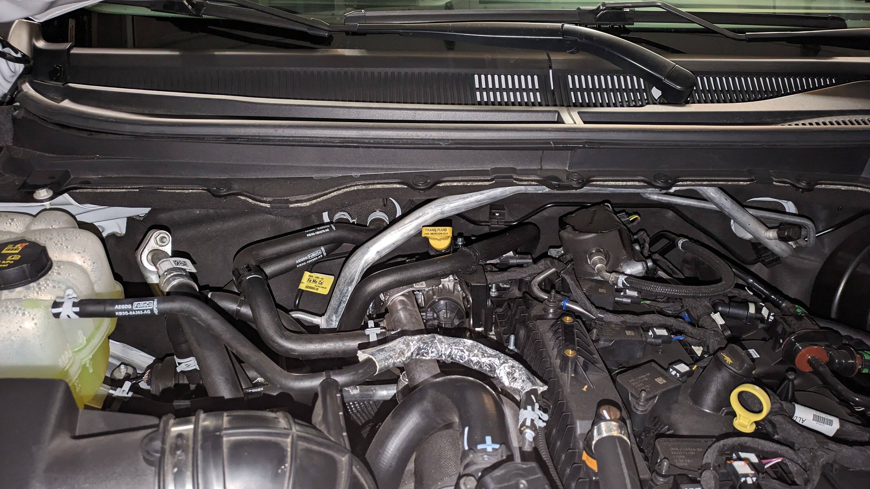

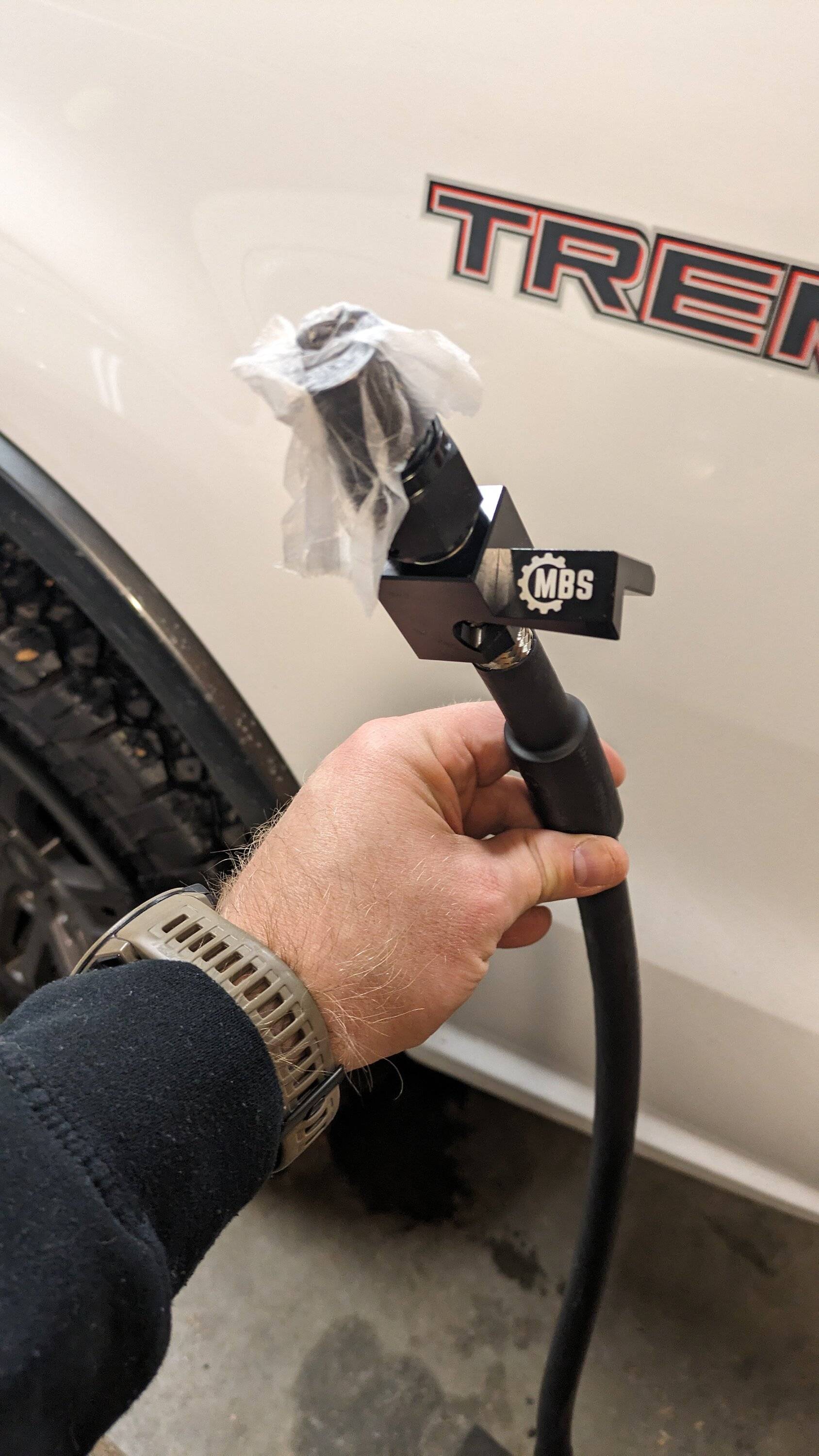

It's in.
I tried to get the factory fill cap from underneath, no dice. Too tight and no leverage. Planned to try the passenger wheel well but I needed a long breaker bar and freaking Lowes didn't have one.
Wound up getting it from above, two 20" extensions and a pivot adapter on the end above the socket on my 1/2 ratchet. Popped loose easy.
Everything else was pretty easy. Maybe get a nice narrow jaw adjustable wrench with a short handle for tightening the adapter and tube fitting when bolting everything up.
I'll run it up to temp tomorrow and check the level.
Nice kit Fitz ?? Went in easy and it'll make draining and filling a lot easier when it's time for fluid/filter service and a PPE pan.

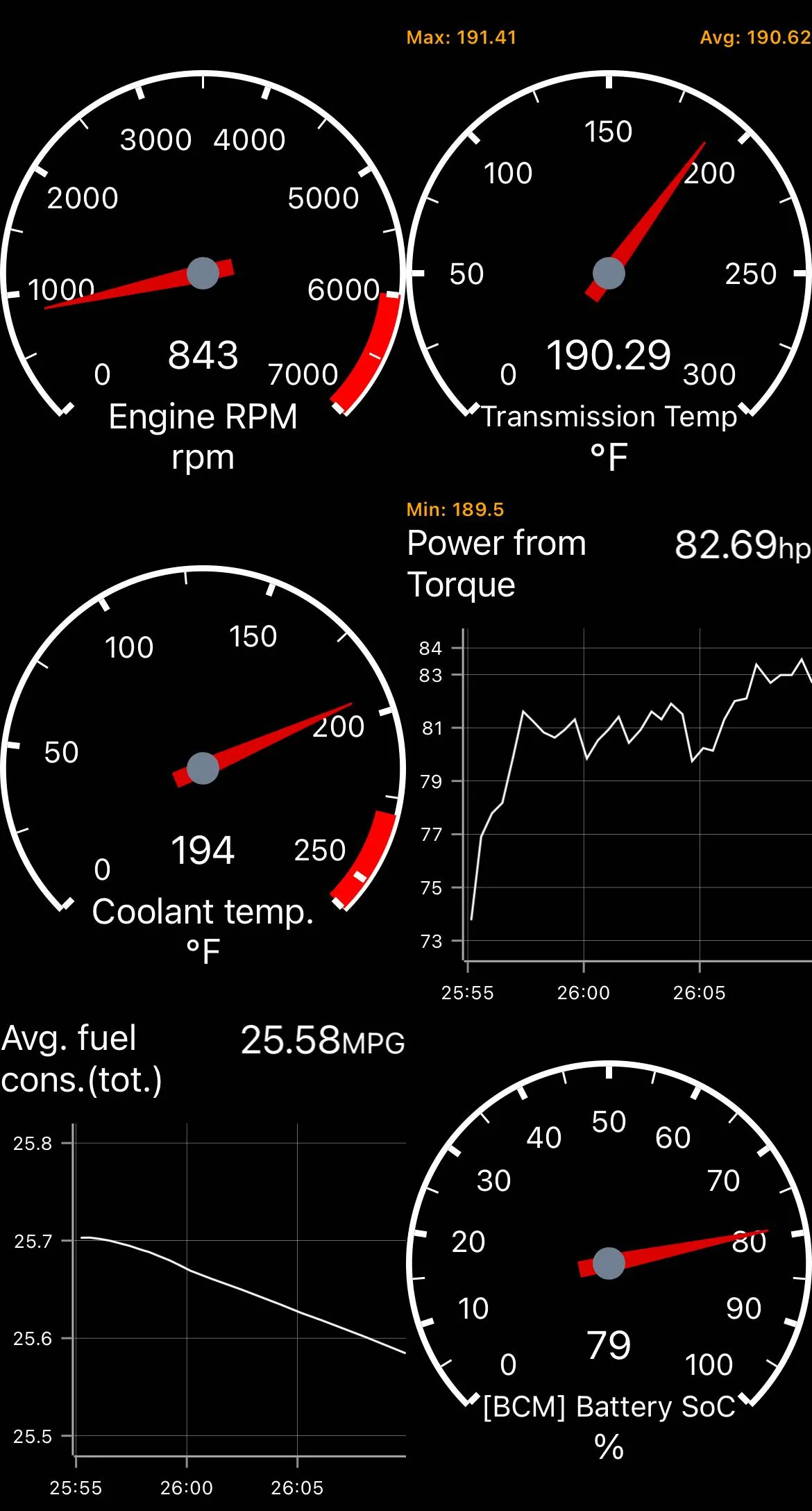

I’m gonna go ahead and say my Scan Gauge purchase was a waste - so, I’ll be selling it since I think I’m beyond my return period. I didn’t realize I could get so much information out of the OBD Link MX+ & an app (Car Scanner on Apple iOS).

…and just a few miles of city stop + go after sitting at 185 for 50 or so miles got it to 209.88°F and I definitely didn’t need that extra fluid. Sitting just above the 4.
Now that you've told everyone what you think of the Scan Gauge, I wouldn't try selling it here lol...
OBDFusion is what I use and it can show transmission gear position while your in S mode!
Ha. Good point. That’s ok. I’ll find a home for it.
Good call! Just switched coolant temp to gear. Much more fun to monitor. Haha.
