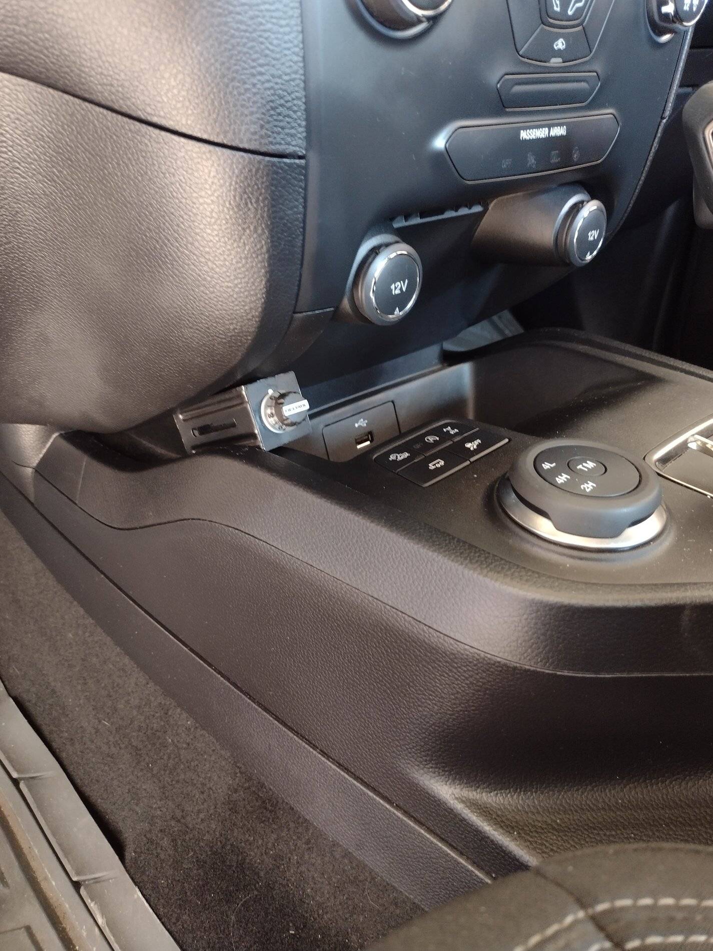

It may have been me that you're thinking of, but I didn't use a third-party face place, so maybe not.
I drilled into the lid. It was a real pain in the ass. The lid is made of multiple pieces and you have to be very careful / go very slow. I am very happy with the end results, though.
Pics here: 8492 - 2019 Ranger - Trailer Brake Controller Availability | Page 32 | 2019+ Ford Ranger and Raptor Forum (5th Generation) - Ranger5G.com
I've recessed the clear hex part into the switch since then so now it's even nicer looking:
I dig it! Recessing the clear nut into the lid looks like royal PITA, but will definitely give it a try since the chrome bezel adds some factory look. Did your truck came with tow package? Mine only has 4 blade connector under the bumper and I'm looking for suggestions on 4 to 7 blade adapter as well.

BTW here are a few other random details about putting the knob into that lid..
  • I used super glue to permanently close the lid, because it was possible to flip it open a tiny bit even with the knob installed.
  • The black plastic that houses the knob's electronics must be popped off in order for the electronics to fit inside of the 12V housing and the shaft to line up straight with the hole you drill.
  • When I recessed the clear plastic nut, I also ended up trimming and using the black plastic that houses the knob's electronics.. but I can't remember why. I think it may have been needed as a spacer or something when recessing the knob?
  • If the 12V housing gets loose from fitting and refitting everything, you can just wrap the backside of it with automotive felt tape, and then it'll be nice and secure again.

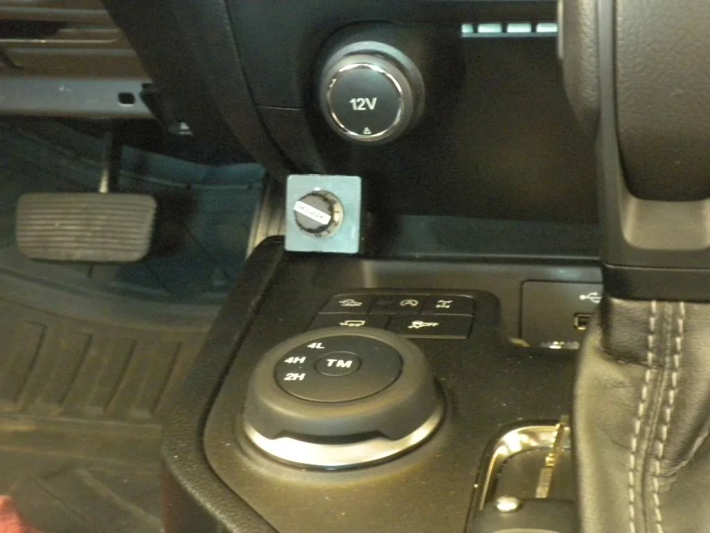

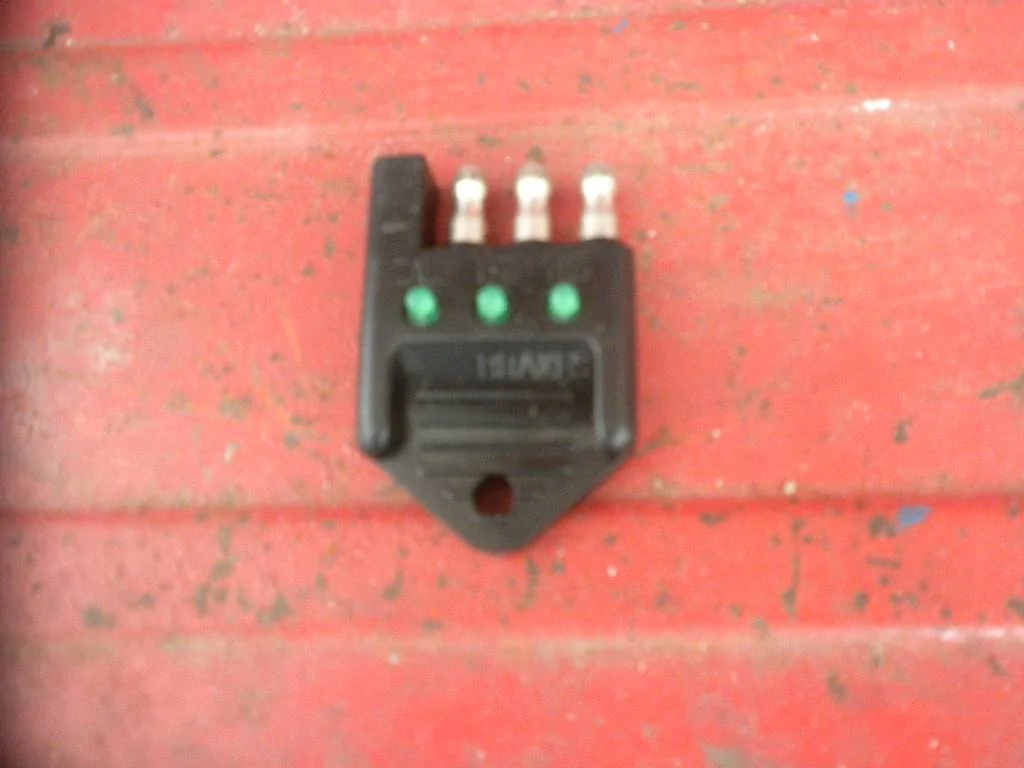

Finally finished the install of my Redarc Tow Pro Elite. Early version, no third brake light hook up. Acording to my trailer light tester all is in working order, brake, turn & tail lights. Also tested the 7 pin conector. Now for driving so unit can calibrate itself for it's location. Then wait till it's time to hook up a trailer & hope for the best. If I understand the instructions there is no light on the dash control knob unless a trailer is connected.
