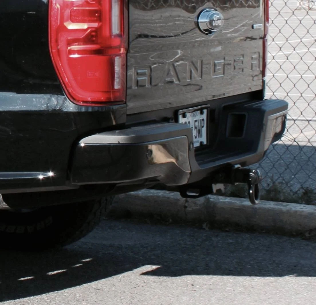

Assuming you have the trailer hitch, it would be a bunch easier to just get a hook that slides into the receiver. I have one, it's come in handy a few times over the years.
This!, I have one also, solid aluminum with a shackle.

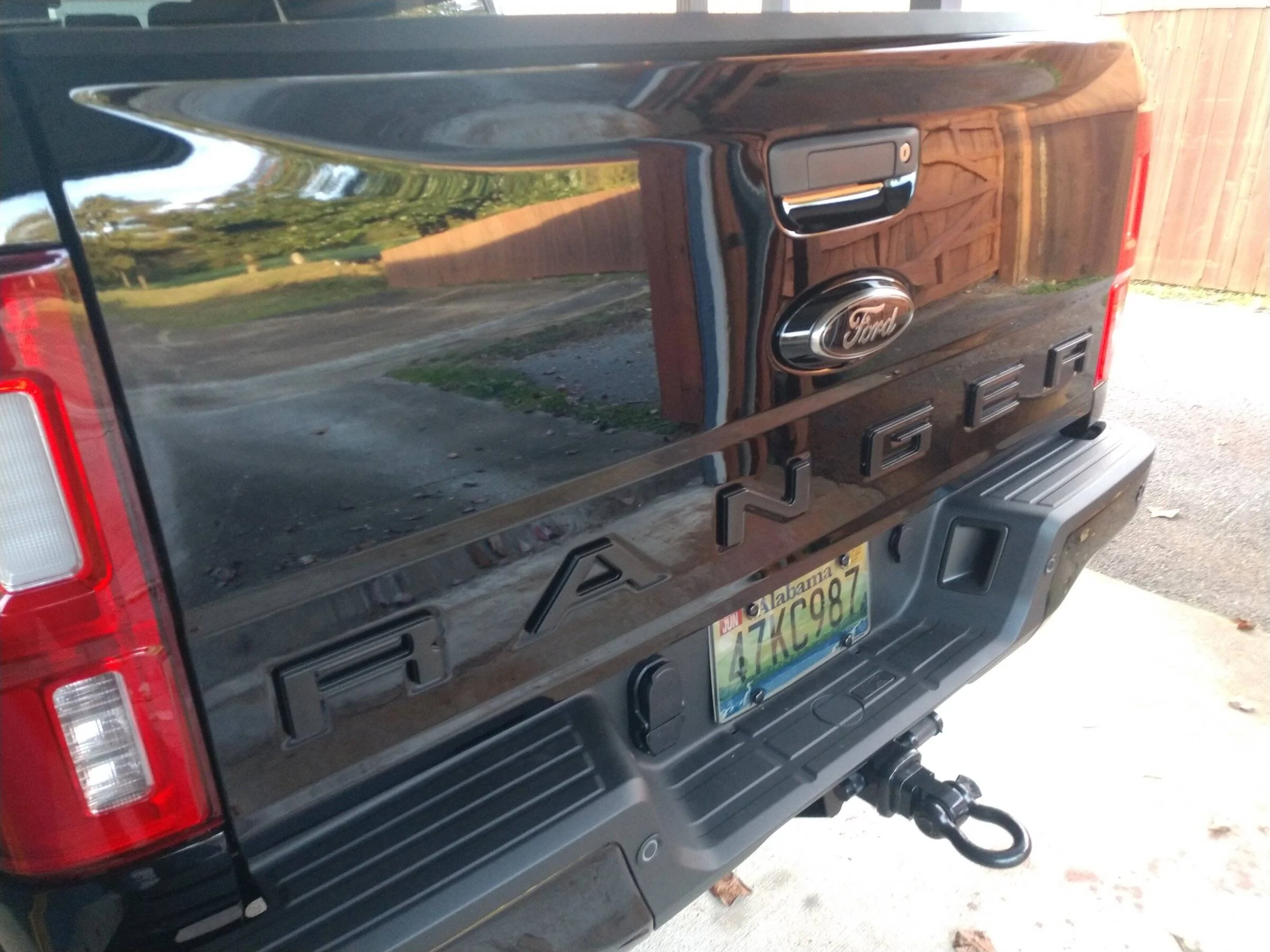

Saw this in a discription from Ford. Not on mine that I know of?
Ranger Tremor comes with two new recovery hooks in the rear, in addition to the two up front.
Do I need to call the dealer?
I installed this on mine, mostly to maybe keep these idiot drivers from riding my ass, but it will still perform as its' intended too.

I had one similar to this on my F150. It did more damage to my shins as I'd always forget it was there and walk into it so I finally pitched it. I just bought this one for my Jeep but will use it on my Ranger too. I also have a soft shackle, locking pin and tow strap coming tomorrow.

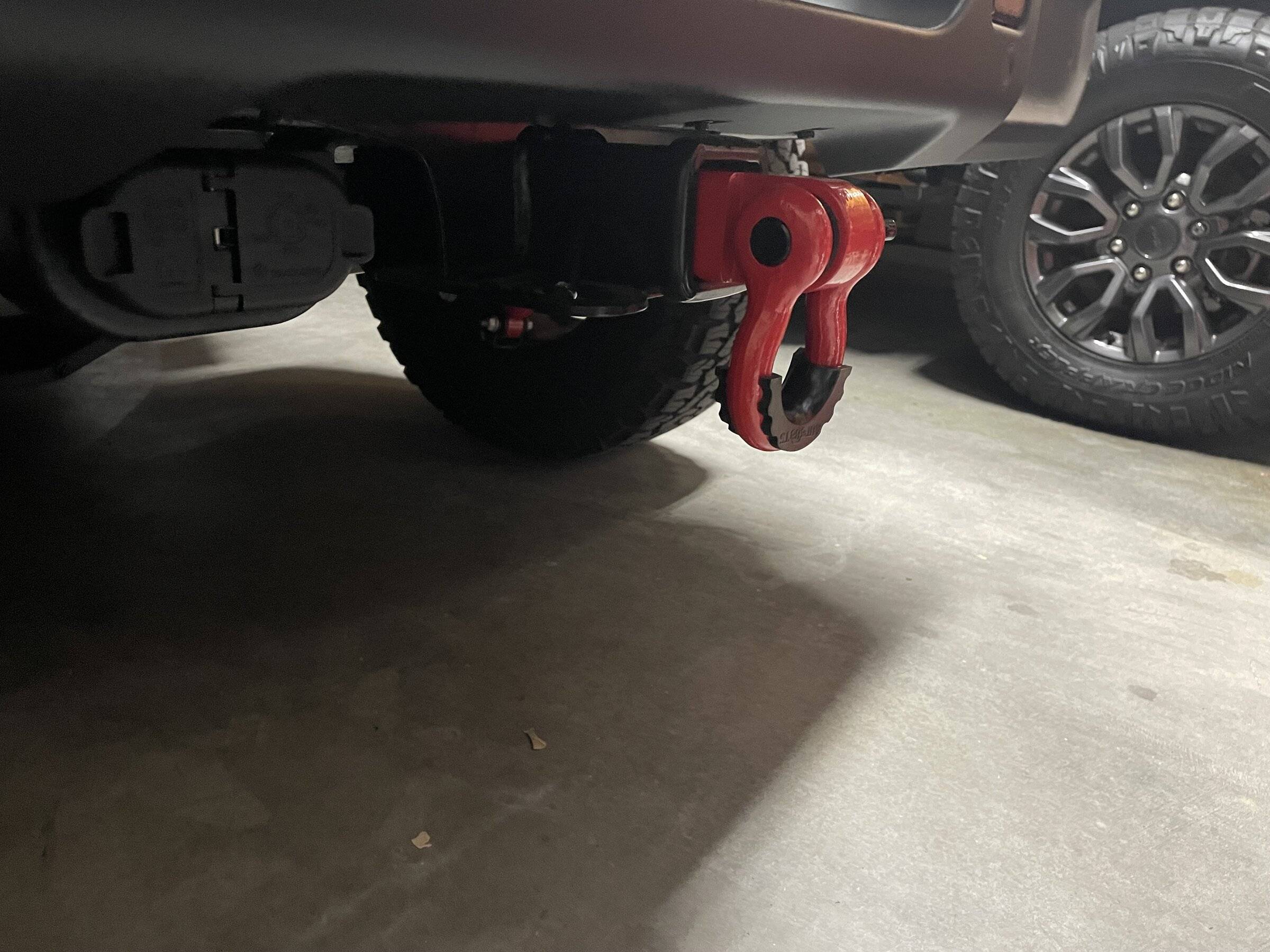

I have a D ring receiver as well. Don't forget about friction of the two steel surfaces, versuses just a metal pin. The d ring receiver will be stronger than just a soft shackle on a pin.

At least in California, if you want to keep a hard shackle attached, tighten beyond hand tight; keeps it from "walking off". Before using the shackle, loosen it to just hand tight.
