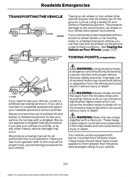

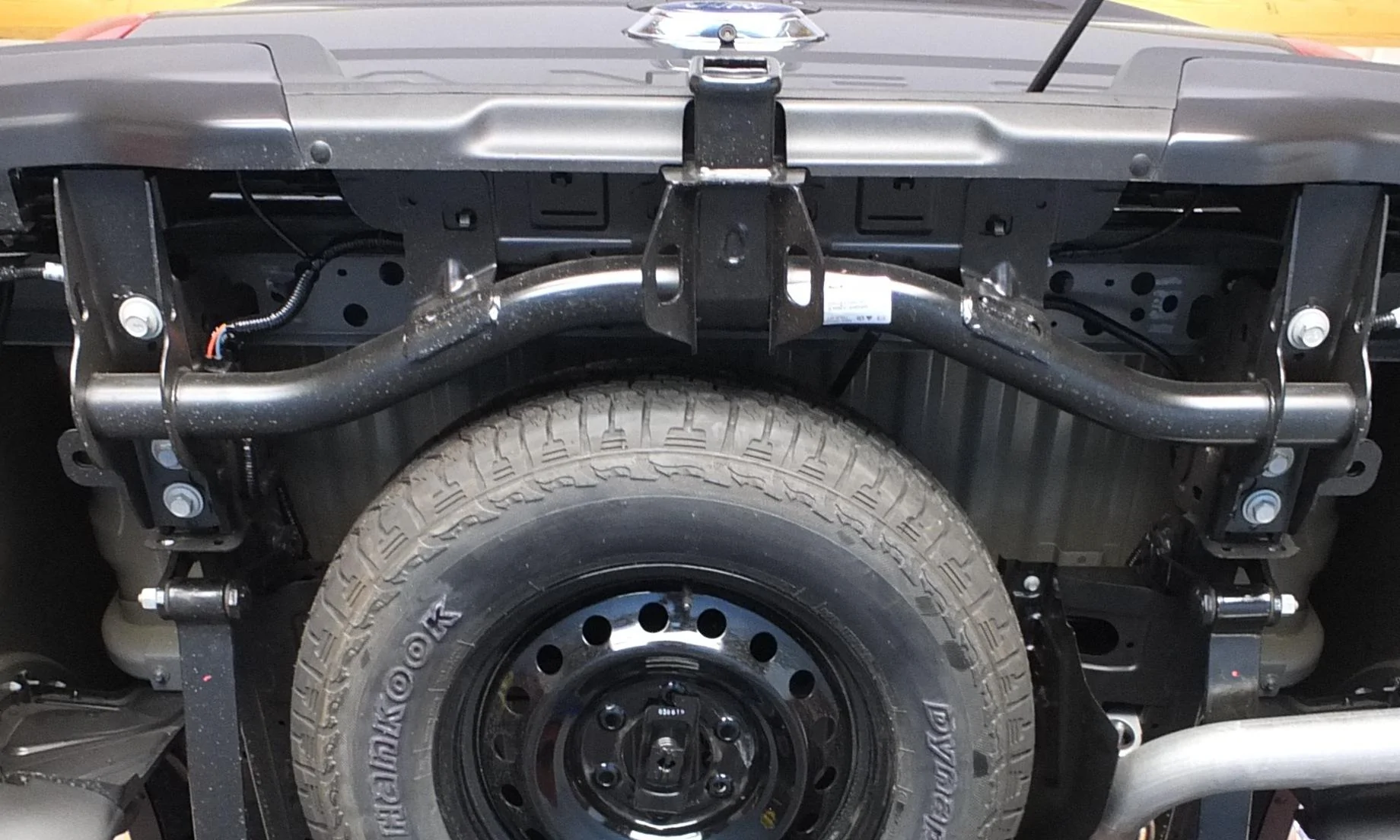

I've looked in the Owners Manual and don't see anywhere mentioned about using the chain loops on the hitch for recovery? The safety chain brackets are 10 gauge steel... and the holes for the safety chains are huge. You'll probably bend the brackets unless you are pulling the truck at the same angle they are attached.

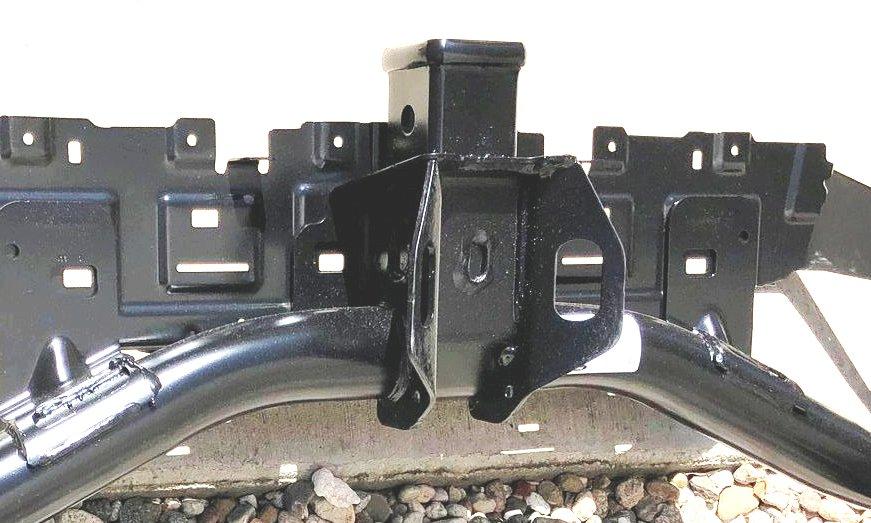

Found this picture online. Looks to me the tow hook is welded to receiver assembly. Anyone see something different?

It looks like an entirely different assembly that still spans back of the truck but doesn't have a 2" receiver on it. Only has the 4 pin connector as well. So this is the non tow package which has tow hooks in its place which would be why you can't get the tow hooks and the tow package its one or the other. Too bad.
