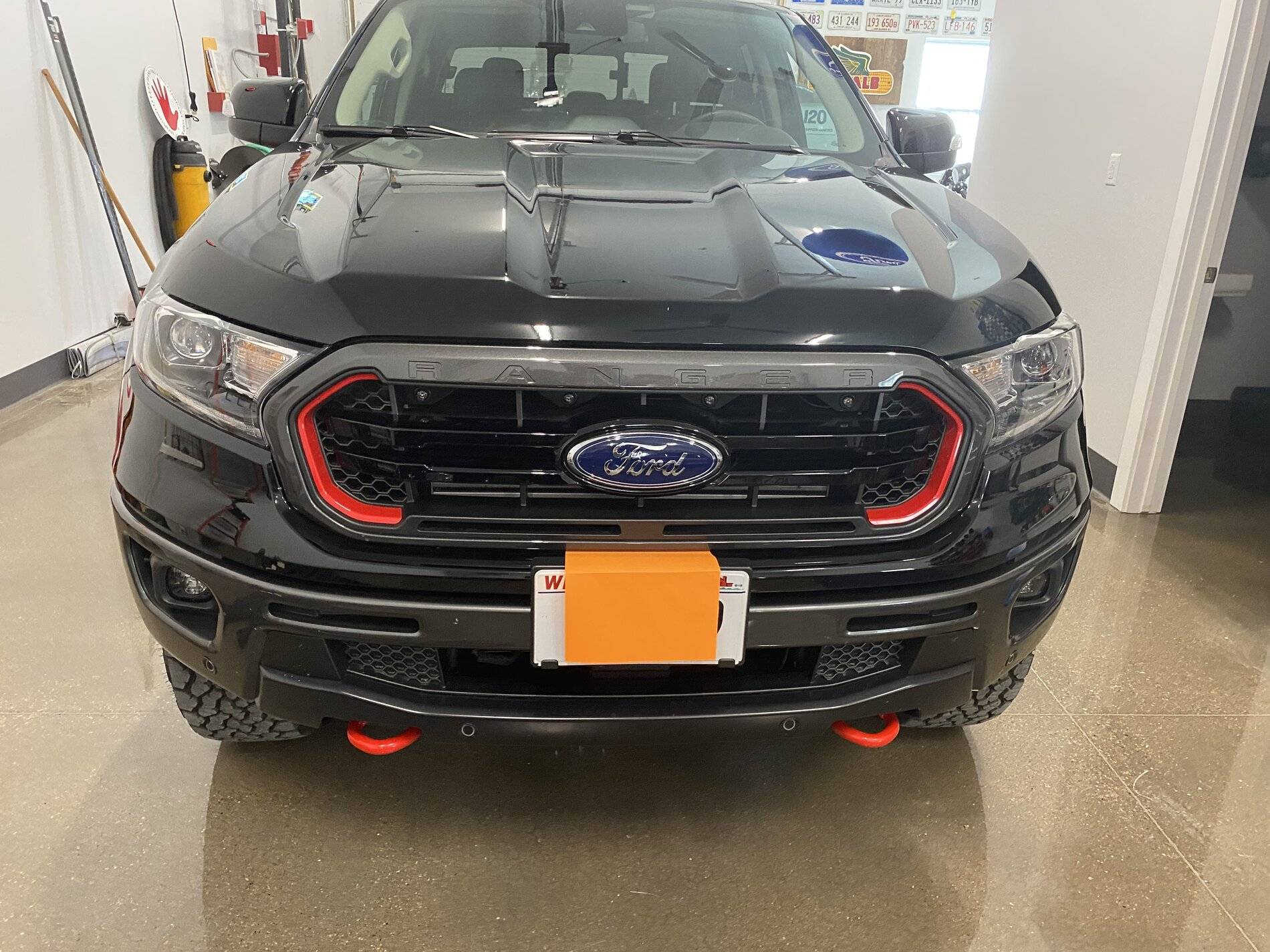

Hey Ranger experts
I just changed the tow hooks from black to red (Tremor)

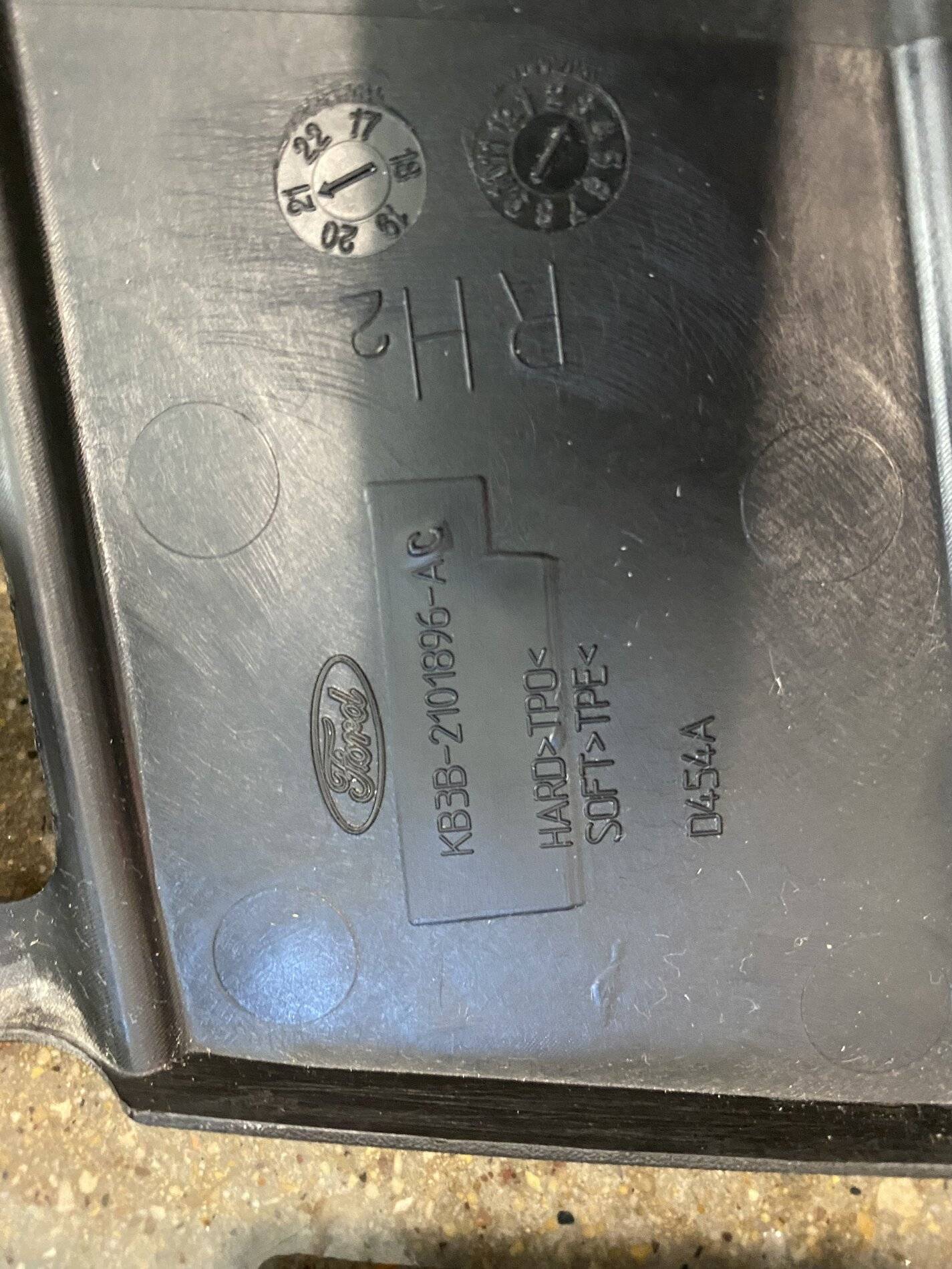

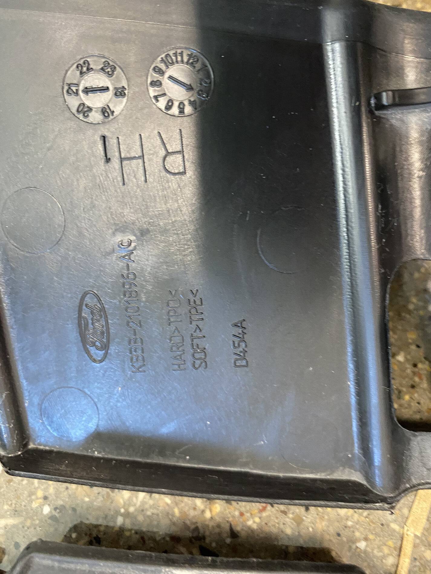

as I am putting it all back together I notice the rubber boot on the left does not fit very well. Hmmm after much thought and experiments I notice it say RH and so does the other one. I have 2 RH boots. Both have same PN and have RH on them. For you that have done this … is this correct ?
thank you

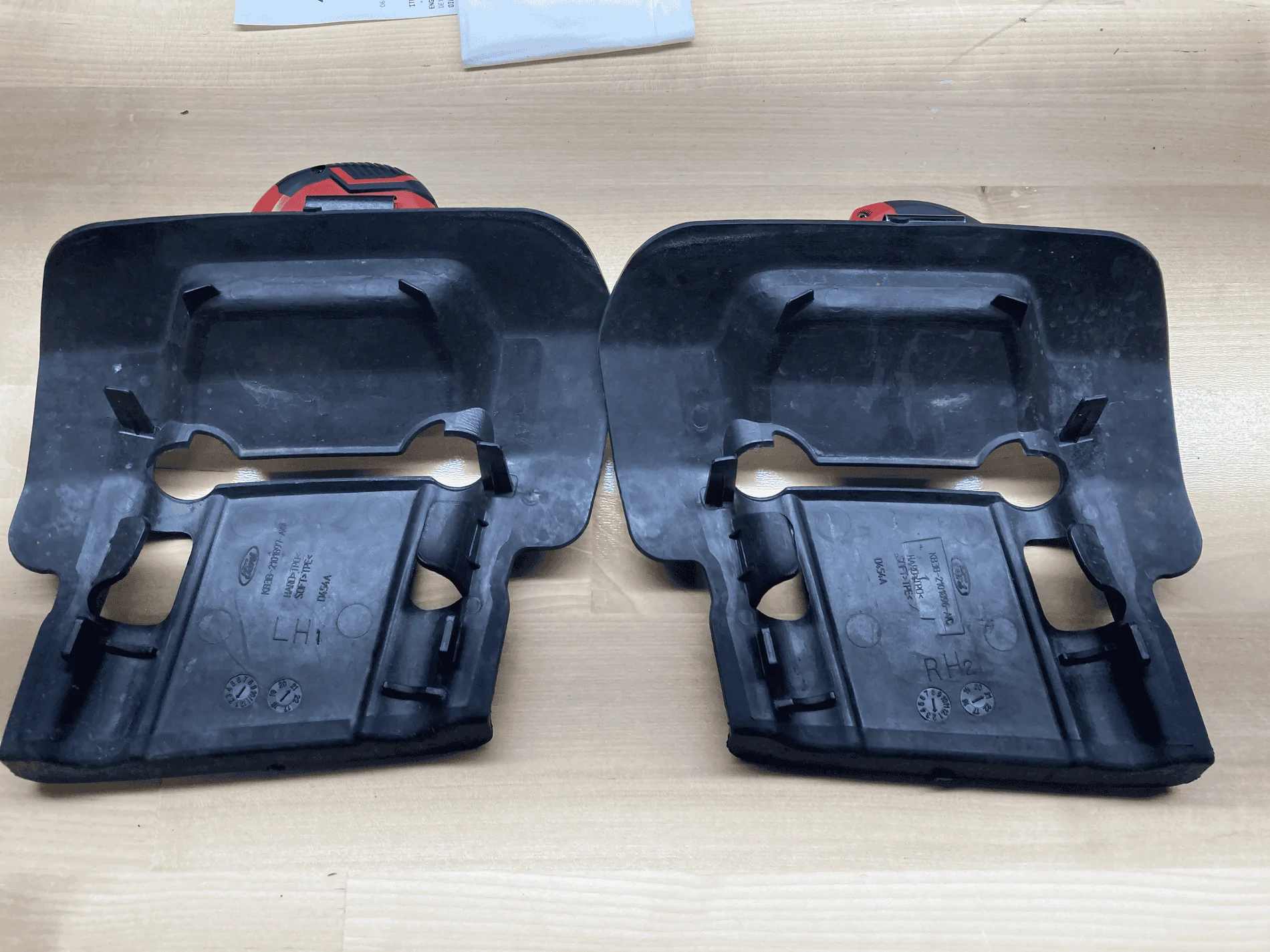

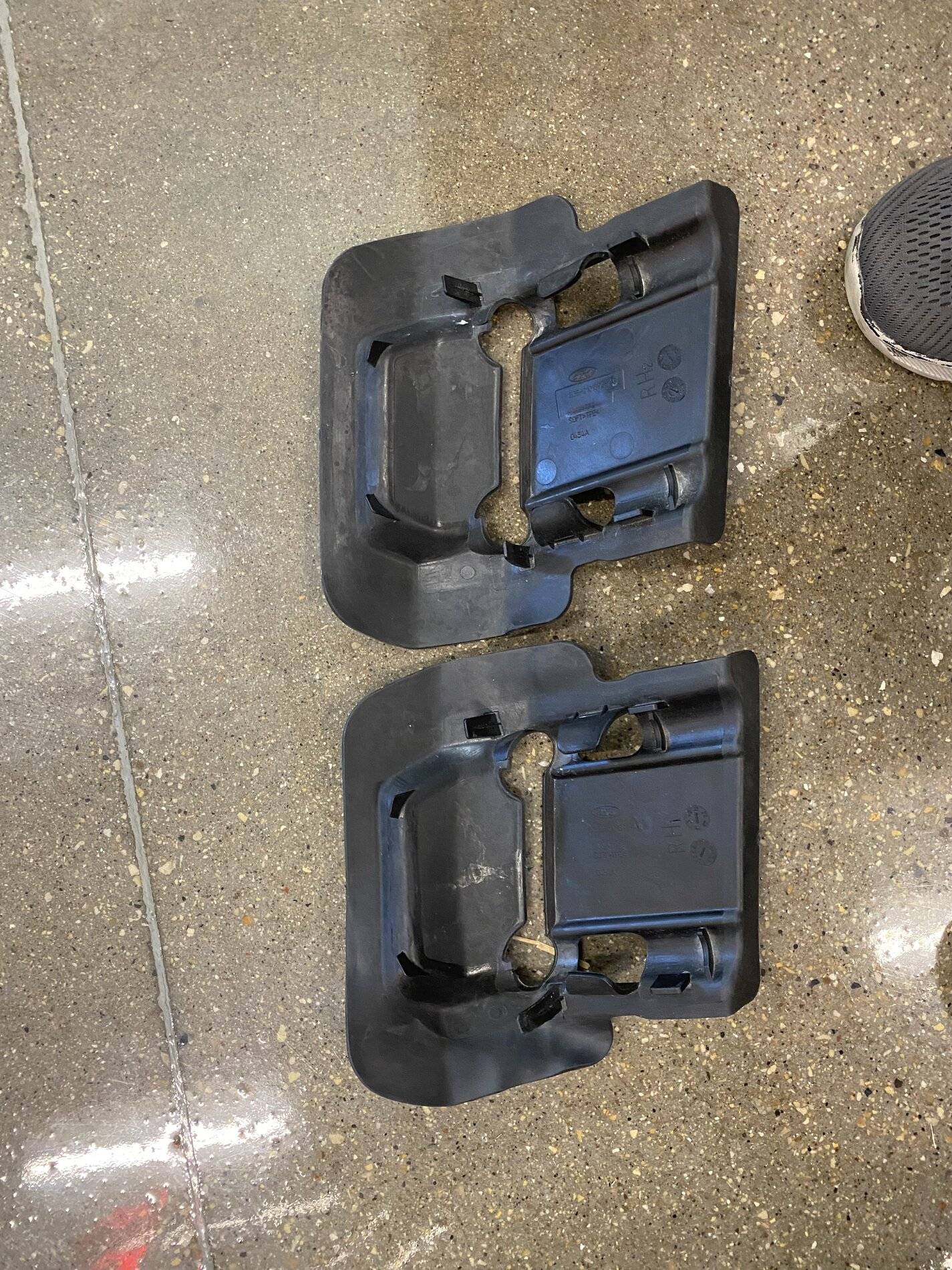

Since the bumper curves where the hooks are located the RH side fits very well . The LH side I can’t get all the material back behind the bumper and their is a gap/opening on the other side … with that said you just never know? Why I am asking to be sure.

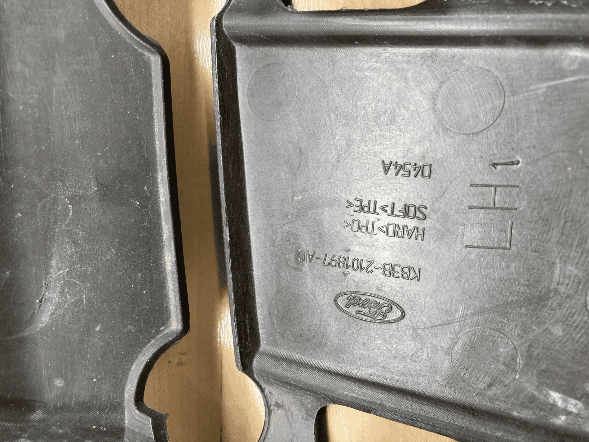

I just put the red tow hooks on my Ranger and can confirm the rubber surrounds are left and right handed.

Yep...Benny of Levittown Ford verified they are handed...now there is a cost reduction...make them universal...can't believe they deleted center tiedowns, but put up with the cost of unseen rubber pieces handed.. I hated the cost reduction game that we had to play at Ford. The pat statement was just do the low hanging fruit...Yeah...right!
