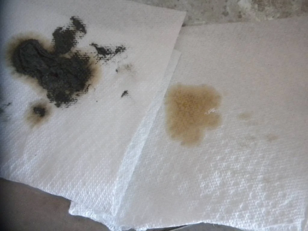

I installed the ARB cover from stage3 and replaced with Ford fluid at 4k-5k miles. Stock fluid was chunky, burnt, and both magnets were packed full. I will probably drain and refill at 15k-20k.

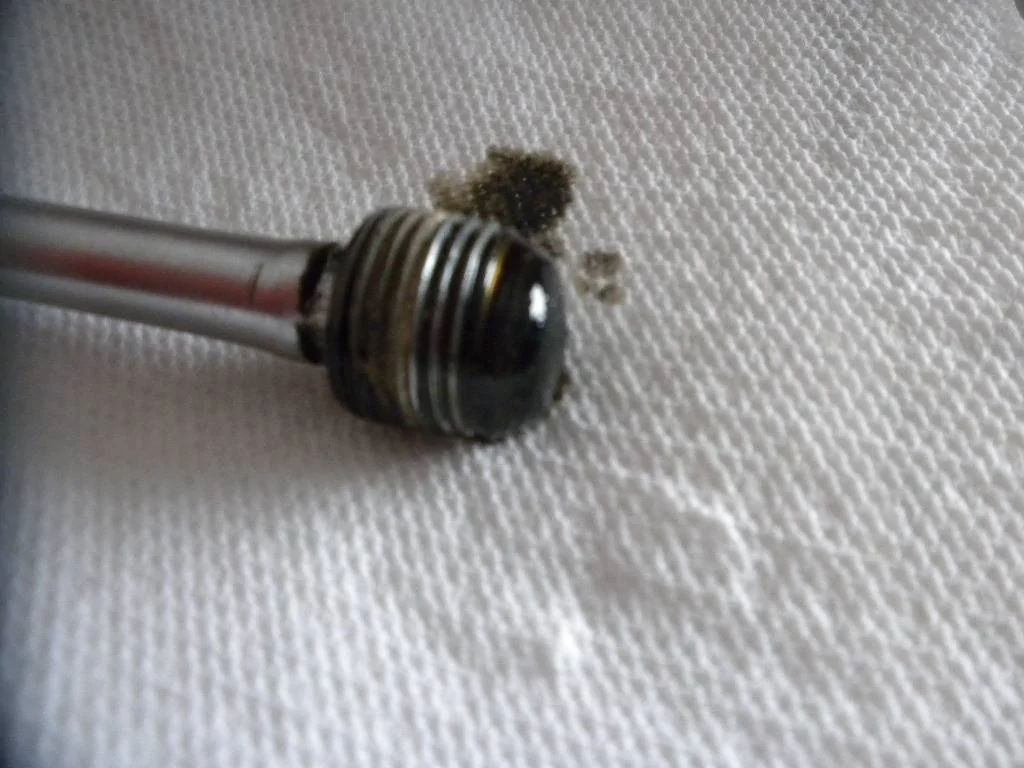

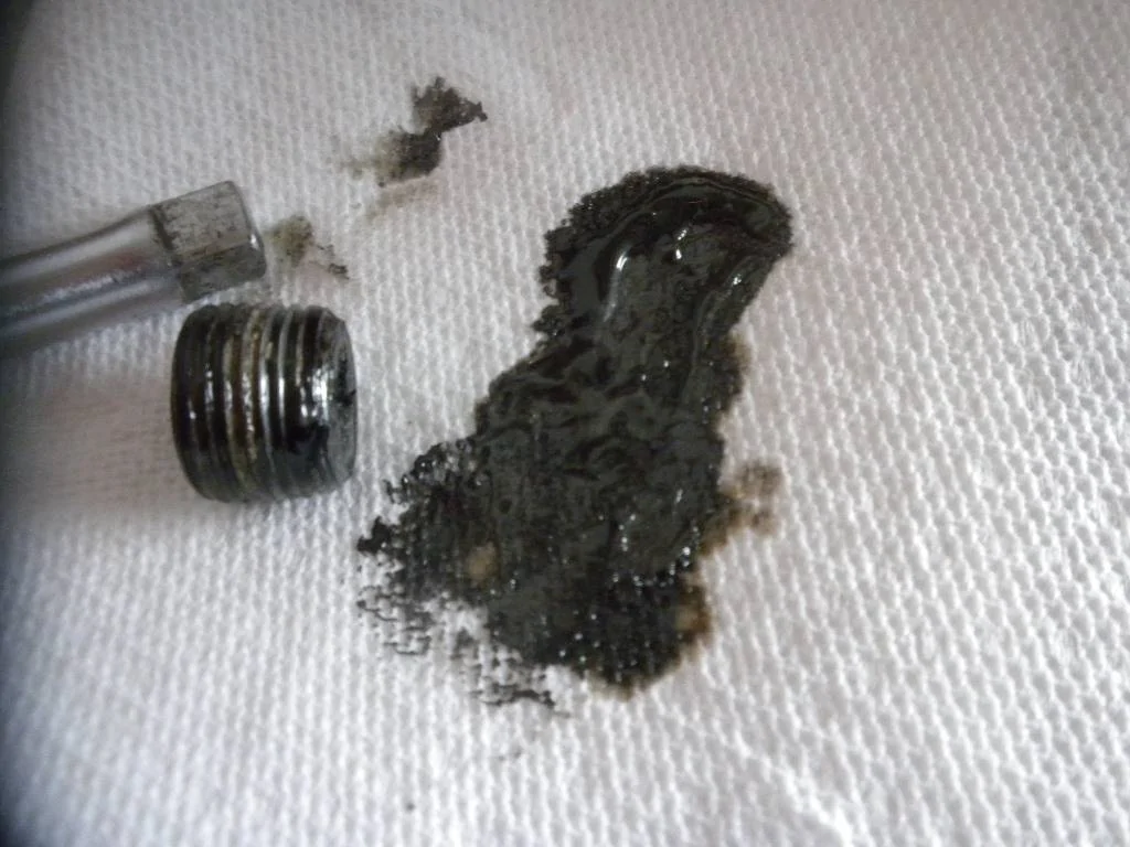

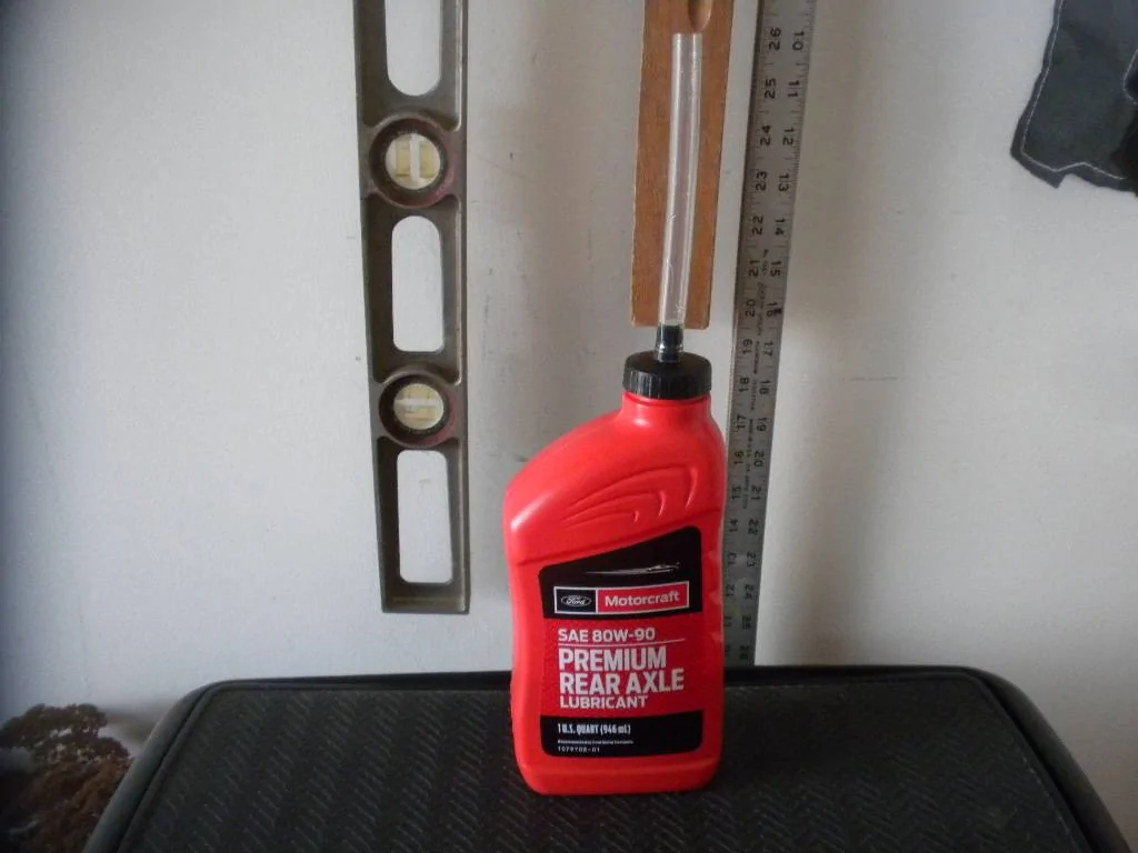

Did my rear diff. fluid yesterday. 33,524 miles will be 3 yrs old in June. I have pulled 5 U-Haul 6x12 trailer loads from Texas back to Mo. I don't believe that the amount on the magnet was that severe, there were no hunks of metal & the fluid was not all black & guncky. For anyone having trouble to fill just put a piece of clear fluid transfer tube over the tip of the bottle. I did remove the spare tire just to check the operation as I am getting ready for a road trip.
