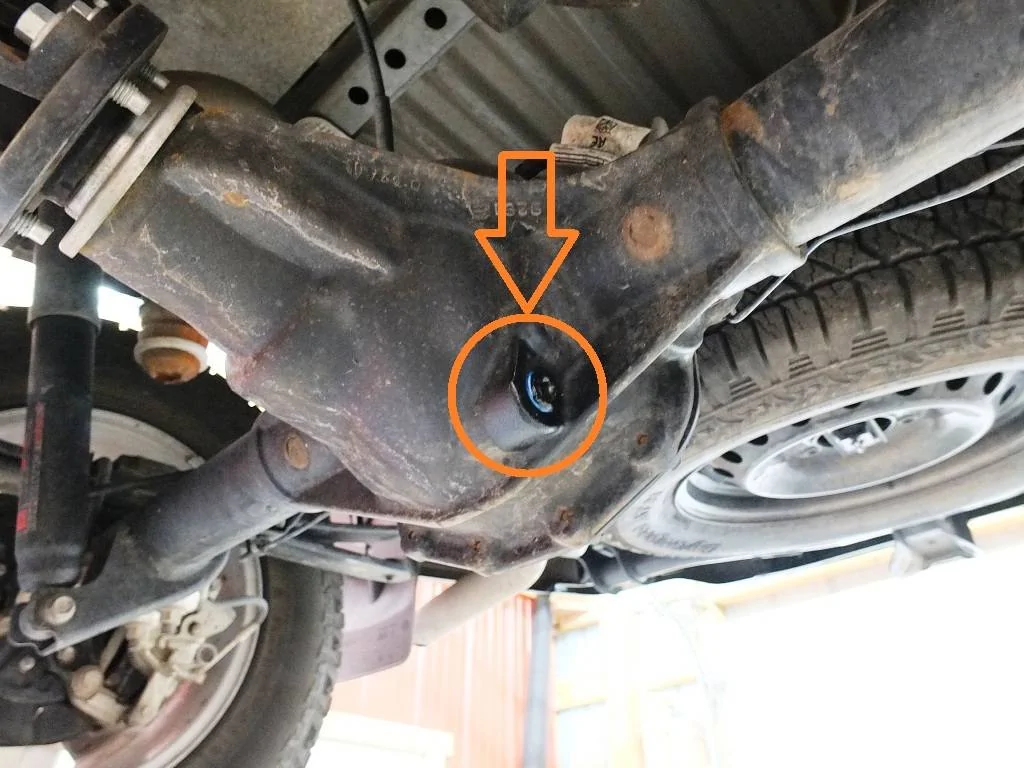

Hi Michael,
Pull the rear diff cover......
