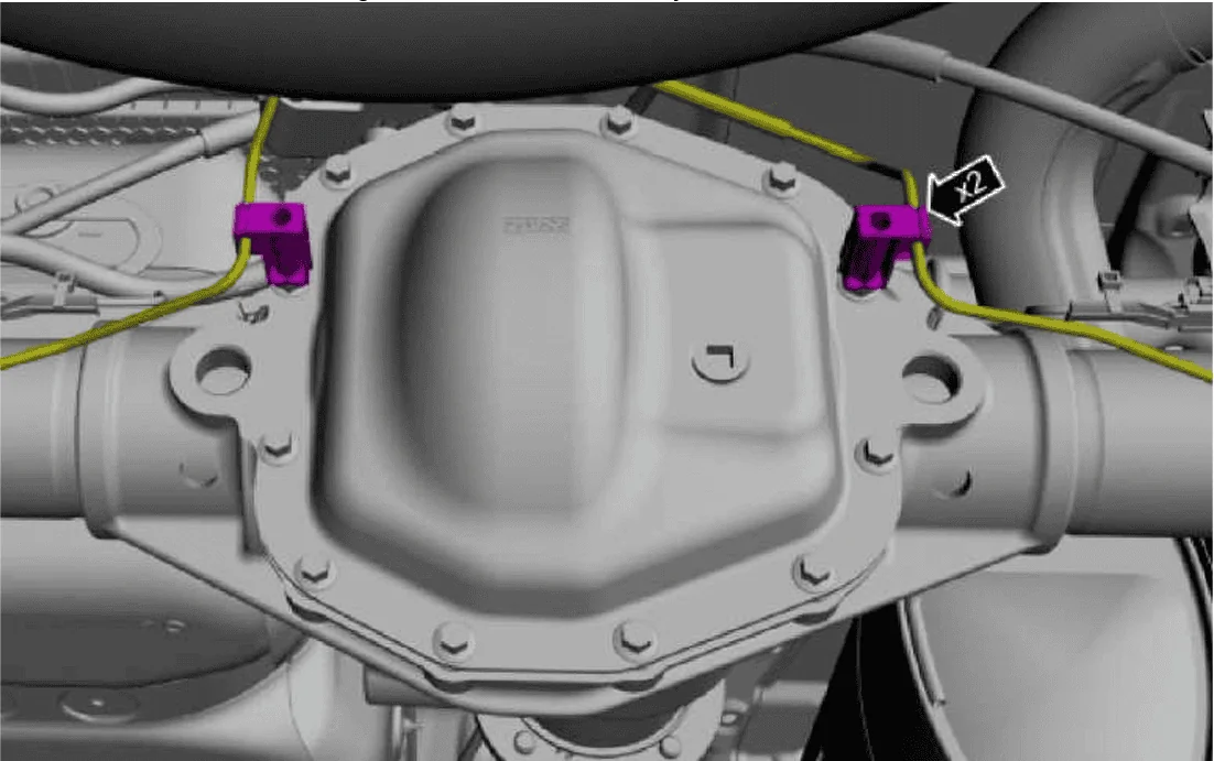

If you do not have a drain plug like me: Add the following steps- (Note the owners manual changed after the build date of 10/11/2021.. so anyone after that probably doesn't have the freaking bolt - guessing on that being when it changed)
Find a rather large drain to catch the mess that is about to happen.... I am going to add cardboard around the catch pan because I am dense and tend to miss with drain pans.....
Detach the brake line retainers (purple things in the picture) from the differential housing cover stud bolts using a small pry tool to lift them straight off. NOTE: Take care not to damage brake line retainers, they will be reinstalled.
Bolt removal. Remove the differential housing cover stud bolts (where the brake line retainers were located) using a deep wall 10mm socket. Then the rest with either a regular 10mm (if you can find it) or deep well.
Remove the case
Make a huge mess because Ford saved... 4 dollars and however much it cost to thread the bolt hole for the drain.... let it drain
I am going to replace the gasket because the gasket is pretty cheap and it seems silly to try and reuse it and end up spending even more to get a gasket later and more oil. So... clean up the surface so it is nice and smooth for the new gasket.
https://parts.levittownfordparts.com/ - part number KB3Z-4036-A - currently 26 dollars + shipping etc.
NOTE: Make sure the gasket mating surface is free of oil or debris before applying new gasket. NOTE: If rust is present, smoothen out any hard edges by scraping away some of the rust.
Throw the gasket on and put the cover back.
TORQUE: Tighten both the bolts and brake cable retainers to 20 – 25 lbs. ft. (27 – 34 Nm)

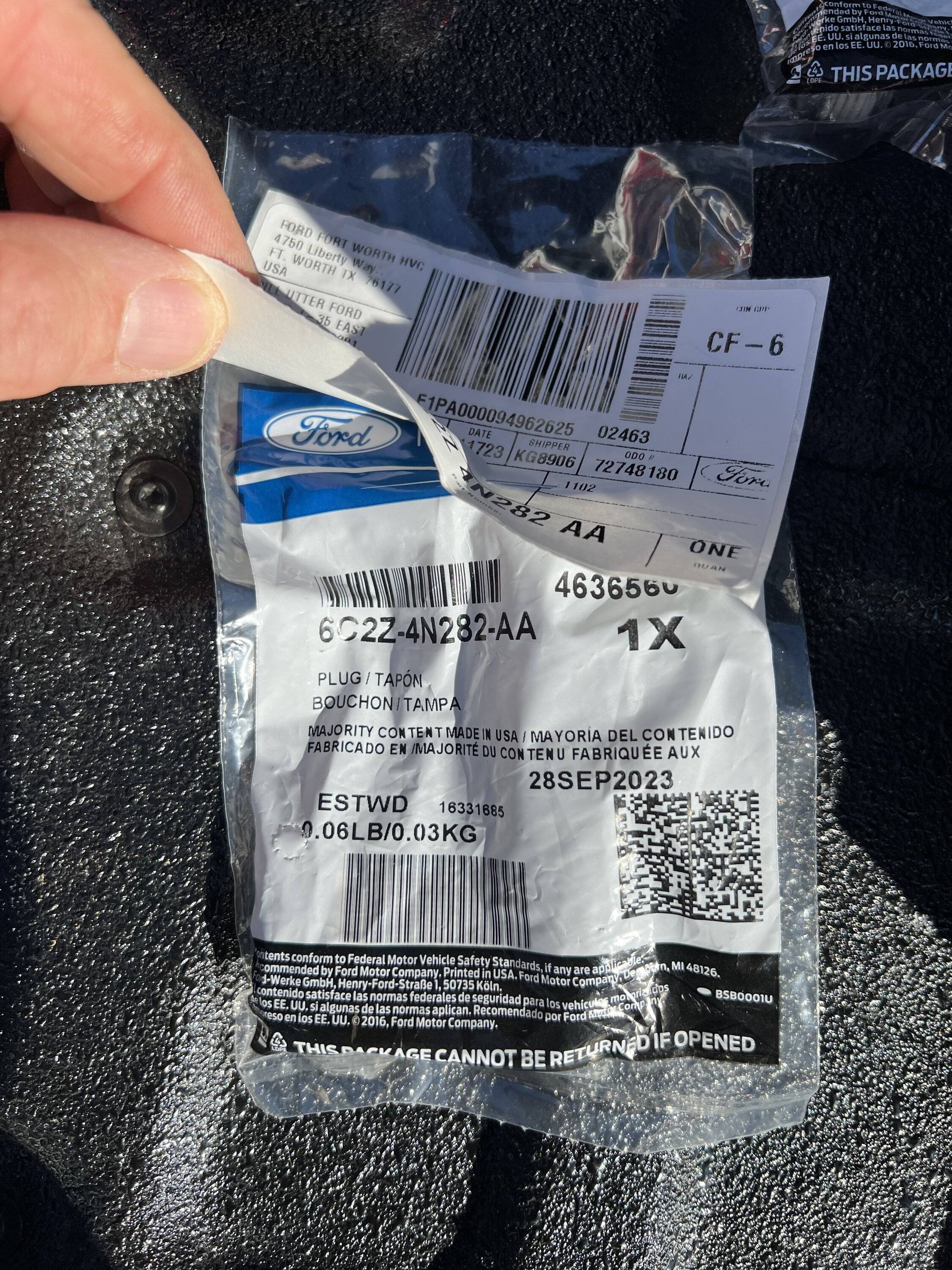

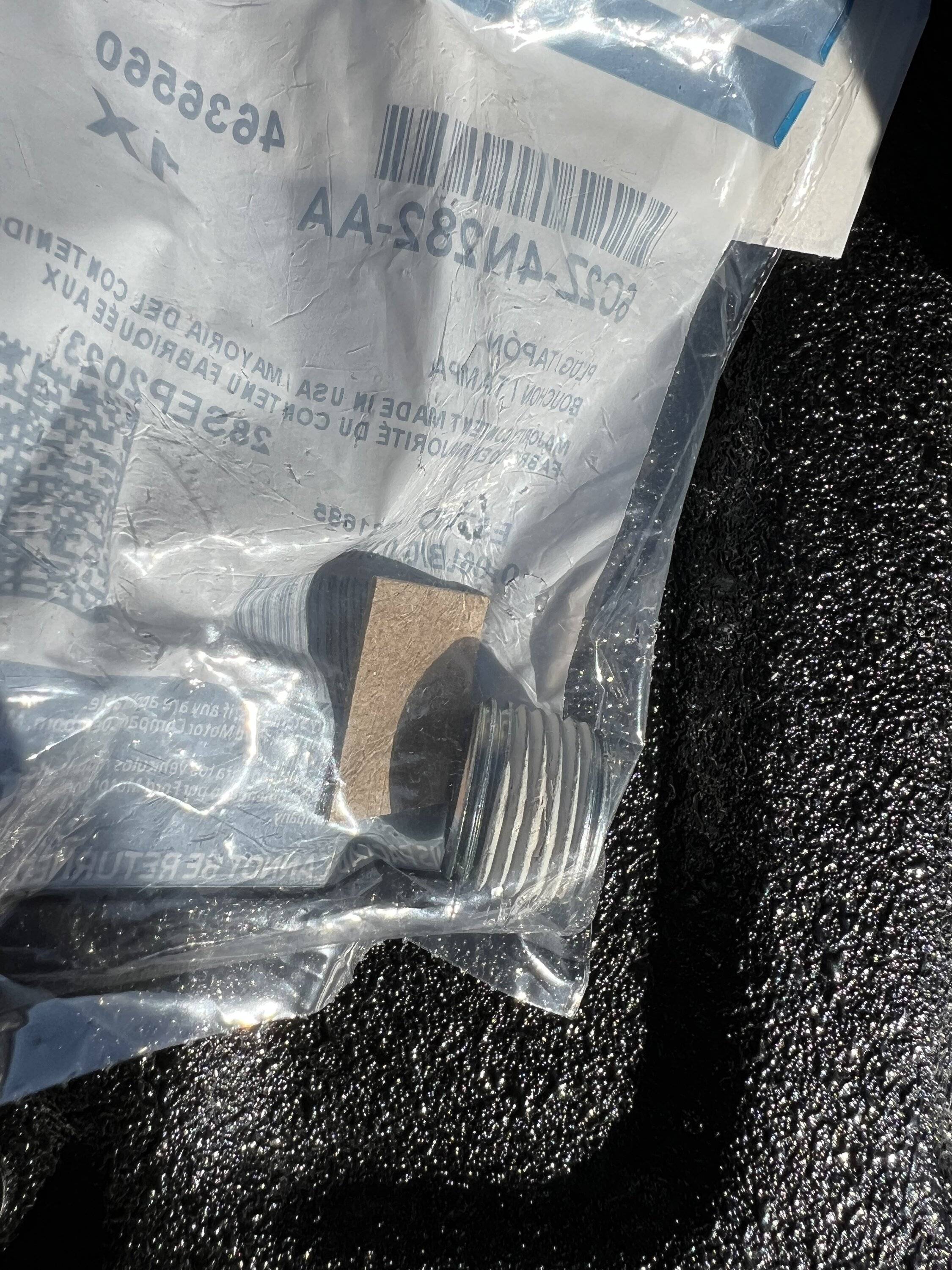

Of course, Ford wants you to replace the plugs, I'm sure they have a small bit of sealant on them, but those threads should be NPT and tapered. There's no reason you can't reuse them. I actually find it flat-out ridiculous that they want you to. I suppose it gives the dealers another line item they can charge, and it might prevent the ham-fisted dealership lube monkey from having a leak, but anyone competent should have no issue with it.
I'm on change #3 with the same plugs. It's not something you should stress over unless you absolutely positively want to do it 'by the book', which is slightly silly, but it's your money. Frankly, I never even consulted the manual for the change other than to look up the recommended fluid.
The amount of 'one-time use' threaded fasteners on this truck boggles the mind.

I reused same plugs. Seemed like a waste to trash them. Been 10k miles since i did the rear and it has not budged. I did the transfer case and front Diff last weekend, and so far no leaks or issues. I'll keep an eye on them for about 1k, then call it good. I just hand torqued them down till snug like you would an oil drain plug. Also, I did not see any evidence of a thread sealant on any of them, and they all came off super easy as others have mentioned. (2020 xlt 4x4)
Side note, I also did the transmission fluid last weekend using that $7 harbor freight red transfer pump. Sucked out just under 5 qts from the dipstick and put 5 full qts back in. I'm at 48k miles. I'll go another 15k then drop the pan and replace filter. I had planned on buying the overpriced PPE pan, but it was so easy to pump it out and back in, that I think I'll save the money and just use the stock plastic pan. PPE used to be like 200 and is now over 300. Just not worth it for a drain bolt and an extra qt. or so. I offroad a lot and don't hit the plastic pan at all. If someone has built a rock crawler, then the PPE pan is probably worth it for added durability.
.... I asked parts guy and he said the reason to replace per ford is that there is single use thread sealant on them so everyone above is correct I planned to re use and add thread sealant like others but they are surprisingly cheap only $2.50 each so I bought two I plan to reuse fill plug (not likely to leak logically) and replace the drain plug just haven't gotten to it yet but Im only at 37k
