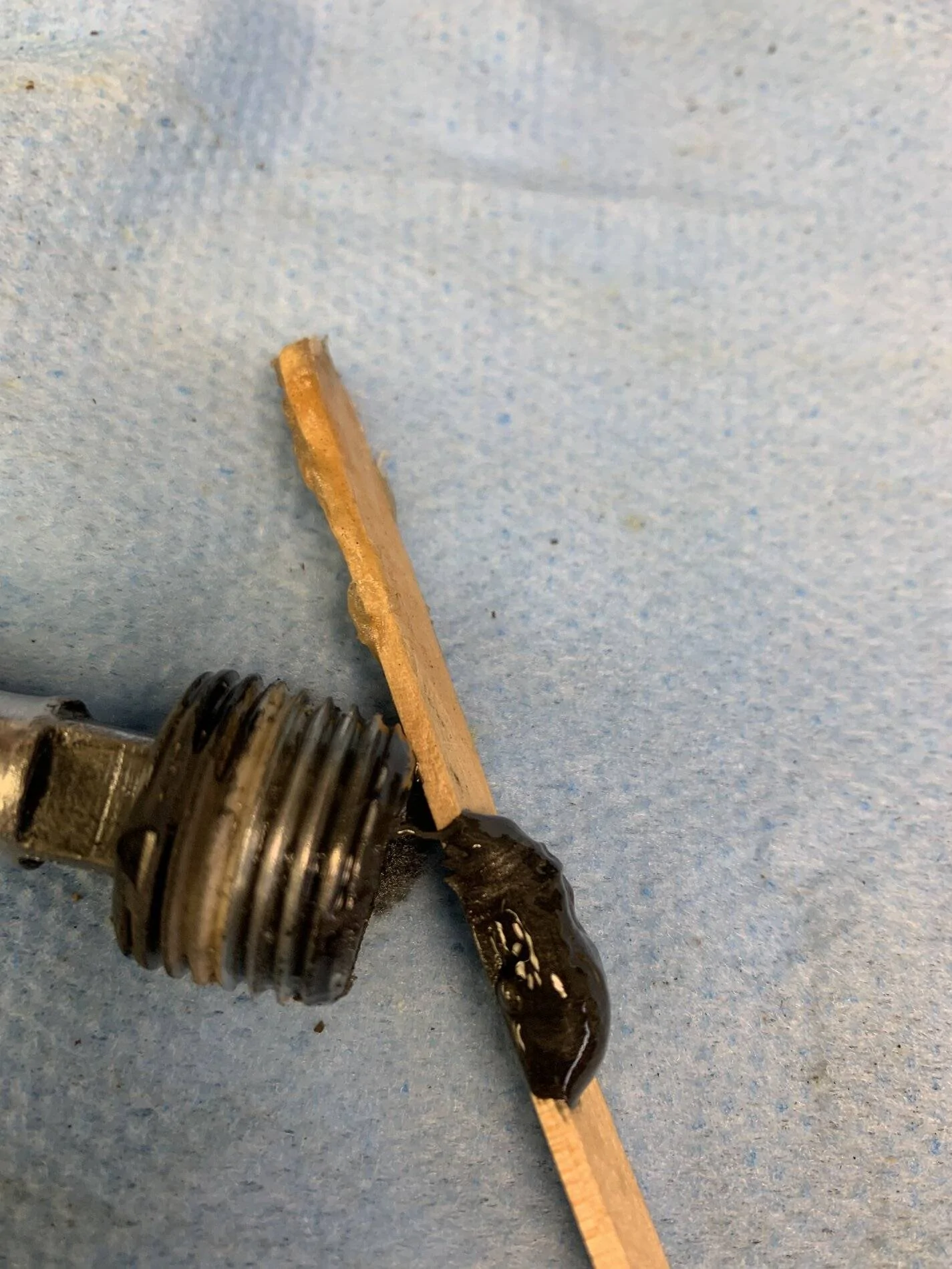

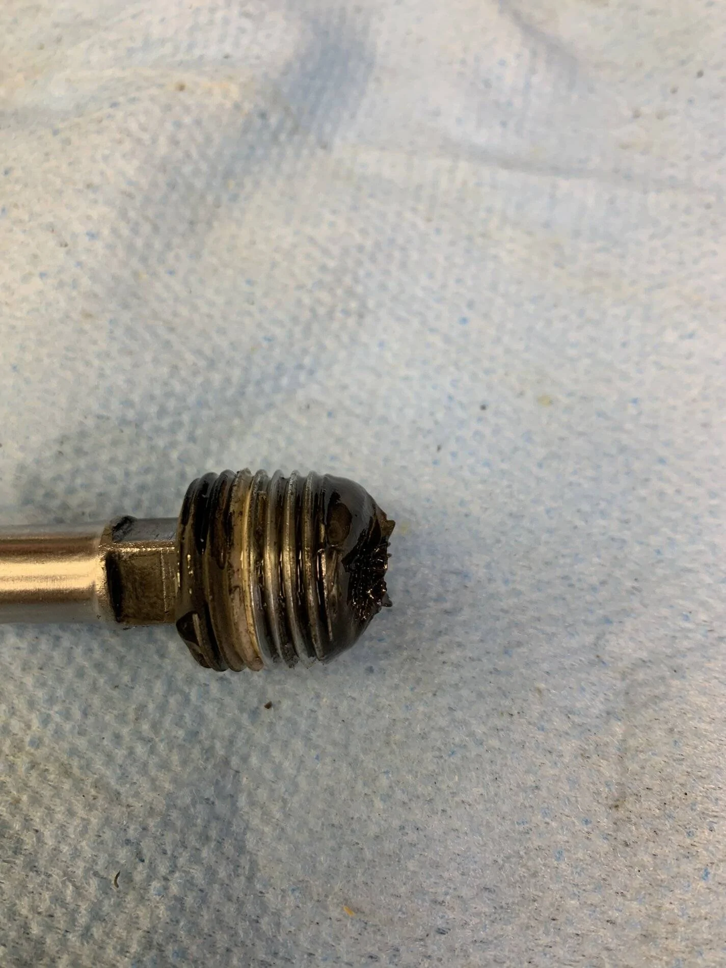

kieefer
keith
Dec 26, 2017
1,059
1,960
2025 F150 King Ranch - 97 BMW M3
I was surprised how much sludge was on the drain plug with only 30k miles.
JesseS
Jesse
May 26, 2021
1,755
4,823
NorCal (Roseville)
That's just nasty! think I will be changing ALL of the fluids 1000 miles (next week) and then more often than called for.
