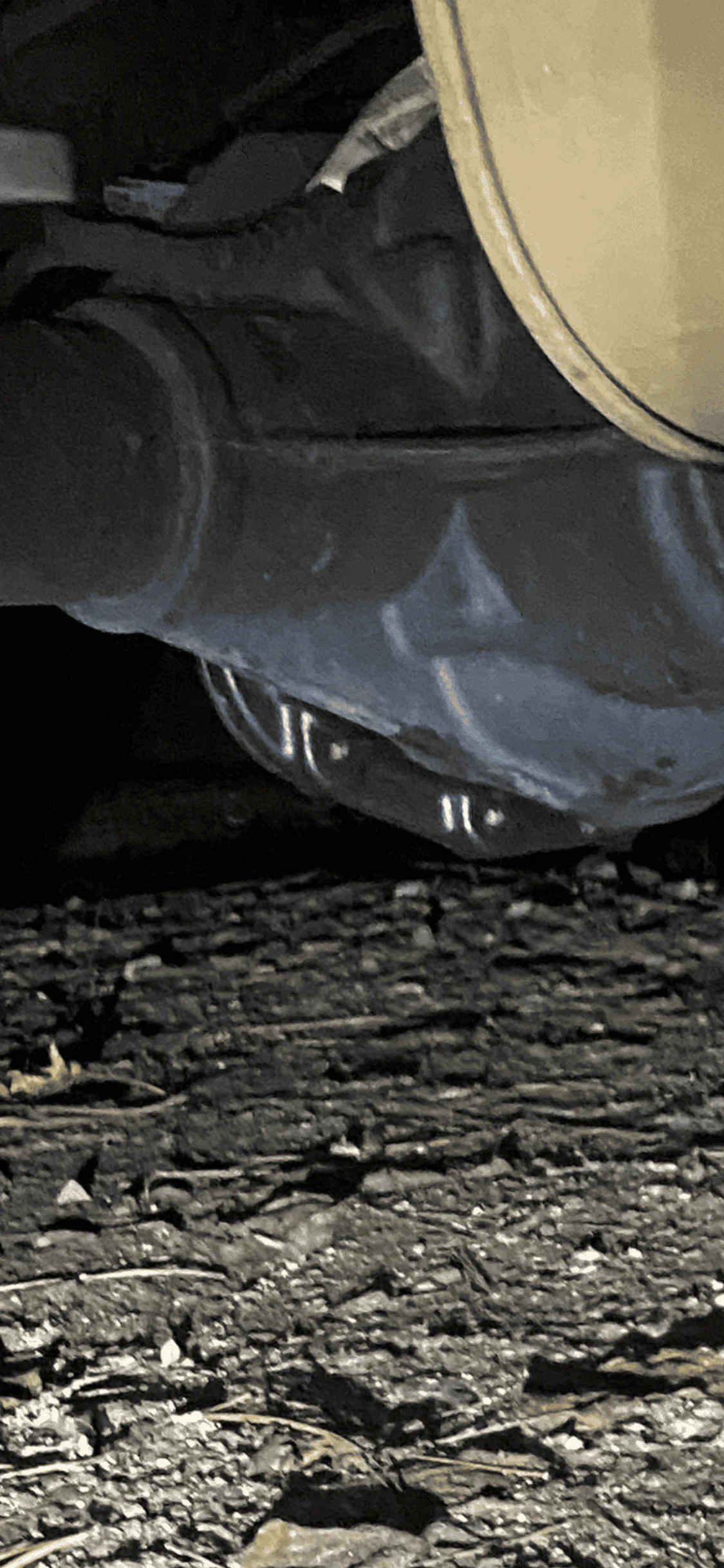

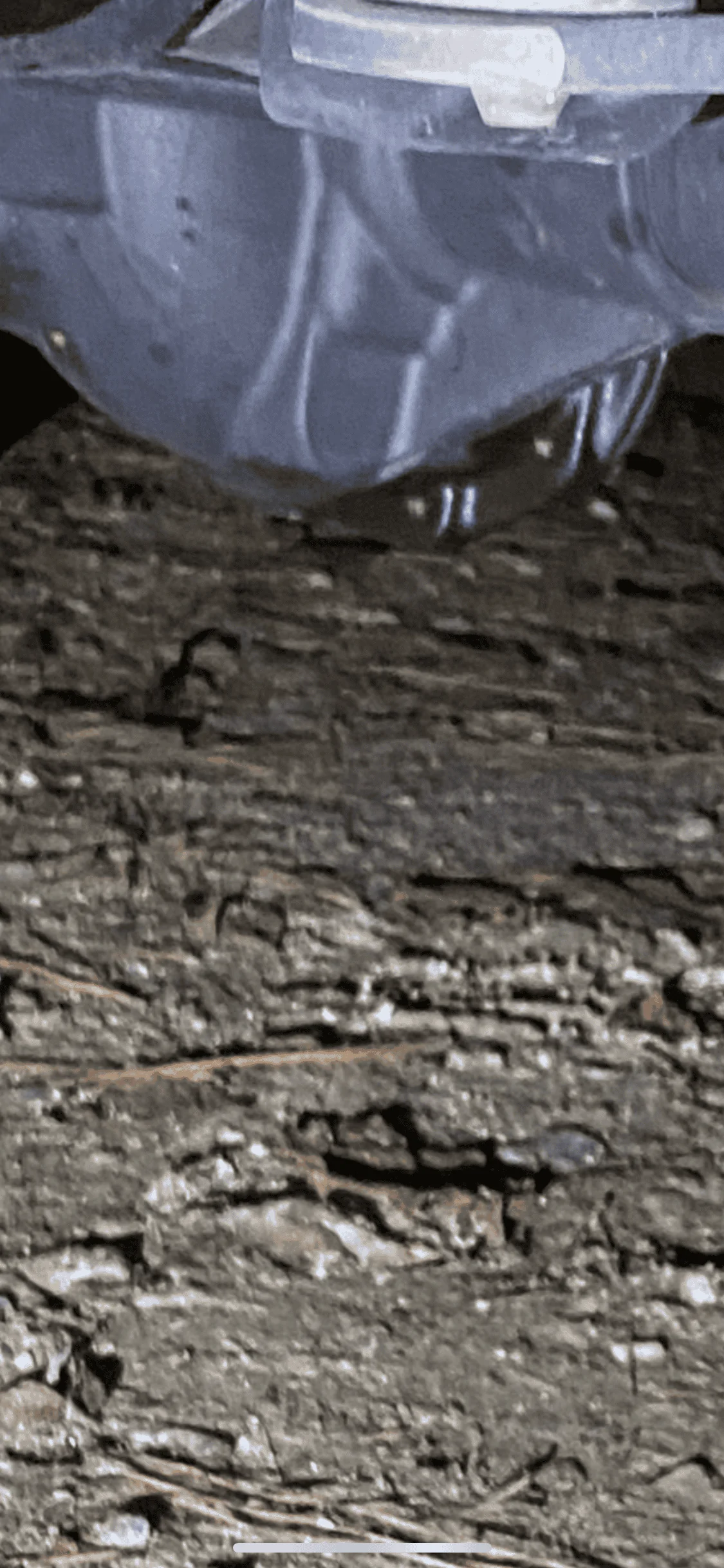

UPDATE: shop says it’s from the mechanic wiping away excess after the mess it caused from the cover removal but keep a periodic eye on it just in case.
2 weeks ago I had the rear differential changed. 2022 Ranger so no drain plug so I bought the gasket (Ford OEM) and had my trusted shop do it.
Noticed yesterday the bottom front of cover is “wet”. No fluid evidence on the ground either.
Crawled under and tried wiping it off but it’s bone dry as if they sprayed an under carriage rust inhibitor.
The rear of the cover looks normal.
Thoughts? I have sent an email into my shop to see if I should bring it in.

I would clean it real well and drive it. After that you will get an idea on if you got a problem or not

clean it and check it in a few weeks
changed mine and still looks wet just from the residual, but no leak and is clean

Not normal if after cleaning the diff it's still appearing to be leaking. I went thru this multiple times and then finally took my '22 in to the dealer, to have them repair the diff. No more leaks now.

You could probably clean it with a solvent, alcohol or brake cleaner or something to get it good and dry and clear and make it easier to monitor
