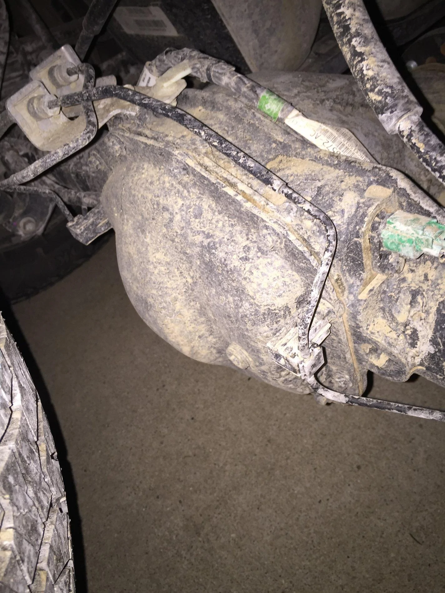

I have a post over in the water fording thread with some pictures of all the vent hoses for the ranger

Also a disclaimer before i post more, i dont particularly know a lot of practical knowledge about vehicles and transmission systems, but I have a resource with some more info on those vent hoses. The vehicle model the following pictures are from is a Ranger Lariat with the FX4 offroad package and trailer-tow.
Rear Differential Vent hose location: Looks to run just below the fuel door
Front Differential vent hose: This looks really low... I think whoever took this picture might have adjusted the hose.
Transfer case vent hose:
Transmission vent hose:
EDIT: Another picture of the front differential and that vent hose. Looks like it's supposed to attach to something else higher up
