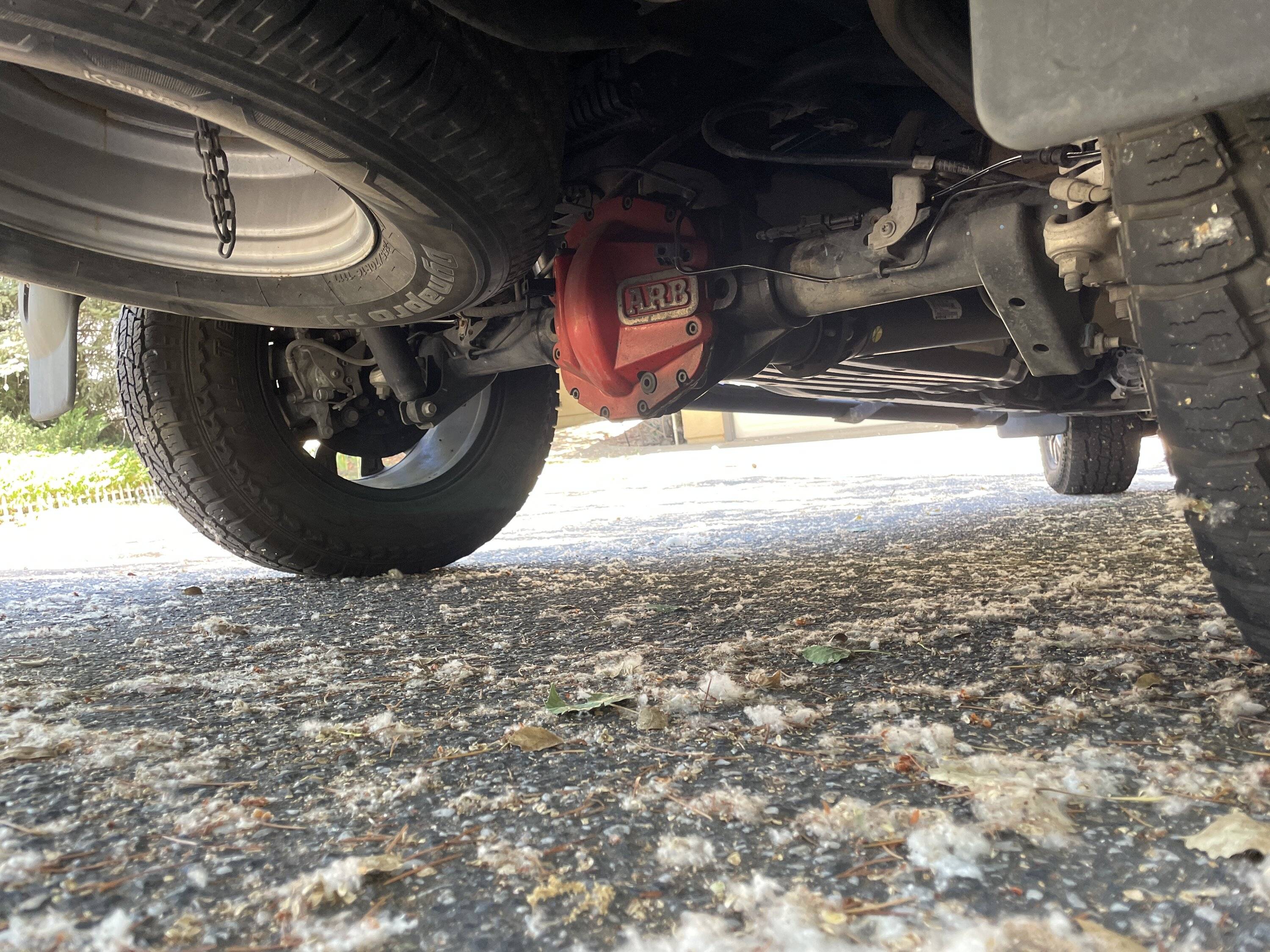

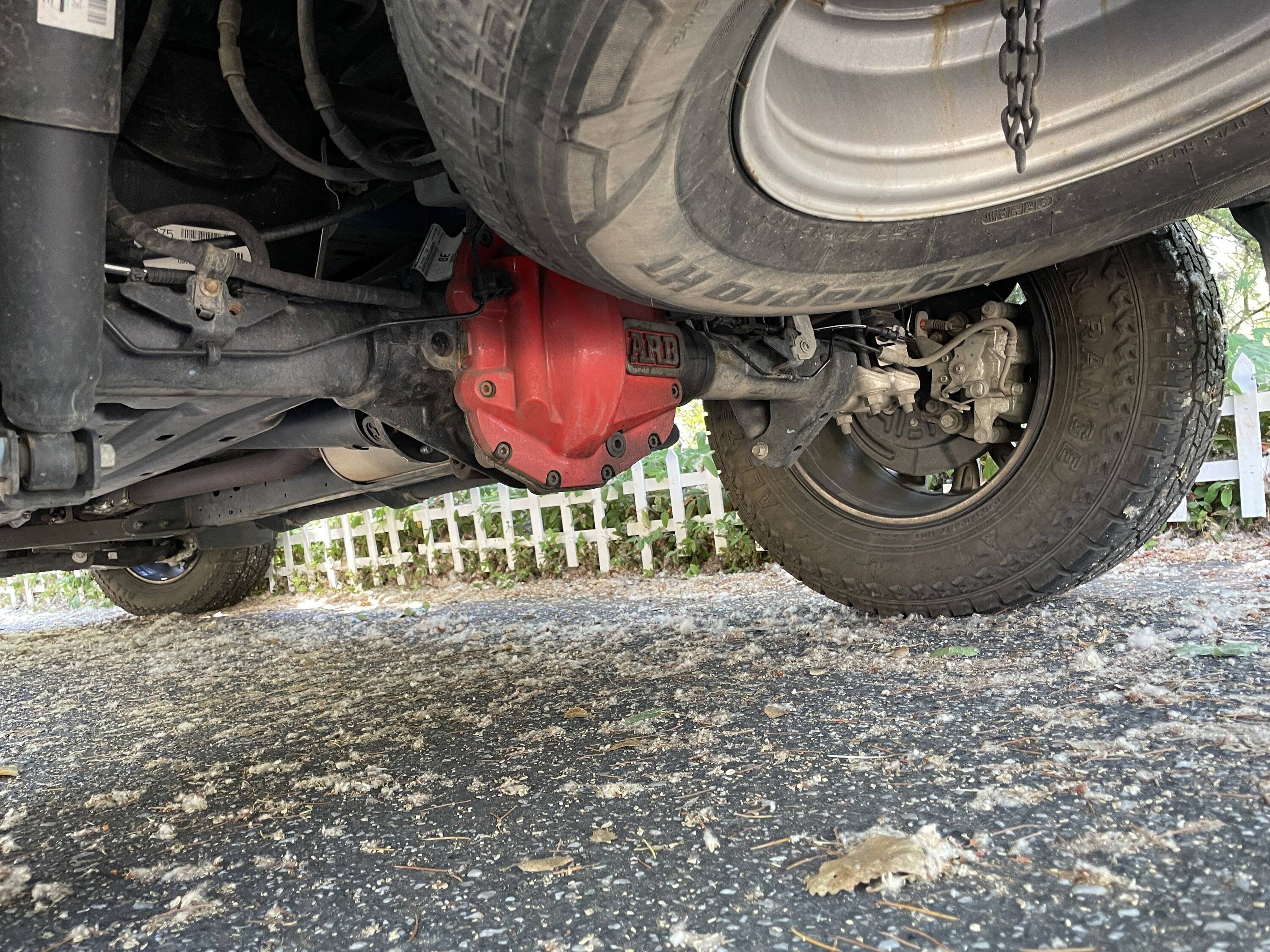

here is mine. I have ocd as I wax it when I wax my wife’s ranger. Been on since 2021 I understand what you’re saying about the brake lines. I’m one of the lucky ones that got a hole in my xj d44 cover and it leaked out over and I ruined the gears and bearings in the rear. Maybe it just my luck.
Wow the underside of that truck is cleaner than my kitchen.
haha ? thanks. I detail all my cars twice a year and I spend two days on each one. one day on the underside and the other on the inside and outside.
