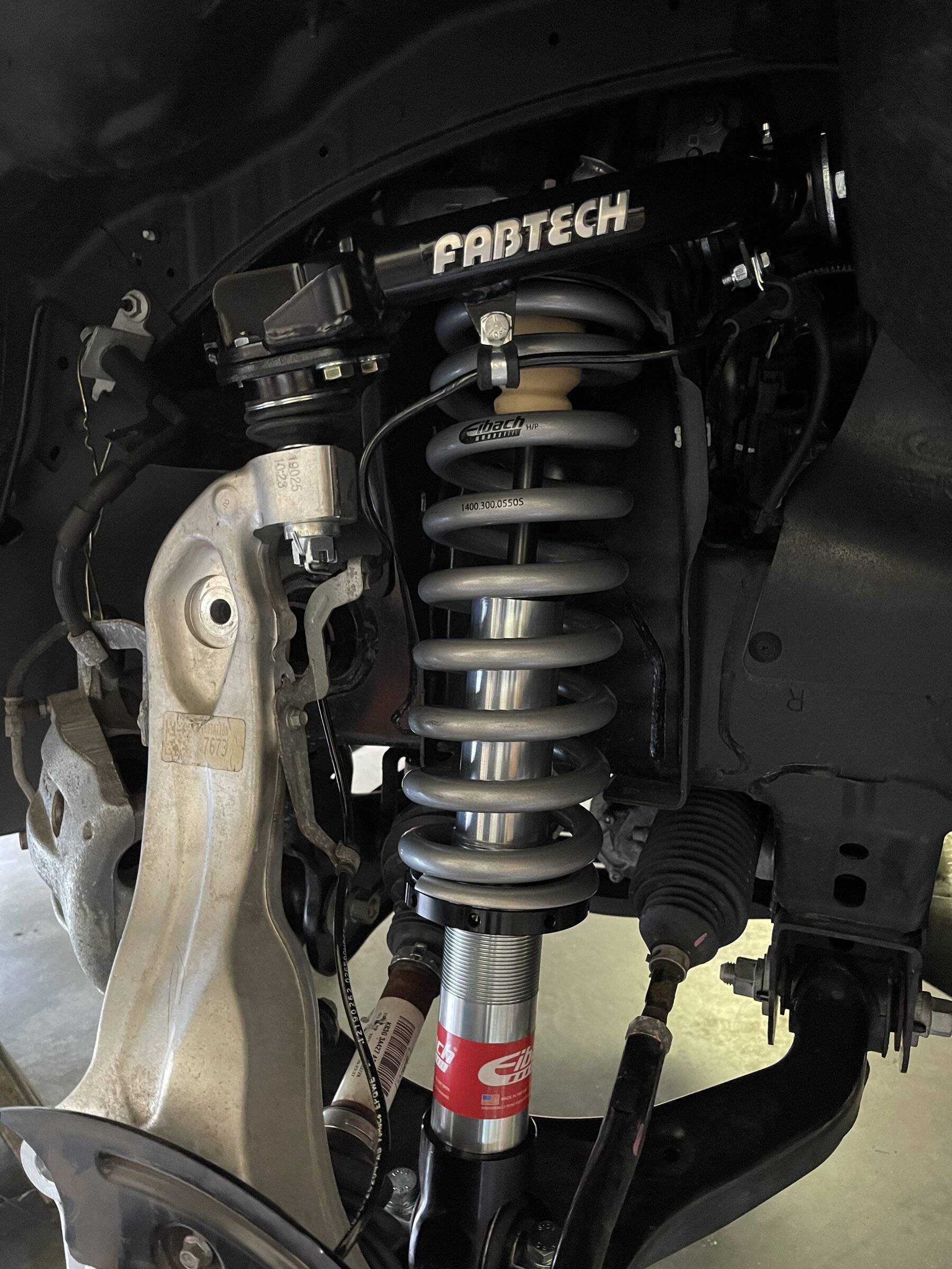

You also need UCA’s to correct suspension geometry and prevent ball joint bind. I have the Fabtech UCA’s, Eibach pro 2.0 Adj coil era set at 3.5 inches.
People need to invest in UCA’s if they really want a correct setup.
You only "need" a UCA if your new coils are 2.5 inches in diameter. Fox 2.5 kings, icons all require a UCA. If you do order a UCA make sure to check if you have aluminum or steel knuckles. Camburg and Total Chaos send parts for both knuckles so you're safe with them. Icon is not making for steel yet.

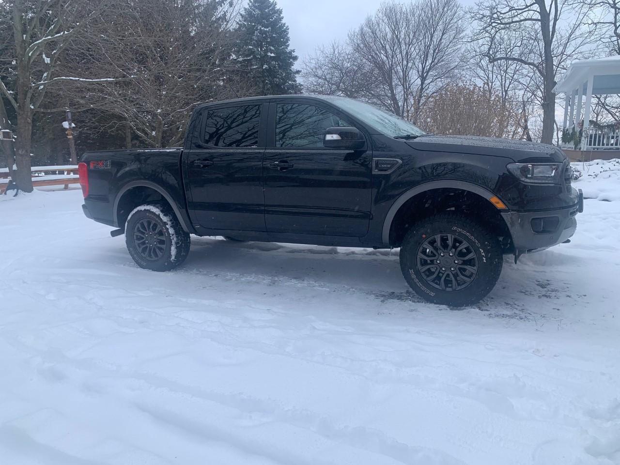

Just had Fox 2.0 Coilovers (non-Ford Performance version - the normal ones) installed this past Friday and I'm so glad that I no longer have the FX4 suspension (the nose dive is gone with braking).
I left the coilovers at the height that they came at and it looks like I got about 2" of lift in the front from them (haven't measured to confirm). No aftermarket upper control arms were installed and the shop that installed it was able to align it at that height.
Tires: Goodyear Wrangler Duratrac 255/75/17 - stock wheels. I also fit one of these in the spare tire area without any issues for clearance.
Super happy with the look and feel of the new setup. Sharing this just in case anyone is unsure if a certain tire size will fit with a certain lift.
