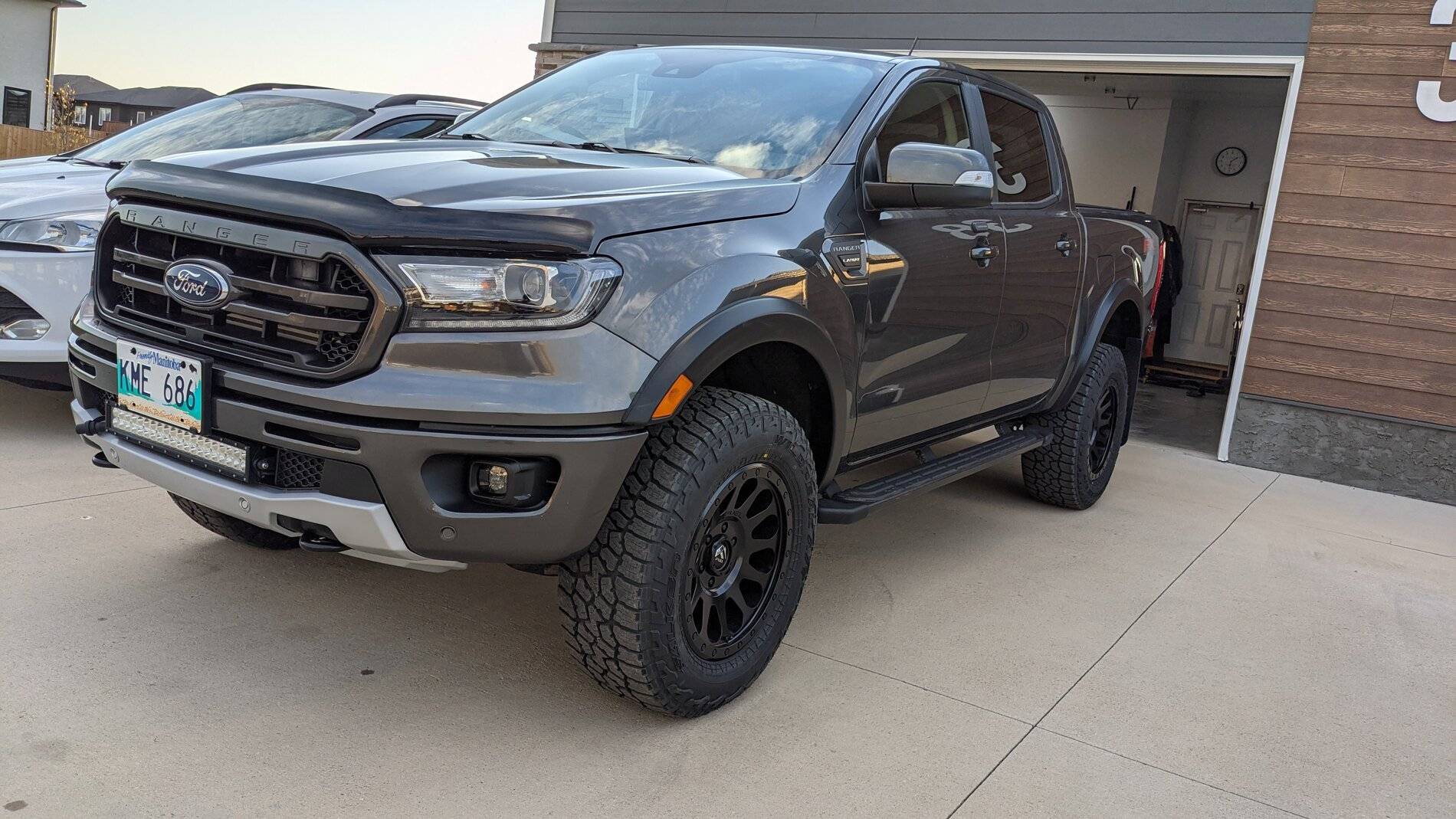

Never have had Duratracs before, but I went with these because of the weight relative to other all-terrains in this size (255/75/17) with an aggressive tread pattern.
Very happy with them after about 500 miles of driving thus far, though I think they do not perform as well as the stock tires in the rain as I accidentally broke traction during a hard downpour while getting on the highway (I had never had this happen before with the stock tires).

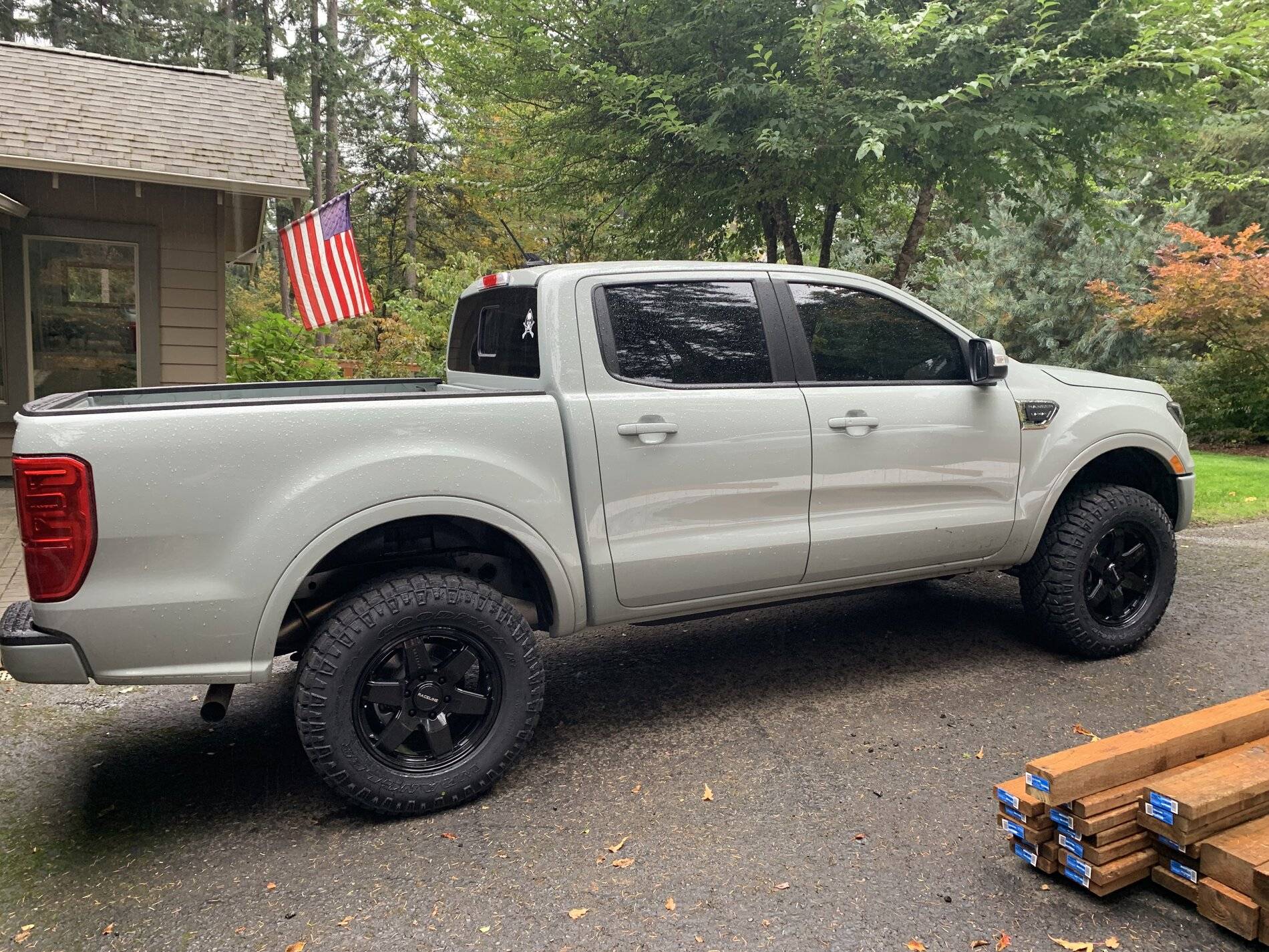

2.5 loaded struts with 275 65 18 dura tracks raceline wheels

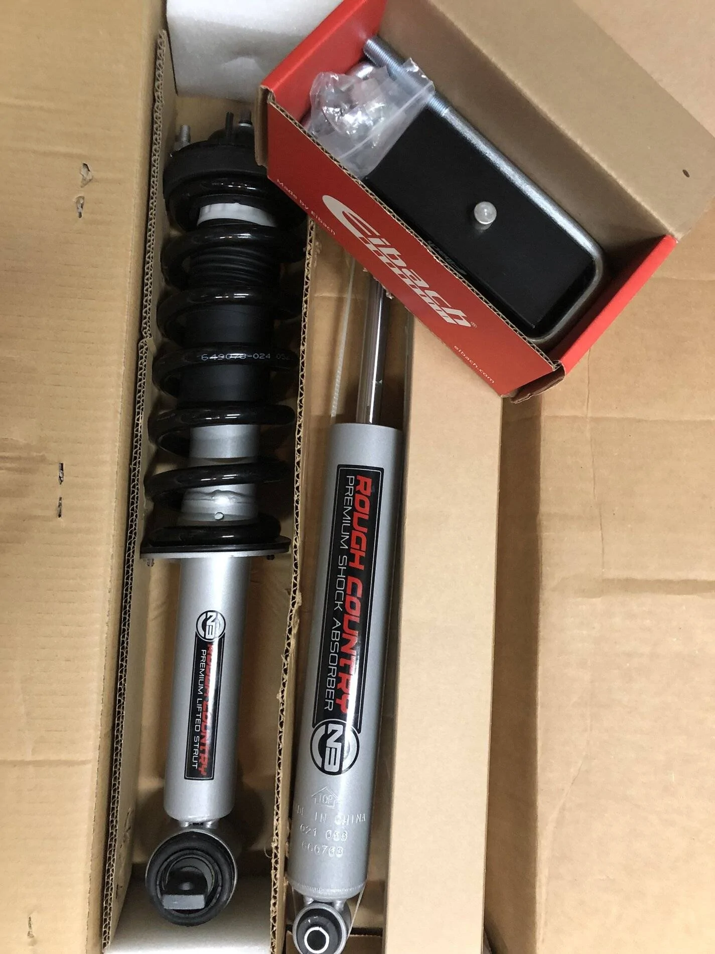

Dan, I've got the RC 2.5in leveling struts, a set of 0-1in RC shocks for the back, and event got a pair of 1in block from the back (just in case). I'm already running 275/65/18's, but there's just a smidge of rubbing up front at full lock, so we're gonna go up a little. Planning to do the install this weekend, any tips?

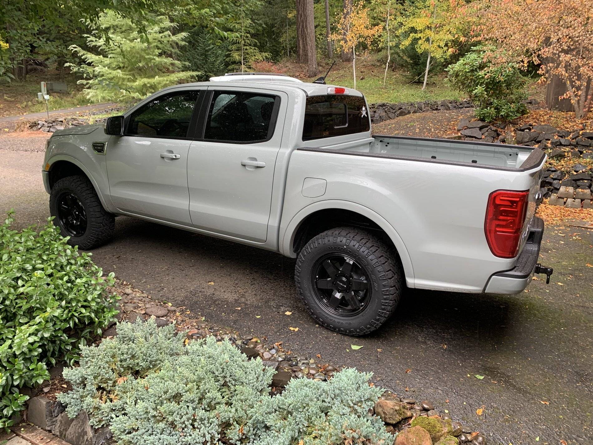

I finally got it done today! Took about two hours to do the first one, and only an hour to do the second. And I did pull the axles (per the instructions). Put it all back together, tightened everything, but on the test drive I sometimes get what sounds like a metal on metal ‘clunk’ going over pot holes (I live on a dirt road). Checked it all, still tight, wondering if it’s possible the lower control arm hittin the sway bar end during sudden compression. Thoughts?

I have not experienced anything like that, sounds like something might not be fully seated, did you check the upper struts ?
