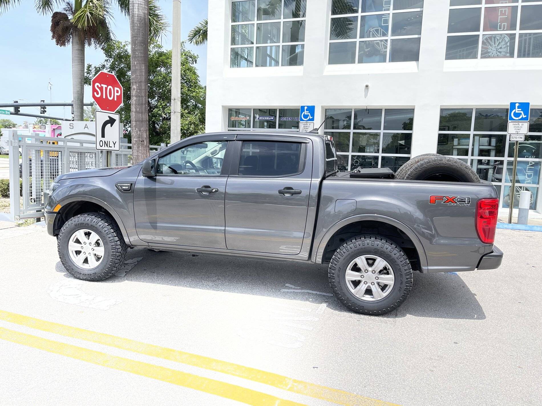

FactionFab 2.5 inch level kit....265/70/17 nitto ridge grapplers...still have crash bars, no rubbing
Do you have a head on view or down the side look (stance)

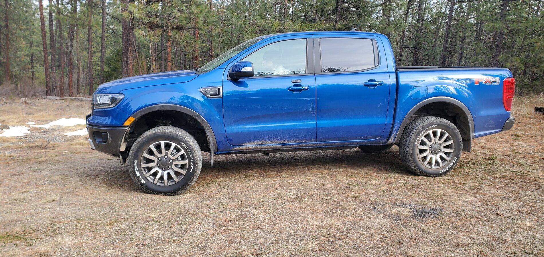

Eibach pro truck coilovers..
Still waiting on the rear shocks and rear blocks to arrive..
Hoping to get alignment and tires tomorrow..
Hoping to fit 275/70r18 under it..
If those dont fit I'll go 265/70r18s..
Progress..
Waiting for the running boards too..

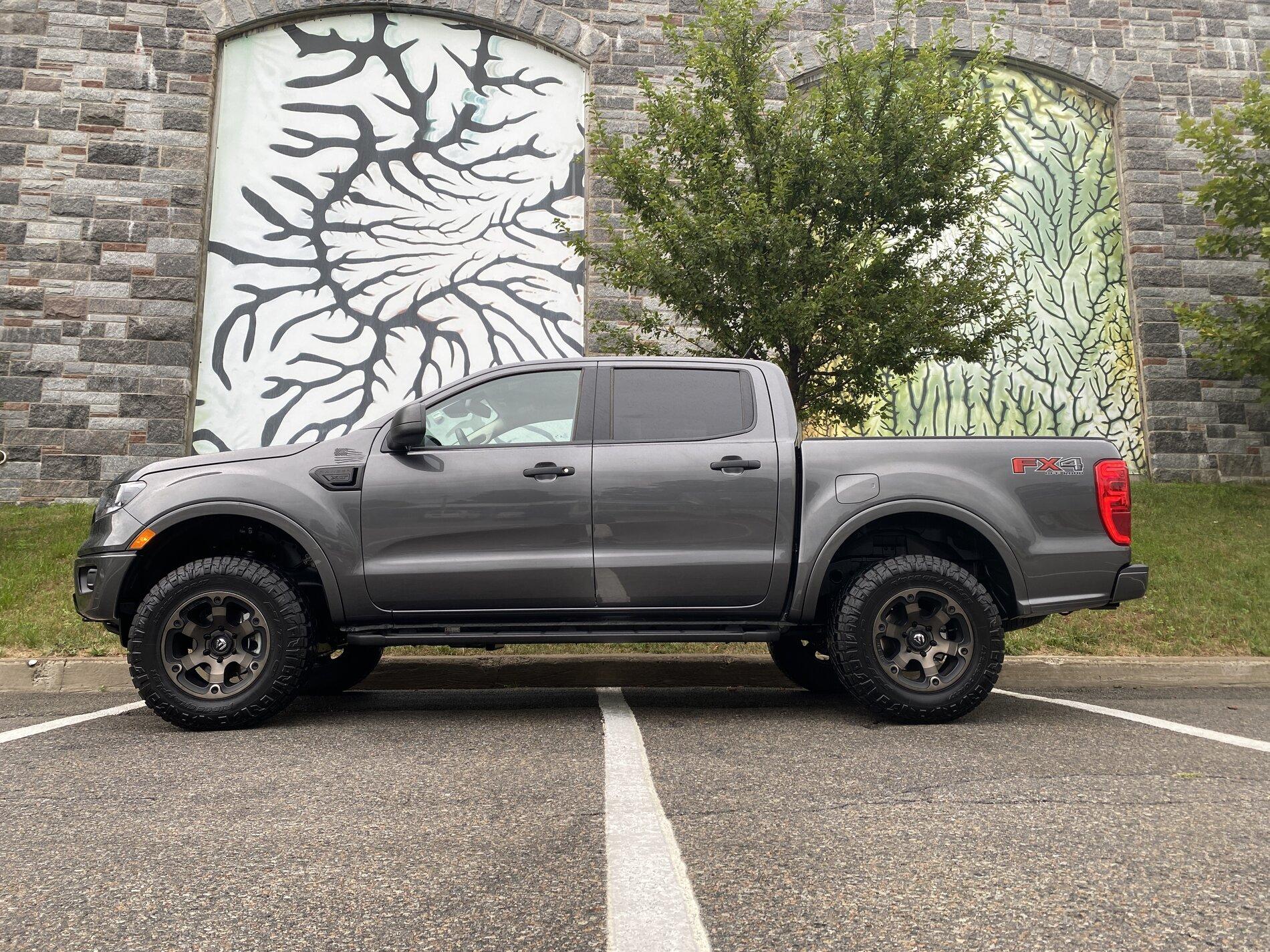

Just had Fox 2.0 Coilovers (non-Ford Performance version - the normal ones) installed this past Friday and I'm so glad that I no longer have the FX4 suspension (the nose dive is gone with braking).
I left the coilovers at the height that they came at and it looks like I got about 2" of lift in the front from them (haven't measured to confirm). No aftermarket upper control arms were installed and the shop that installed it was able to align it at that height.
Tires: Goodyear Wrangler Duratrac 255/75/17 - stock wheels. I also fit one of these in the spare tire area without any issues for clearance.
Super happy with the look and feel of the new setup. Sharing this just in case anyone is unsure if a certain tire size will fit with a certain lift.

Never have had Duratracs before, but I went with these because of the weight relative to other all-terrains in this size (255/75/17) with an aggressive tread pattern.
Very happy with them after about 500 miles of driving thus far, though I think they do not perform as well as the stock tires in the rain as I accidentally broke traction during a hard downpour while getting on the highway (I had never had this happen before with the stock tires).
