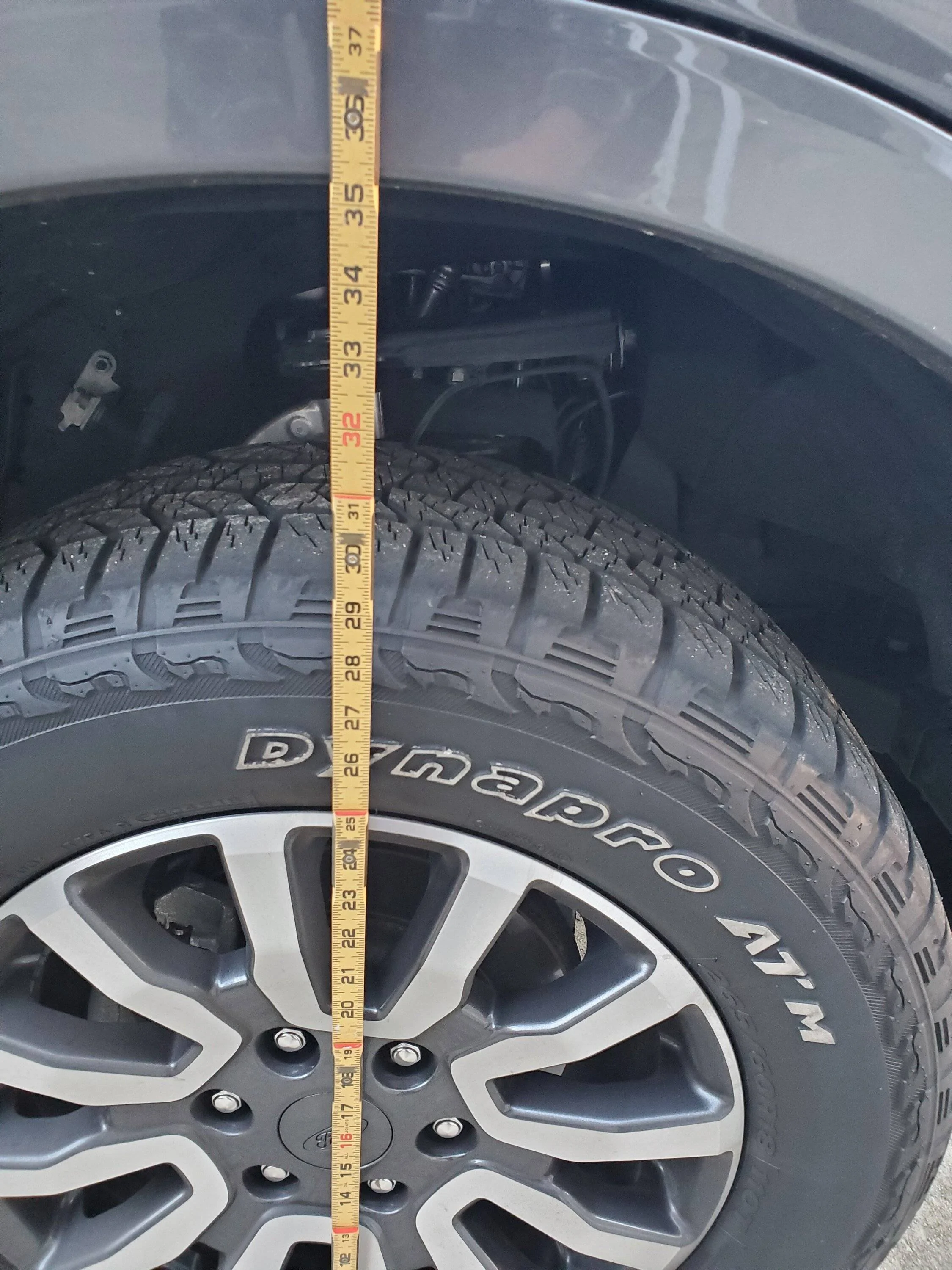

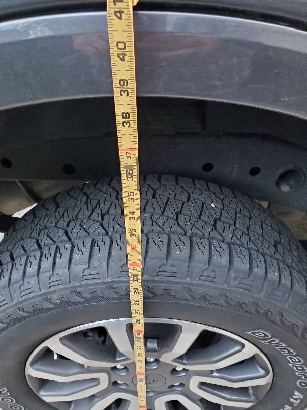

Does anyone have measurements from either the ground or the center of the hub to the bottom of the front and rear fender for a stock FX4?
Recently purchased a 2020 Lariat FX4 that has some sort of either leveling kit or lift kit. Currently front and rear are measuring around 37.5" from ground to bottom of fender with stock Dynapro tires.
I have the stock wheels and tires. On the rear, I have Fox shocks. I just measured it at 37 3/4. I have Eibach coilovers on the front that are set at one inch. Front now measures 37. Based on your measurements, I would guess the front has been leveled.

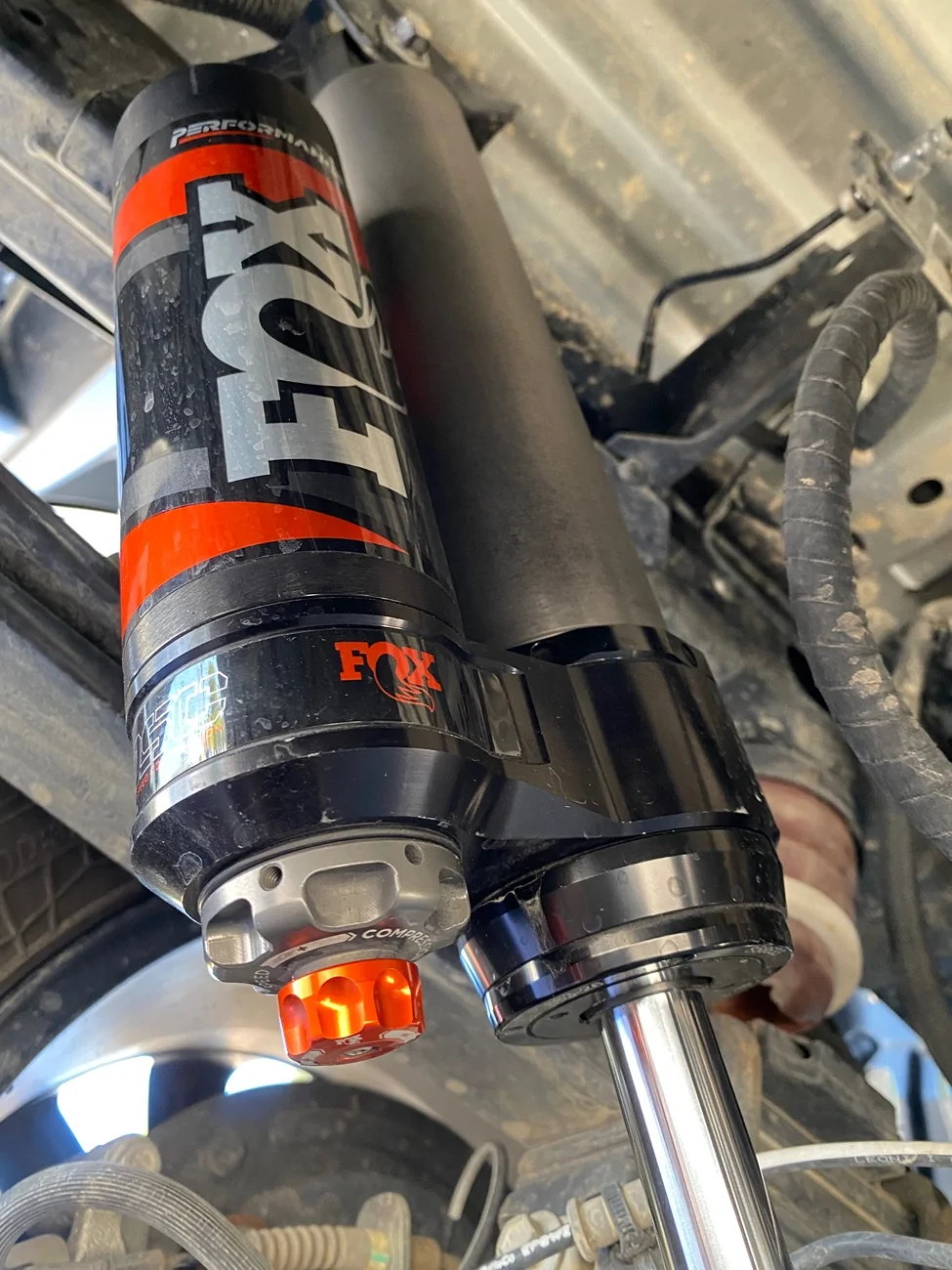

So Eibach's Pro Truck rear suspension for the Ranger comes in two flavors: one with a reservoir and one without.
Is there a particular reason the reservoir would be the better way to go? i've always thought the reservoir systems were a bit extra for anyone who isn't jumping a vehicle. Curious if that thought holds true in this case as well.
Whiplash
Kern
Oct 17, 2021
270
846
The southwest Missouri Ozarks
2021 Ranger XLT FX4 / 2004 Mazda RX8
The remote reservoir are for added oil capacity......More capacity and better cooling = Longer life...Heat is what kills
the seals....Don't have to jump , just washboard roads will elevate temp...

2019 Ford Ranger XLT FX4
i'd never considered the reservoir as a longevity thing. good to know. thanks so much, that was a TIL!
