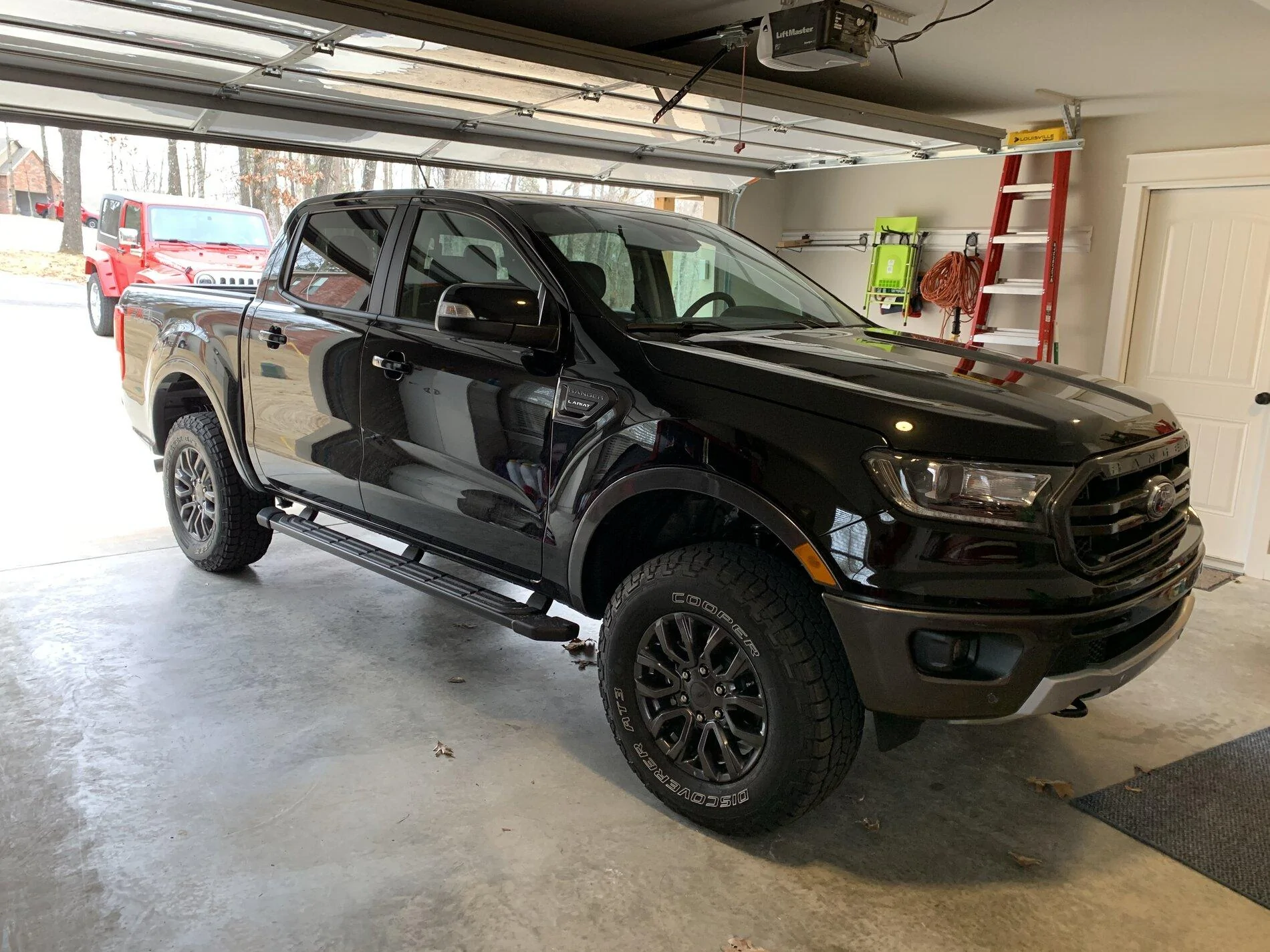

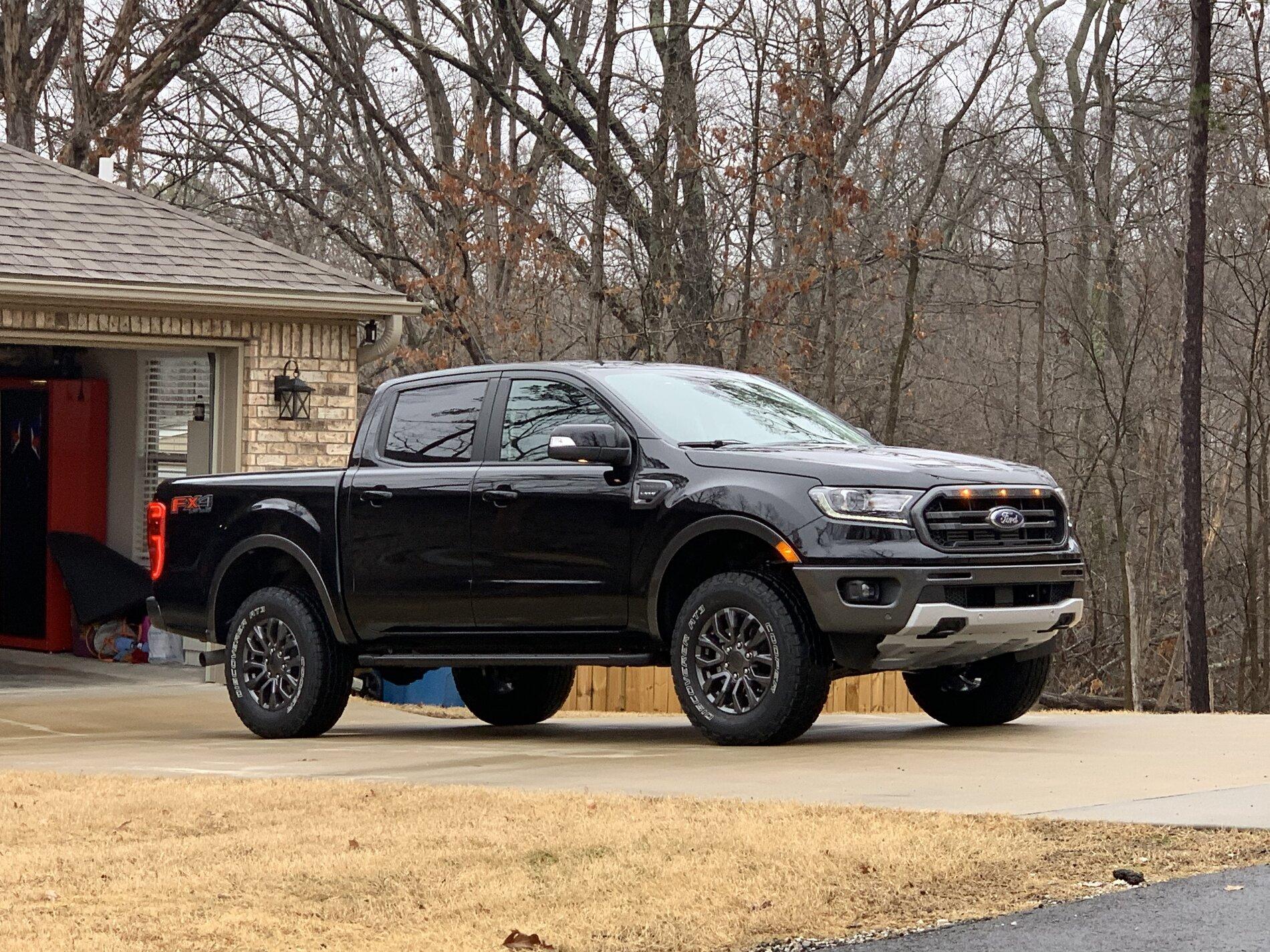

FactionFab 2.5 inch level kit....265/70/17 nitto ridge grapplers...still have crash bars, no rubbing
Looks great! Did you have 17" wheels to start with? I have 18" but willing to go to 17 18 or 20 for the right look and no rubbing.
What are your rims dimensions? (Width and any offset?)
i had 18's but i like the way 17's look better with a beefier sidewall. wheels are 17x9 et 19.
Et 19, is that a plus or minus 19?
