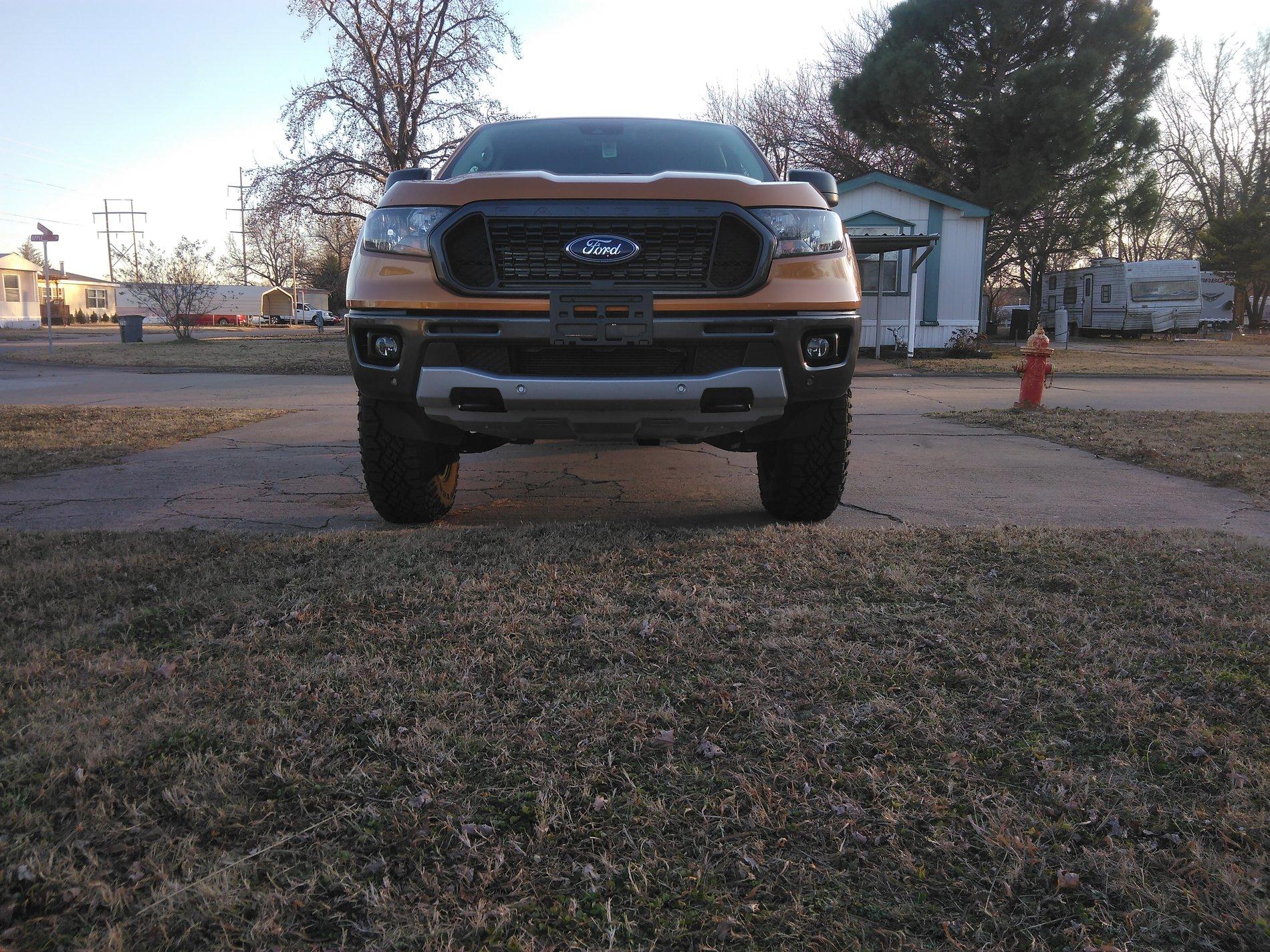

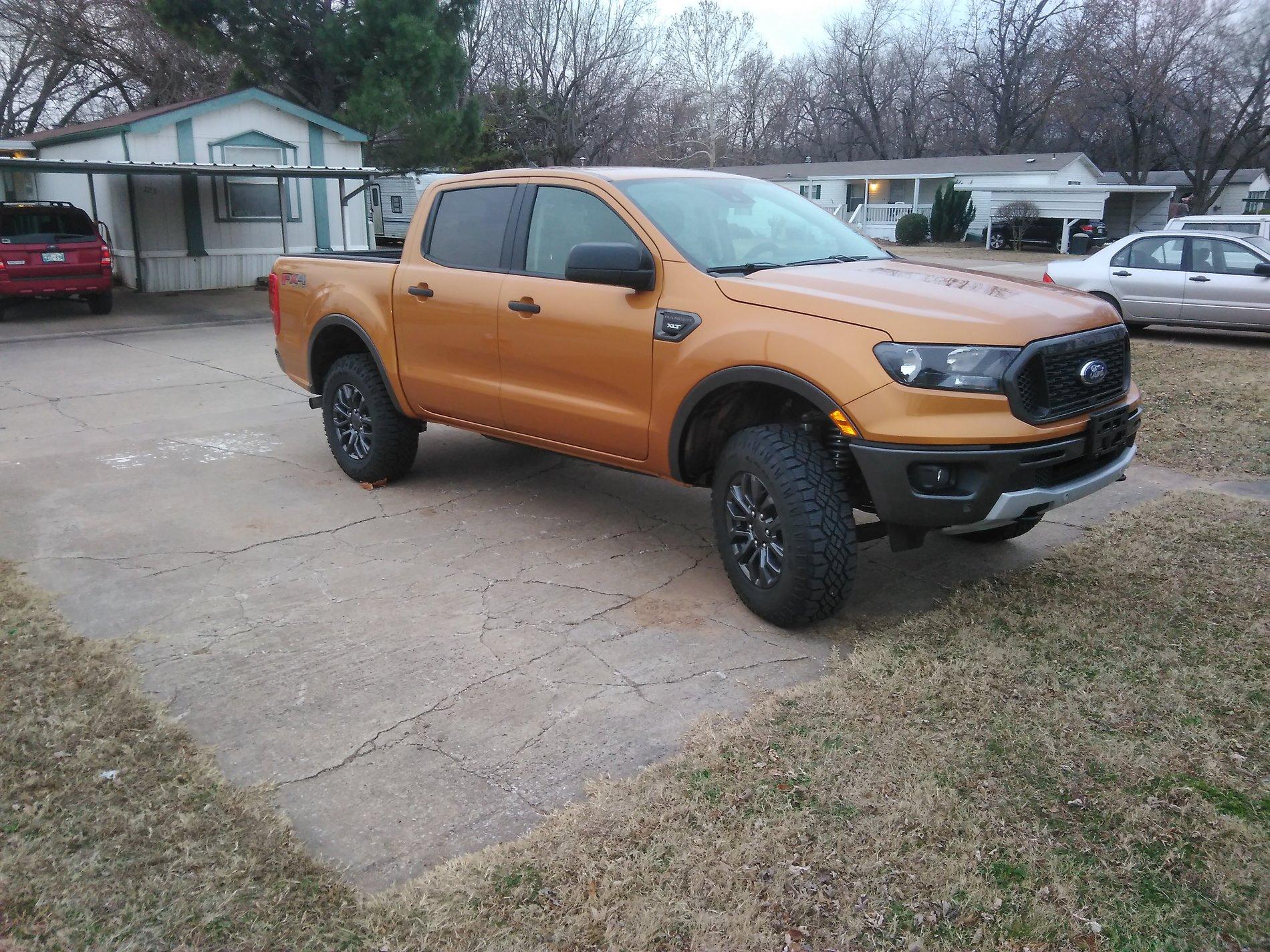

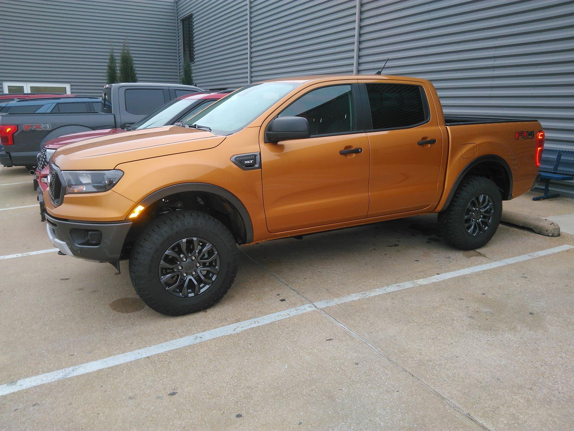

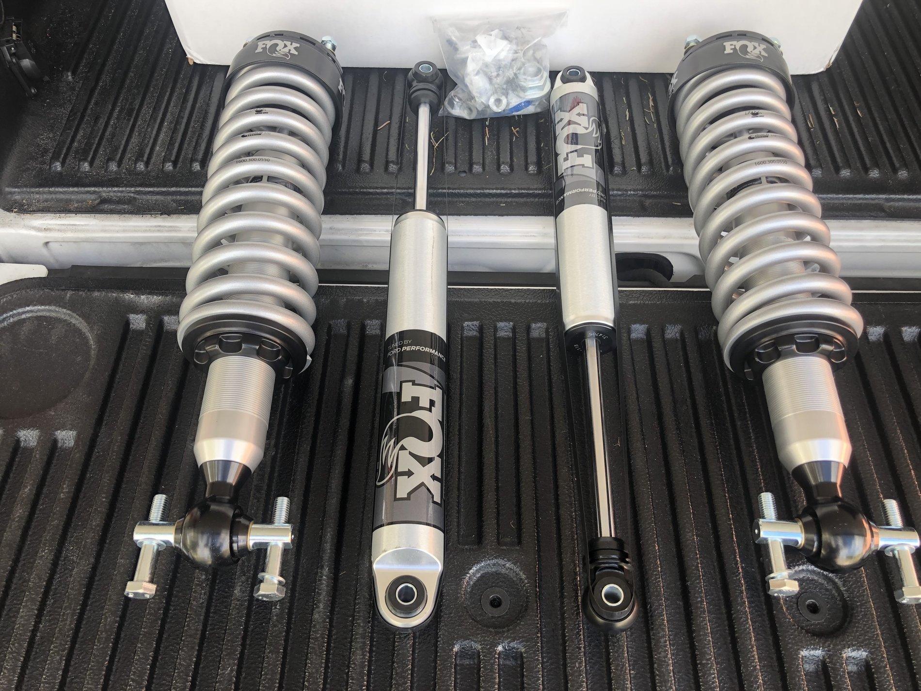

Just picked up my truck today after getting the Ford Performance Level kit installed by the dealer and while I only drove it a short distance home the difference in the ride is very noticeable. Ford even let me use my Ford Pass points to cover some of the cost. I think this upgrade was well worth what I paid. Can't wait to get it on the trails.

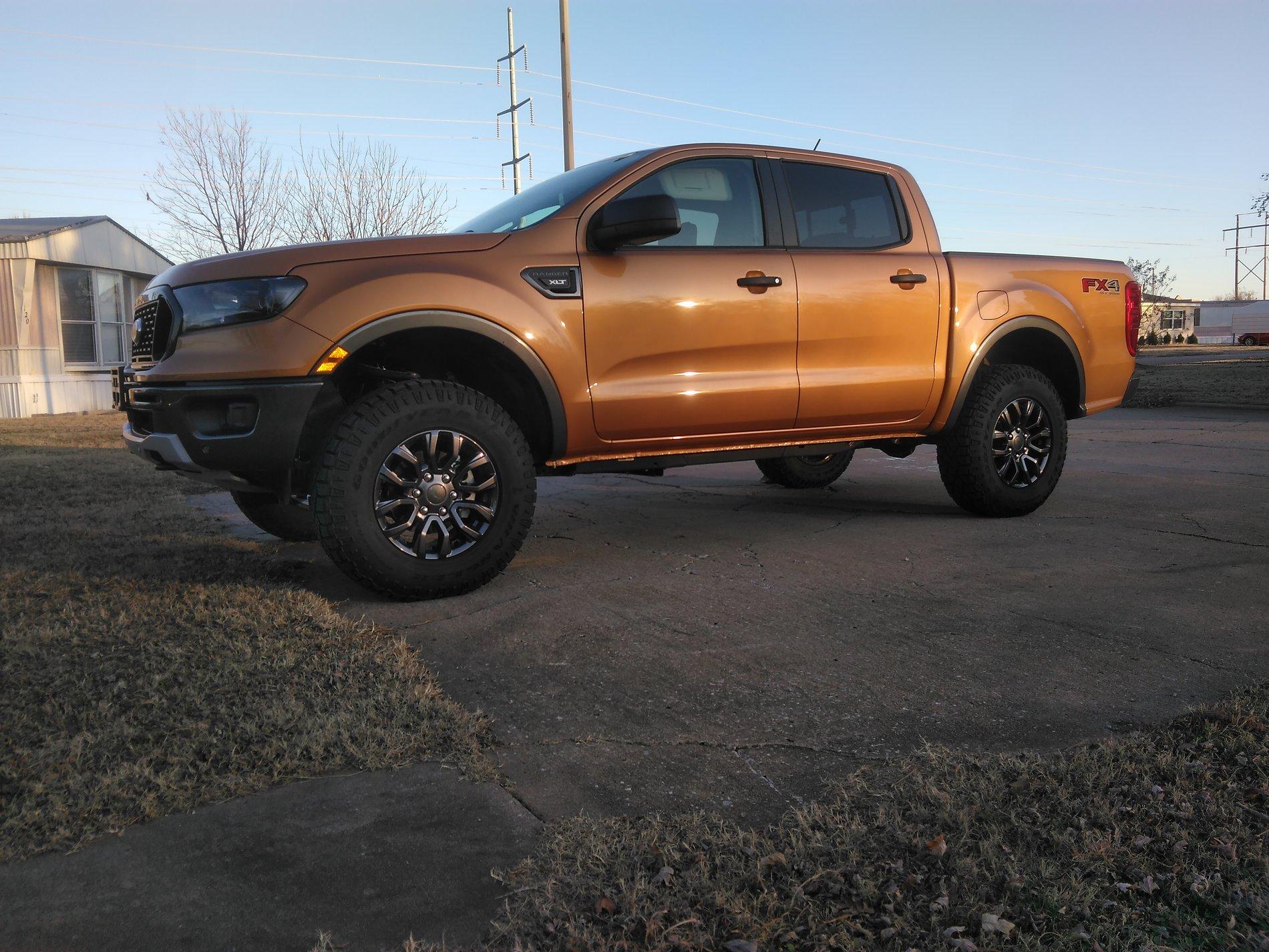

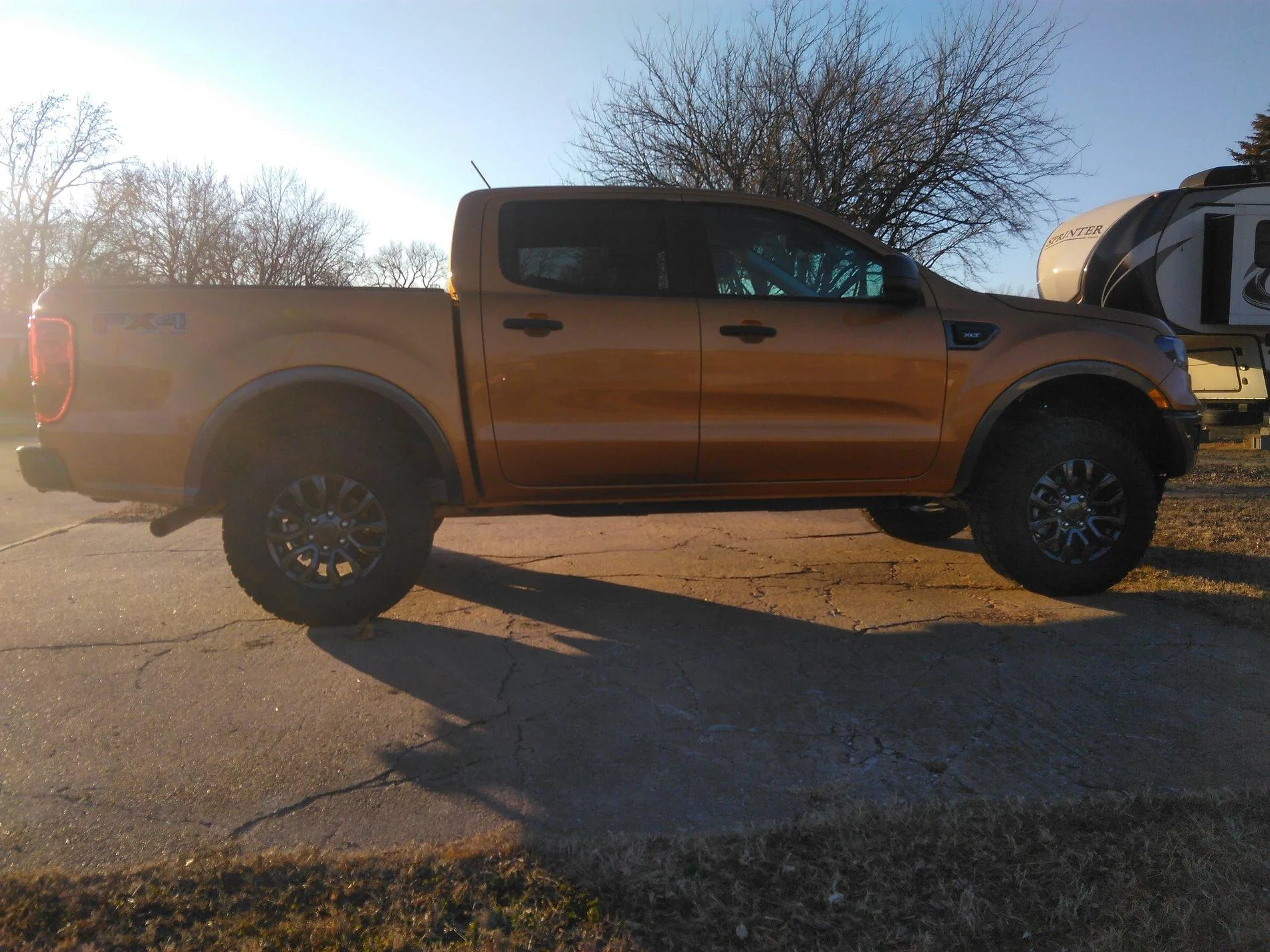

Looks great. Can we get a straight on side shot? Is there any rake left?

These are 255/75 17s. Could probably go a little taller with the level kit but I think these are about perfect for the Ranger.

To me it looks like there is still a little bit of rake on my truck but could just be a figment of my imagination. Front coil overs are adjustable so if I wanted I could go higher down the road. I'm sure the dealers have some sort of height guidelines to maintain the warranty.
