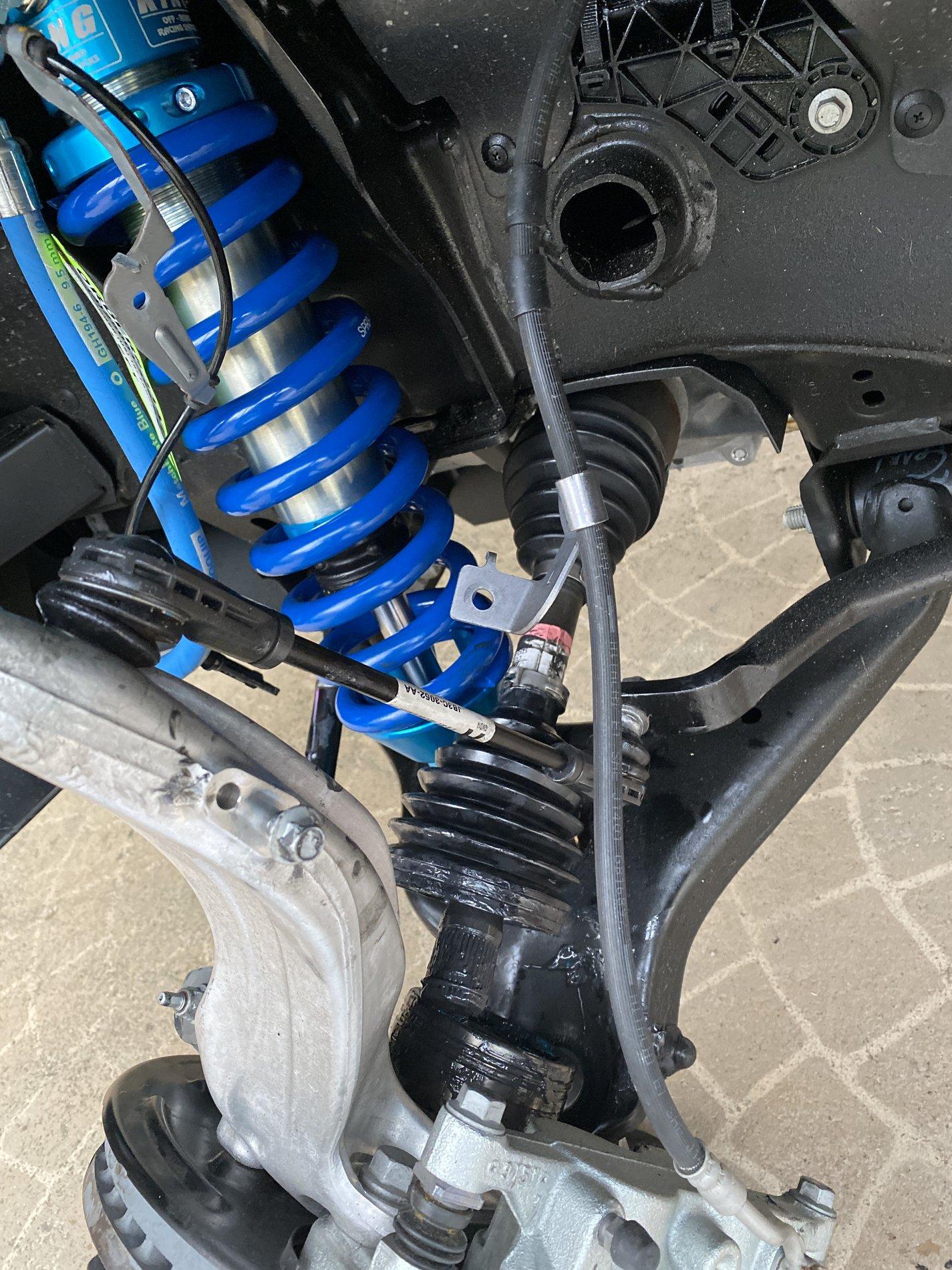

I just popped mine out today. I'll let you know how hard they are to repair
Yours popped out while installing this kit, what do you think you did wrong? Or came out for other reason?

I would recommending removing the 35mm nut and removing the CV shaft from the hub. Makes install much easier by reducing the possibility of accidentally popping out the shaft from the hub carrier or shaft boot. It gives you the room needed to remove and install the new strut/shock. Use an impact to put it back together. The image shows my setback and I learned my lesson for the other side. This side took 2hrs to swap while the other took 35min.

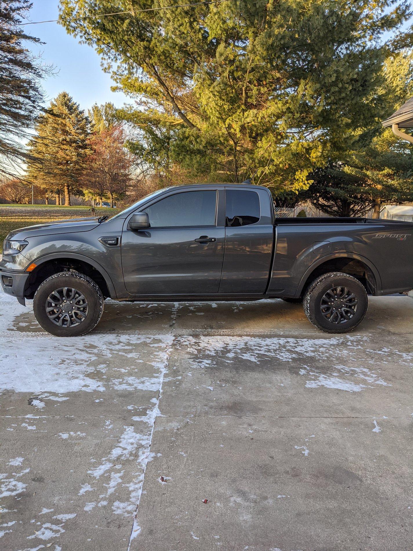

Just got my coil over level put on yesterday. Ended up ordering from Stage 3 Motorsports since it's the same parts. Loving the new ride height in cab vs stock and the improved ride over the bumps on the Michigan roads.
Thanks, so i wonder if ford is doing this better procedure when they are installing the ford kit!
if you look at the ford install instructions it says to do it that way. Also shows how to realign the front sensors.

Looks great. Can we get a straight on side shot? Is there any rake left?
Rick, two-inch leveling leaves just a slight forward rake, which is just exactly right, in my opinion....
