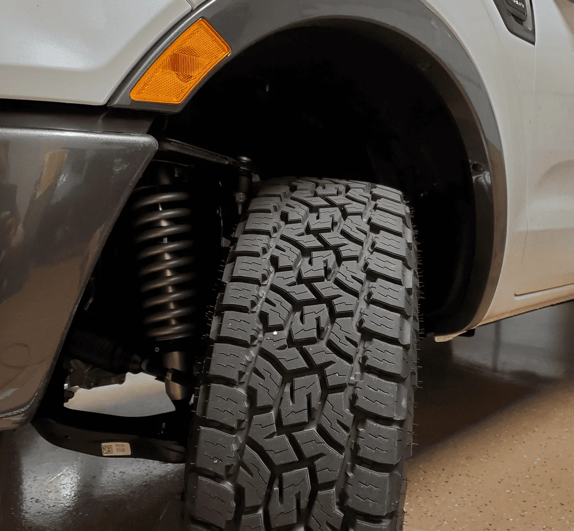

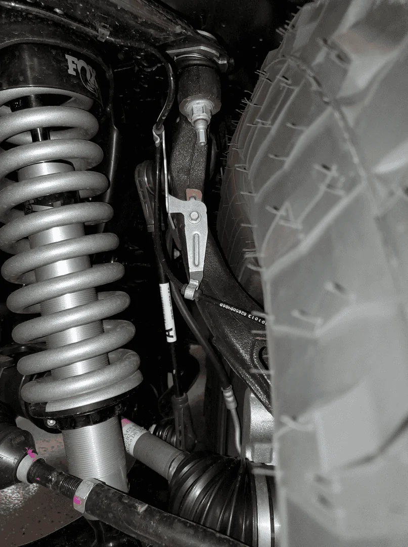

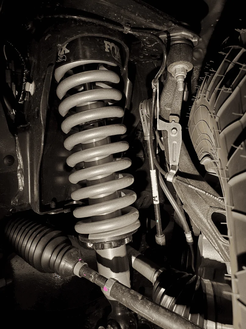

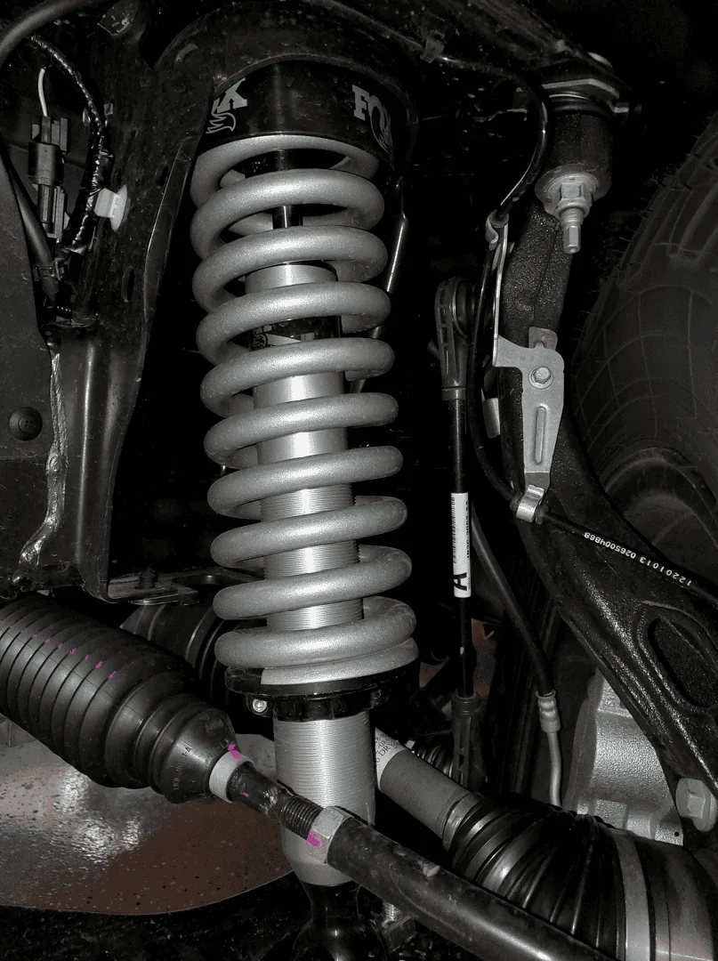

Pics of Ford/Fox 2.0 kit (only front shown)
really nice, I will mount my fox supension kit next week, how do they perform ??? on and off road ??? did you see a huge difference with the factory suspension ??? tks

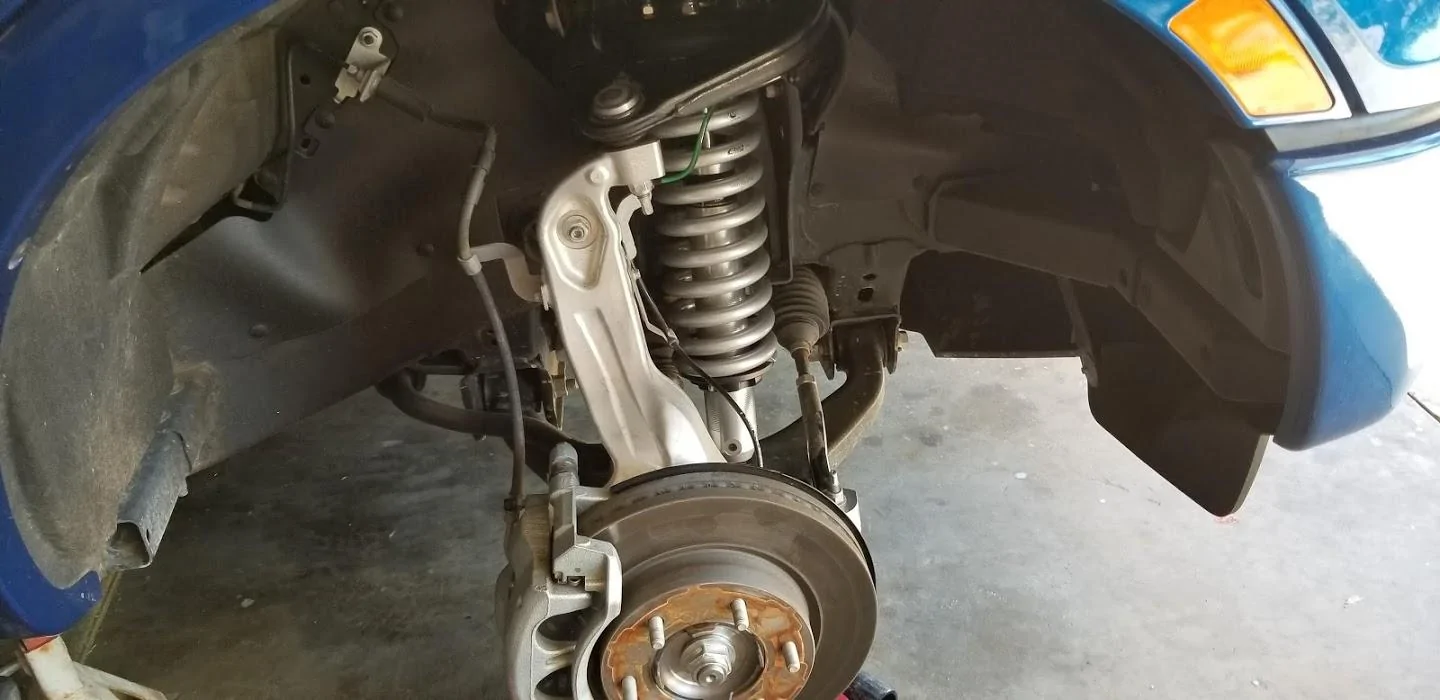

Only added the Ford/Fox 2.0 Leveling Kit. Everything else is stock.
They appear to be black crinkle powder coat on them, every other picture I've seen here that are just aluminum color like mine.
Metalshift
Dec 24, 2019
91
166
Vancouver Island, BC
2019 XLT
Those are definetly cast steel and hollow. Look closely at the pictures. You can see the rust. I wonder why Ford changed the material. I wonder what else has changed.

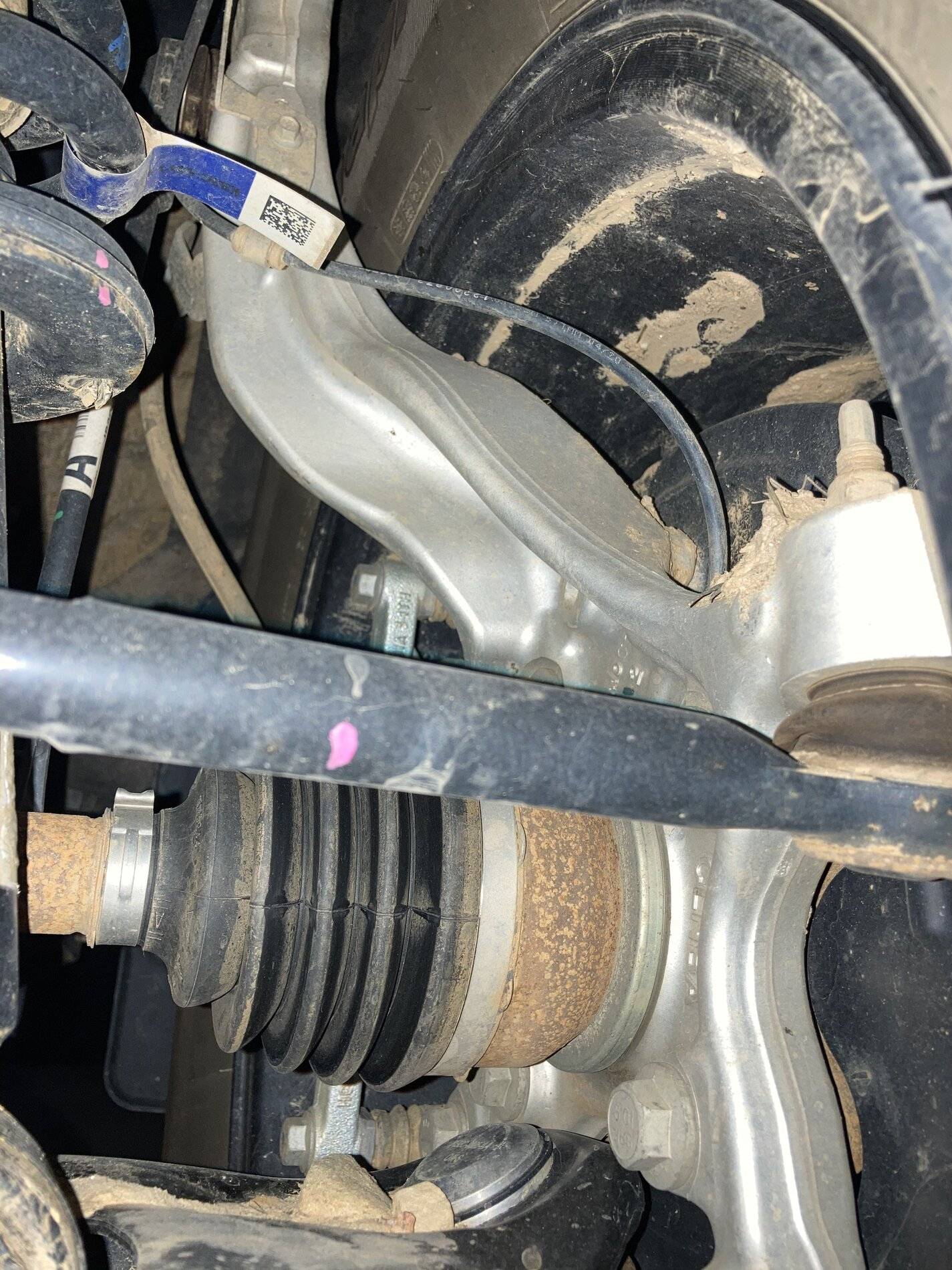

Hey can someone verify that I'm looking at an aluminum knuckle/spindle? Obviously a newbie to working on my own stuff and want to make sure before I try to fit some new UCA's on.
Thanks!
Thanks!
Yes it looks like an aluminum one. They went over to the cast steel ones late 2020. My build is 11/20 and I have steel. What year/build is yours? That’s how you can tell for sure
Thanks, finally went and found the build date of 03/20. Reading all the posts it seemed a lot of the 20's were steel so I started trying to figure it out, I guess I was early enough to get the Aluminum, which is good since I didn't see the note about the change in spindles until after I ordered the Fox stage 2 kit :facepalm:
Pretty sure the change over happened mid year 2020. You lucked out!
I can change over my steel for aluminum ones for $250 for the pair but I better have new UCA if I do decide to go that route later myself.
