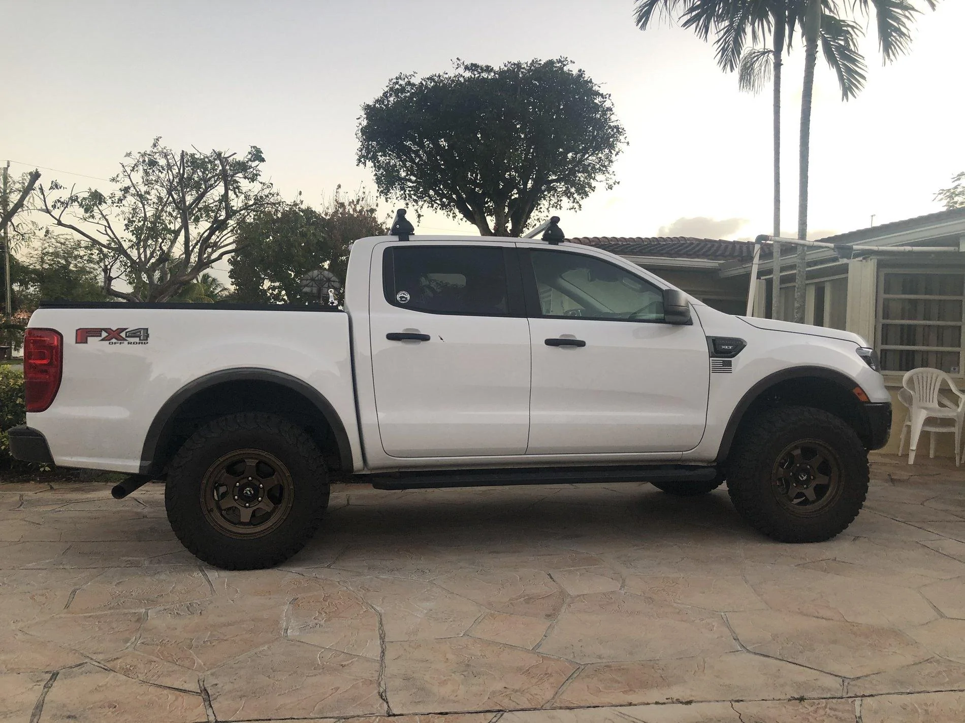

Just drove my FX4 home from the installation of the Ford Racing/Fox lift kit. So far, I'm very pleased with the more planted, stable, less wallowy (is that a word??) and bouncy ride up front. Rear feels about the same - that is to say a little bouncy over speed bumps, but overall, I'm very pleased. Way more clearance for the trails in Colorado and California this summer. Woooooot!! Sorry for the low contrast, dark pic - just got home. Better pics tomorrow.

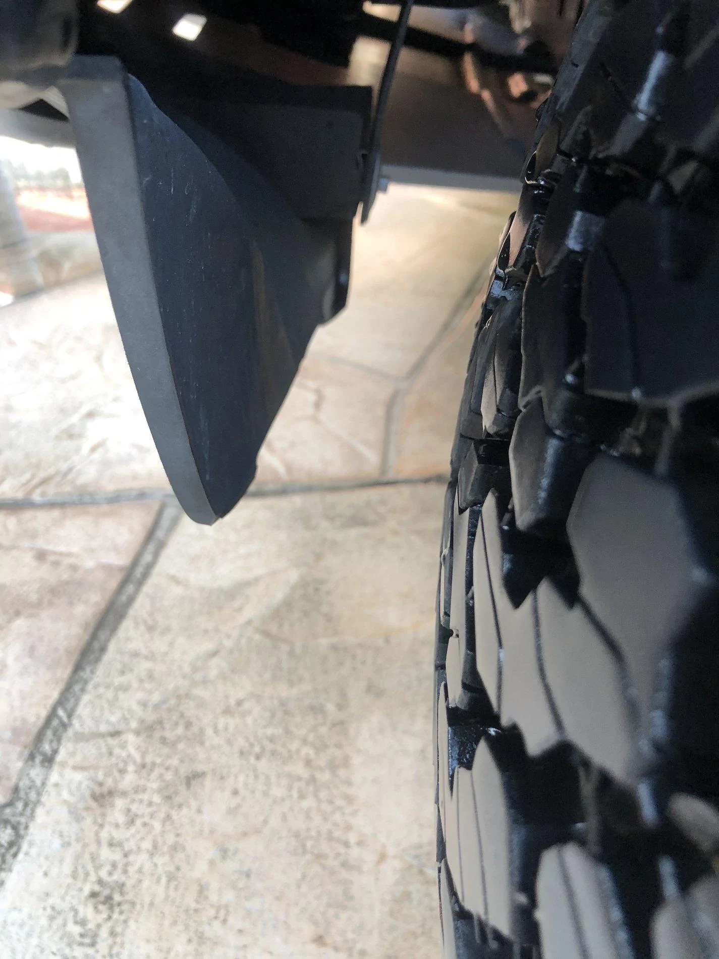

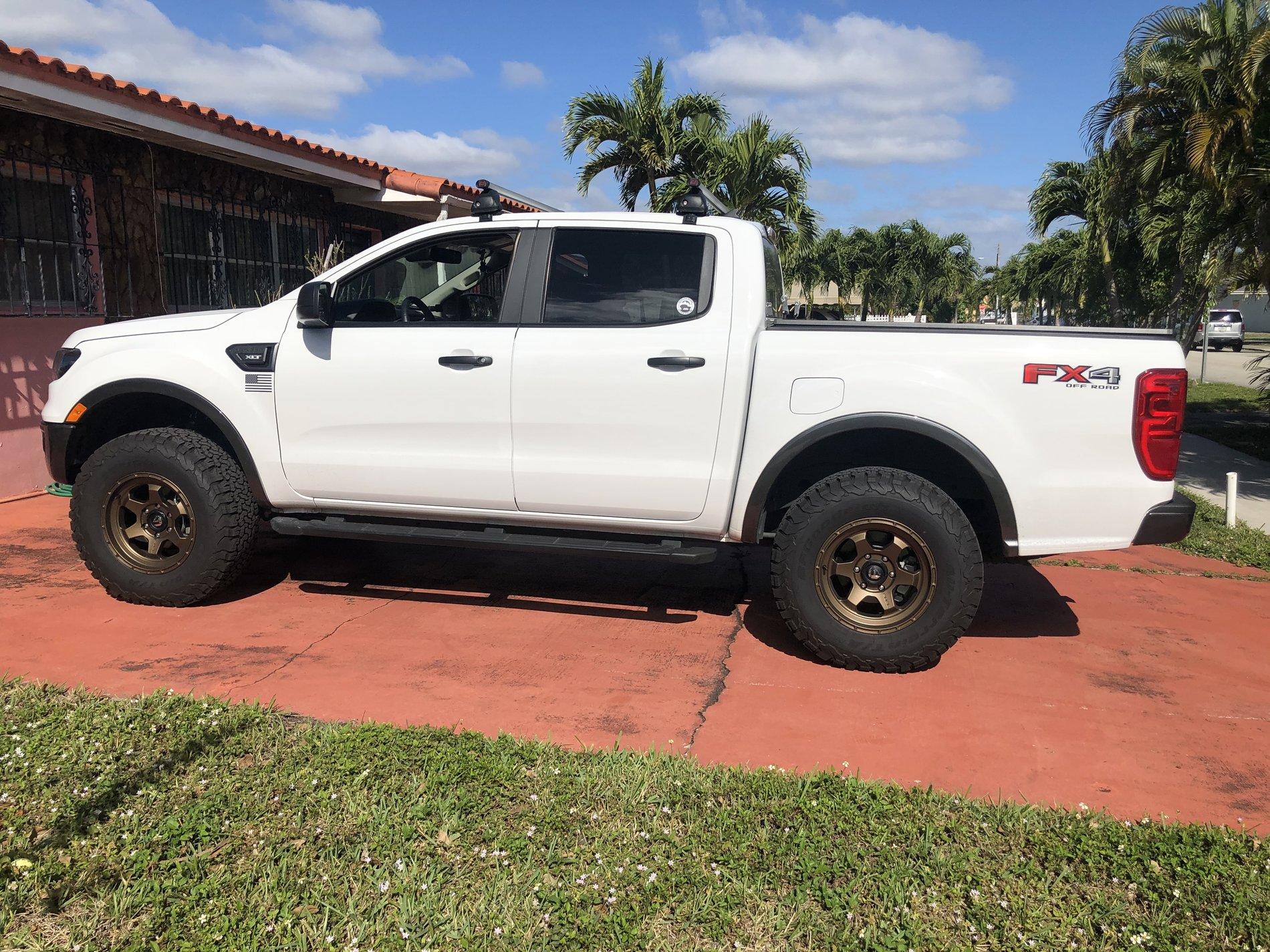

Here's a better picture the FR/Fox Offroad Kit installed. Was considering a 1-inch lift in the rear with block or an add-a-leaf, but I really like the look as is. FYI: 39" from ground to top of fender arc on both front and rear - Perfect.
Also - experienced a slight rubbing of the front tires against the inside molded flange of the air diverter in front of the front wheels when backing up at full lock. Will do the required trimming tomorrow. Very happy with the swap.
**** UPDATE **** : The air diverter in front of the two front tires was rubbing against my new BFGs when I reversed at full lock. If you look closely at them, they have a 'flange' of sorts at the very bottom that protrudes very slightly towards the tires. I removed that 'flange' as well as about 1/8" off the bottom of the plastic air deflector and no more rubbing at any wheel position. I've attached a picture.

Looks great! :like:

That stance looks perfect and the white really sets the wheels off!
