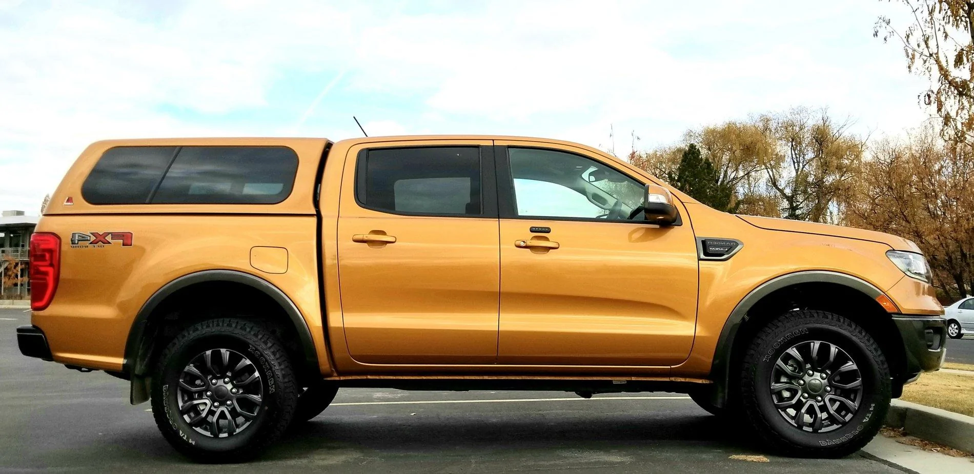

I would of posted earlier, but I had a lot of things done with the Fox suspension and after... I can say that the truck rides better and the handling is night and day different. First off I no longer get seasick in curves or turns. The body roll is mostly tamed and you get a better feel of the road. It’s not numb anymore. And bumpy roads aren’t gonna shake your fillings out. I also has the dealer install the Decked system. This is what it looked like...
Great looking setup! What tire size are you running?

Thanks... They’re 265/70R17 Goodyear Ultraterrain A/Ts load range E on the stock Sport wheels.I thought that I’d try something different instead of my usual KO2s.
I was hoping that was the size, that's the size I have in my garage to put on and it looks great on yours.

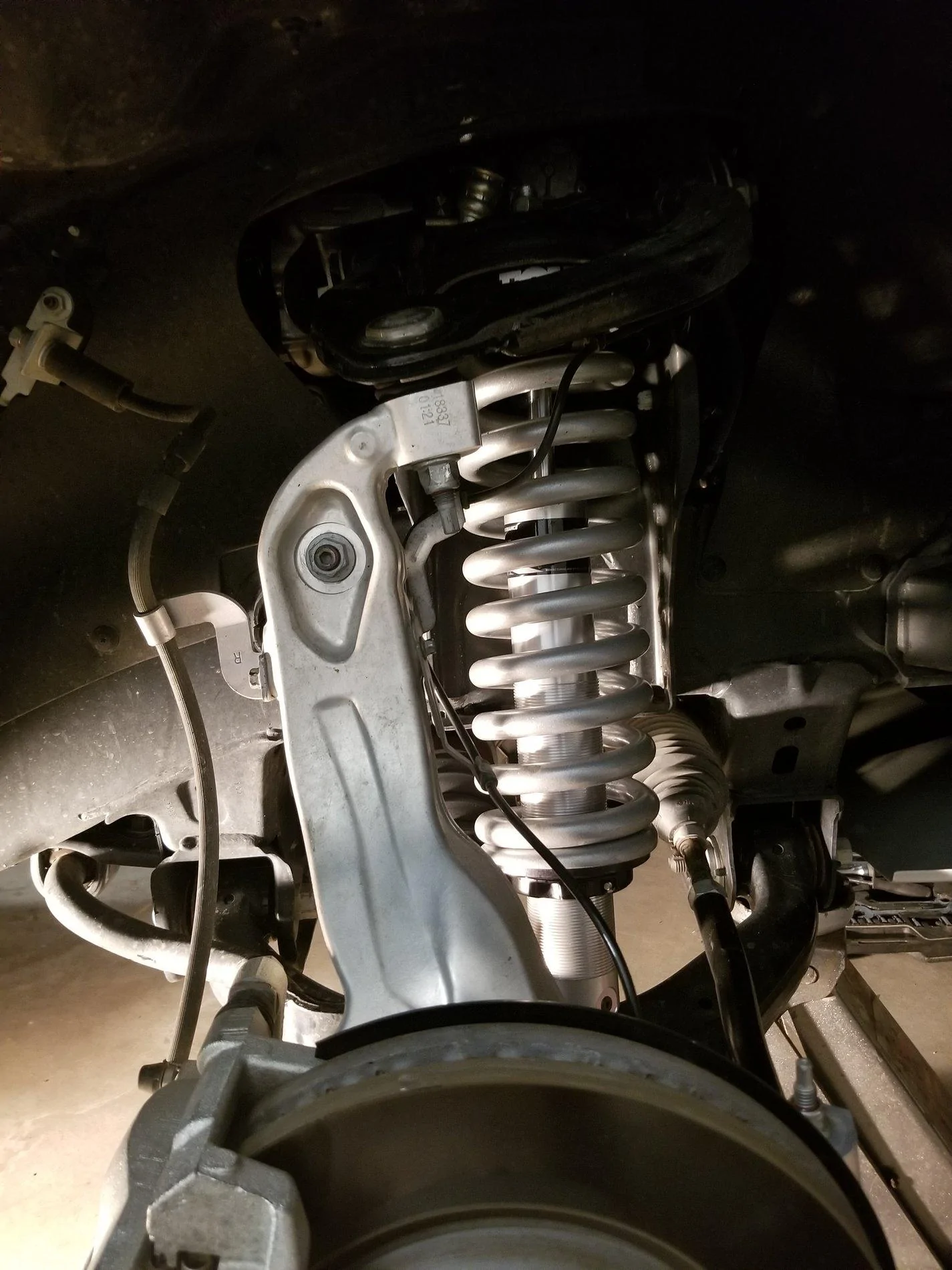

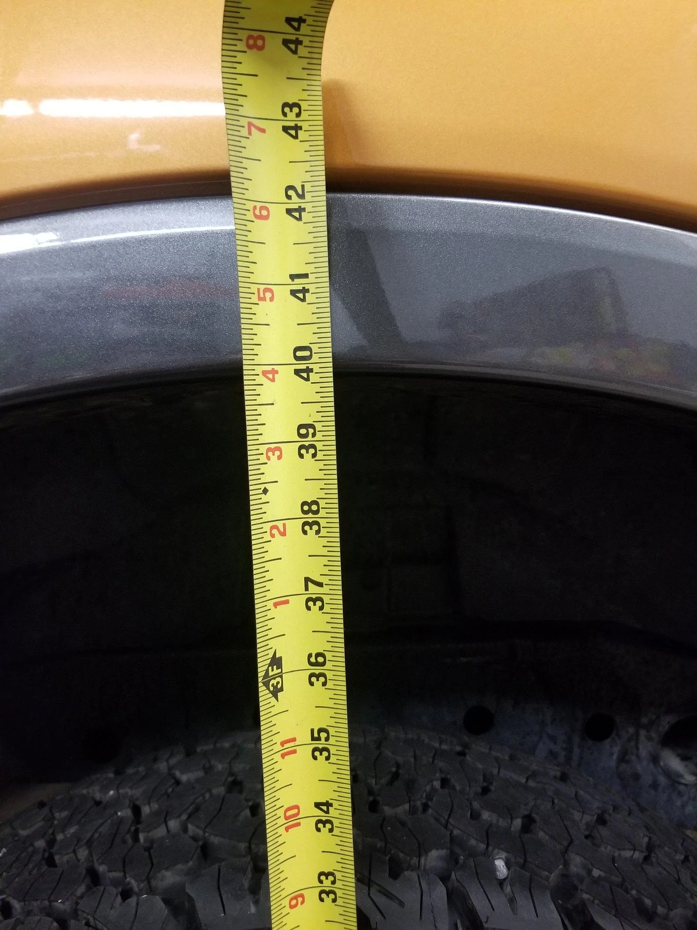

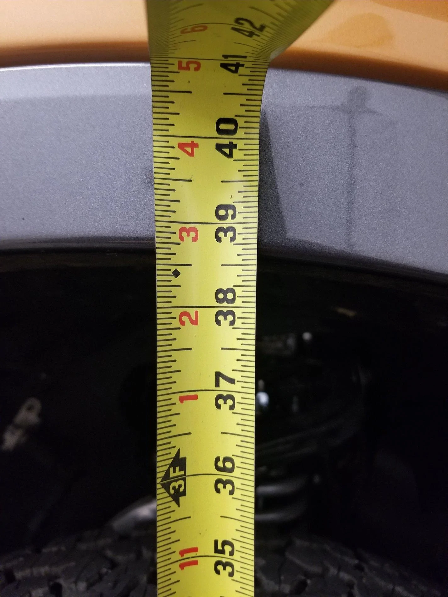

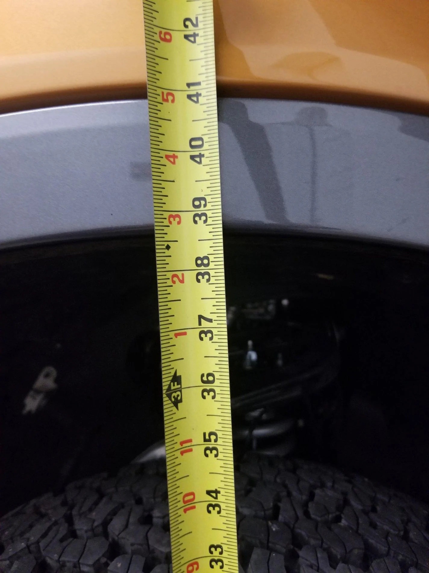

I got the Ford Performance shocks installed today
I've got a LEER topper on it already so I wanted to see how that affected rake with a full tank of gas.
Front
Rear
It measures almost perfectly level, but the sensation from the drivers seat is that I'm driving uphill everywhere I go.
I'll post some pics when I get some daylight tomorrow so everybody can see the semi-finished product, but I definitely plan on installing the rear blocks I've got coming from Stage 3 to bump up the back a little bit. Then I'll take new measurements and pics and get them up.
As for the ride (on a limited test basis)... I got a chance to pound up a dirt road in a canyon by my house tonight and the control is dramatically improved. The body roll is a million times better and it seems to absorb front impact much better. If there is one downside- I'd say that the rear shocks are borderline too-stiff and the pothole-style ruts in the road are felt more abruptly than before, it seems to be a little more jarring or sharp. Almost like when you have overinflated tires (which I checked, they're not).
More pics to come...

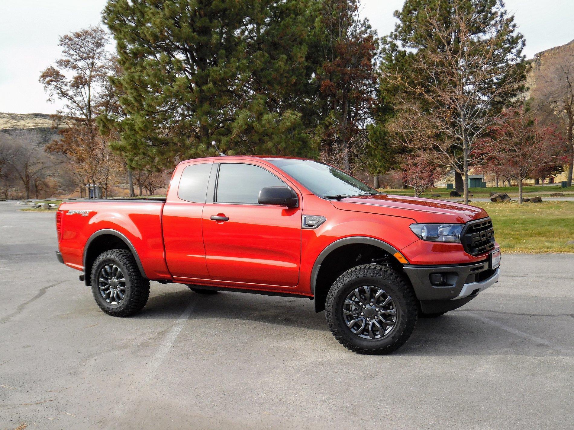

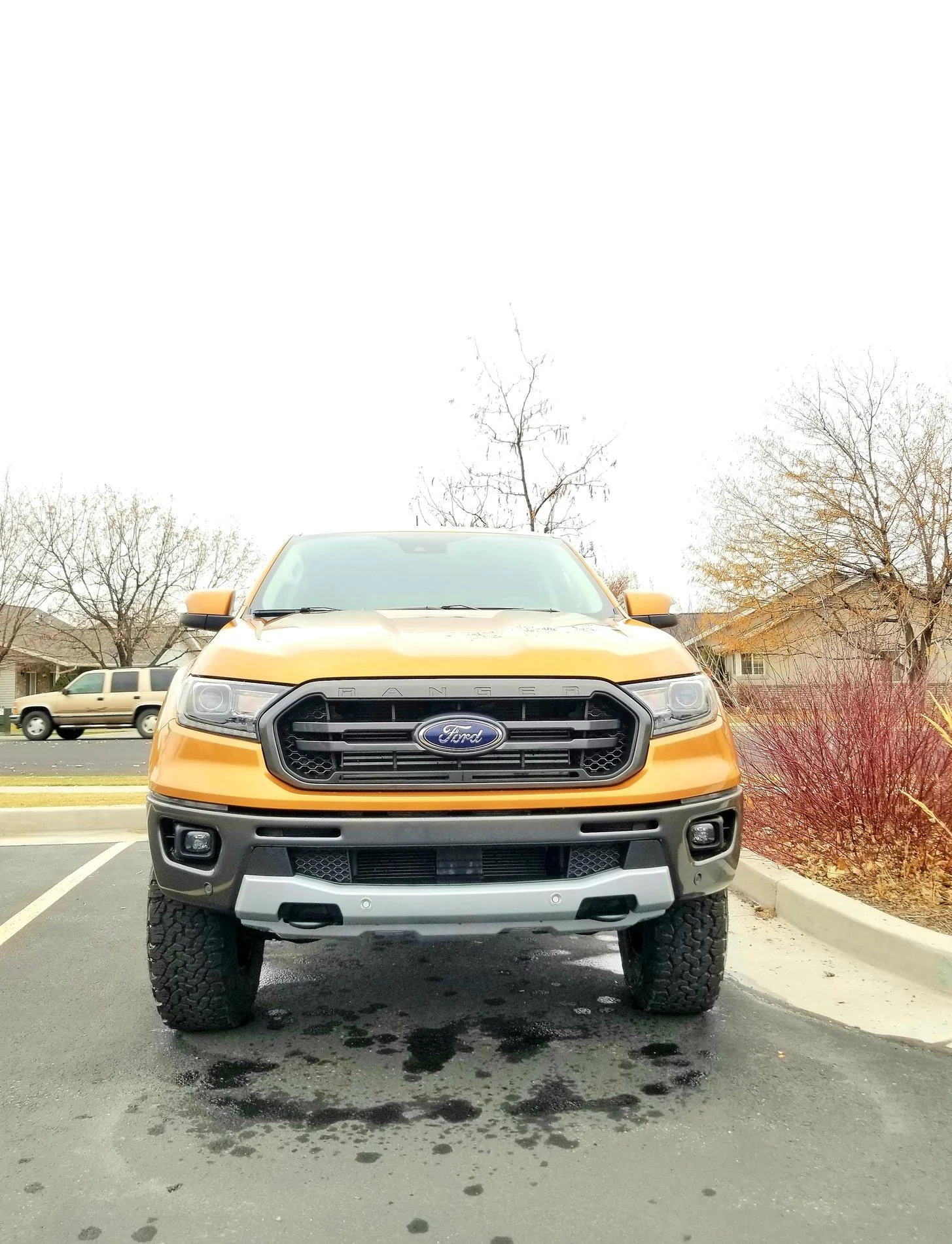

Here's the before and after pics (pre-rear block)
And the head-on
Tires are BFG TA KO2 in LT255/75R17 (32.1"), they have excellent clearance with no modifications to trim or crash bars.

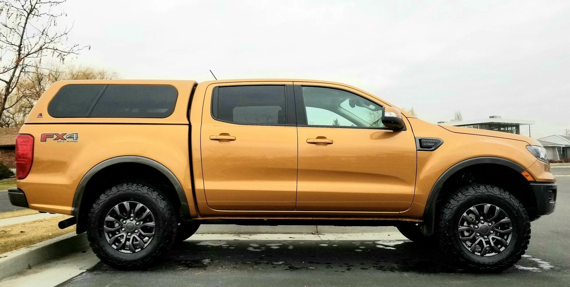

2017 F-350 CC & 2019 Ranger Lariat Sport & 2005 Ford Explorer Sport Trac - SuperCharged

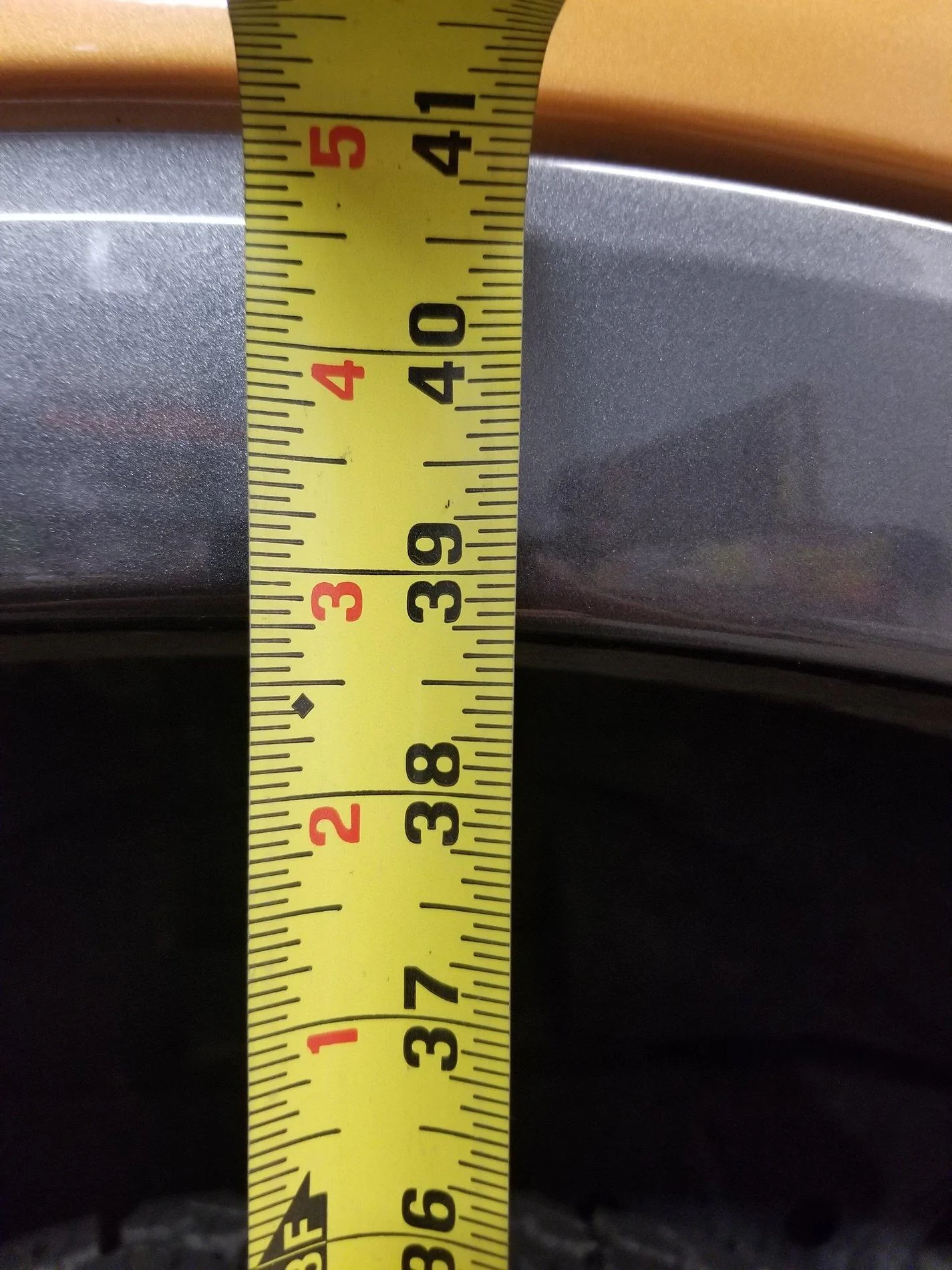

Love the new height with the Eibach rear blocks!
Front
Rear
After more time behind the wheel, I can't recommend the Ford Performance shocks enough. MASSIVE DIFFERENCE IN HANDLING!
