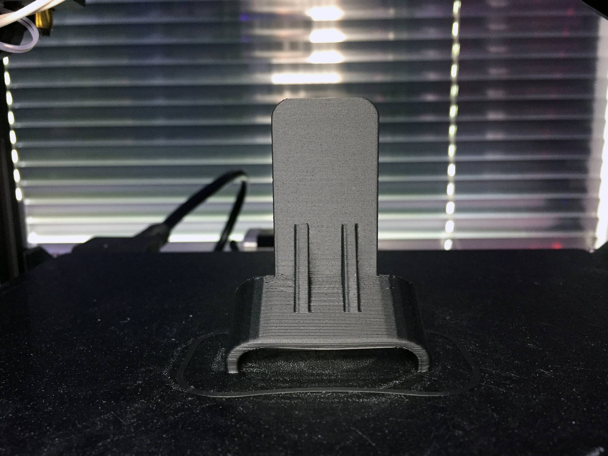

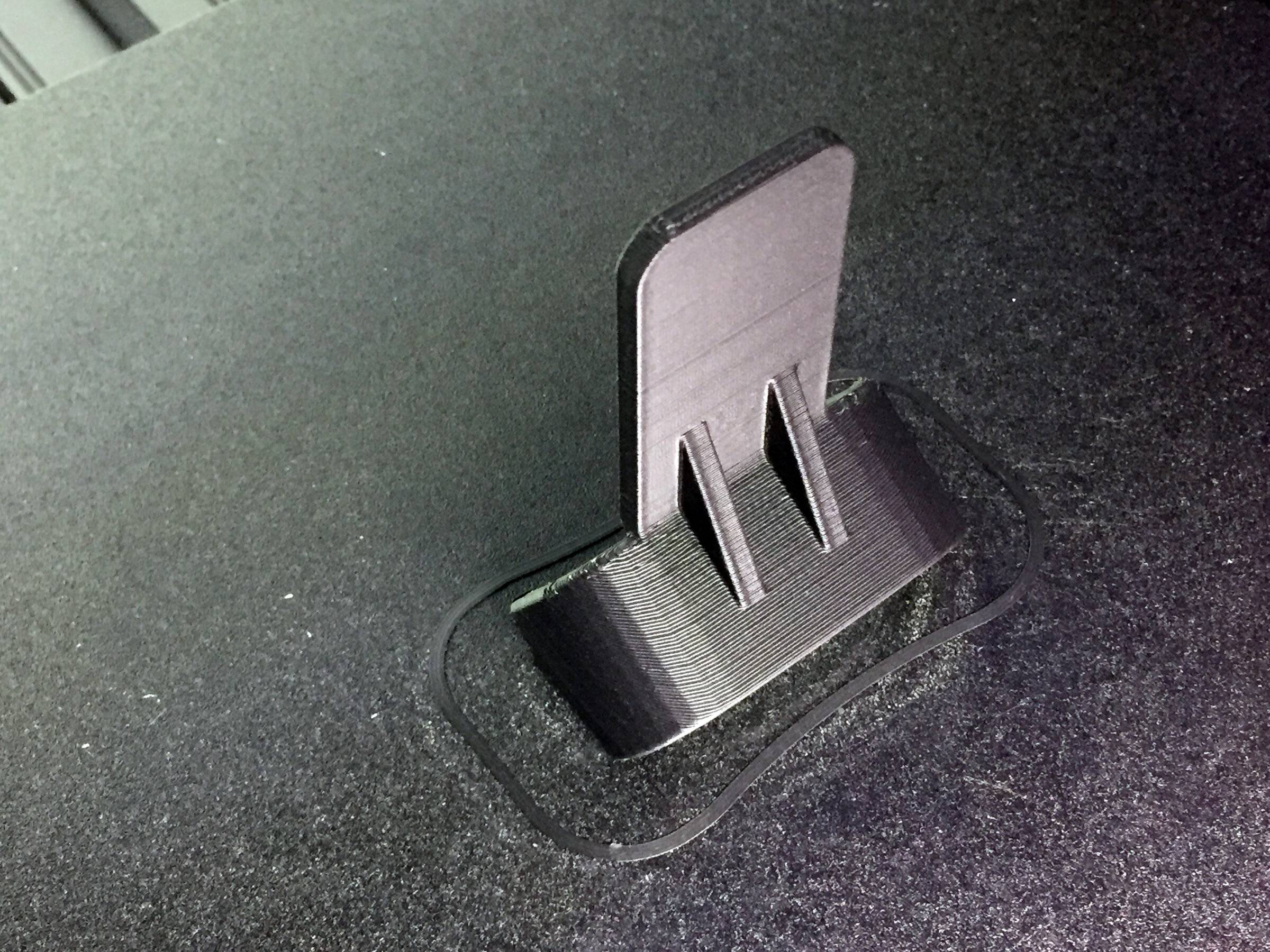

Hi Sid,
With two gussets...must be a heavy load for this bracket...must be another light bar, eh? Your poor overworked alternator....

Hi Sid,
based on the second images (after your post) I would say another dash board mount for something.

I'll have it mounted soon...it's an exterior part...

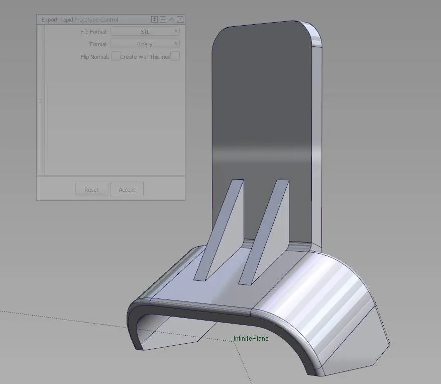

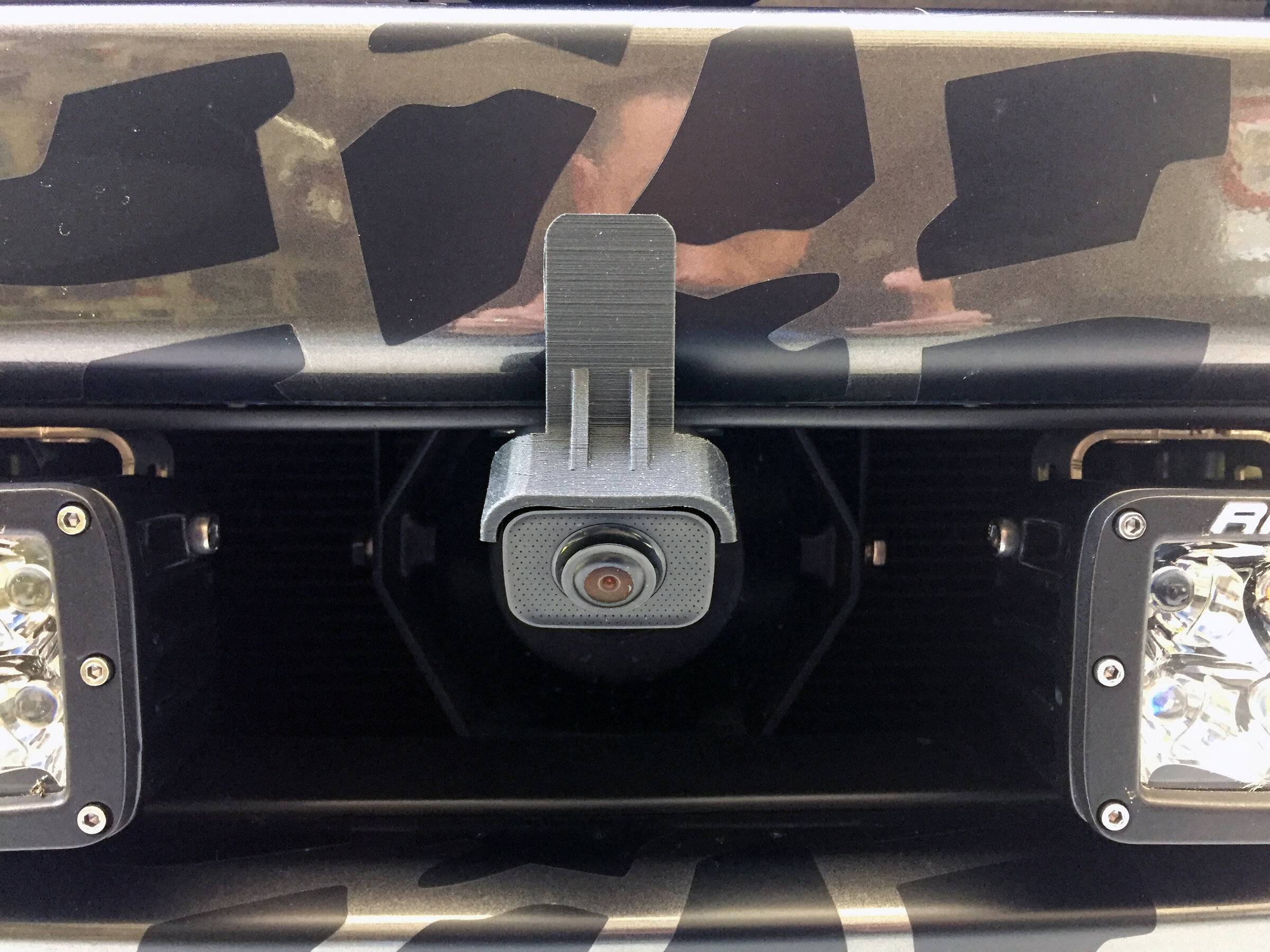

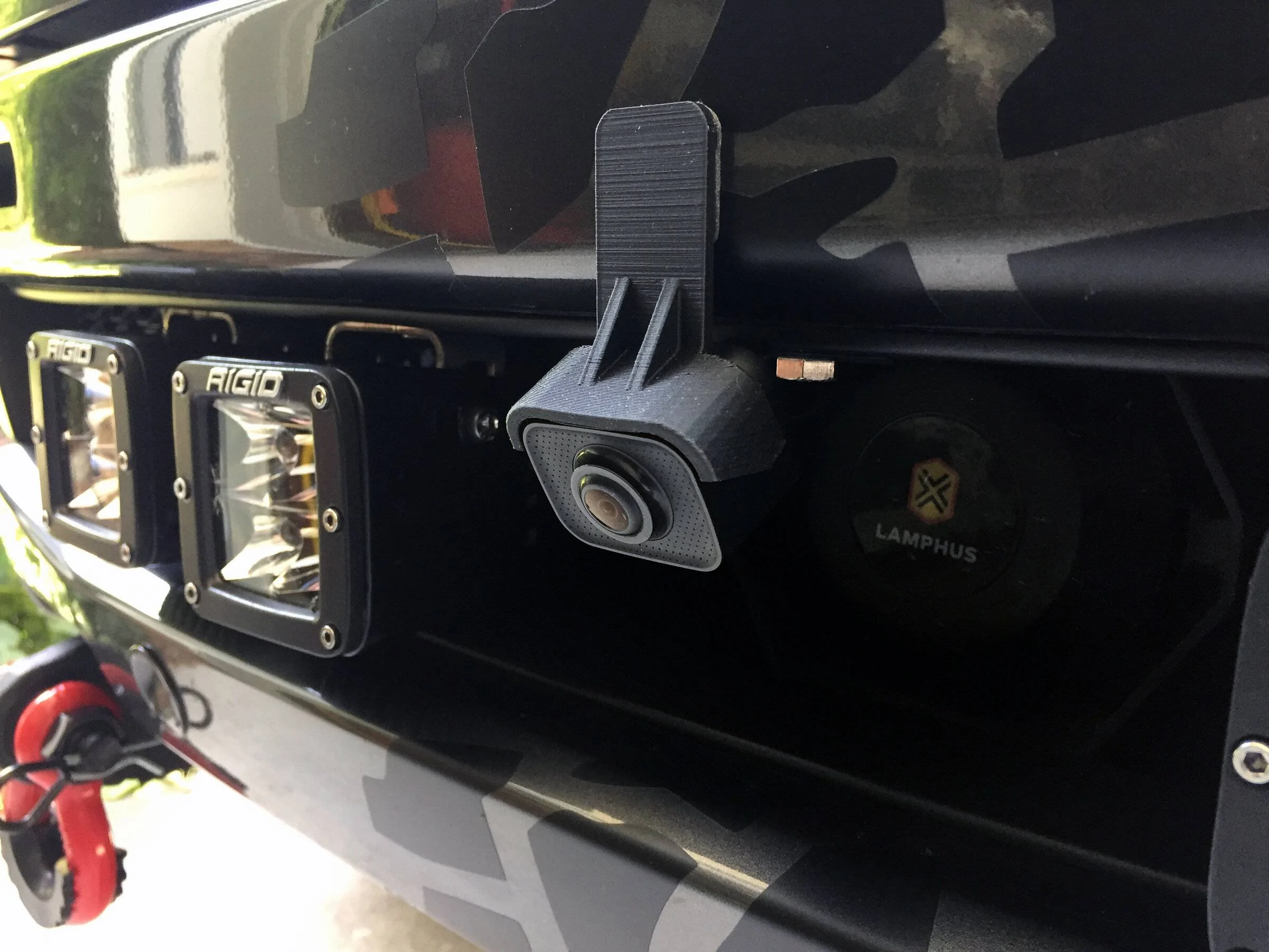

There's no chance of guessing this part as it only applies to my truck...specifically, the front ground camera...works great but occasionally, car wash or wind at highway speeds would deflect it's aim down, making it useless...so this gadget is to keep that from happening...

That was going to be my next guess.
Though I still think it would likely twaddle turnips with authority.

Good to hear. I thought it was some type off support for your bummed up ankle. :like: :frown:

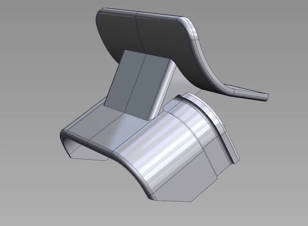

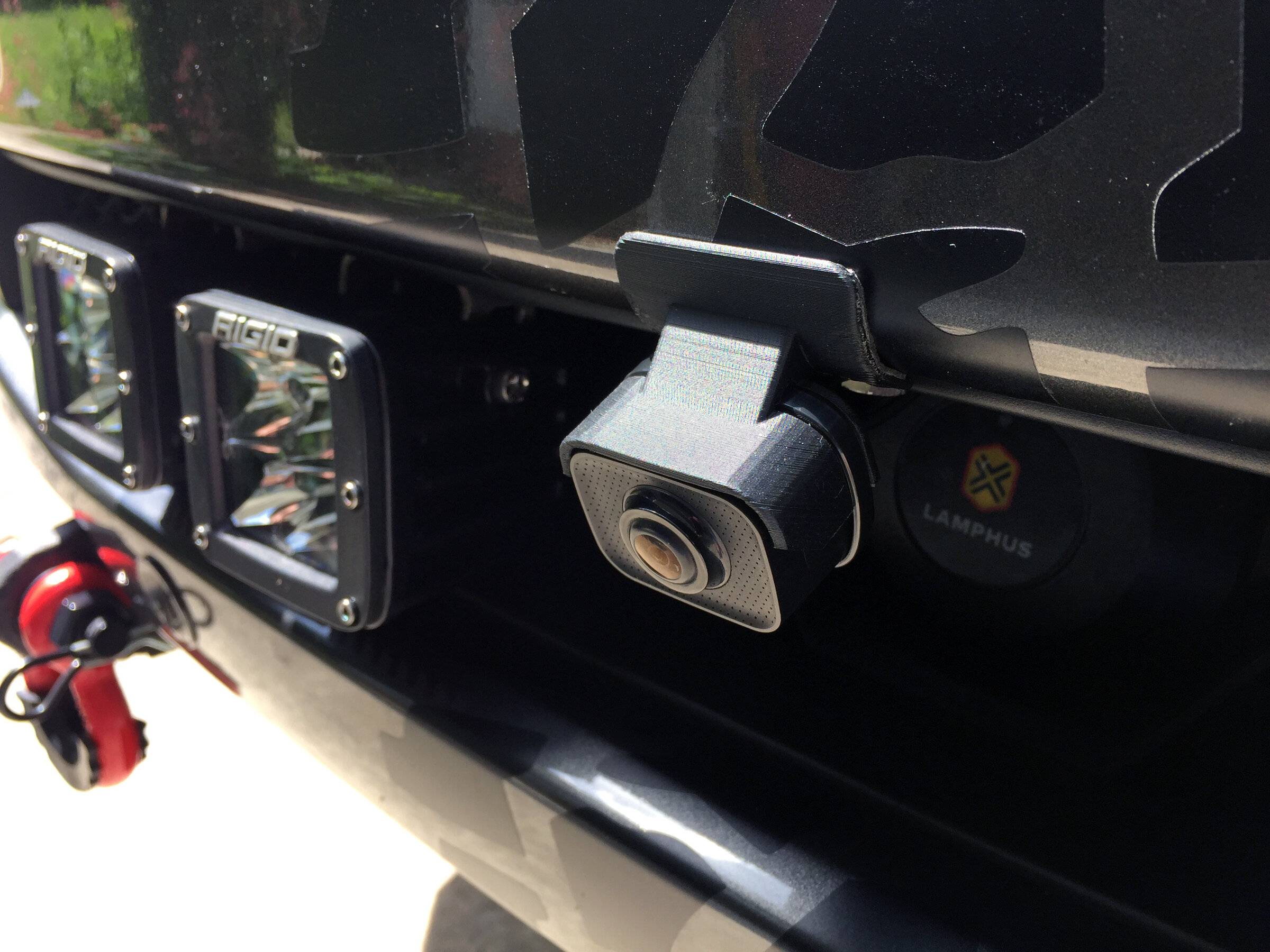

Refinement for strength and compact size...included a channel for zip tie...
