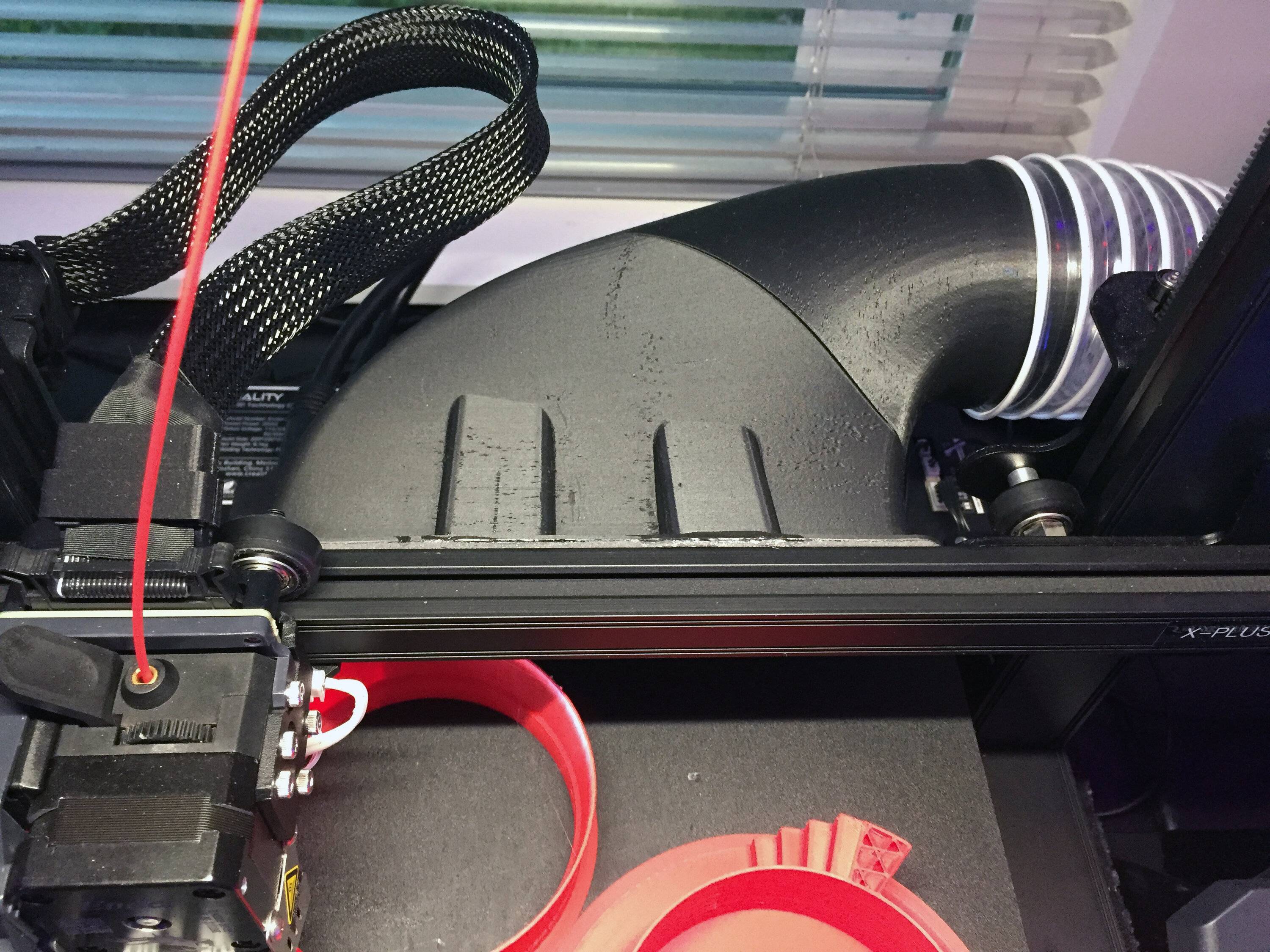

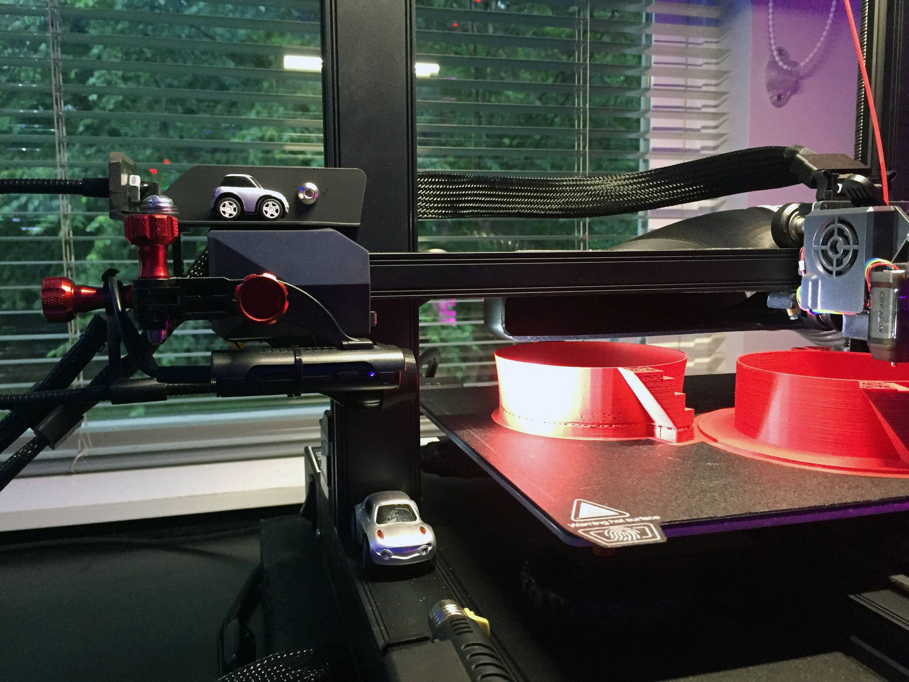

One part of a custom 3D printer particulate extraction system...printed of course...

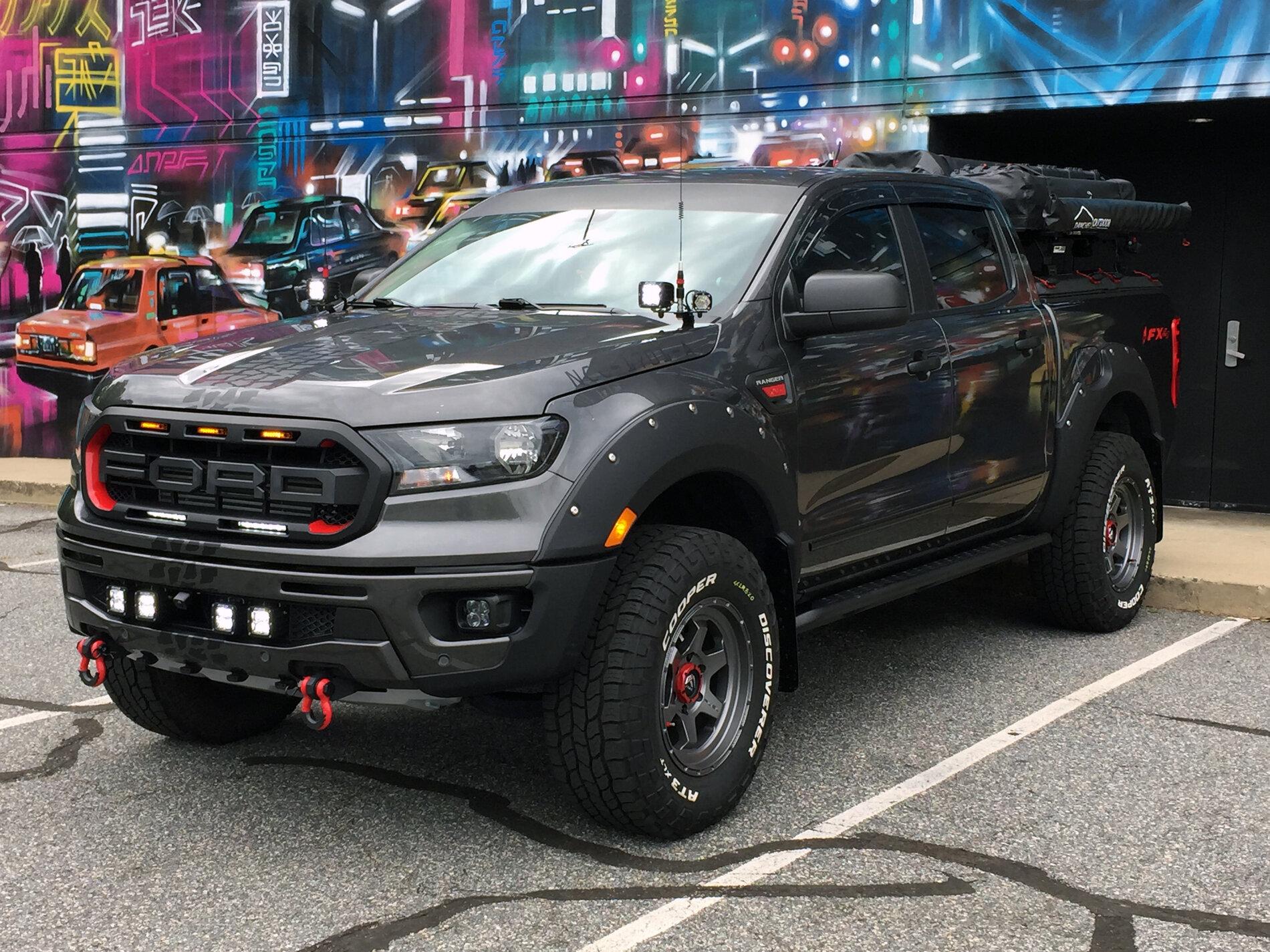

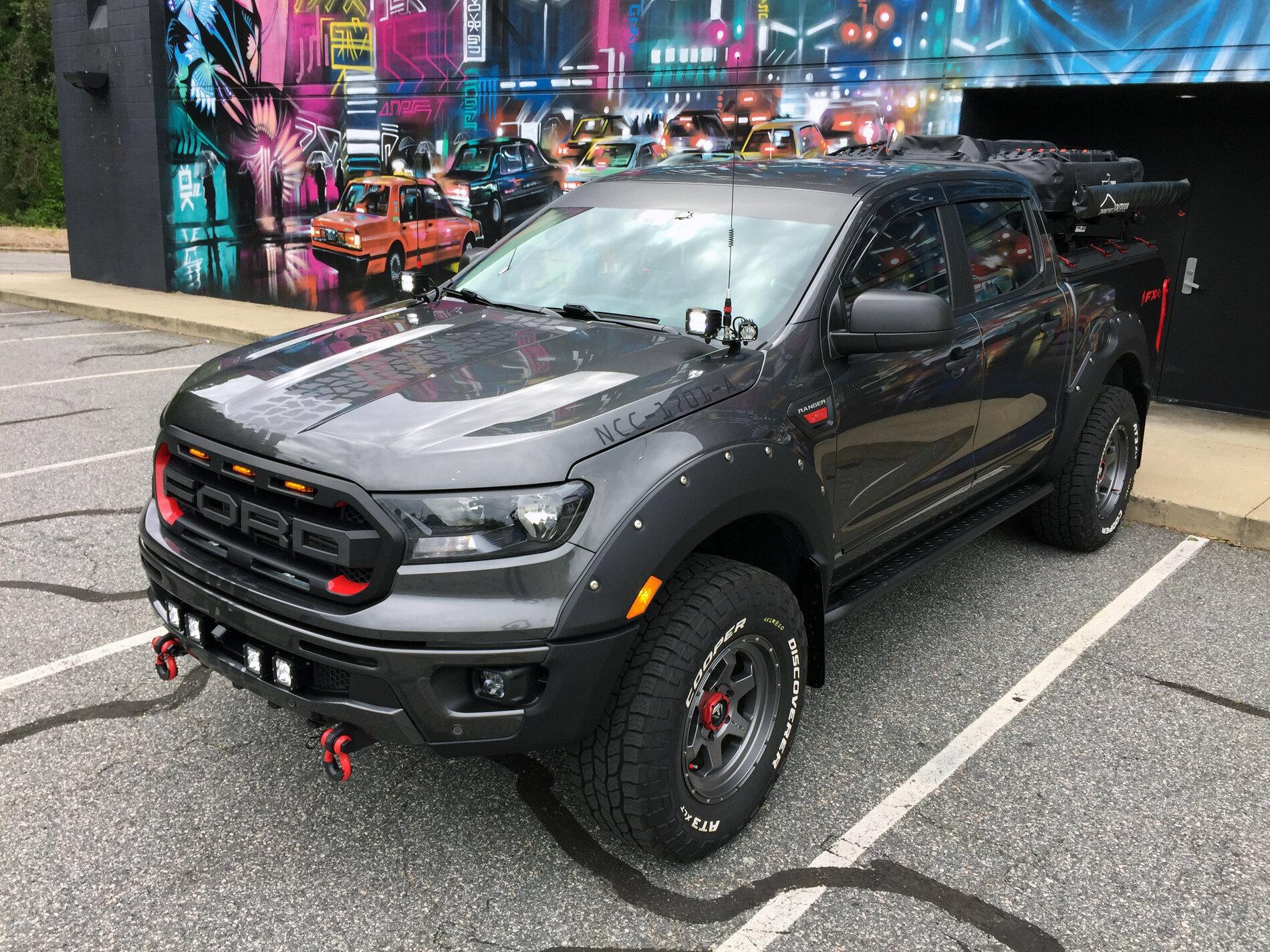

Moving on without the deflector...could never get used to the shape of this particular AVS bug shield...too misshapen and looks melted...the way it's mount is sandwiched between the seal and hood increases the thickness requiring hard slam in order to latch properly...so I'm taking it off until a better one comes along...

Are those inserts from a stock tremor grill??

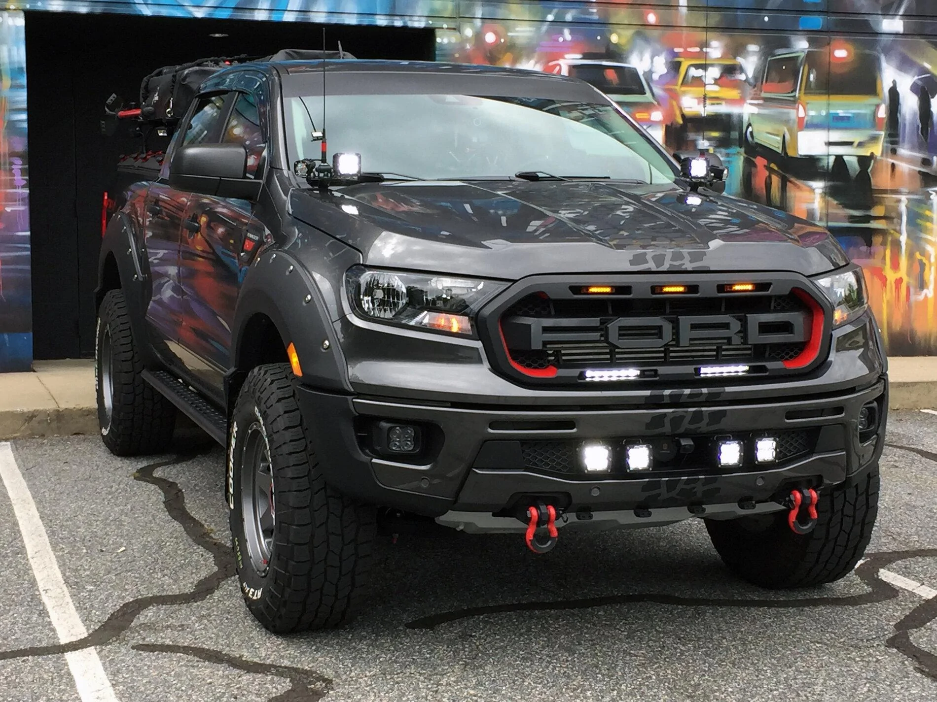

They're custom Oracal red vinyl...hand fitted by trial/error templates...tricky but a couple of members have asked and done this too...it's a lot easier to have it painted if you don't want to go through the head ache...

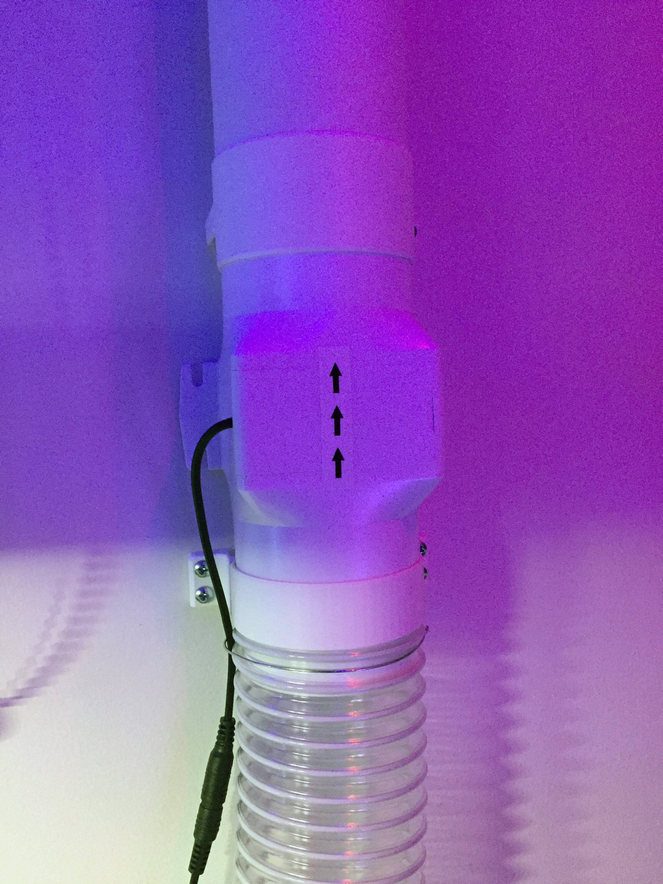

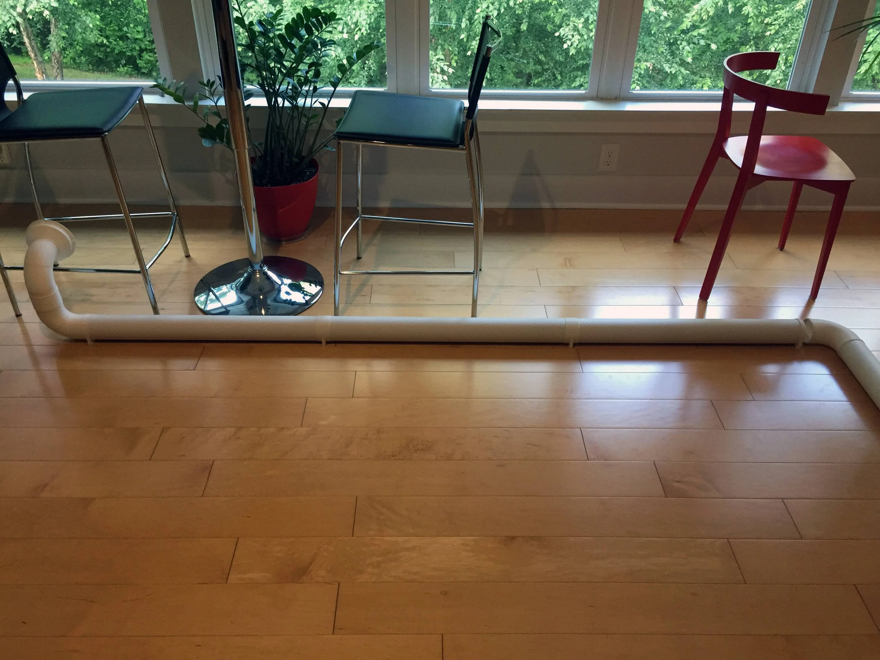

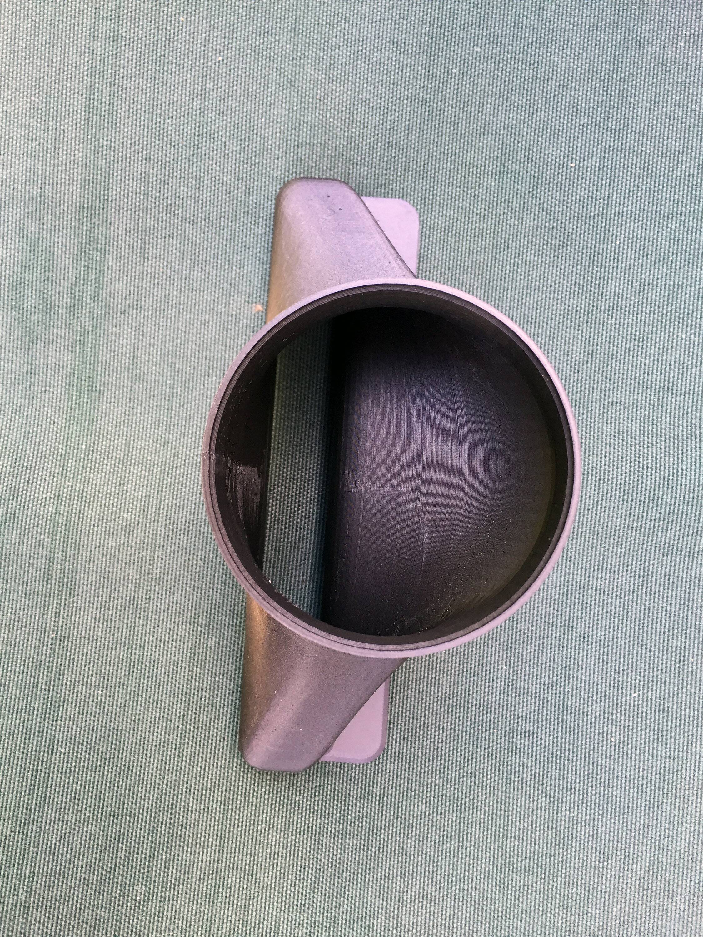

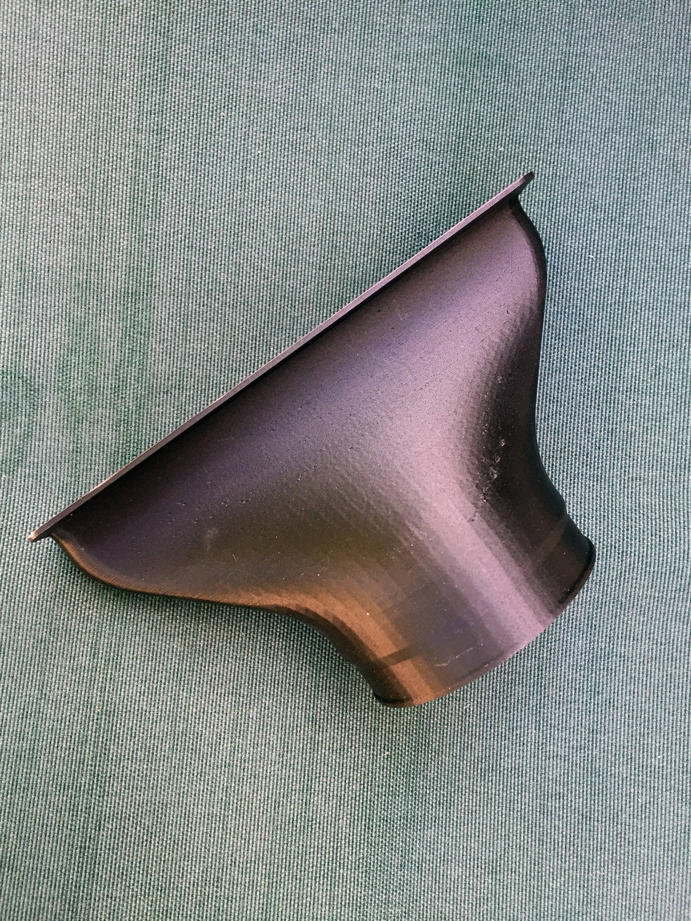

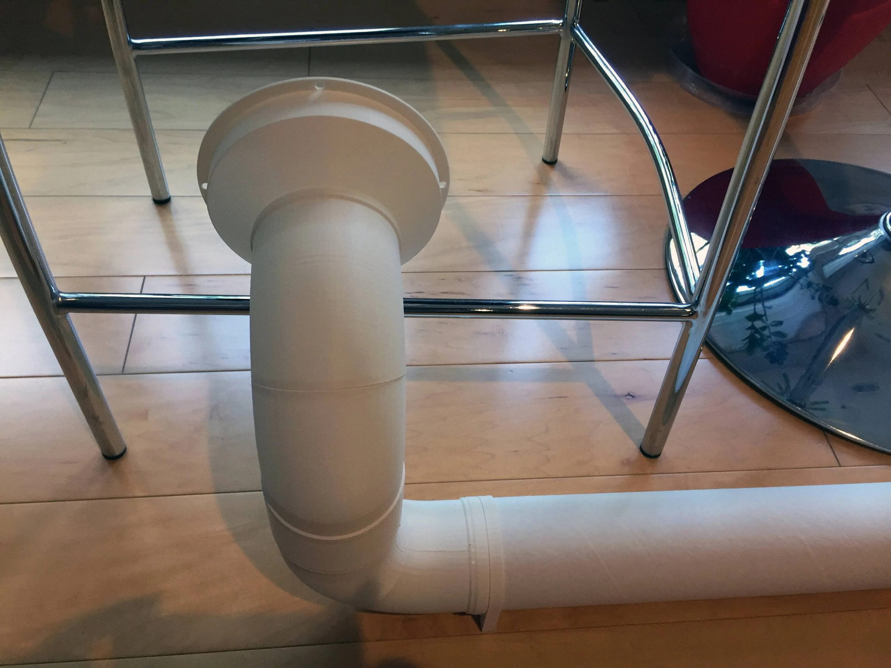

Working on reopening the Keystone pipeline.... ?

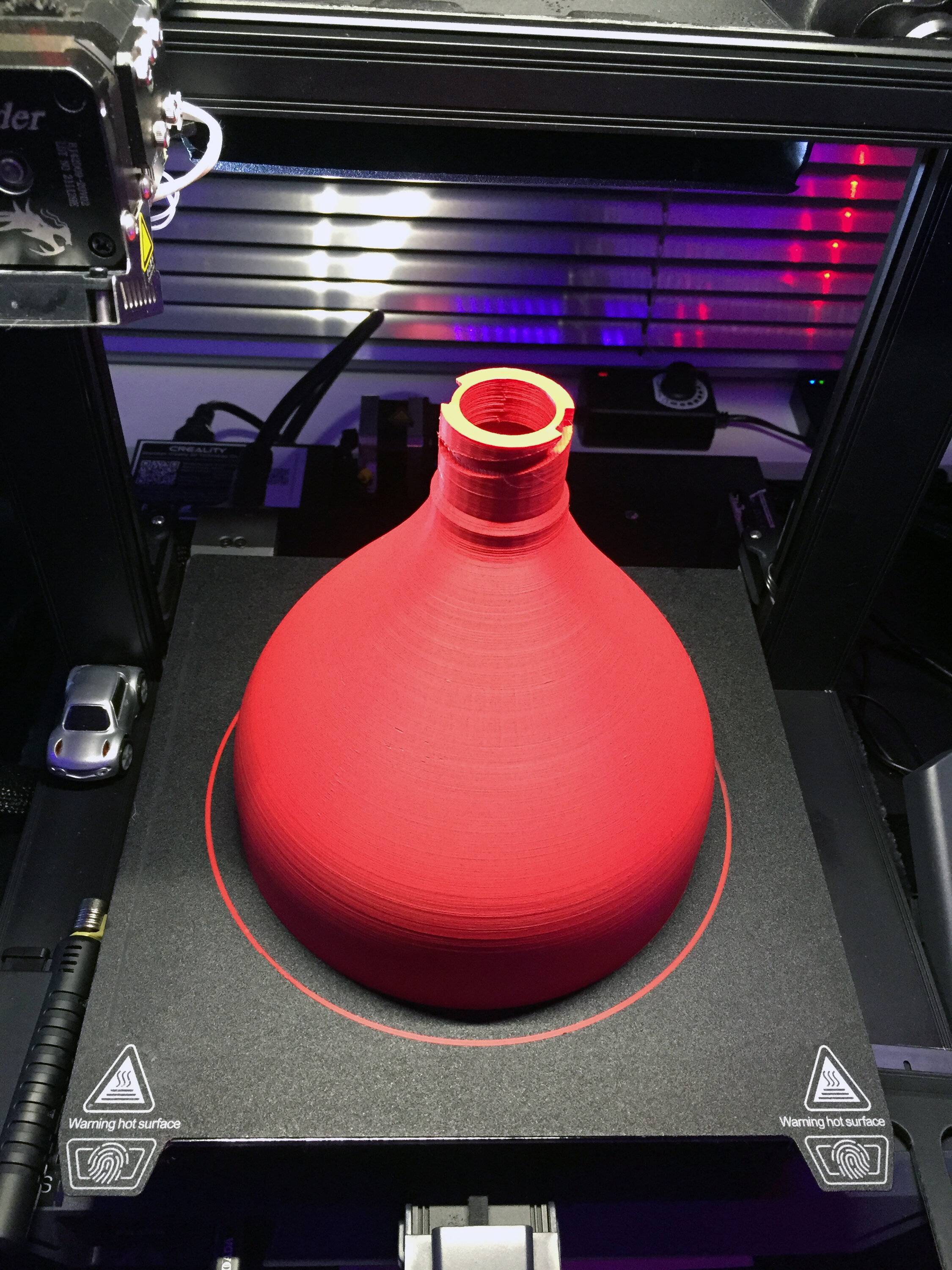

Serious printing requires some serious ventilation...one piece at a time...this looks like PVC but it's actually 3" mailing tubes and printed connectors 1 mm thick...super light...PVC was way too heavy and the parts costed well north of $100...
Extraction point...

Sid, Just a guess but I don't think your wife is going to like that hanging out the dinette window. :shock::LOL:
Funny you mentioned her...she's in MI this week...?

Boy will she be surprised when she gets home. :shock: Should I text you my address in case you need a place to crash??

Simple, just her that it is part of your new 25' underwater river crossing mod...?

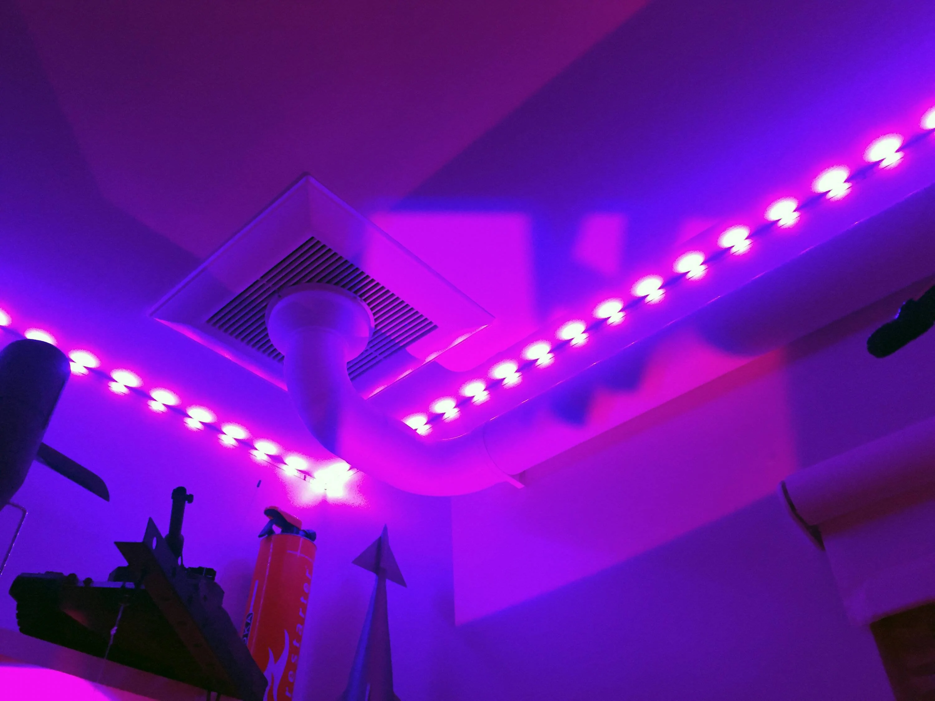

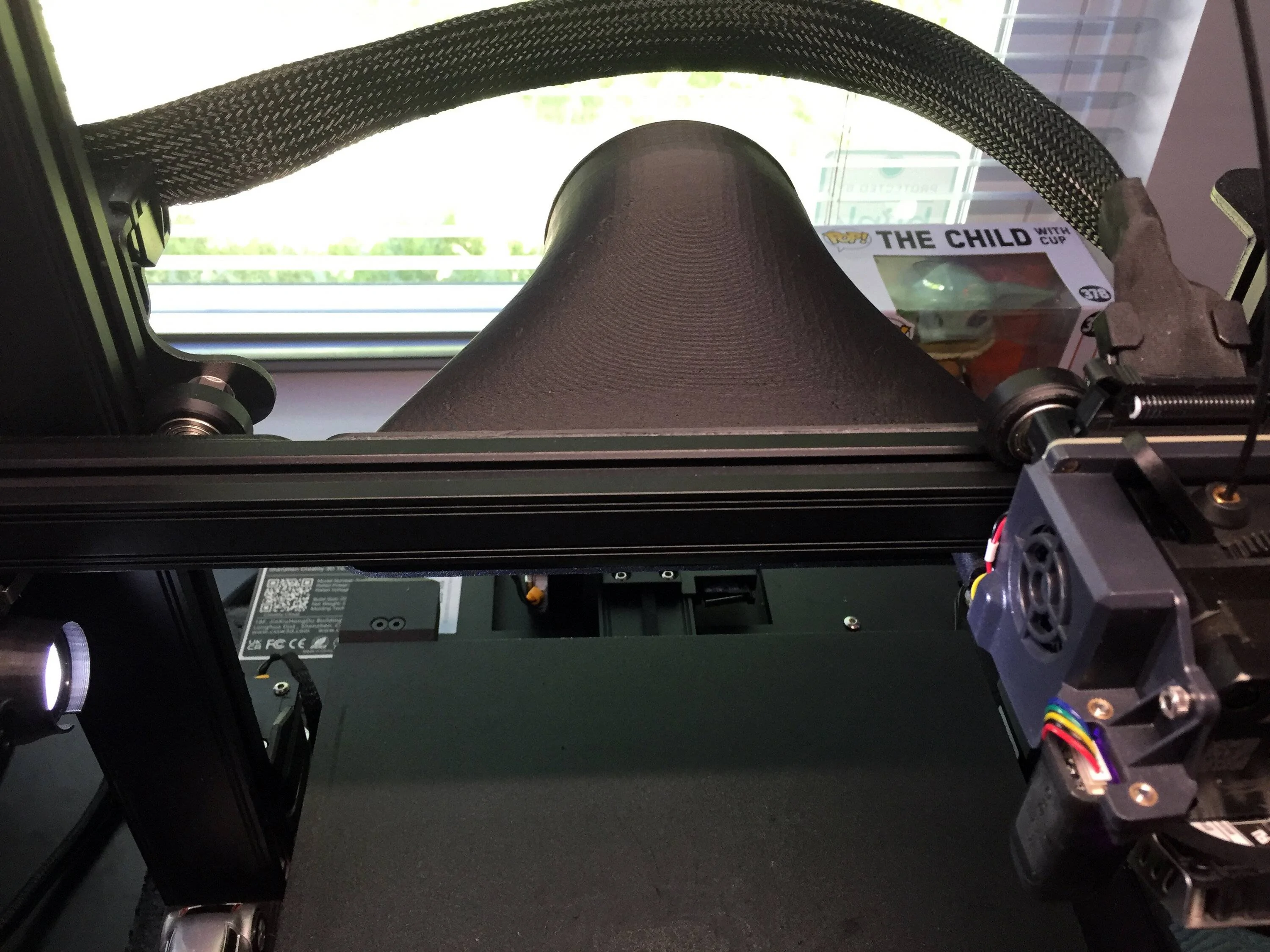

Extraction system complete...long wait for the 3" inline duct fan...draws particulates from hot end and plumbs them up/over to the ceiling vent fan...

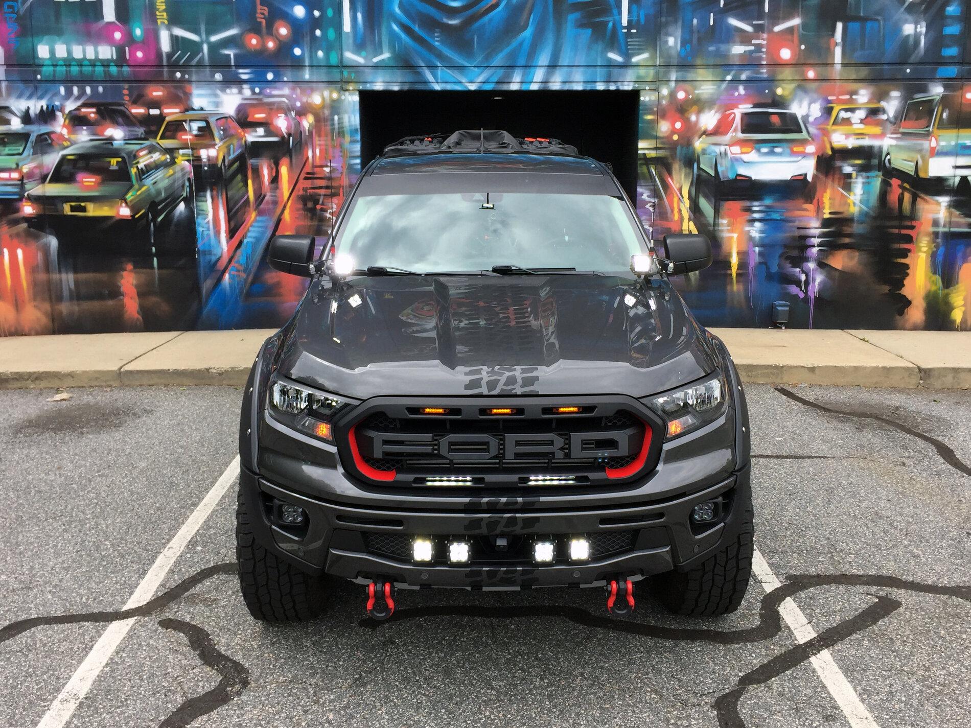

Looks good Sid, even your house is all lit up like the space shuttle. I really don't know why I'm surprised at this. :facepalm:
NewRanger009
Jan 7, 2022
91773
2021 Ford Ranger XLT Sport 4x4

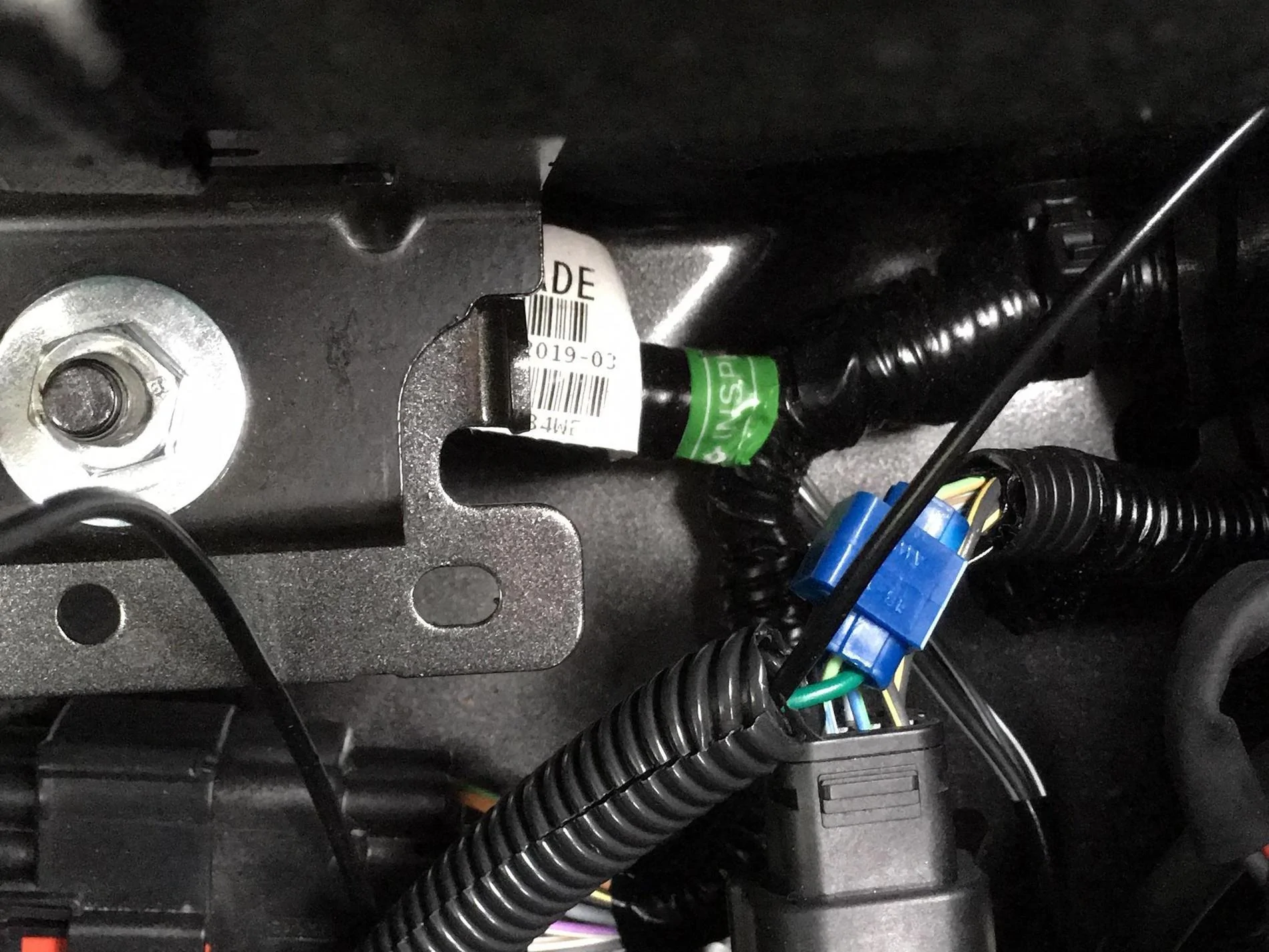

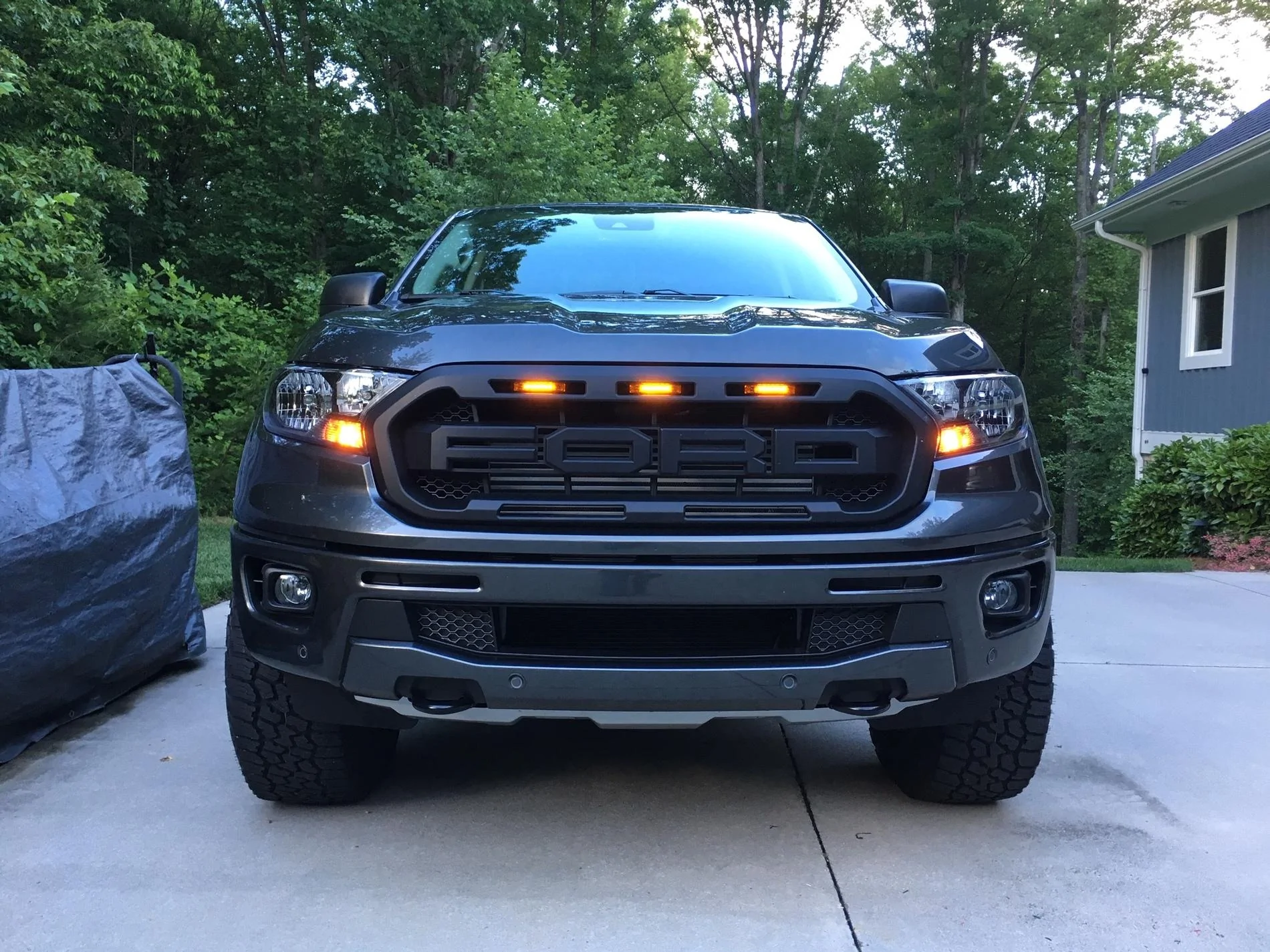

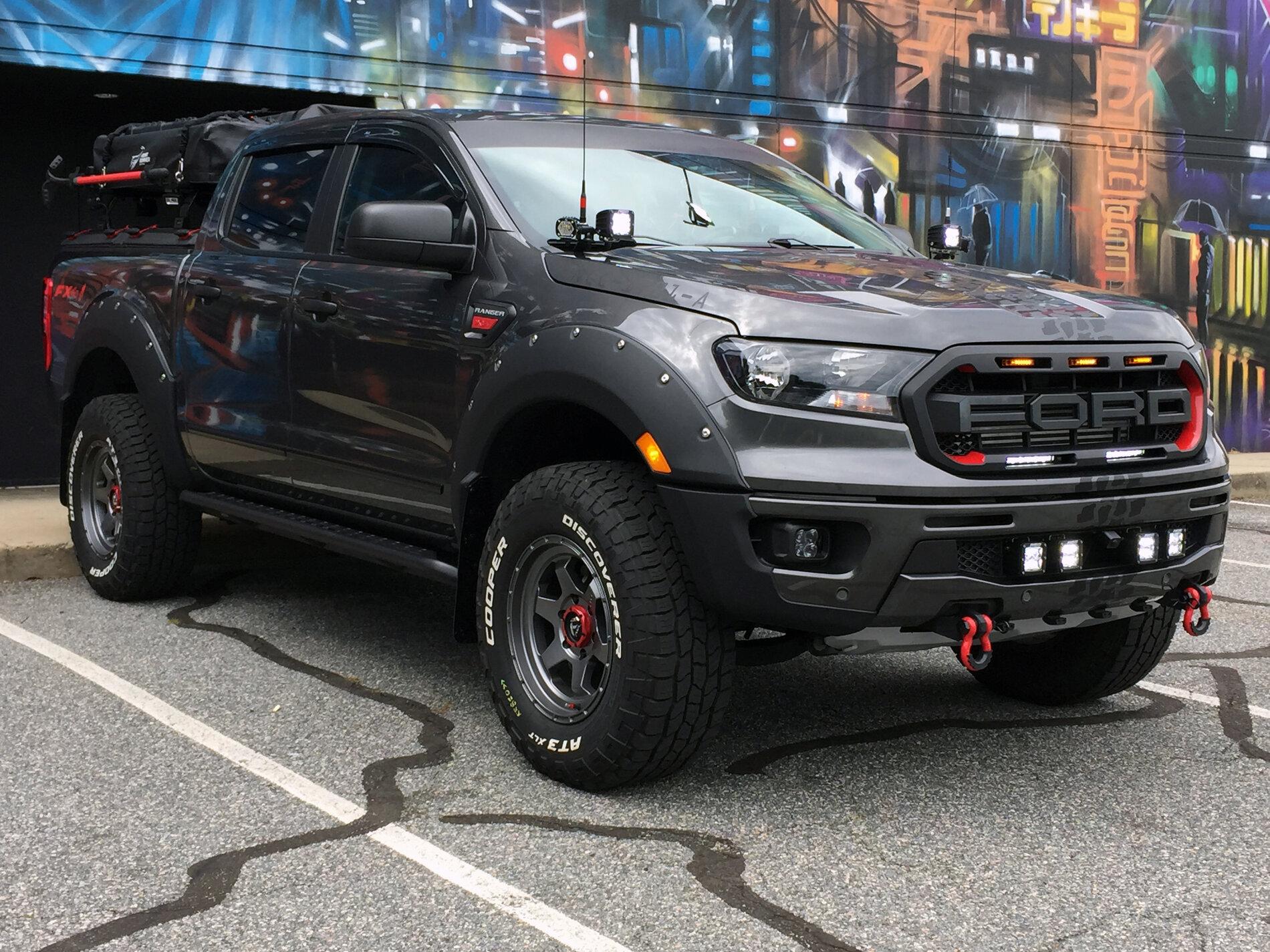

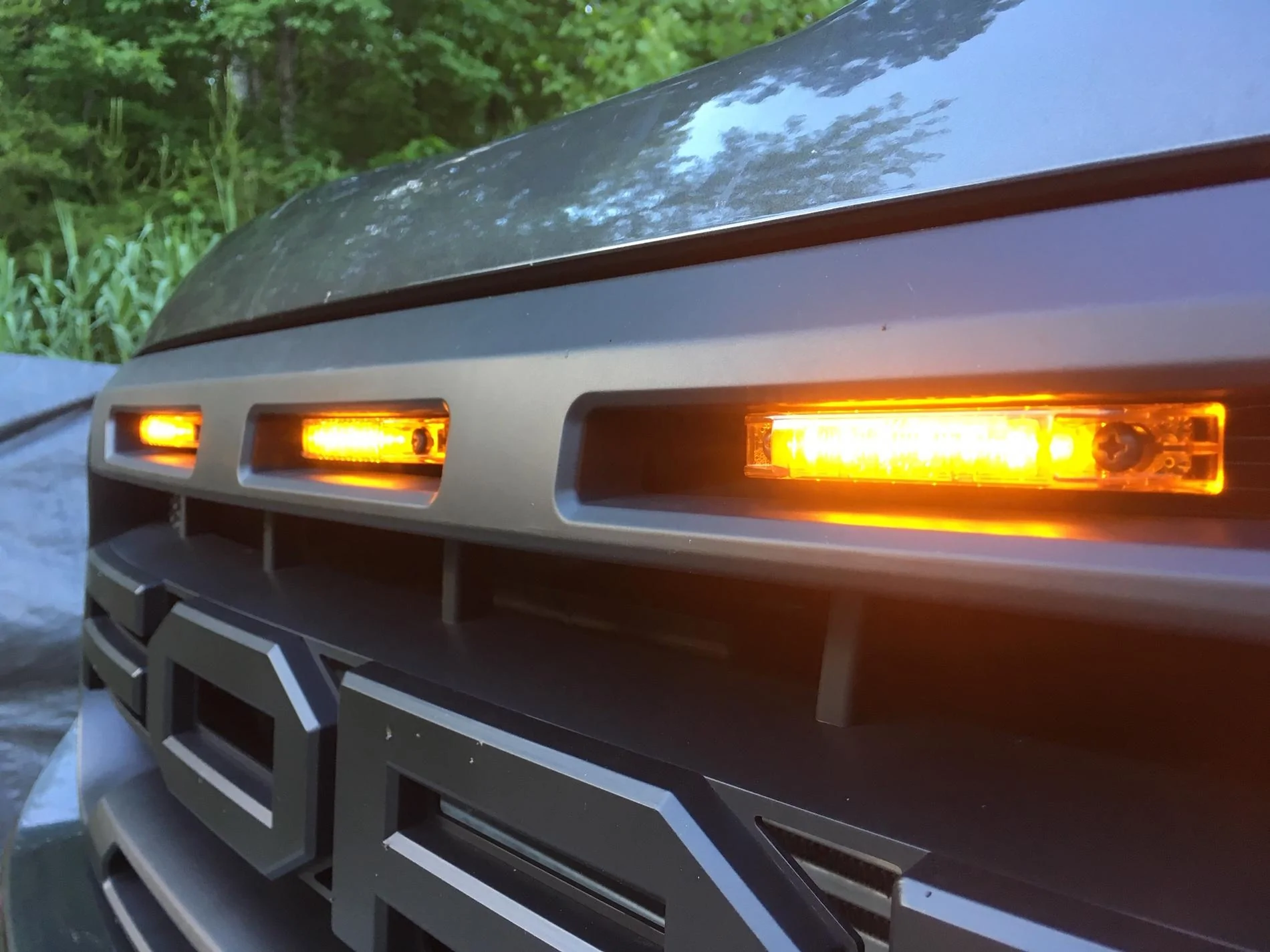

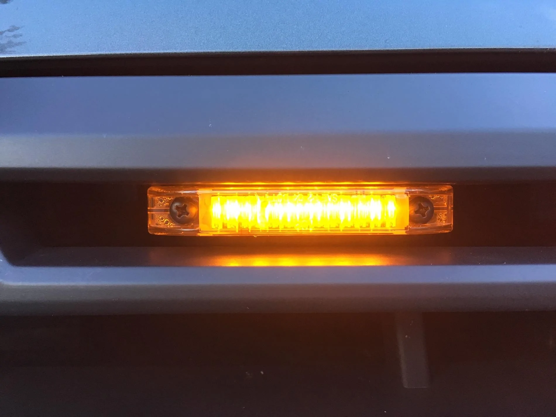

The LEDs were wired together in parallel and the positive tied into the top left lead (yellow/green) which are switched on/off with the marker lights. The negative tied to any ground bolt under the hood.
LED source...
https://www.amazon.com/gp/product/B00ECTQNF6/ref=ppx_yo_dt_b_asin_title_o08_s00?ie=UTF8&psc=1
Just got my Ranger 6 months ago, and I loved your setup.
I've bought the Raptor Grill from Amazon. The connection to the lights isn't like the one from Stage3, its just exposed black and red wire. I see where you tapped on the side marker using the Green/Orange wire. But which ground bolt did you use? I didn't want to mess up my electricals if I use the wrong bolt as a ground.
