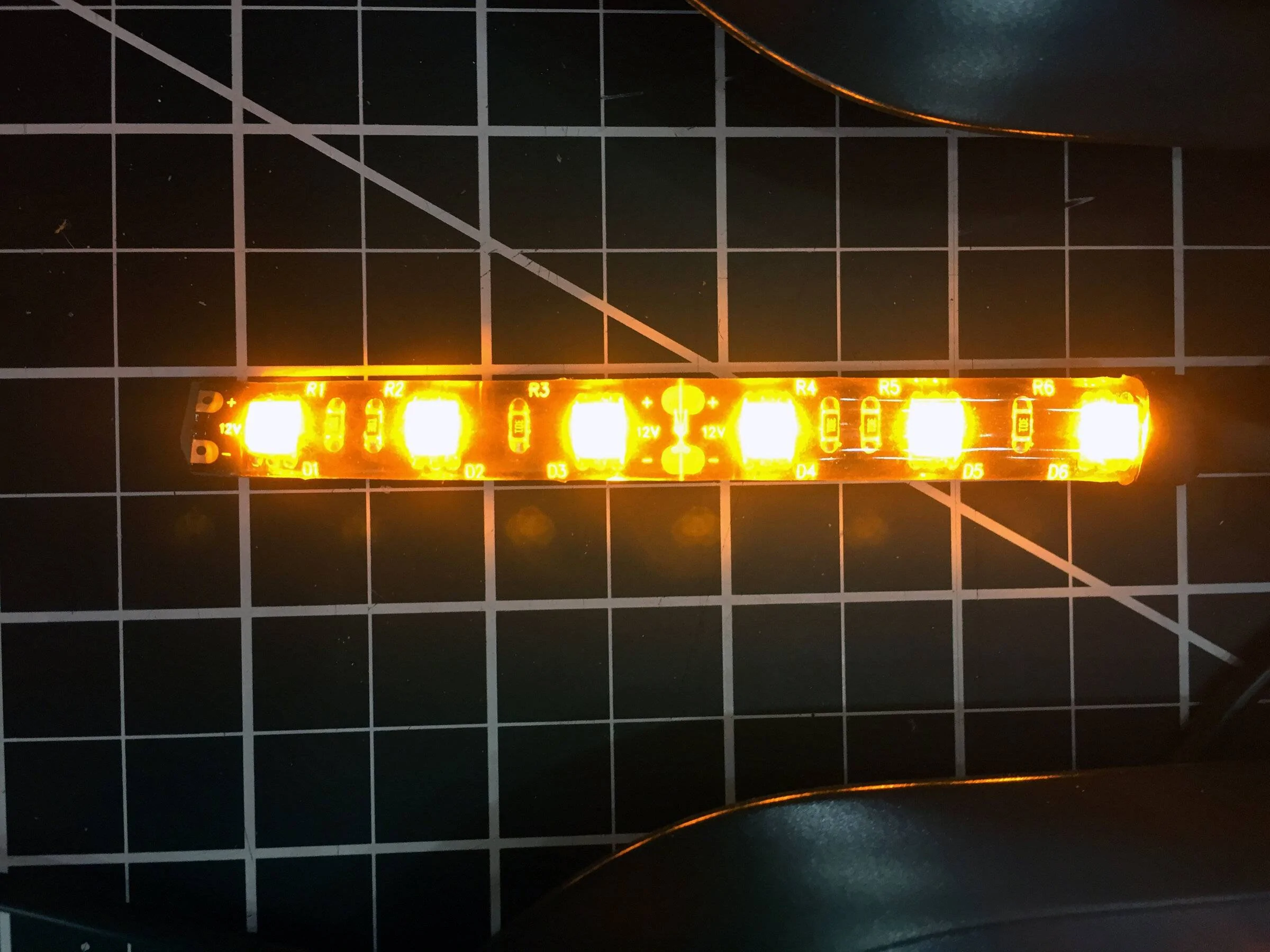

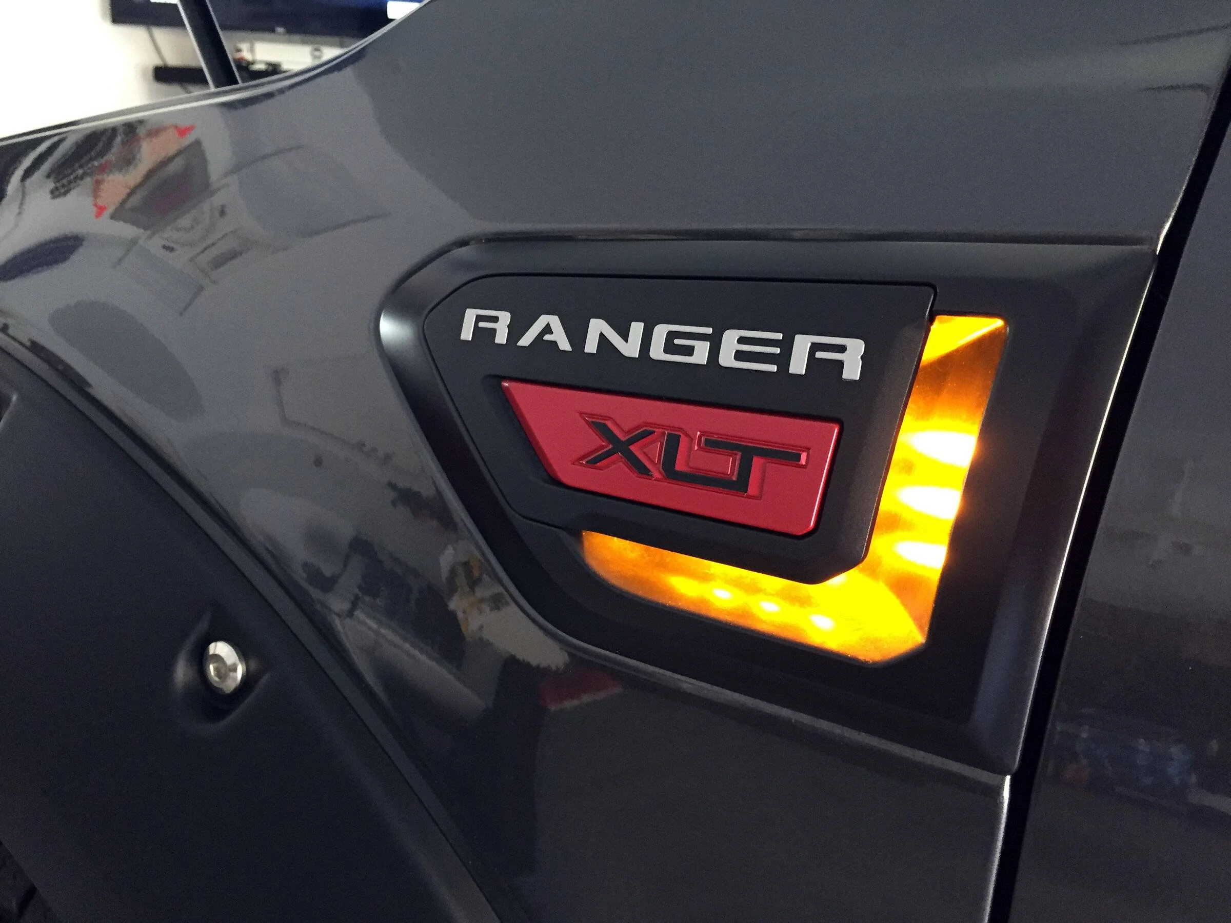

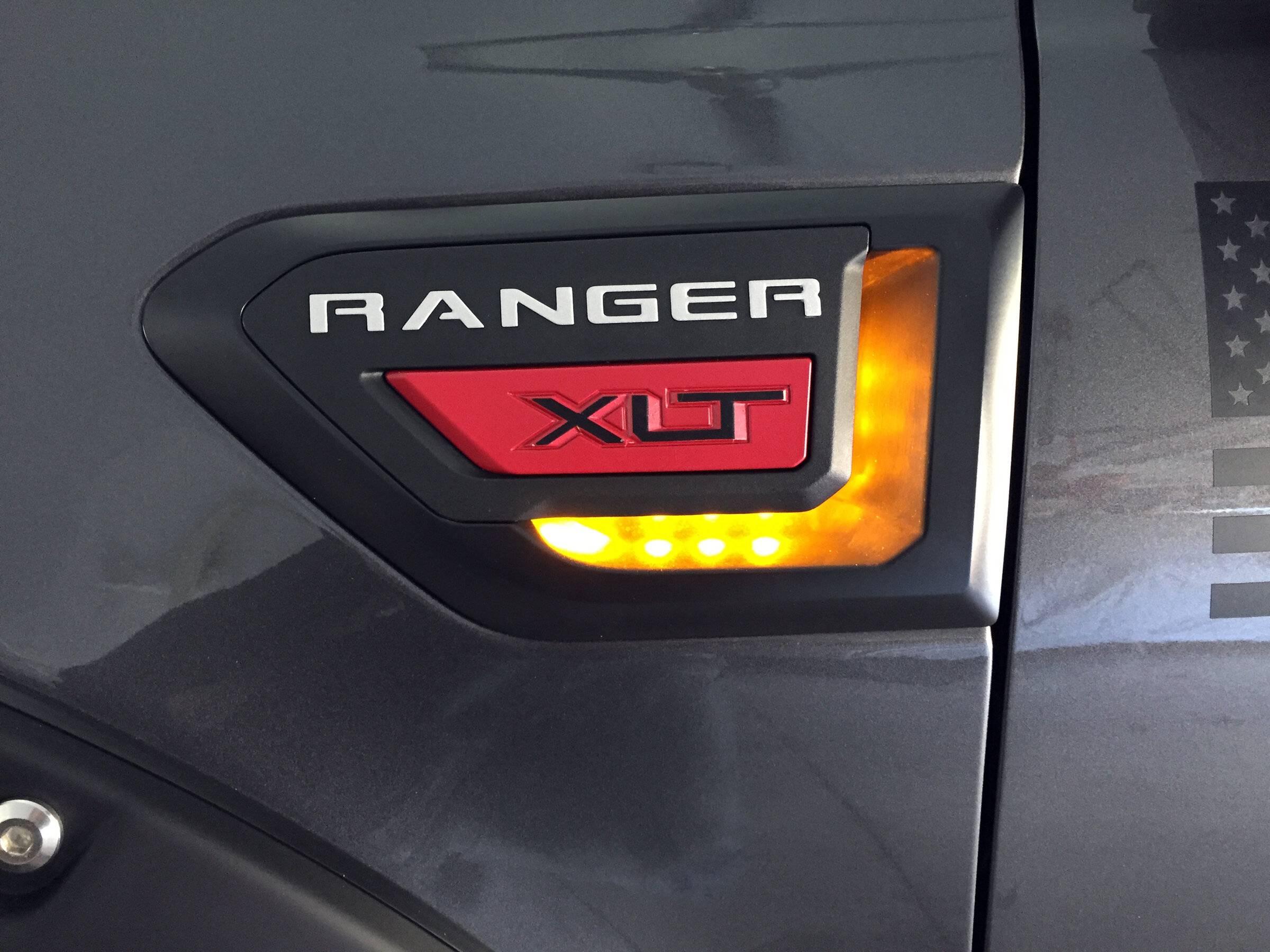

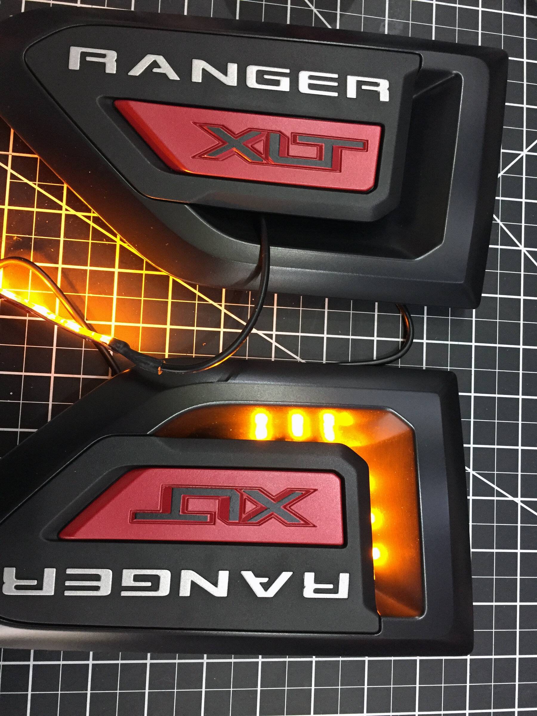

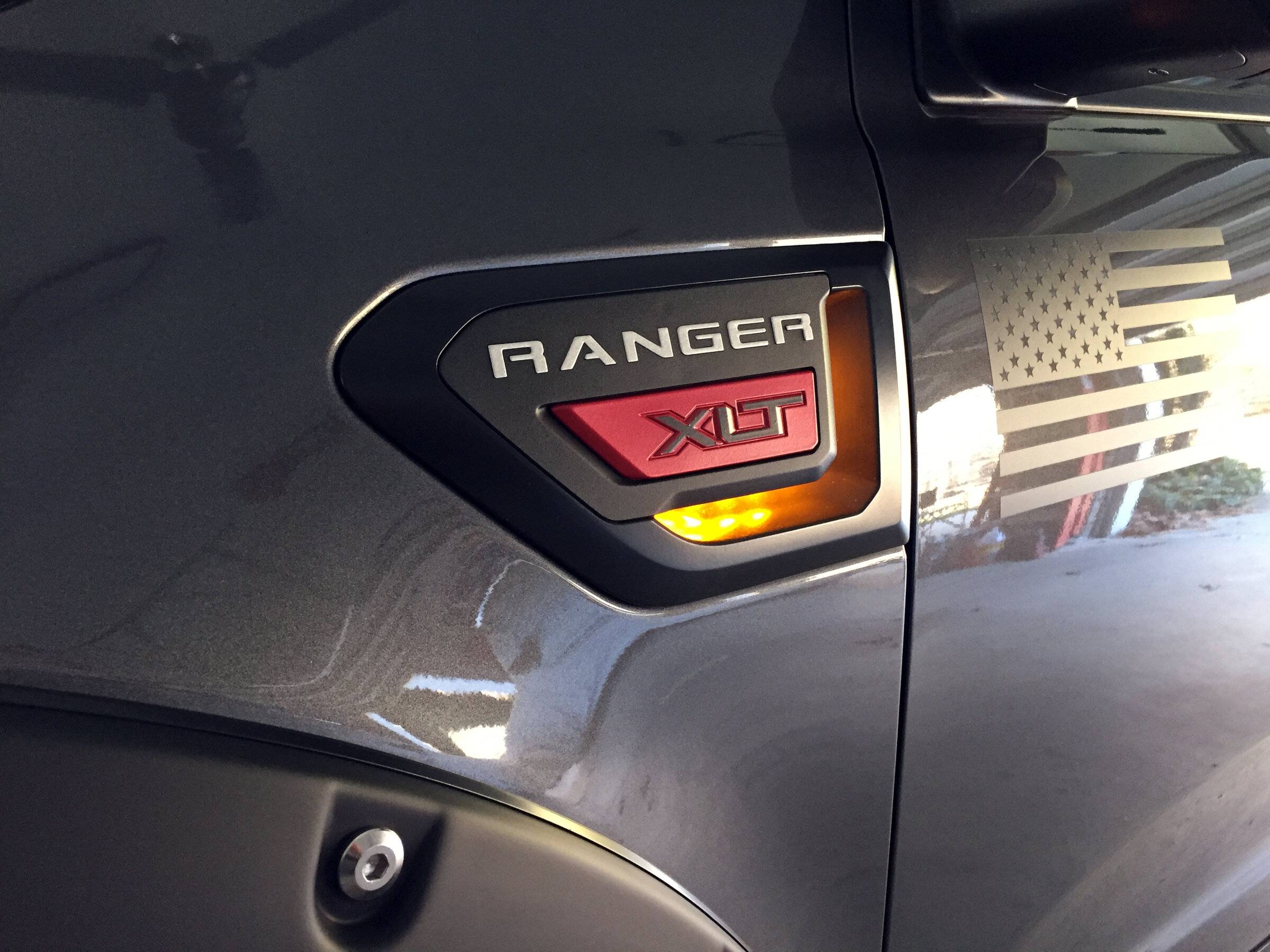

Since XLT gets the cheap mirror without a turn repeater...here's a solution I assembled today...?
Nilite 3.5" LED Amber strips fits nicely into the channel inside the trim...there's a hidden 10mm flat surface...application of adhesion promoter and the included 3M VHB tape, this will not go anywhere...almost like it was made for this idea...I'm intending this to be a dedicated turn/hazard lamp so to the blind spot vehicle, this will be a vivid surprise/warning...
Test power and fit prior to permanent adhesive bond...
Flip the turn signal and...ooo happy therapy...mmmm...Dopamine...?
Can't wait to see them in action tonight...I'll add MOV later...
I know this was a while ago, but did you just tap into the blinkers on each side? And since these are LEDs, did use any resistors to avoid any hyper signalling? Thanks in advance for answering an older thread ;)
9,191
28,344
Yes and yes...I have DD amber led turn bulbs so the resistors were necessary....these side repeaters are wired to the turn signals...

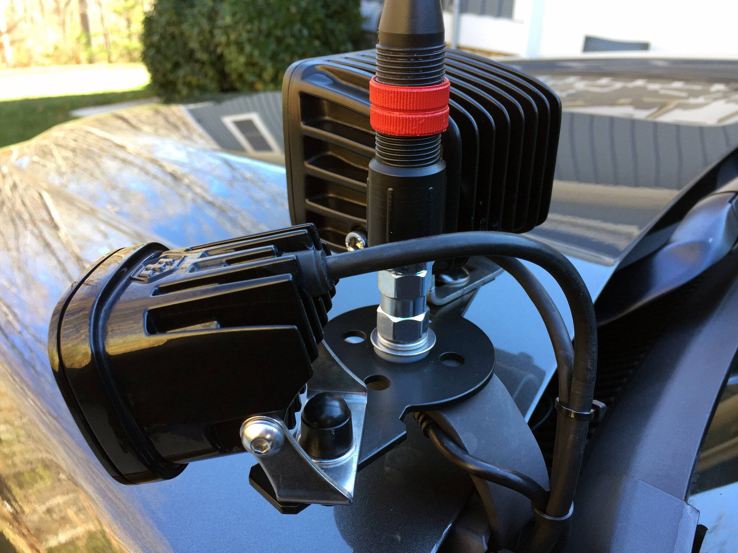

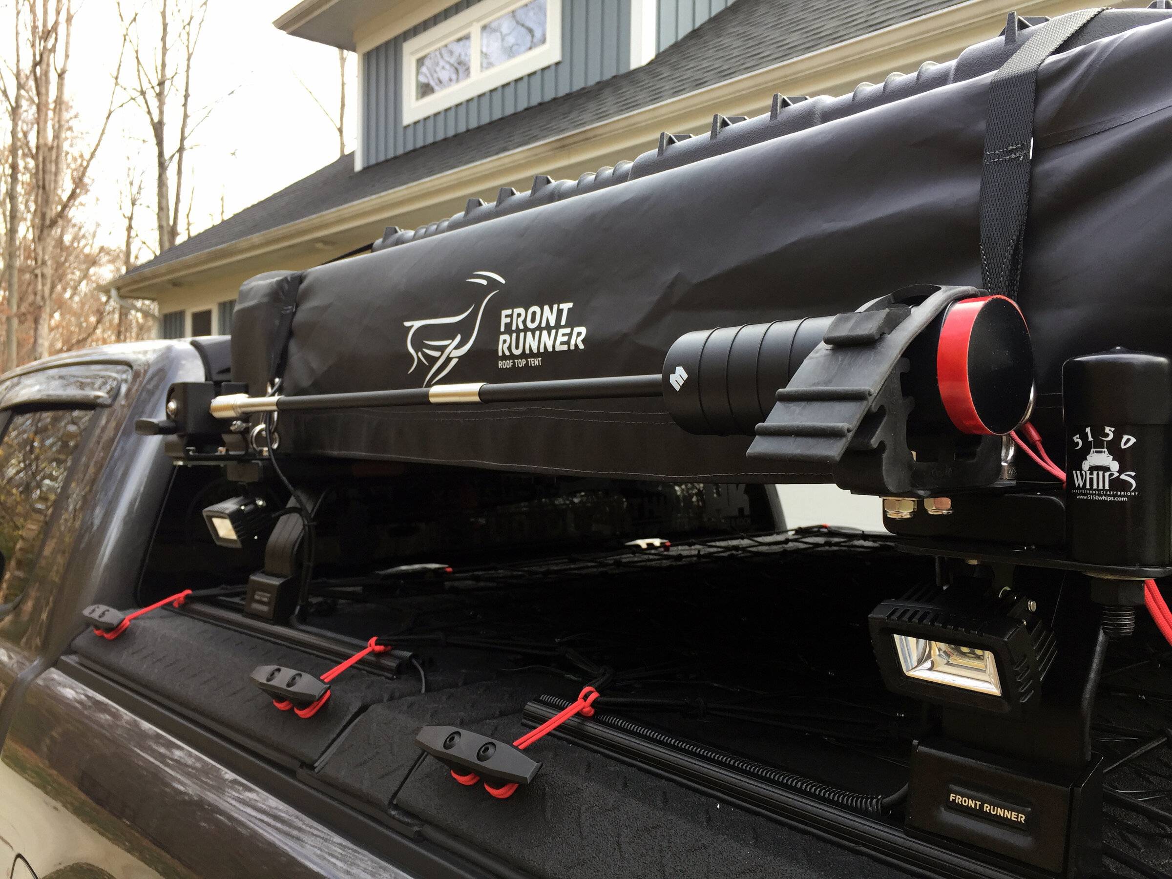

Thanks for your comment...as to your question...the usual must have like level/lift/big tires/wheels etc are the "expected" to give the Ranger the necessary muscle stance...I guess my favorites would have to be the one offs that are unique to my truck...ready for a photo dump??

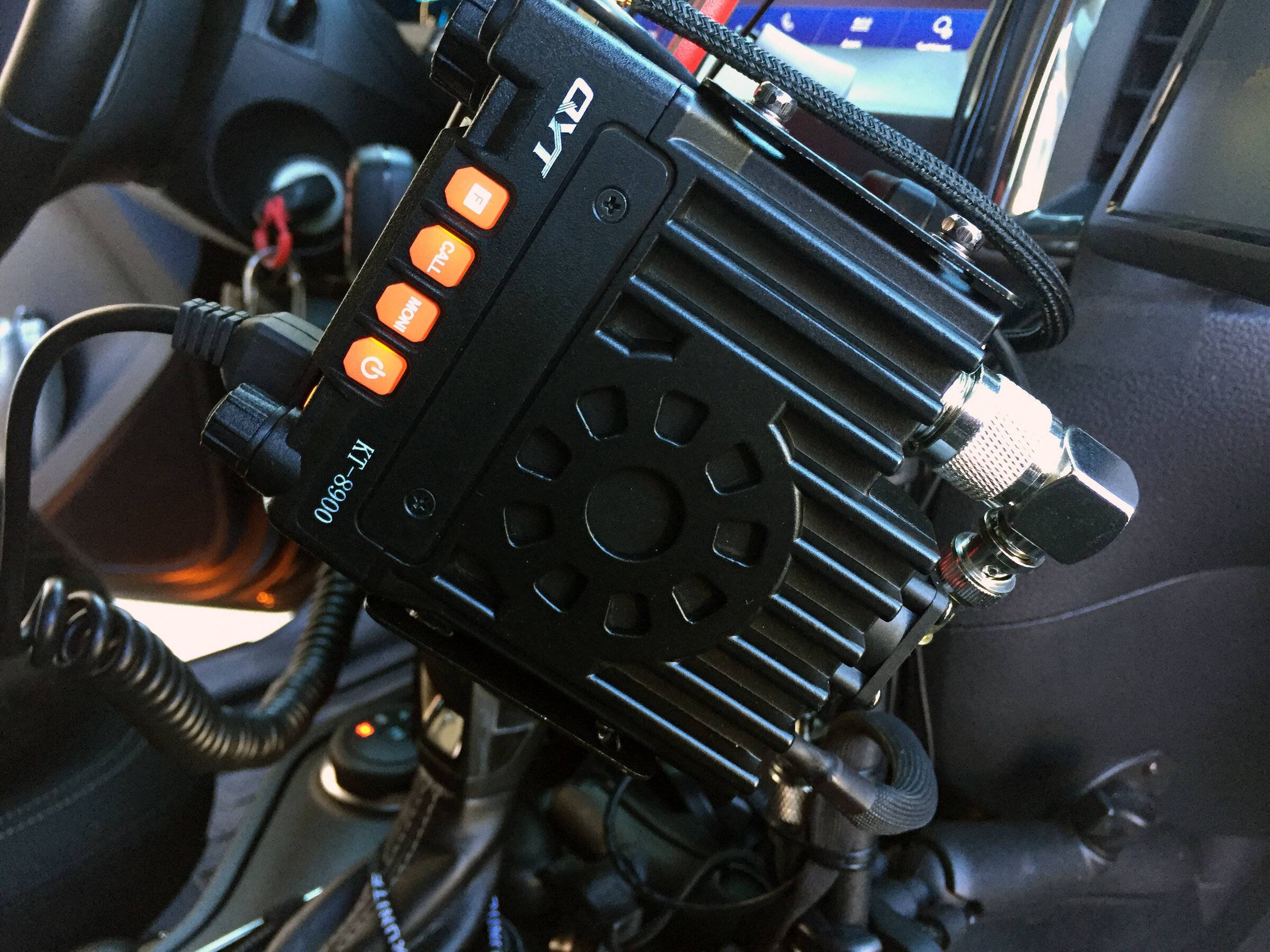

Mounting antennas on the ditch bracket...
Hidden side turn lights...

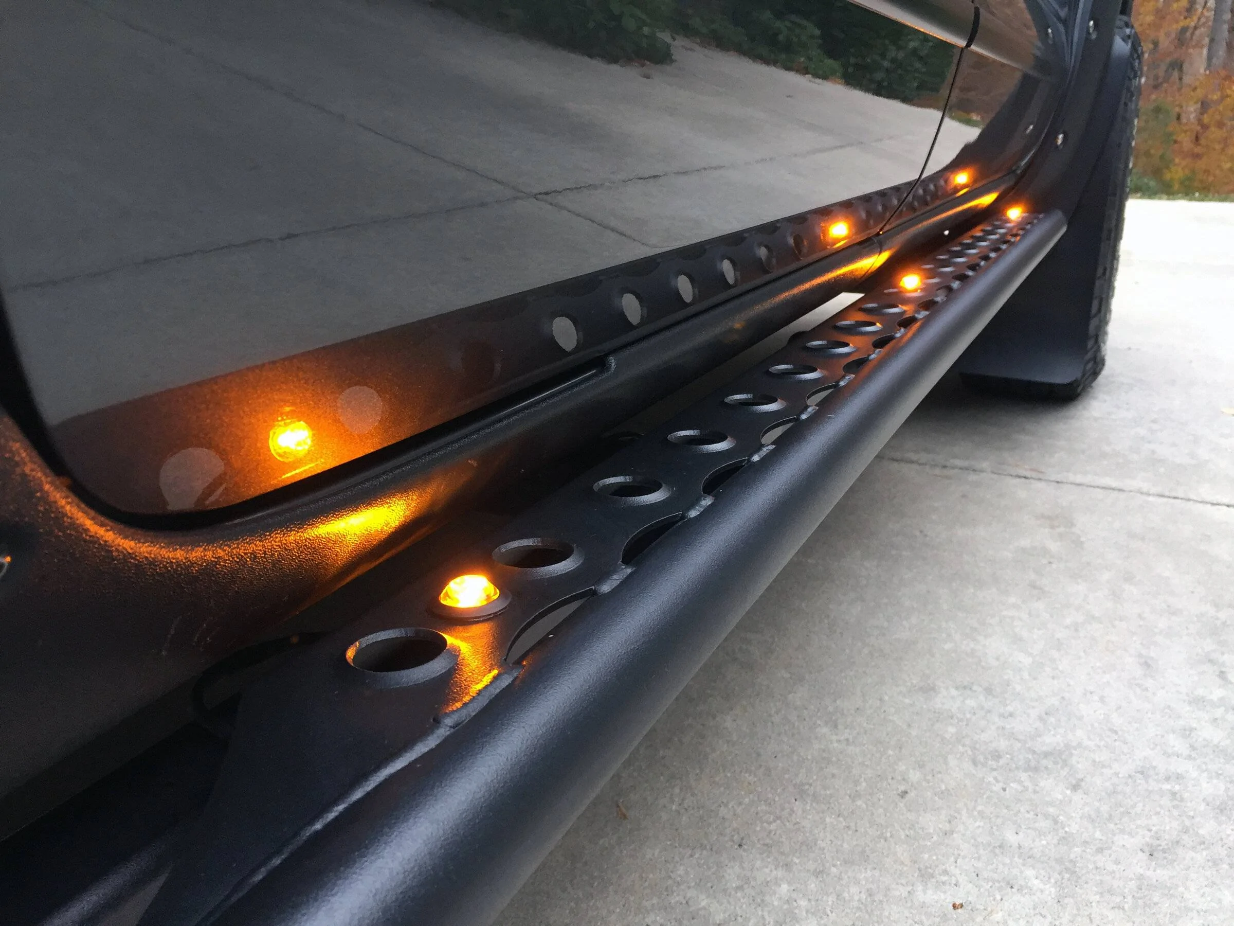

Custom slider lights...

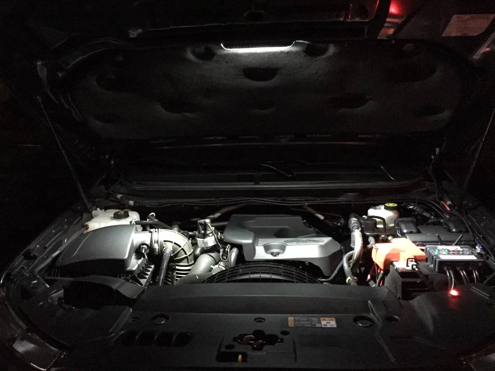

Custom under hood LED lighting...

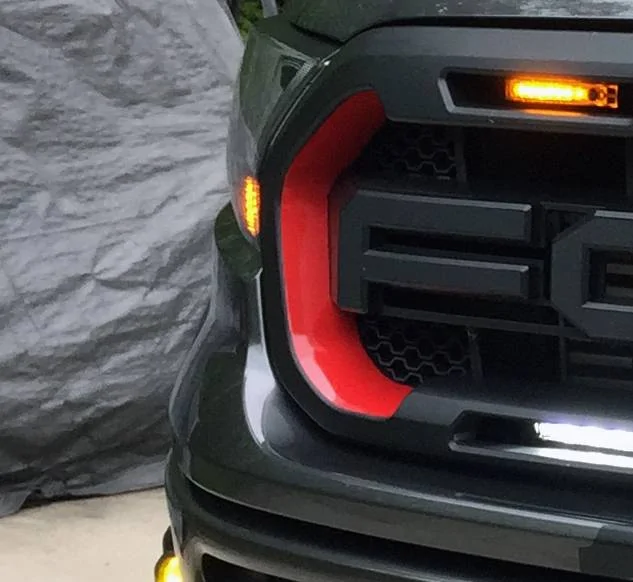

Tremor graphics on Raptor grill on FX4...wait...what? ?

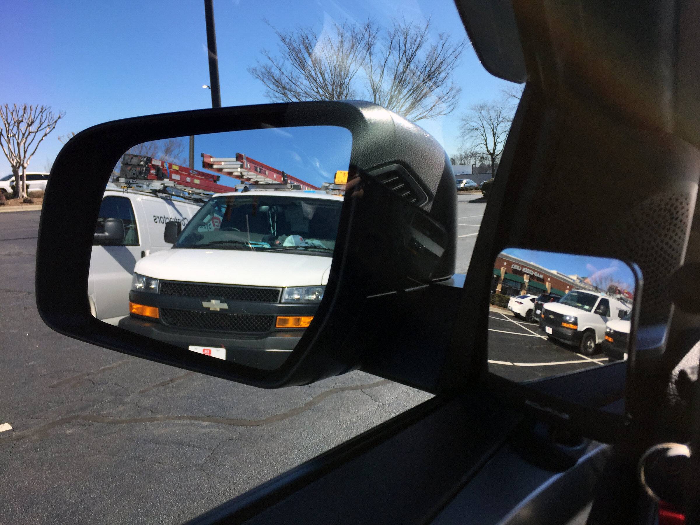

Internal blind spot mirrors...

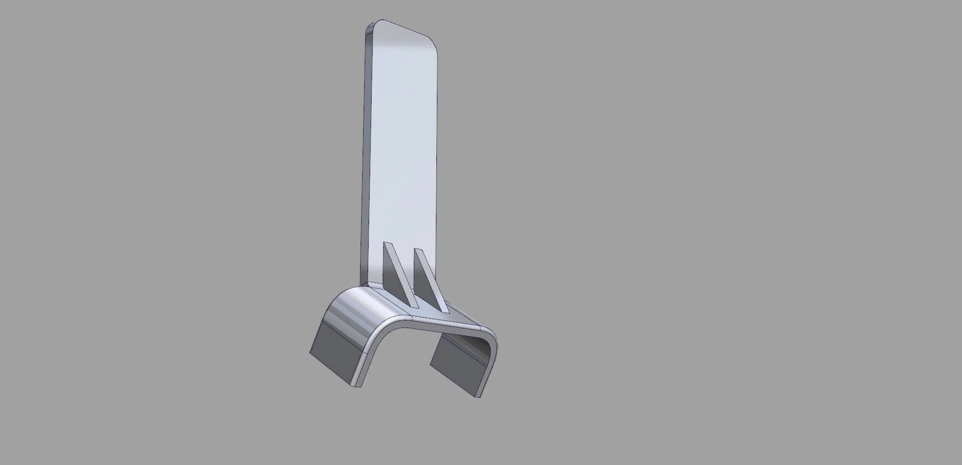

Hi Sid,
With two gussets...must be a heavy load for this bracket...must be another light bar, eh? Your poor overworked alternator....
