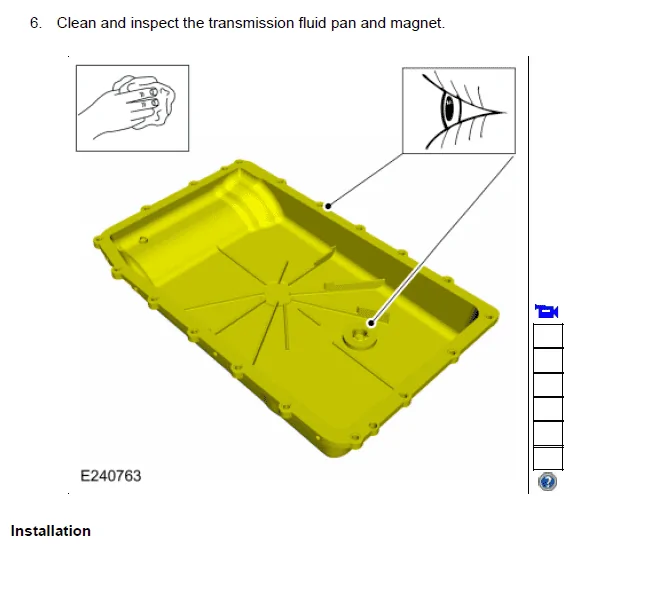

I will be reusing the existing gasket. It is designed to be reused. The plastic transmission pan is a disposable item, but people reuse them as well.
I'm trying to chase down any Ford documentation that the pan should be discarded. So far I've only found the assertion it's a one-time use part on PPE's site promoting their aluminum replacement.
Does anyone have a source of Ford service procedures that explicitly says not to re-use the plastic pan?

Other than PPE, where did you see mention of it being a one-time-use?
This just shows, clean and inspect and reinstall.
They specifically call out the filter and gasket as being reusable as well. Ford loves their throw away parts, so if it were the case, they'd clearly call it out.
airline tech
Aug 24, 2022
4,673
8,961
Midwest - KS
Aircraft Tech
Yes, the Filter is reusable - If not excessively contaminated with debris
Yes, the pan gasket is reuseable if not damaged
The Pan is Inspect and reinstall, no mention of discard and install new with pan or hardware.
Now since the manuals do not specify what to inspect, you want to focus on has the pan ever been hit on the bottom of the pan - Scrapes, Gouges Etc
Inspect the flanges of the pan for deformities or cracks Etc. that could affect the mating surface of the gasket.
But for me if I am pulling the pan, I am replacing the Filter and Gasket, it is not one of those procedures that I want to do over again all because I skipped a step to save money and be saying to myself I should of did that, now I have to pull it apart again - if it is leaking or shifting erratic.
