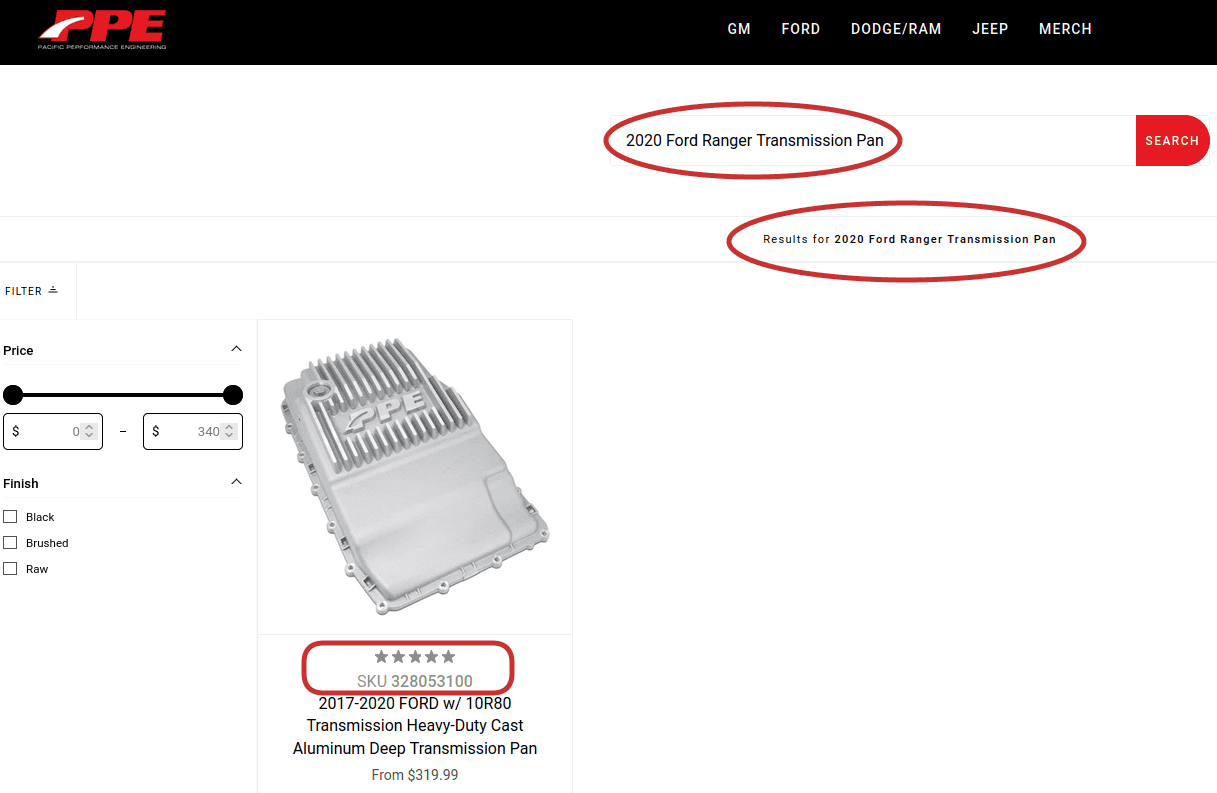

Interesting, I just got off the phone with PPE Support and raised the issue with them. I have the original deep pan Part 328053100 series, and was worried about the close fit of the oil pump to the base. I had read about the issue over on the F150 forum. I sent him all the details of the issue in a PDF document with Pictures.
He researched their sales and told me that no Ranger returns had been made on the part I had (i failed to ask how many had been sold), so it was good to go.
Now I see PPE confirmed the correct part for the Ranger is Part 328053600 Series.
I think that I'm gonna call them back again for more into.
Just performed a search on the PPE website for a 2020 Ford Ranger Transmission Pan and got the following result ....
The good news is that if I have a problem PPE support assured me that would "work with me to make it right"
Edit: I'd prefer to have a pan that I KNOW fits and won't damage my tranny oil pump.
I am still a little nervous about the apparent confusion on this issue. The good news it that PPE had my buyer info. And I purchased through a dealer who did not feel obliged to support me, even with information.

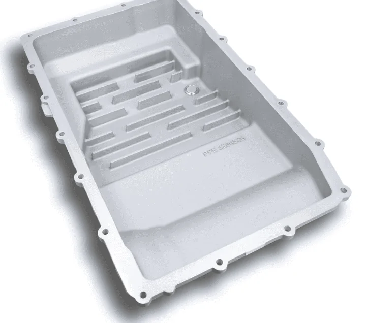

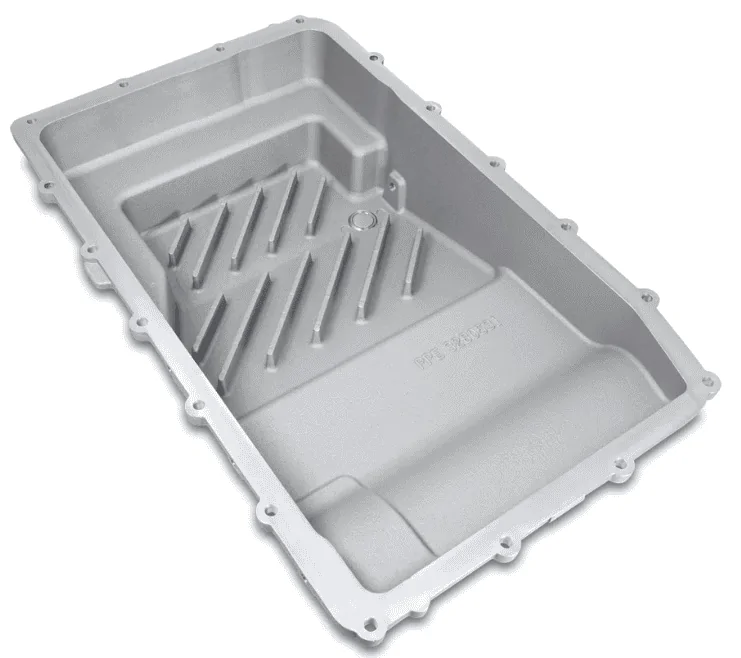

Here's a Picture of the old (on left) and new (on right) versions of the Deep Pan.
You can see the deeper shelf ridge at the front of the new pan.
That actually looks like a significant re-design. I wonder what engineering went into it - the change in the fins on the bottom and the clearances?
And what impact(s) it would have in the transmission operation as well?
I wonder if the regular pan was redesigned too?
