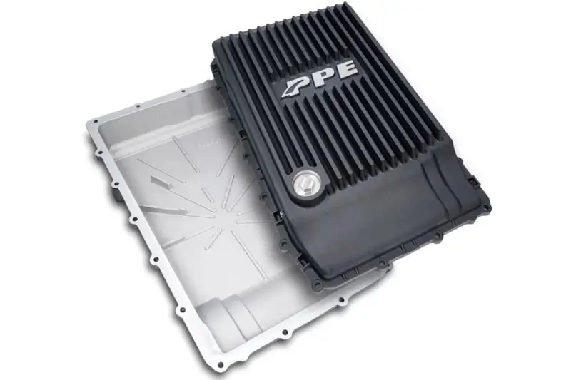

Hey guys! Hope y'all are well. I was combing through this forum but couldn't find a clear answer but how do I know of I have the deep or shallow pan from PPE? I got mine from Stage 3 and looking back they don't really specify the depth. Thanks for y'all time!
Got a picture?

This is the same image from Stage this website. Part number PPE328053220.
Link below lol
https://www.stage3motorsports.com/3...nger-ppe-black-hd-10r80-transmission-pan.html
Thanks for the help Frenchy!
That is the shallow pan. That said I prefer that over the deep pan for the Ranger. Why you ask? Because instead of trying to cool by increasing capacity you are doing it with cooling fins that were not there before. That little bit will make a huge difference when towing or OffRoad. Also you get the nice little drain plug
It doesn't really work like you might think.
The trans will still run at around 200 degrees, but, instead of dumping that heat into the truck's cooling stack, you're rejecting it to the atmosphere. So the cooling system doesn't have to work quite as hard to reject heat coming from the trans.
You DO see a bit slower warmup of the trans fluid, so it is getting rid of heat, just not much to see once things come up to temp.
I'm well aware of how it works. The way you state is correct. Will the transmission run around 200°F? Absolutely. Will it get up to 250°F? Maybe, but it will be much harder for it to happen
