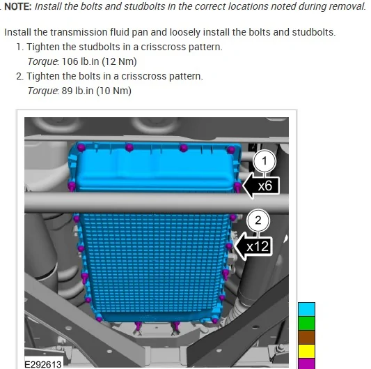

For Ref: OEM Pan Torque Specs
Do not know if PPE has a different set of specs
Ensure you have the (stud bolts) in the proper locations, they MAY be longer - not sure
Is your T-Wrench (calibrated accurate)?
Have you rechecked the torque since install and it's been heated up?
Since I do not have the PPE Pan - I have the following questions
Is the pan flange Thicker than the OEM and did they supply longer bolts with it?
If using the OEM bolts you do not have enough thread engagement for proper torque if the flange is thicker.
I would think the PPE pan being aluminum would be a different torque spec
Advice- Whatever the Torque Specs are
Start in the middle of the pan and work out
Stage the Torque in 2 or 3 passes - example for factory (stud-bolts)
First pass - 30 in lbs - 2nd pass 60 in lbs - 3rd final 106 i lbs
do the same for all bolts
Then after it has been heated up (driven) go back and recheck the torque
