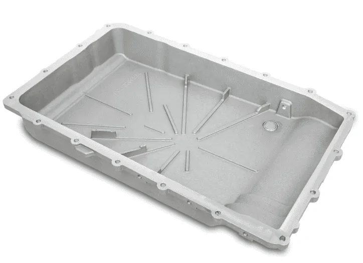

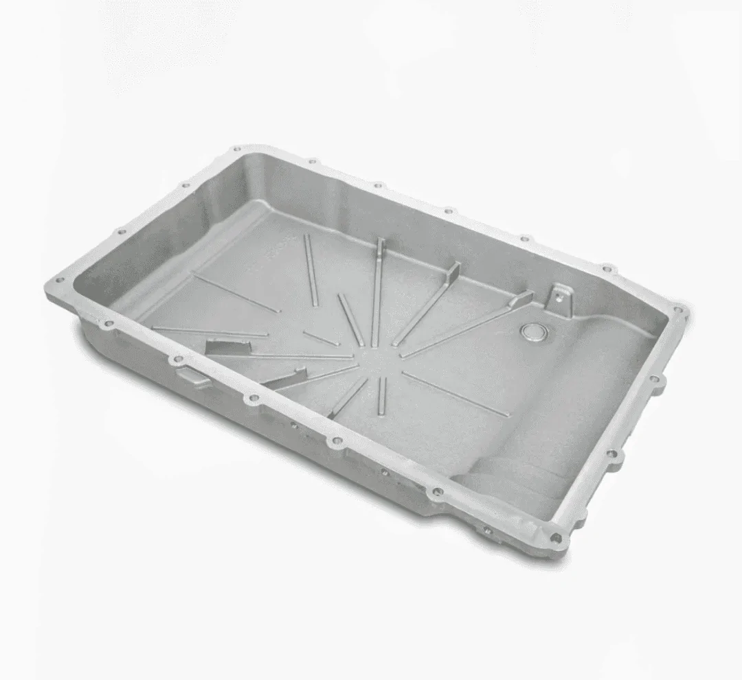

Here's a Picture of the old (on left) and new (on right) versions of the Deep Pan.
You can see the deeper shelf ridge at the front of the new pan.
The new pan doesn't have the seam in the lower left and the bolt hole? on the right. Maybe that is for a temp sensor. I guess that would be redundant on the Ranger. Gotta watch out these things, sometimes the new version is better and sometimes they do a little "cost reduction".

It is interesting that their photo doesn't show probe sensor port. I hadn't noticed that. Good eye!
TJC
Aug 28, 2020
47
4,117
10,496
That actually looks like a significant re-design. I wonder what engineering went into it - the change in the fins on the bottom and the clearances?
And what impact(s) it would have in the transmission operation as well?
I wonder if the regular pan was redesigned too?
From an engineering perspective, I noticed that the old pan's diagonal fins route the fluid to the magnetic drain plug. Perhaps to catch ferrous contaminants from metal wear. Think about fluid flow movement as the truck (de)accelerates.
The new pan seems more intent on slowing the fluid movement before the fluid is pulled into the pump allowing sediment to settle.
Just a guess though.

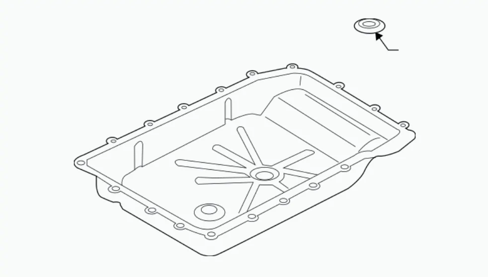

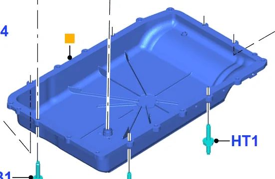

Here's the PPE standard pan vs the Ford Plastic Pan (image from Ford Part Catalog). PPE has not updated this pan.
inside looks very similar to the Ford Part EXCEPT for the drain plug.
PPE selling point on the standard pan is the cast aluminum construction with external cooling fins, magnetic drain plug, and an extra .75 qt capacity.

Answering my own question, merely the difference between stock and the 3/4th quart larger 'standard' pan - the inside of the pan:
Stock illustration:
And the PPE aluminum pan:
More capacity and a better heat conductor seems like a nice upgrade. I guess the casting next to the drain is the temp probe port.

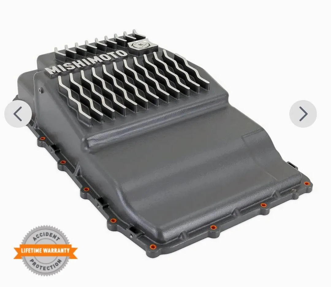

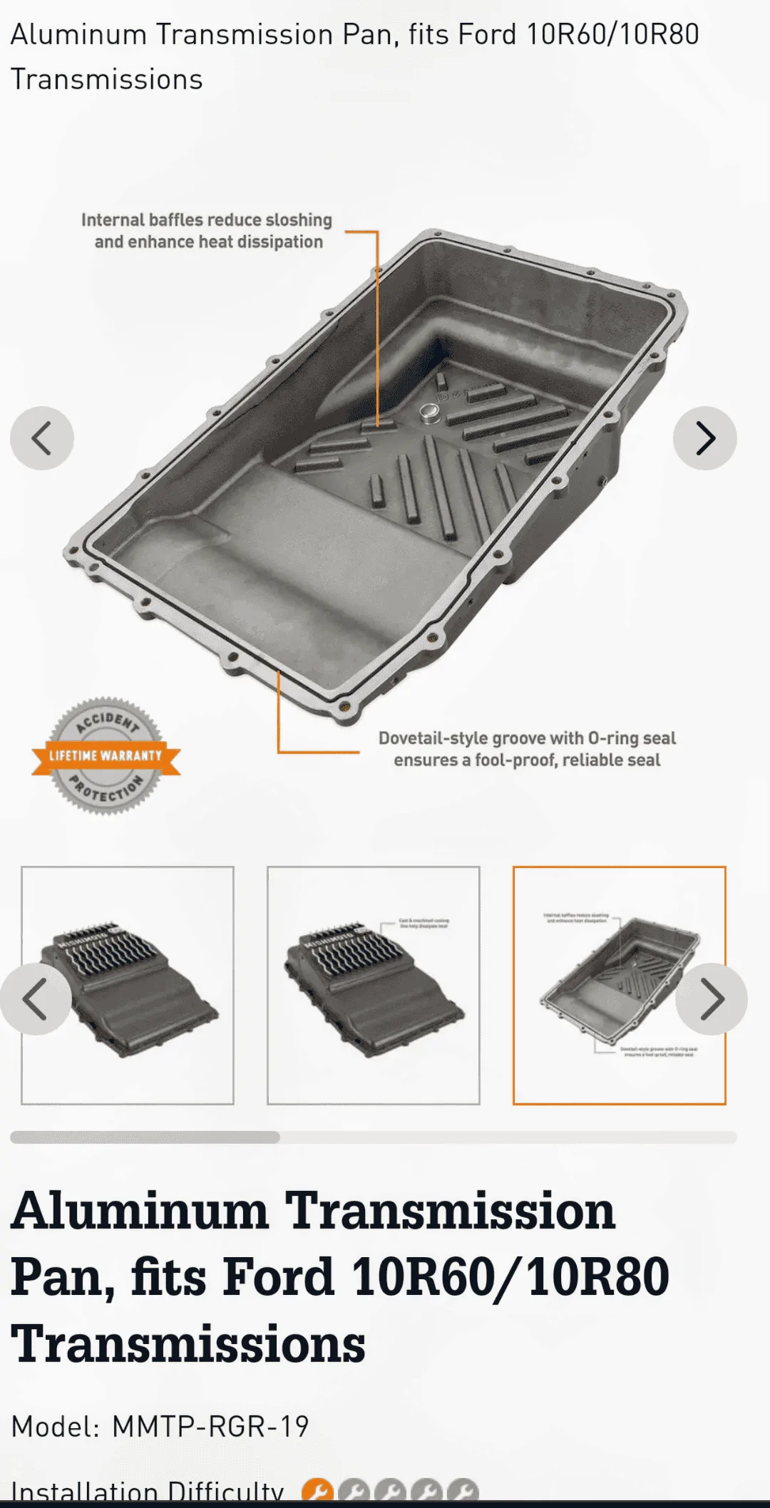

Some searching on line turned up B&M makes a pan for the 10R80 as well as our friends at Mishimoto:
Their web page says it holds three additional quarts. The external fins are different and the finish is grey that might sort of go with my metallic grey. It would be the second Mishi part I get although I'm really leaning toward the 'standard' PPE size. Summit's website says it doesn't increase capacity but we know better.
Another pic from Mishimoto (notice different internal baffling - better for draining?):
