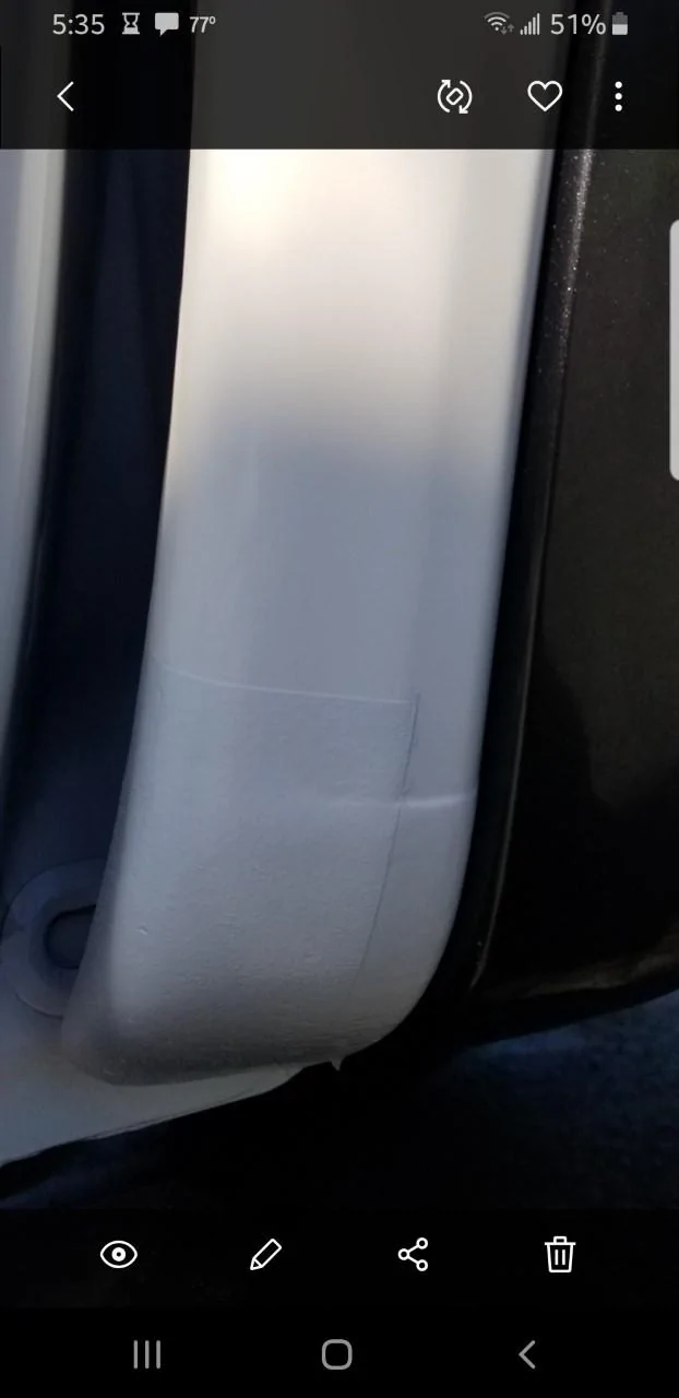

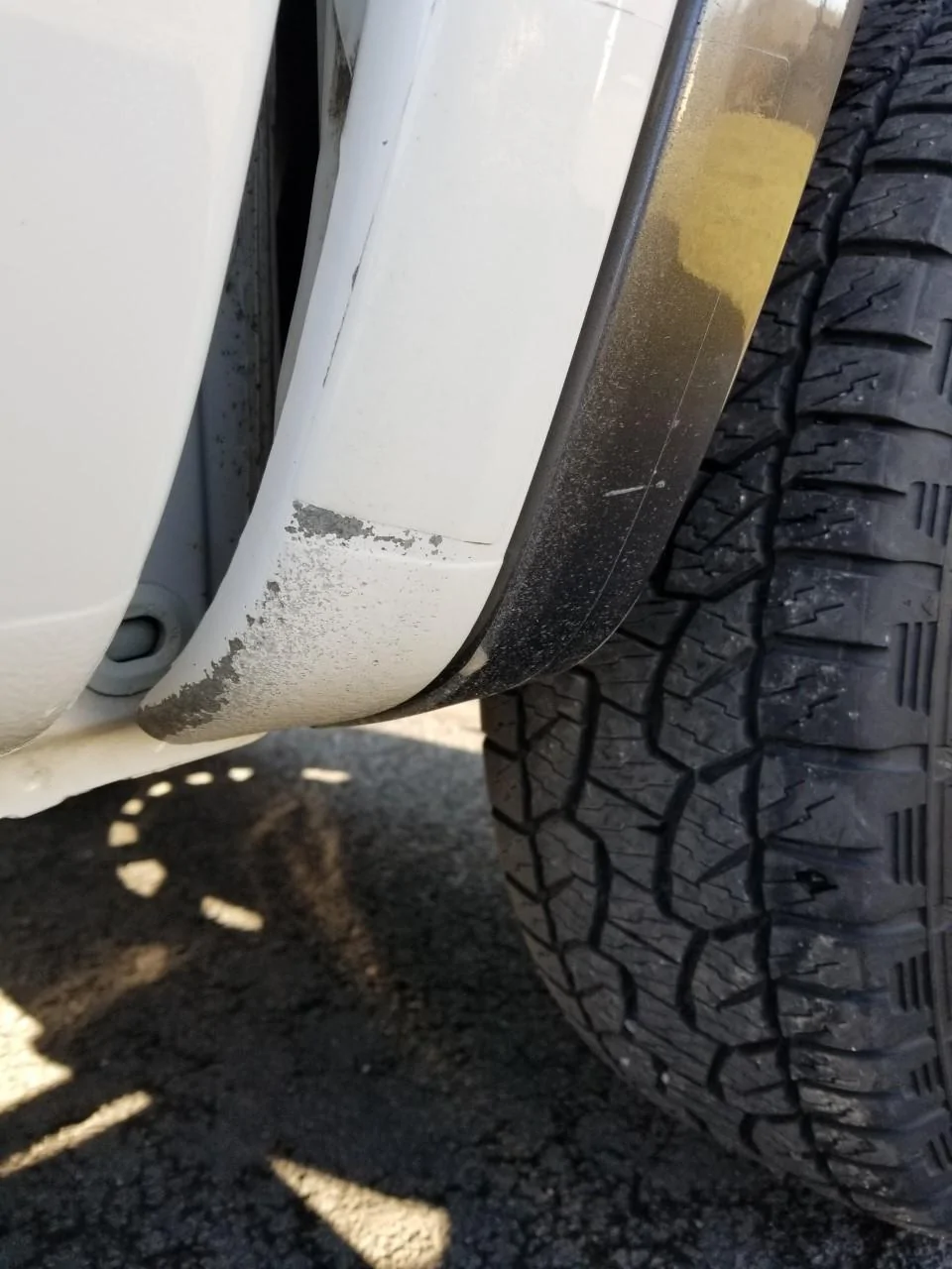

Finally found time to repair it. Duplicolor Oxford white can $9.99 and Duplicolor clear $10.49 and some RustOleum bedliner that I had in my garage. First I tried to just use filler primer, but it wouldn't fix the chips in the factory rock guard. I had done a complete repair otherwise, but wasn't happy with it. I then masked off and did the bedliner to cover the deep chips in the factory stone guard. I then wet sanded the whole thing and went over it with 4 light coats of the White before doing 3 light and one heavy clear. It looks 95% better than before and for a day's time (all day with proper drying) and $25, I'm happy. I ordered some 3m clear to go over it, but I'm gonna let it dry good for a week or two before I apply. I did remove the wheel trim, wet sanded and re coated with multiple clear coats. It looks almost new. FYI, the moulding is very fragile!! You need a plastic trim tool and patience. I pooped off one of the molded fasteners, but luckily it glued back on no problem. Even the plastic trim tool wanted to leave marks in the molding. Very flimsy stuff!! The white isn't a perfect match, so I had to "feather/blend"(??) it in by working my can away and almost leaving an over spray. I then did the clear as mentioned, I let it dry 48 hours bfore doing a wet sand with 2000 grit followed my some Megs ultimate polish when I was done. It blended in great. At first I tried to mask a hard line, wet sand and then polish, but it was pretty noticeable, almost looked like a shadow line...
