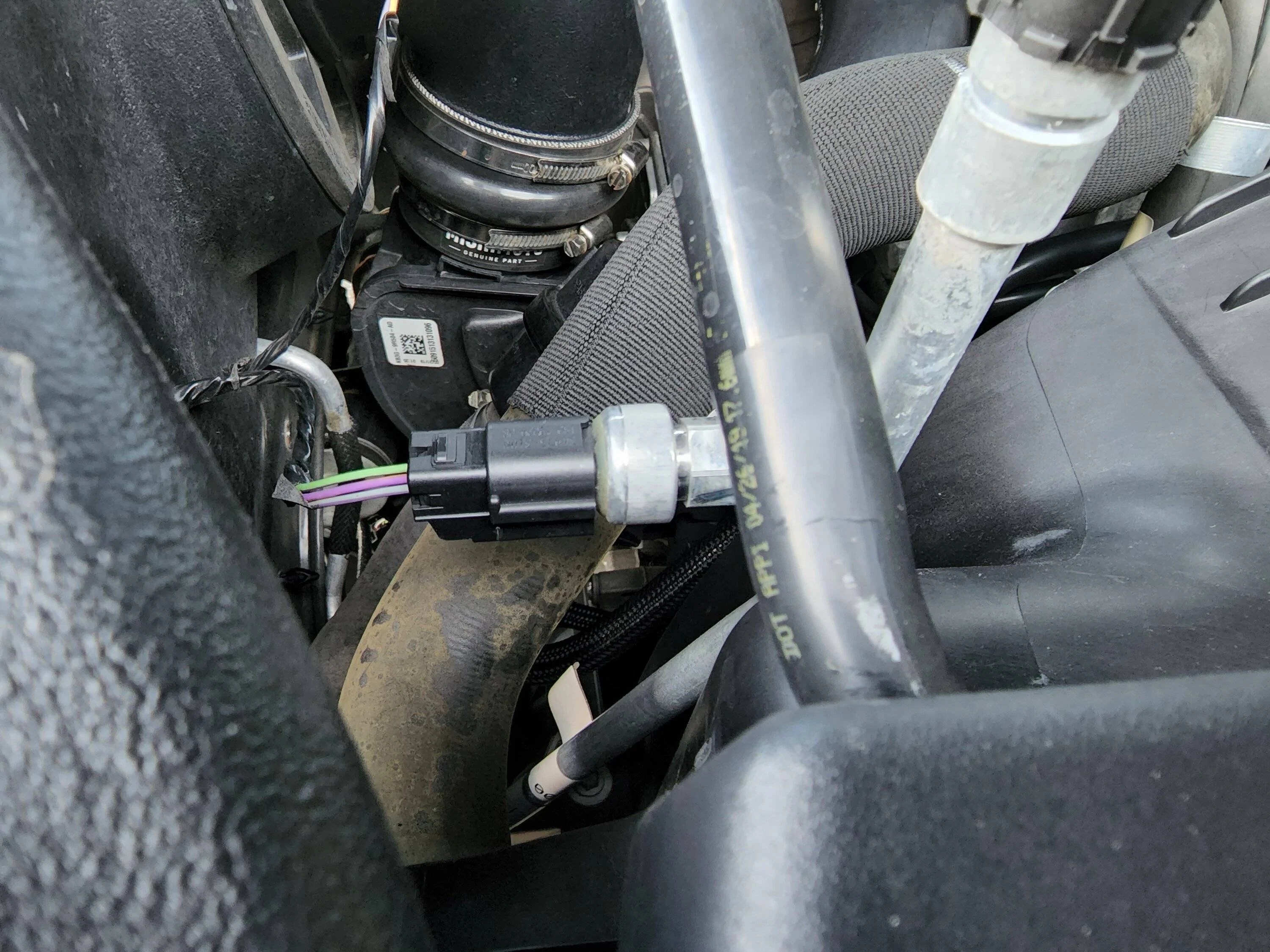

So the blend door issue may still be happening. You might not be getting a blend door situation where the hot air is completely blocked off, and well, it's still blending hot air with the cold air to give you 60° air.
I've also seen a pressure switch bad in a BRAND NEW 2.3 Bronco AC system, and it was doing the same thing. Just something to consider, maybe?

I can change out the pressure switch - can anyone confirm it is part #HG1Z-19D594-A?
