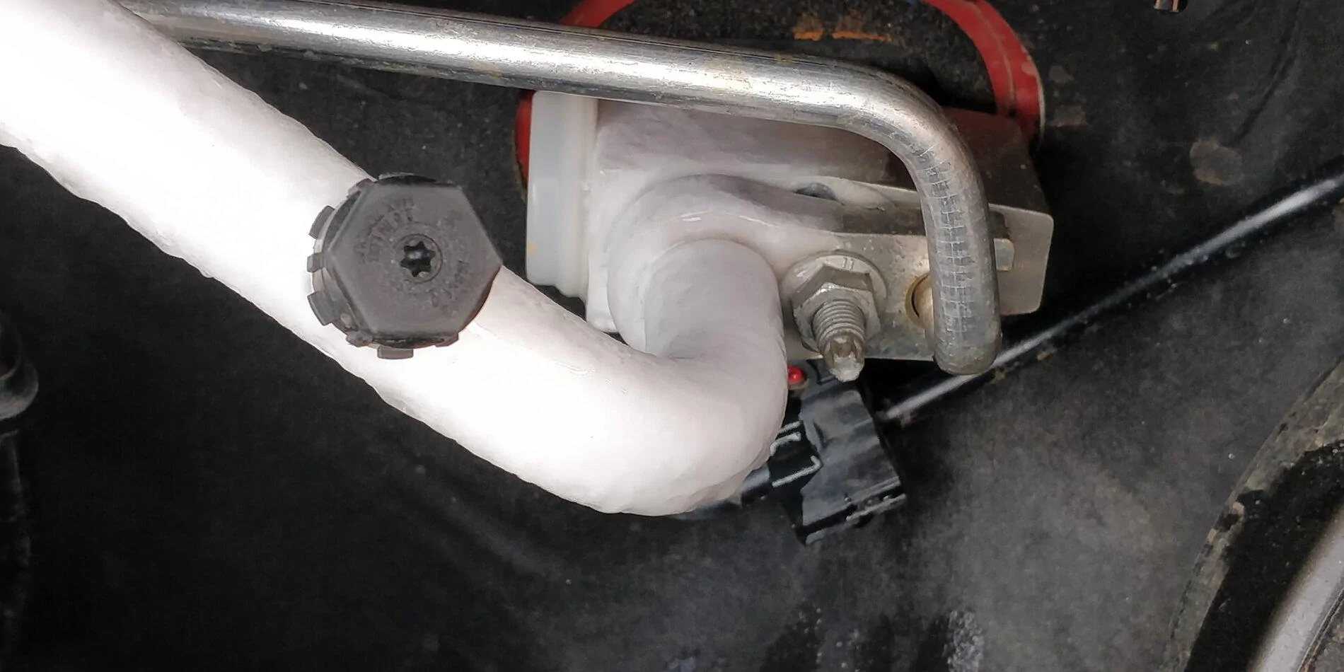

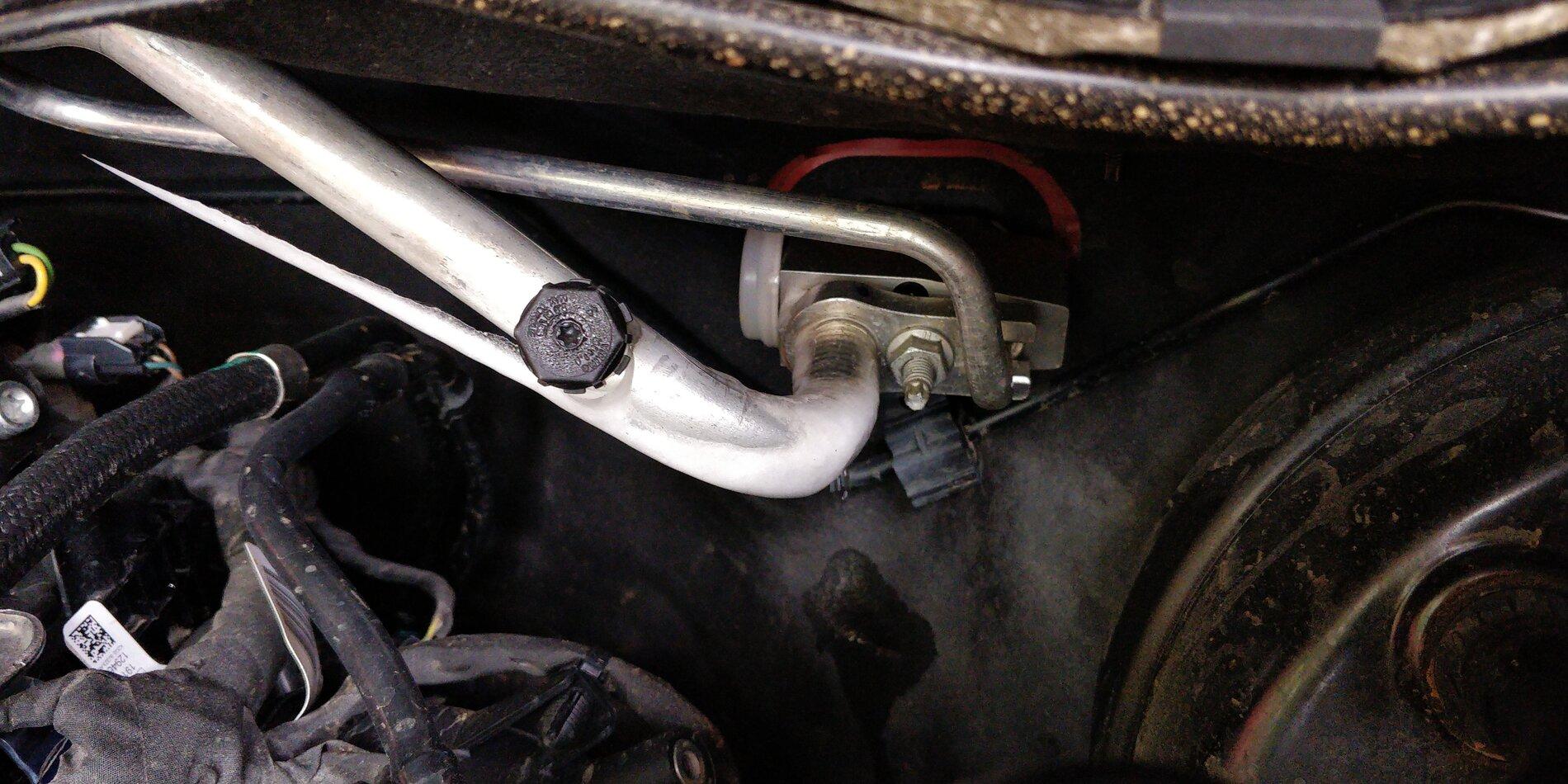

Hey y'all,
Anyone have any issues with their AC freezing up on them, or just me?
Outside temp was 85°
Climate temp was 74° on auto setting
Noticed the truck starting to get a little stuffy inside, so I bumped the AC down 2 degrees thinking the auto would take over. Nope, no changes. Felt like vents were blowing weak.
I pulled over and took out the cabin air filter to check if it was clogged. No problems there. Filter looked good to go and didn't help with the air. I left the filter out to further diagnose the problem.
I then popped the hood to check the compressor and lines because, why not? Lol
Turns out there was major freezing on the coolant lines.
Anyone got any ideas on what might cause this?

could be a few different things...pressure switch issue, refrigerant levels wrong, thermostat control issue.
regardless it needs to go back to the dealer I think.

Looking at that the main thing that will cause that is a restriction in the low side before that point. The most likely cause is the TXV/or expansion valve. Very possible you have a faulty one.

Take a picture of the frozen lines. They saw my pictures and didn't bother trying to recreate it. Sadly, the compressor was on back order forever. So here soon I'll have parts. :)
