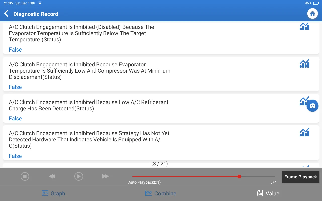

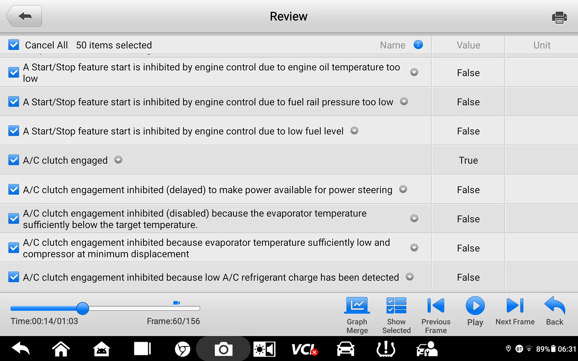

I have been working on building a (PID Reference) Database of normal for ALL PIDs and will be setting up some (Custom-Ref) PIDs as well, including all the AC System in one set and many others such as the - Transmission (Test Drive) PID Monitor for a ref point of what we should be seeing during the drive - in an attempt to highlight exactly what is happening as far as pressure when the transmission starts the (Harsh Shifts) - just for a knowledge addition and curiosity.
anyway, here is a couple pages of the complete (PCM) database run @ Idle parameters and note AC was off and only using heat -so the 68.44 PSI is just static system pressure with the current ambient temp and engine bay temp from idling.

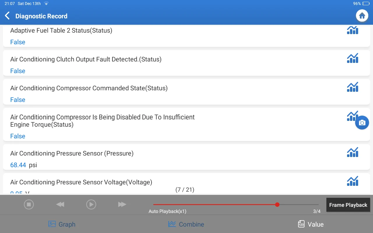

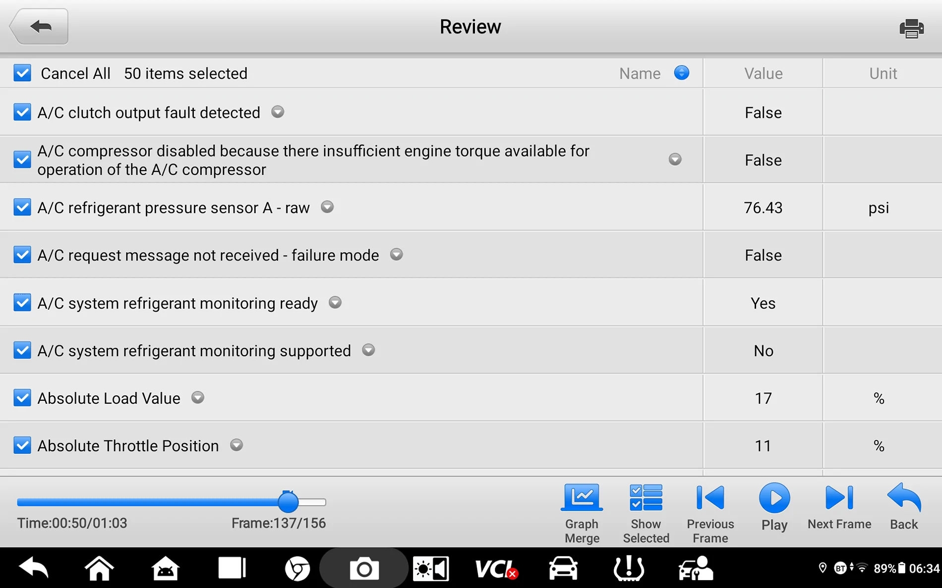

Here are a couple more from my Autel:
