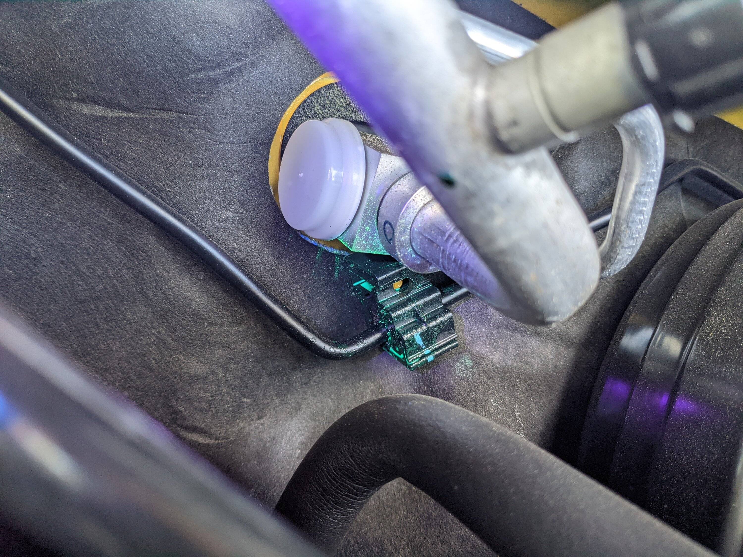

OP, did shop explain or show you how your compressor failed? 47k is extremely low mileage for compressor failure.
Possible that if there was a leak the oil left with the refrigerant, if the compressor kept trying it could burn up, I think there is a sensor that would have prevented the compressor from working if the system pressure was too low. But I know that my compressor was still trying when it was low enough to have crazy noises from the system, so I pulled the compressor relay to prevent damage. Ford couldn't get the seal kit I needed so I had to source that myself for them. I bought $13 seal kit, they gave me $25 Ford Performance shirt for my troubles.
