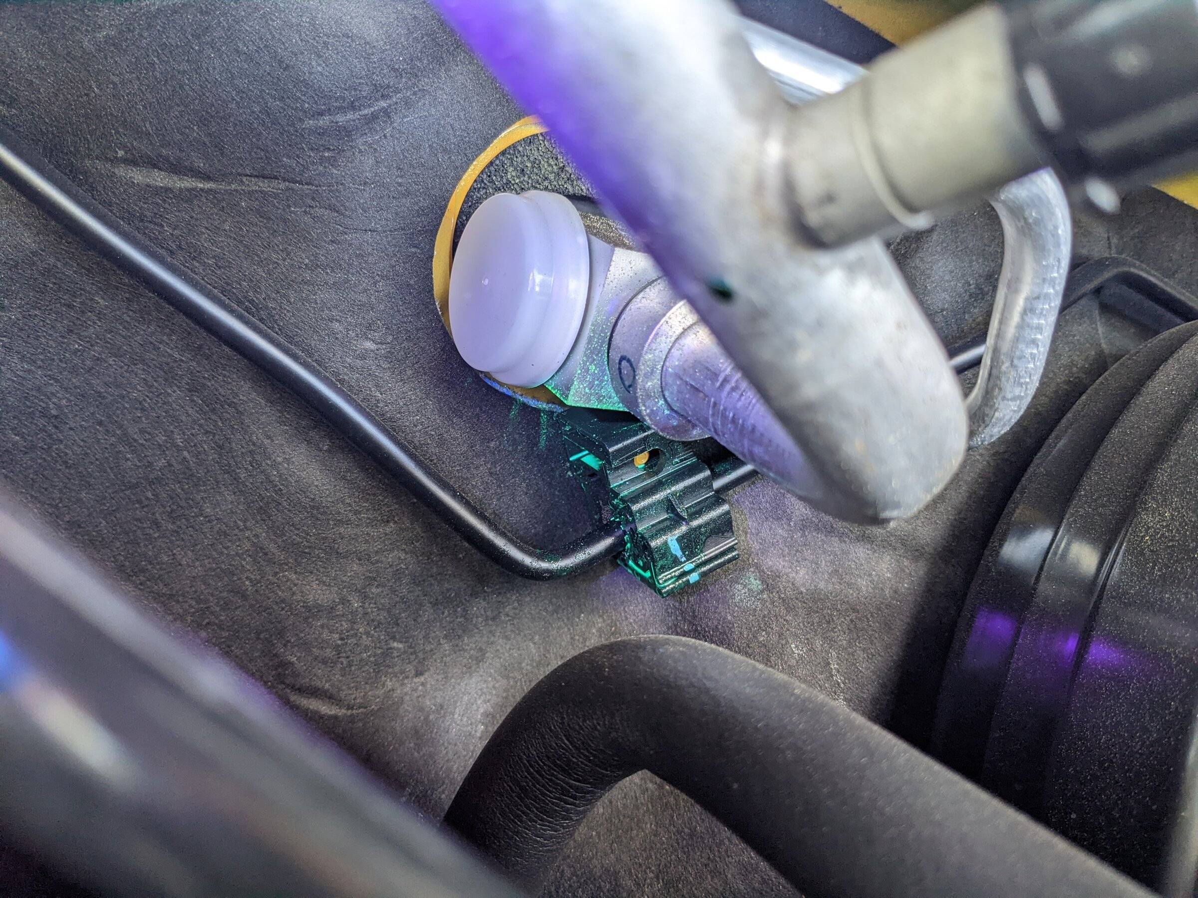

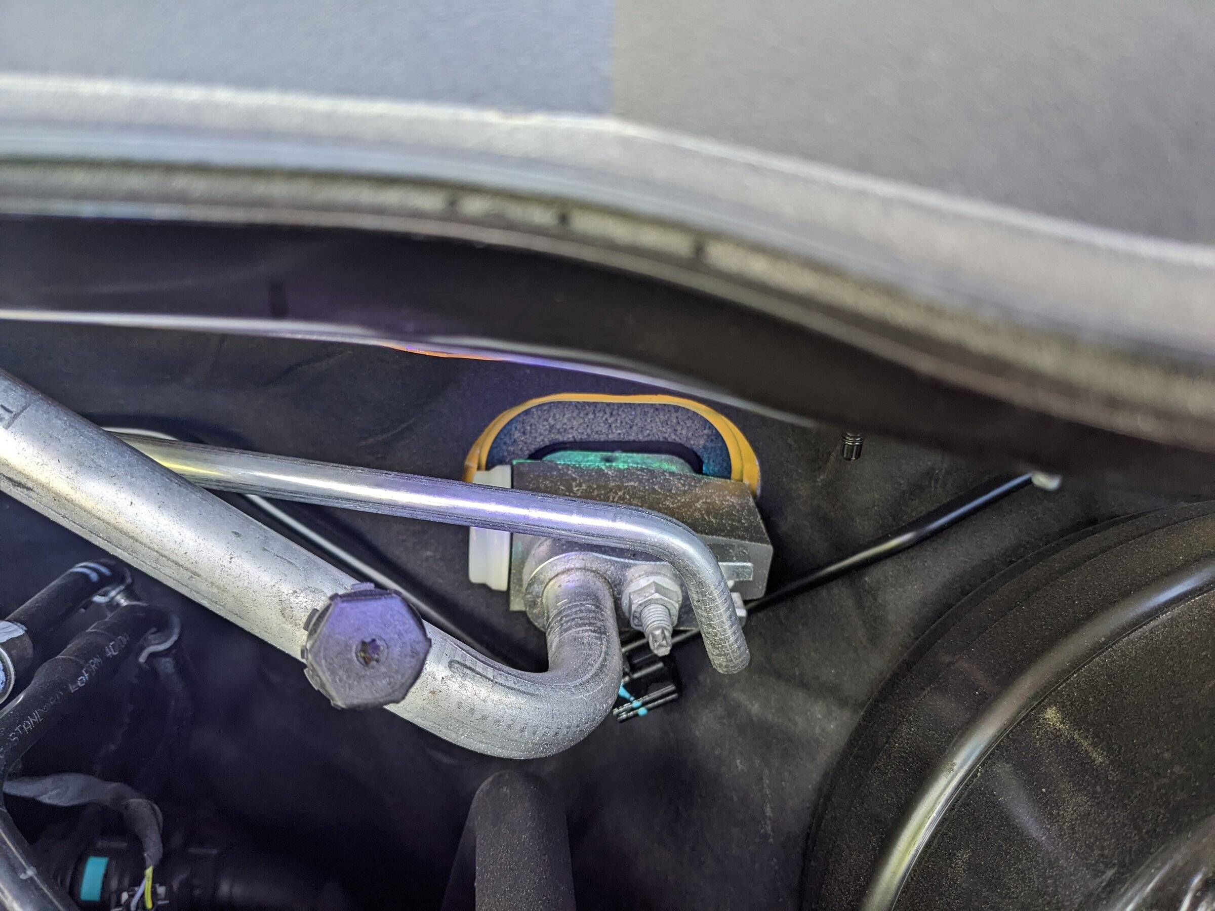

My black light arrived today. And I think I found the problem with mine, looks like a leak between the thermostatic expansion valve and the evaporator. Emailed the pics to the service advisor. And suggested they consider having new seals for that service on hand and hope they don't find any other leaks.

And went to my appointment today. The tech refused to look at the pictures I sent so there was no attempt to order parts in advance of my appointment. I was advised they need to order a seal kit that is on "galactic back-order". No ETA.
