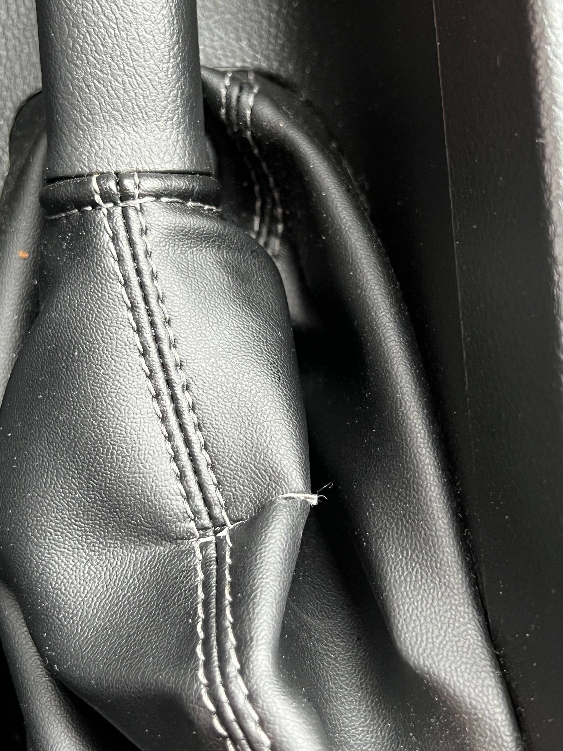

Guys, Thanks so much for the Parking Brake work with Redline. I've been all over the internet looking for a leather replacement and was about to come here to research, but saw a picture in my web search with the cracking issue, clicked it, and it brought me here anyways. I got my 2020 XLT on October 31st, 2020 and the cracking started around 8,000 miles (now have 10,500 mi.). I'm in Settle and the pleather sleeve was always stiff no matter the temperature. Also someone mentioned if you give your e-mail and walk away for a day they send you a 10% off code. Their site offered it to me as soon. as I clicked the button to look at the bi-color options. Anyways should be here in a month. Just wanted to express my gratitude, especially because the price was reasonable. Now just need to wait for the shifter knob version to come out, and maybe the arm rest.
Thanks again and see you around.

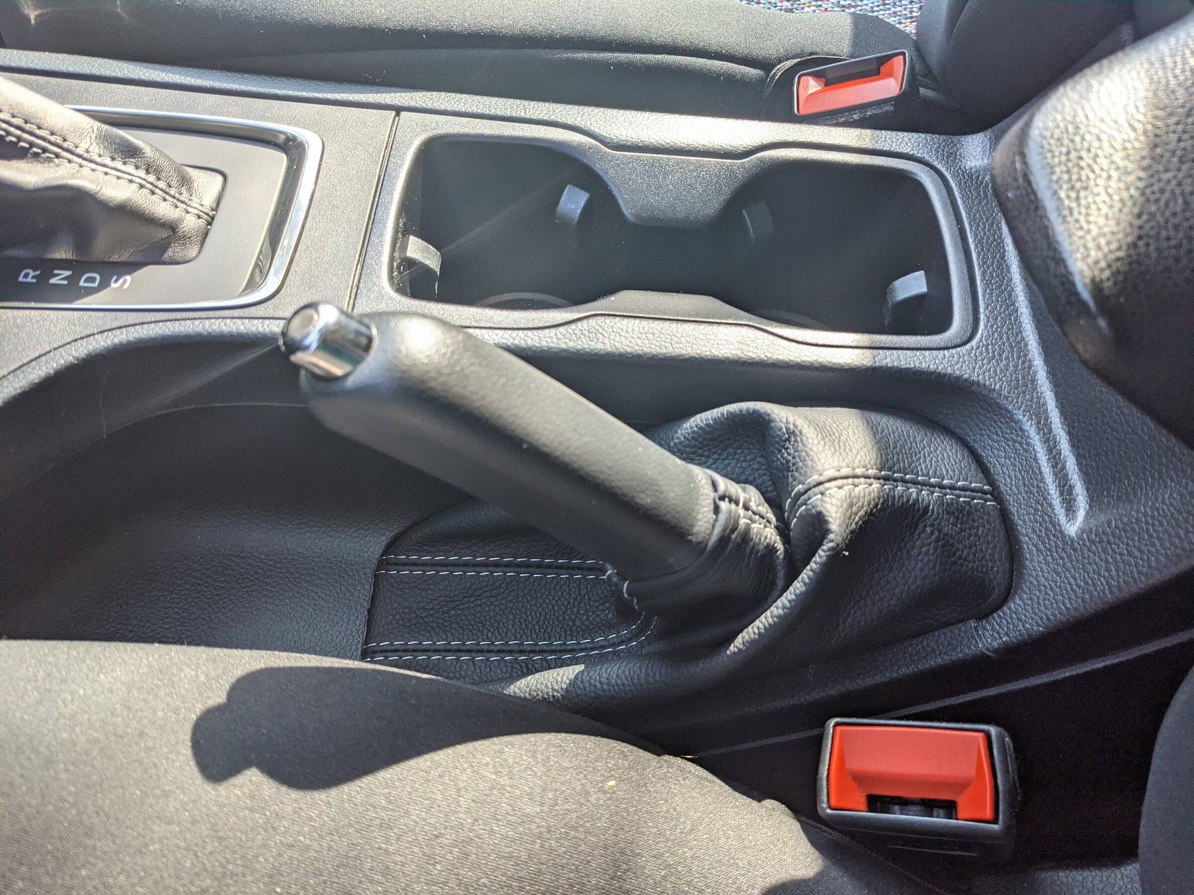

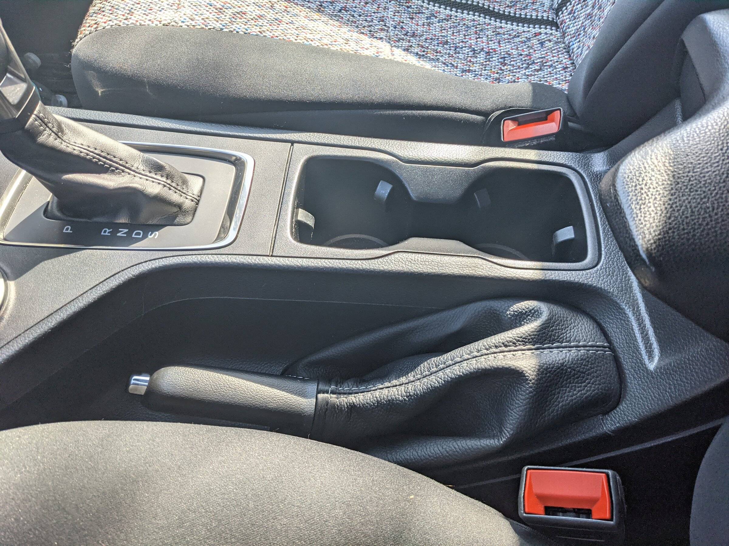

Pretty easy, take your time. Not hard at all.
To remove the original, start in the back, pull up and work your way around. Once you see how it works, it makes sense. Remove the boot off the old ring, install the new one. I uses a dap or two of Gorilla glue, and then set it in the sun to cure. Install and done. Maybe 30 mins. I took my time.

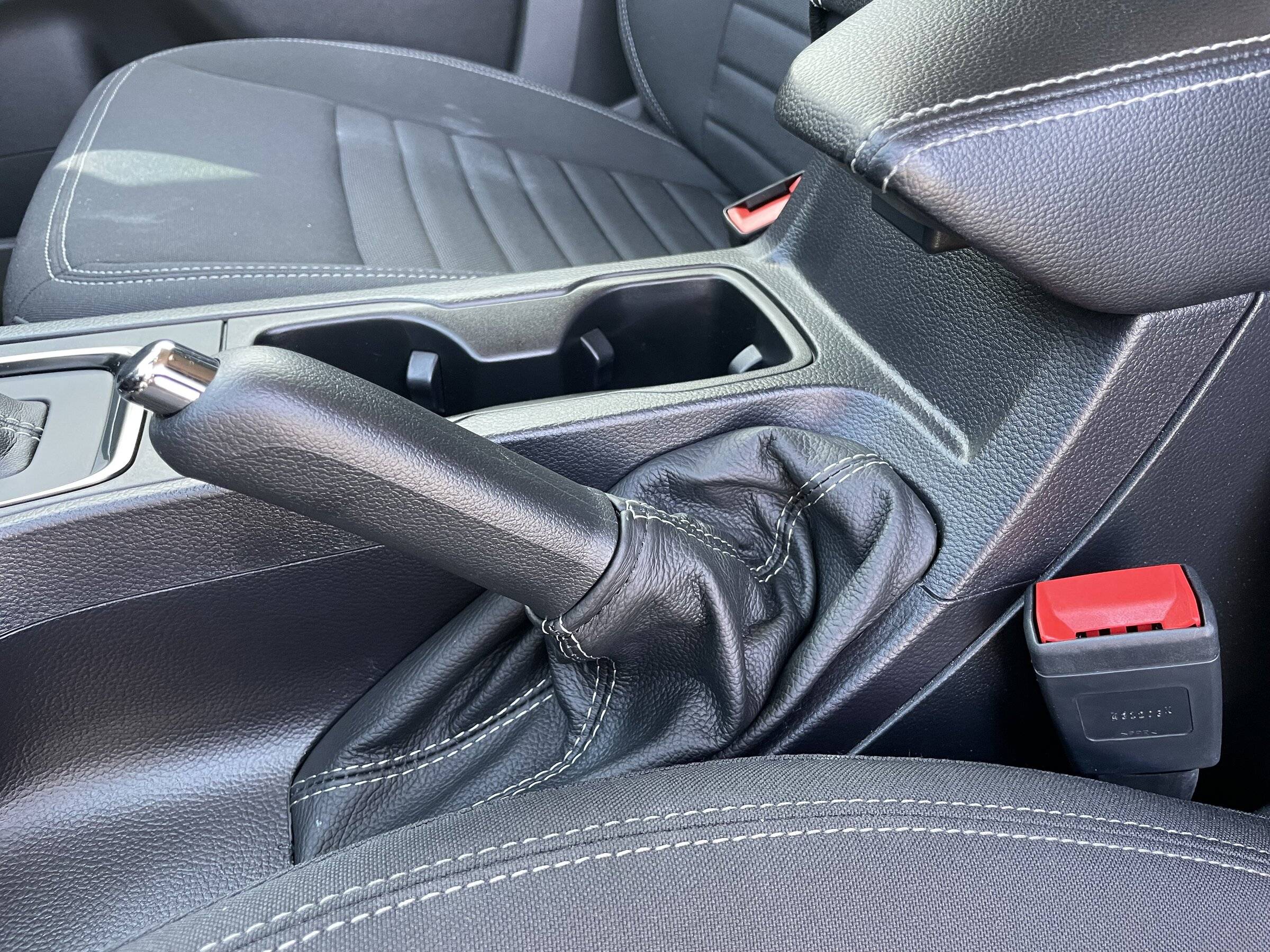

Redline boot is on. Looks like factory and as expected much higher quality, way more flexible. This is their black regular leather and silver thread.
That looks great - thanks for the pics. =)
