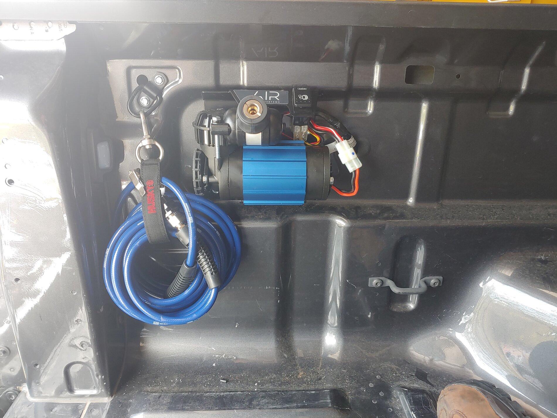

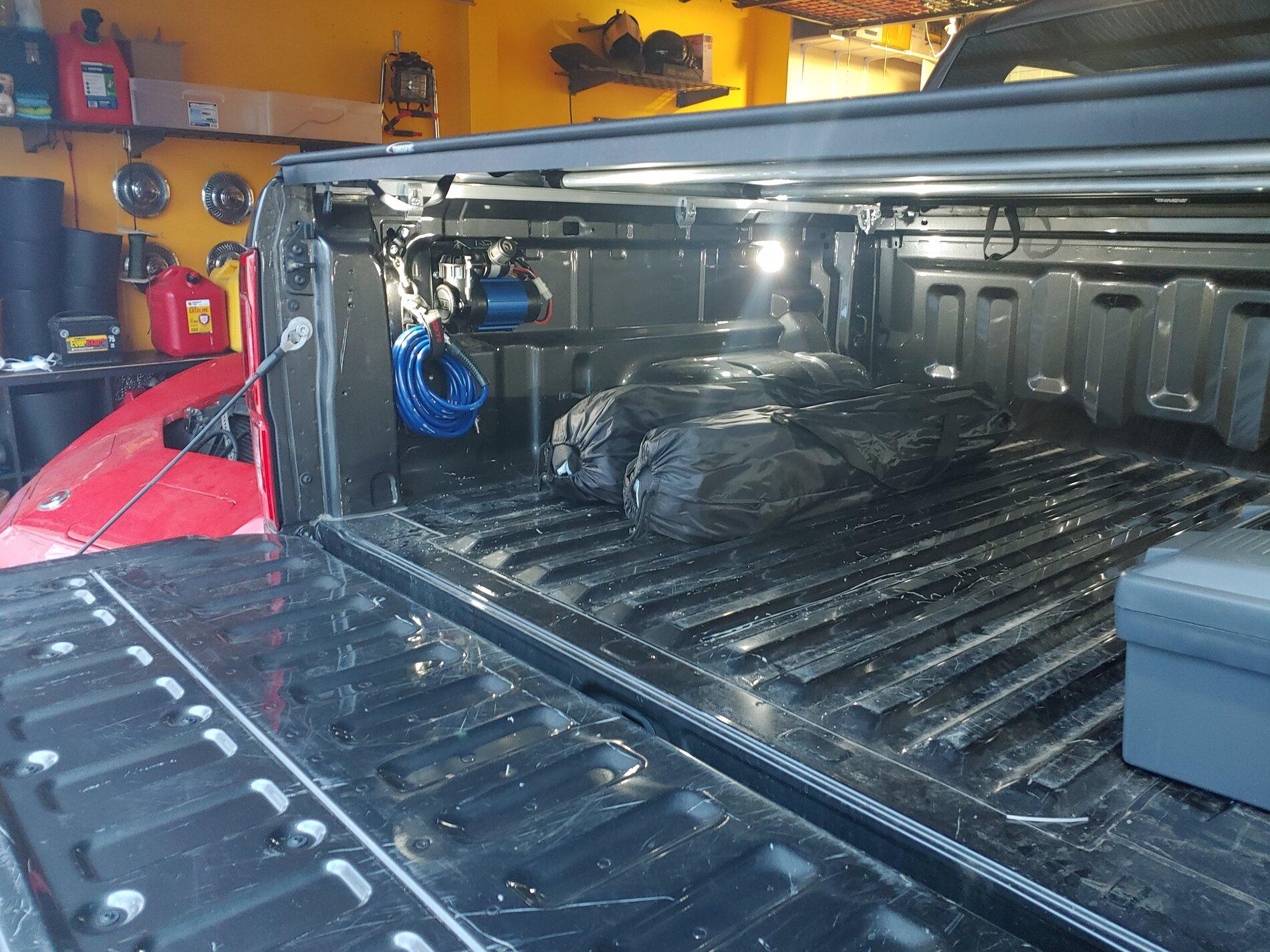

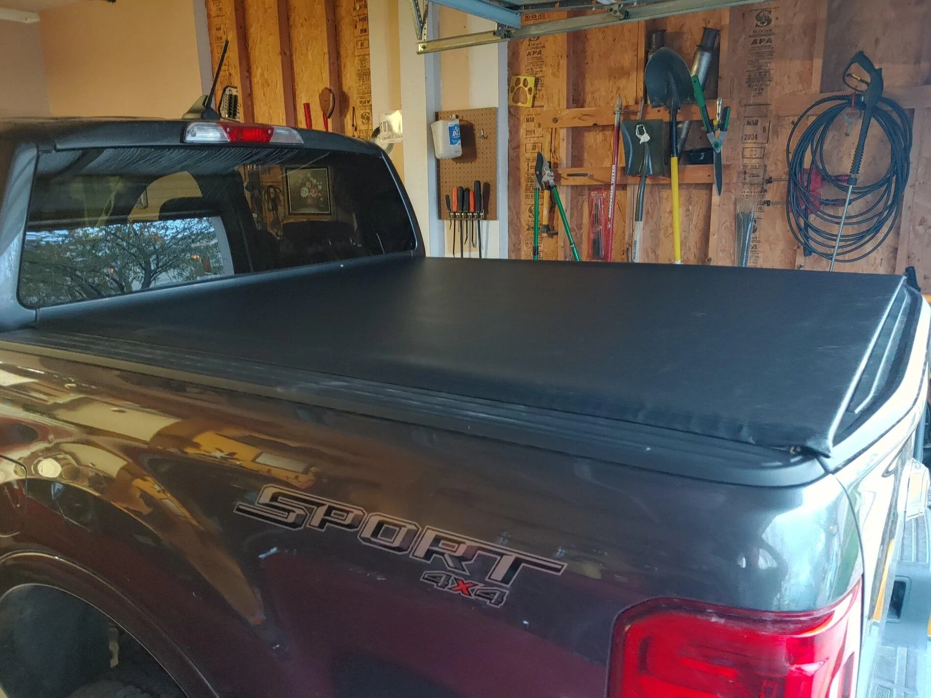

Well it took me a little bit but i finally have onboard air on the truck!! How did I do it? Well I got the Ford Performance portable kit, remobed it from the case and mounted it to the bed. At the same time I added the Access Tonnosport tonneau cover to morr or less hide it!! Herr is my setup!!

Just so some of you have an idea it takes me 5 minutes to air up all 4 from 20 psi to 30 psi with the ARB single compressor. Think that is a long time? Well my compressor that is in the Harbor Freight jump pack would take 45 minutes from 24 psi to 30 psi so I think it is worth it!!!

This compressor is straight out of the Ford Performance Kit. I simply removed it out of the box it came in and mounted it to the bed as you see. I had to buy about an extra twelve feet of wire if I remember correctly to hook it straight to the battery

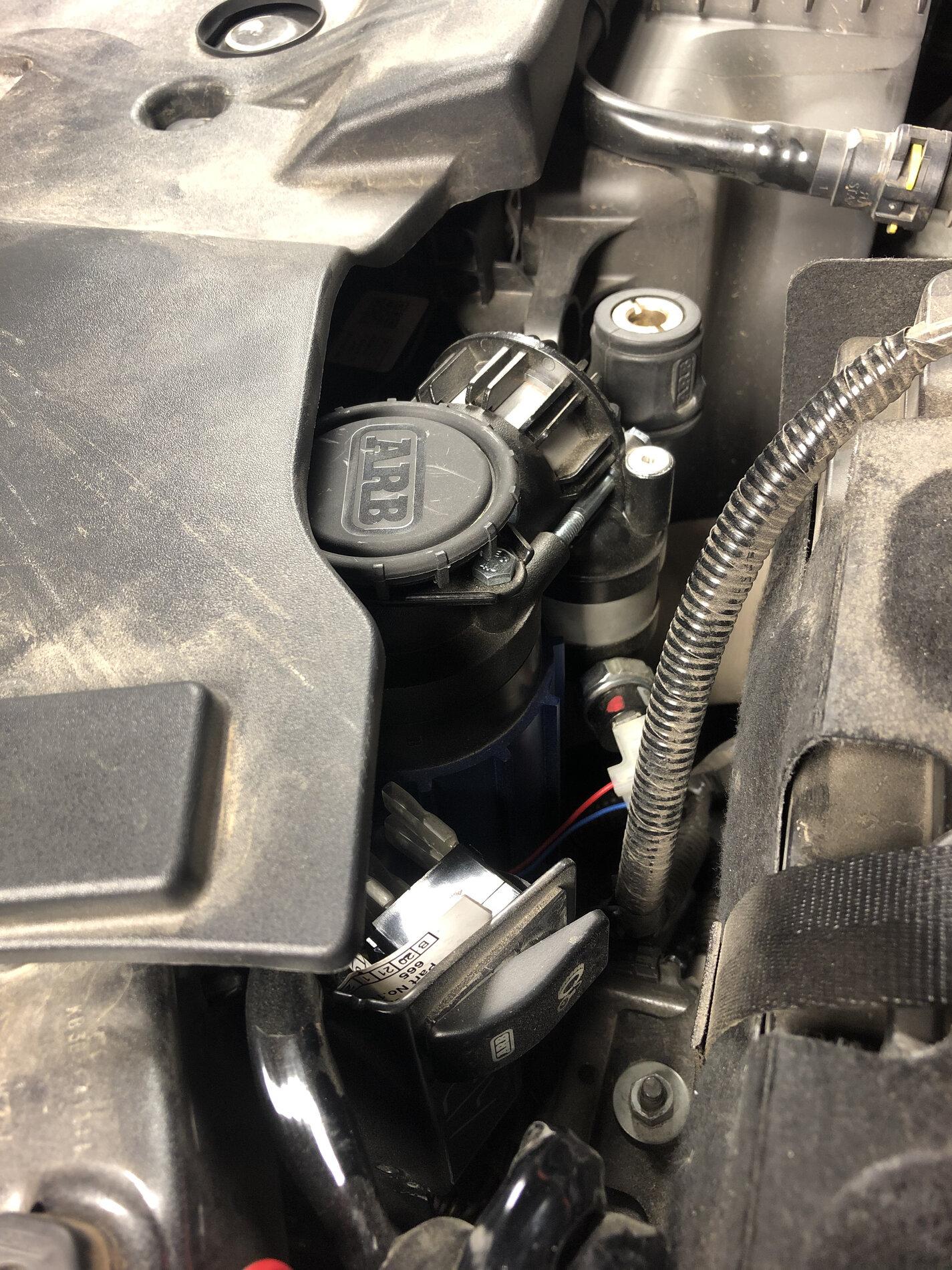

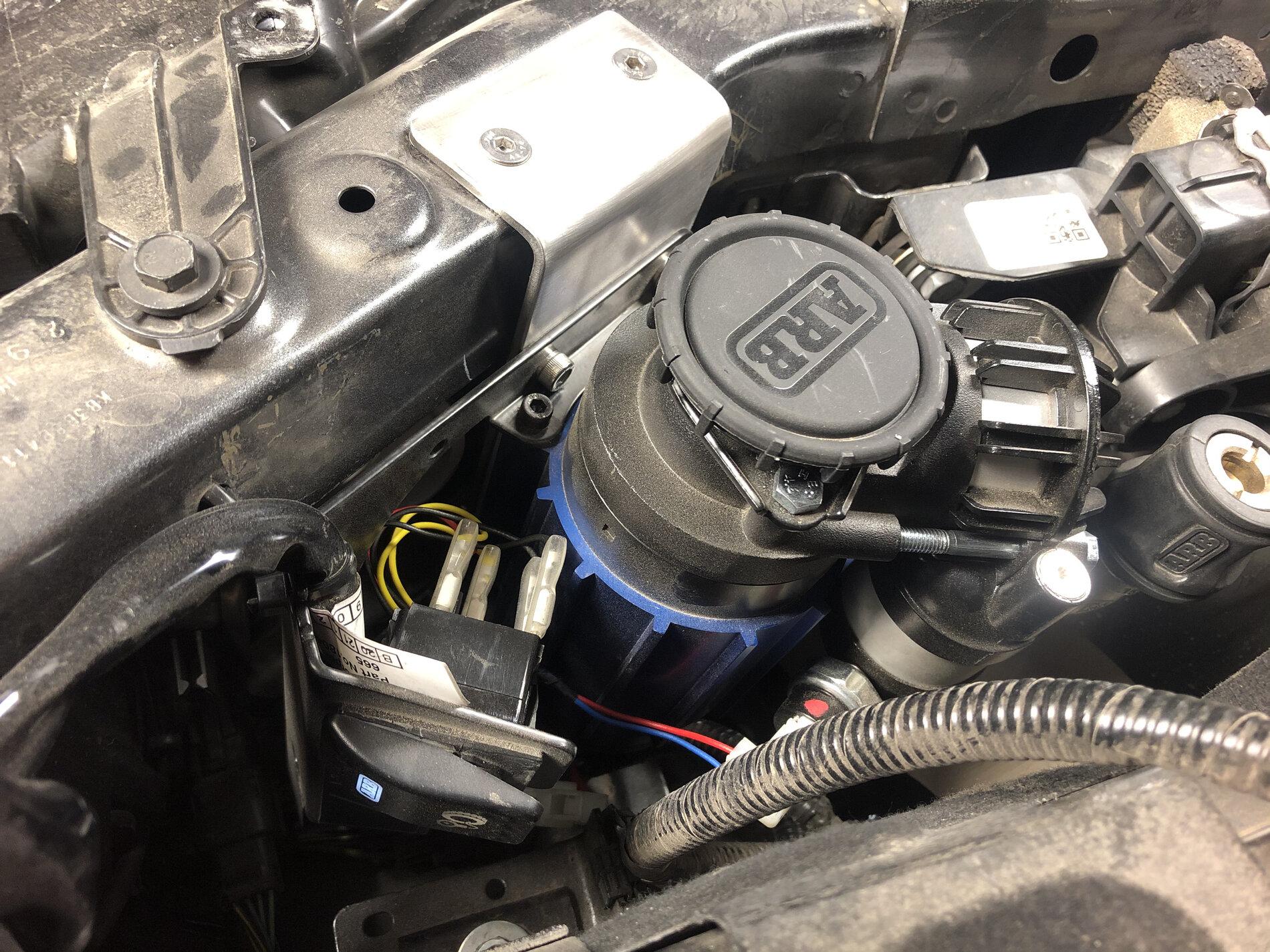

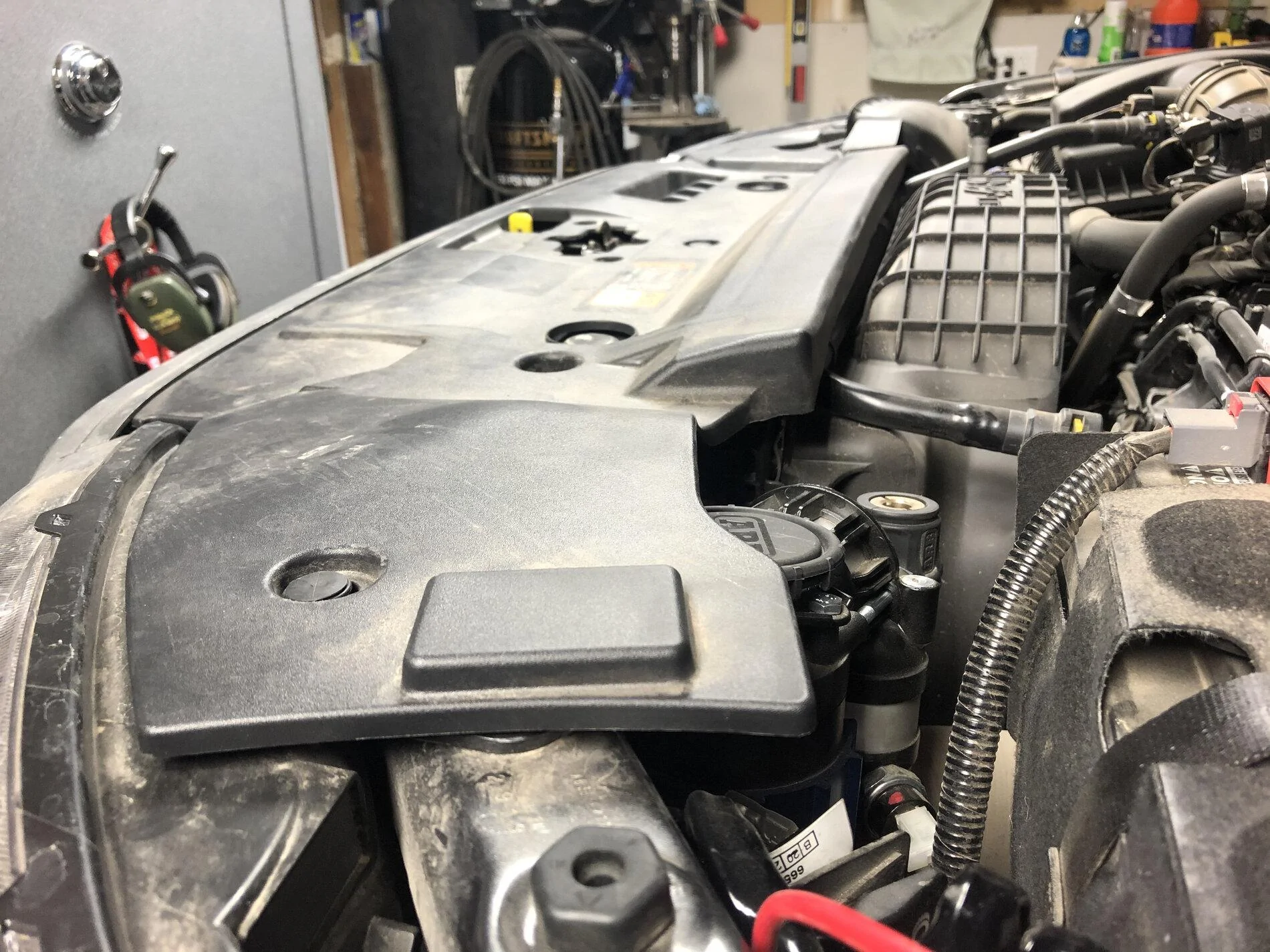

I removed the compressor from the Ford Performance ARB compressor kit, fabricated a bracket and mounted it in front of the battery. All I had to do was insert a couple rivet nuts, relocate some of the wiring and re-clock the quick connect and pressure transducer.

Could you go into more detail on what you did here? What are the dimensions of the bracket you made and how did you relocate and move pieces on the compressor? This looks ideal. I have the arb single compressor box kit just like you. I would love to run this setup!
The bracket is 8"x3"x1/4" SS flat stock that I bent to fit the small relief in the core support. I used the bracket that the compressor was mounted to as a template to locate where to drill the holes in the SS plate.
I removed the wiring harness so it could be repositioned and so I would have enough length for the pressure transducer leads. I did not add any extra wiring, there was more than enough on the harness.
To re-clock the transducer and the air QC, I simply loosened the bolt at the end of the reservoir and clocked them where I wanted them. This was the easiest part.
