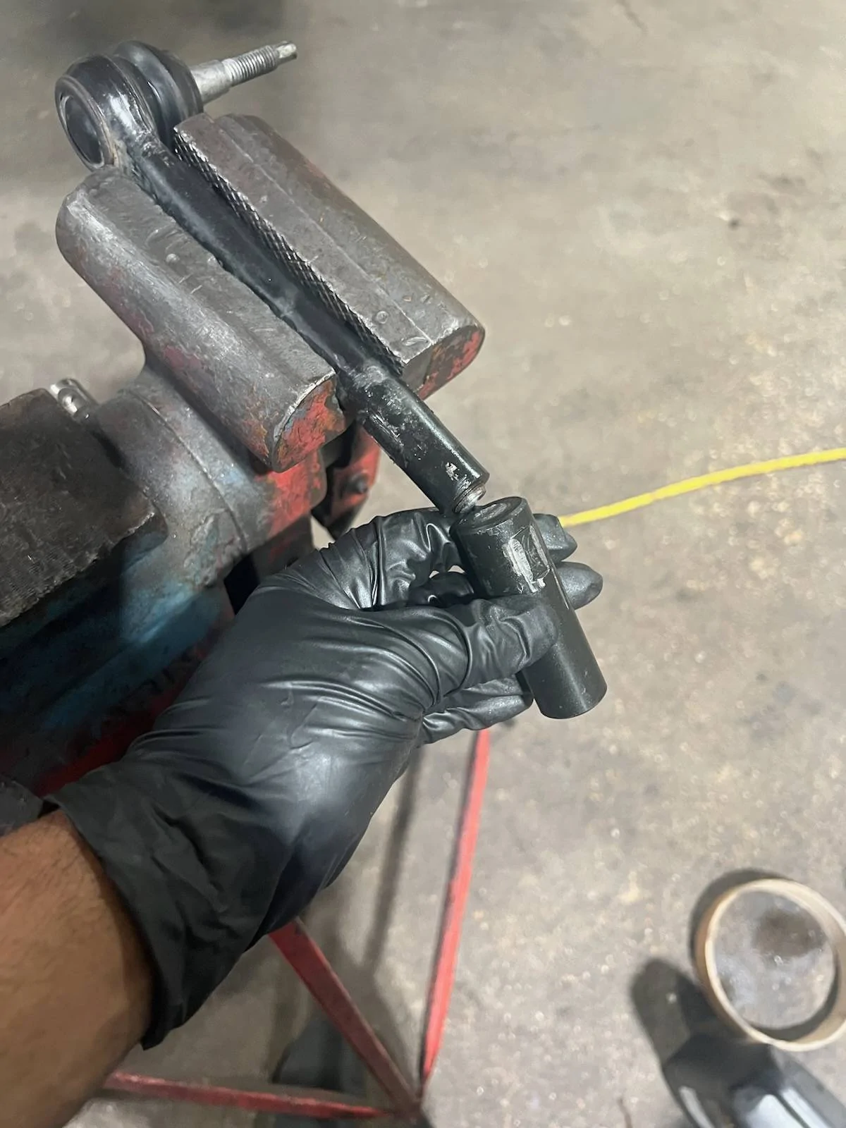

Bad news. So first to understand the situation you have to understand I am running +3" wider control arms and the kit came with 3" spacers that screw between inner and outer tie rods. I couldn't get the spacer loose so I dropped off the truck and the new tie rods with my mechanic because I figured my wrenches were too small to get good leverage. He messaged me that the spacer seized and broke when trying to take it apart.

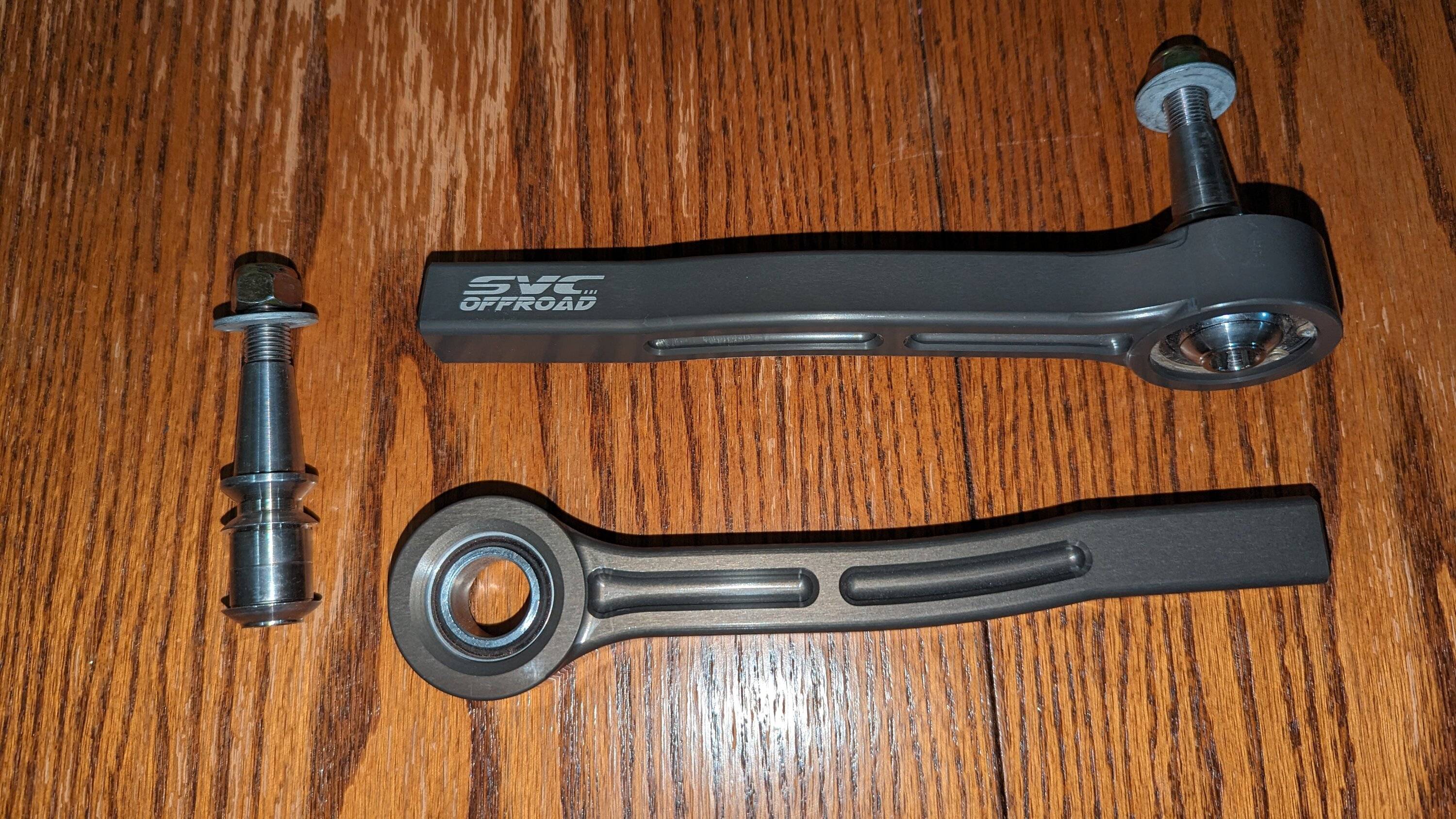

Just got the extended length tie rods from APG overnighted. My truck will be ready for me by the time I get off of work tomorrow.
Got some SVC tie rods for sale!

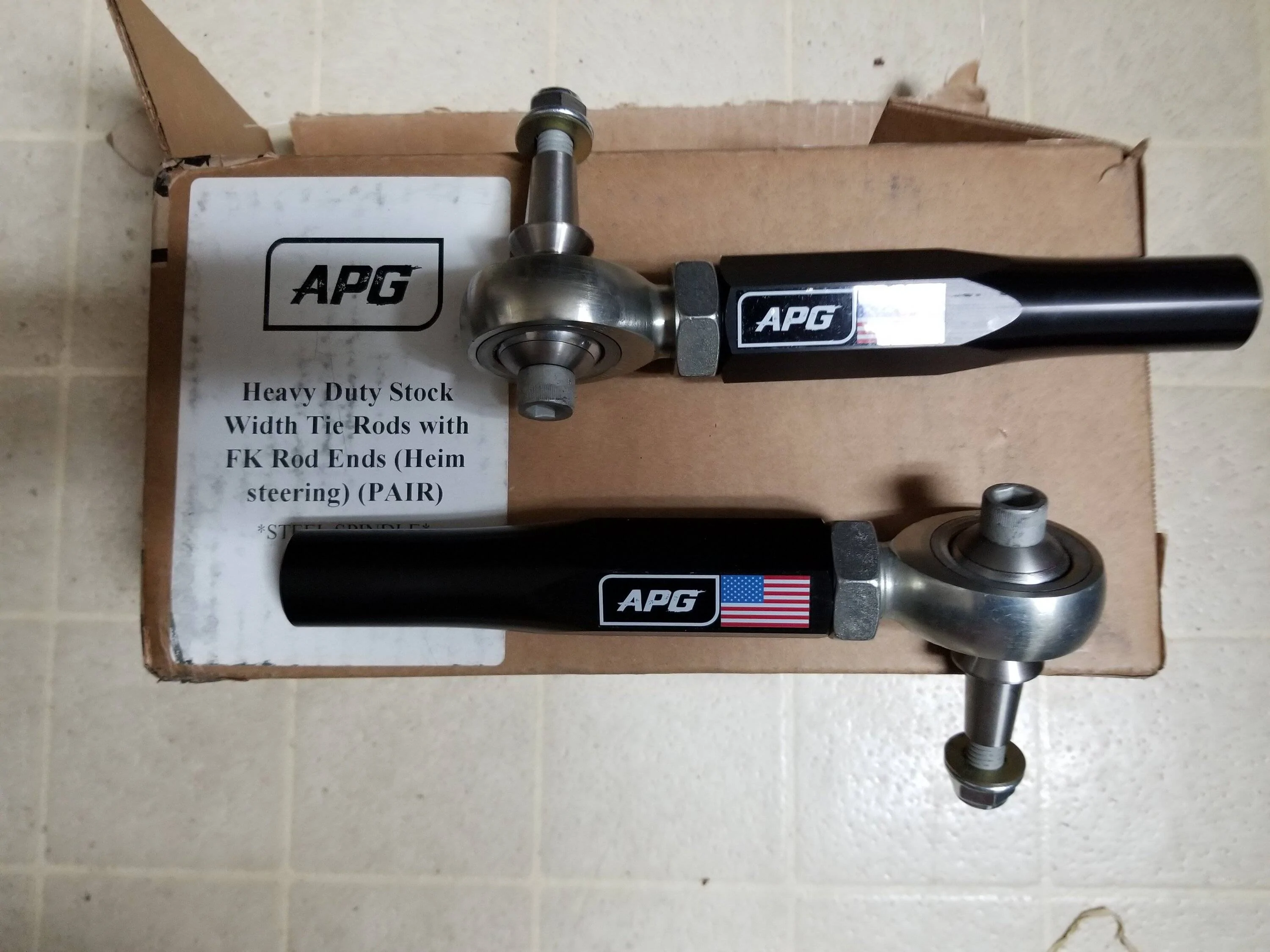

Extended Length? ...I have the APG stock length Billet Tie rod ends with the Heim joint end on my "mid runner"...APG has an extended length Billet Tie rod with the adjustable end for the " Pro-Runner:" long travel , allowing for more than 3,0" used in that kit..

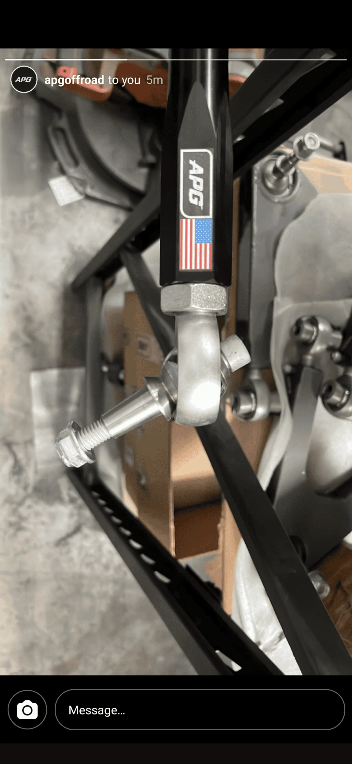

I ordered these in extended length!
Honestly when you posted this picture I was like damn I should've gotten the extended length and now I did!

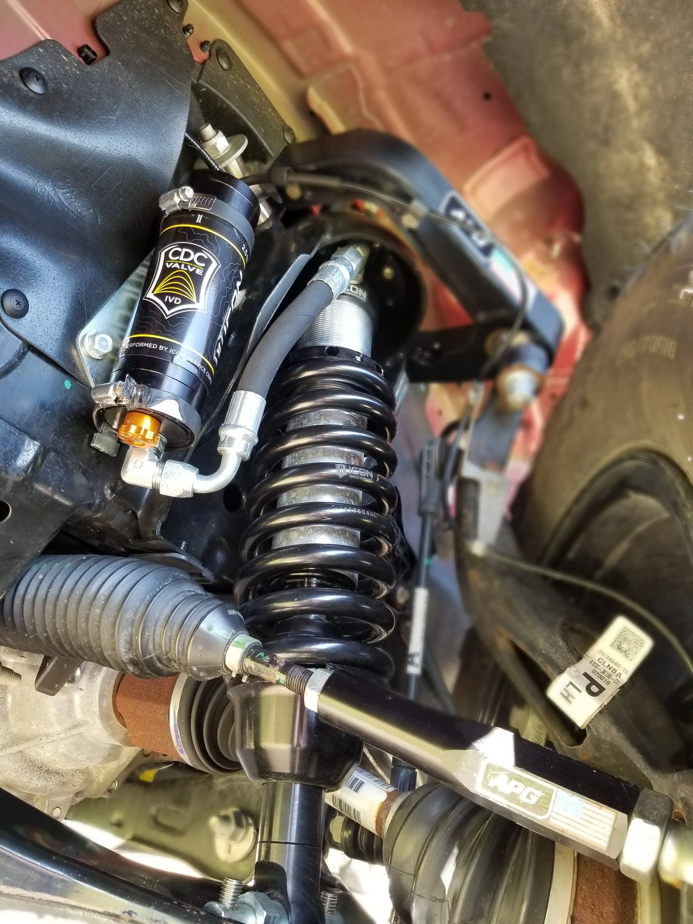

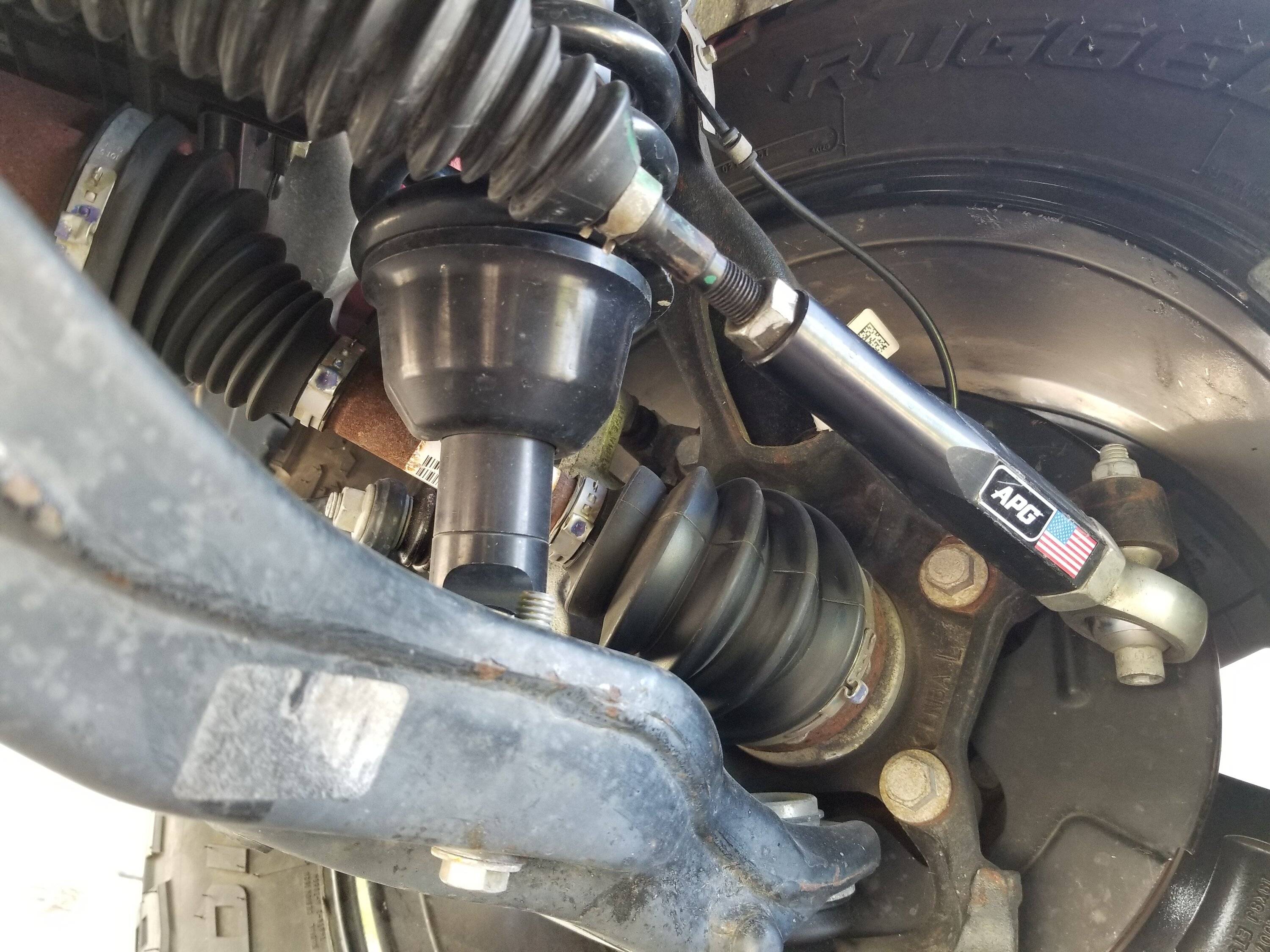

Not sure what you needed to see..pictures are of driver.side with wheel turned out to full lock position....My alignment guy is across the street from an offroad shop that specializes in extreme suspension set ups...He is very familiar with Heim joints and it still took him several tries and test drives to get the steering wheel centered to his satisfaction...He made the comment that Heim joints are "tricky" to get adjusted properlly...

I never got to actually hold mine they went straight to the mechanic to put on. I would've put them on myself if I knew I was going this route. When I tried, the spacer was seized in the stock outer tie rod.

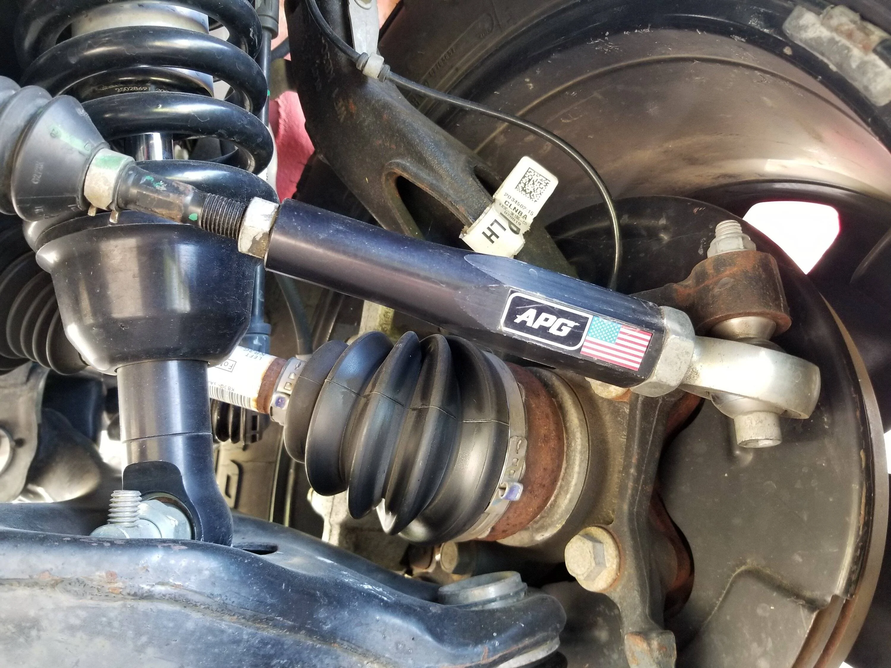

First picture of when I received them in the mail Dec. 10th 2021...I did the install within days....2nd picture April 1st 2022 my first post showing them on the truck..
