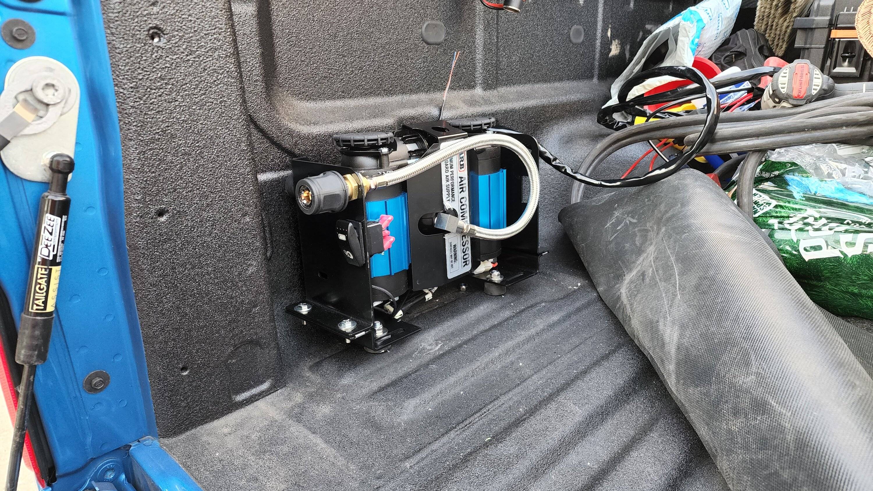

Rivnuts into the floor & wall
Rubber isolators threaded in
Compressor mounted in ARB Universal bracket.
Wired to Aux batteries.

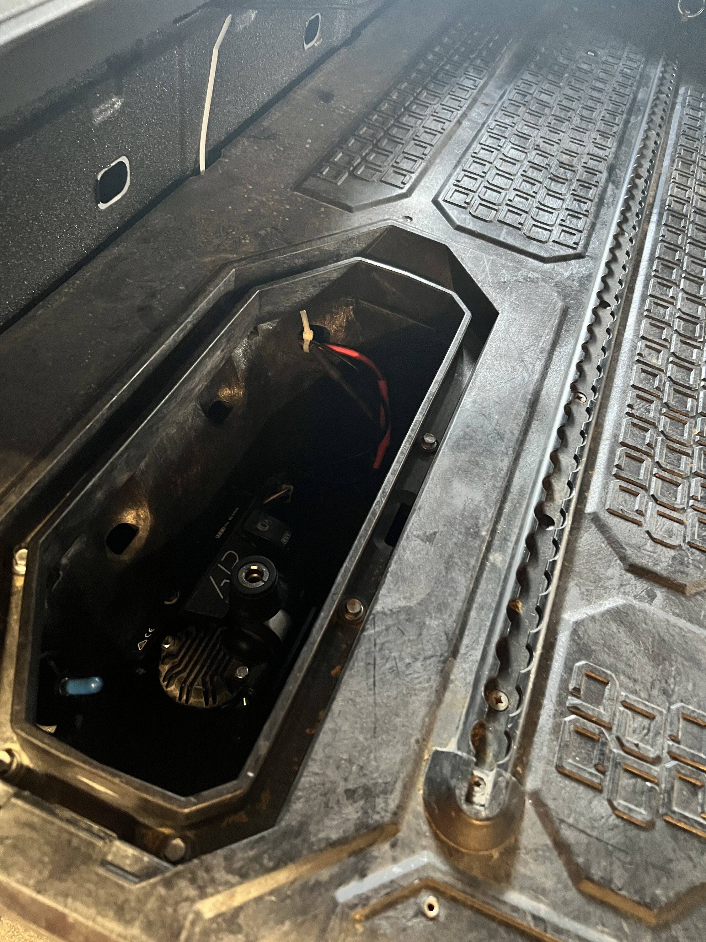

I am finally happy with my install. ARB Single in the Decked ammo can. I will be moving the check to the back, so I can air up without opening the cans. Mostly for when its covered with my camp gear and cooler.

Any issue with thr elements getting into the ammo can , and damaging the compressor ?
Colo_Ranger
Apr 19, 2021
3,847
13,214
2021 Ford Ranger XLT FX4
Nothing yet. The only way water would get in is if I was submerged above the decked system. The top is sealed pretty good and routes water away from the tub.

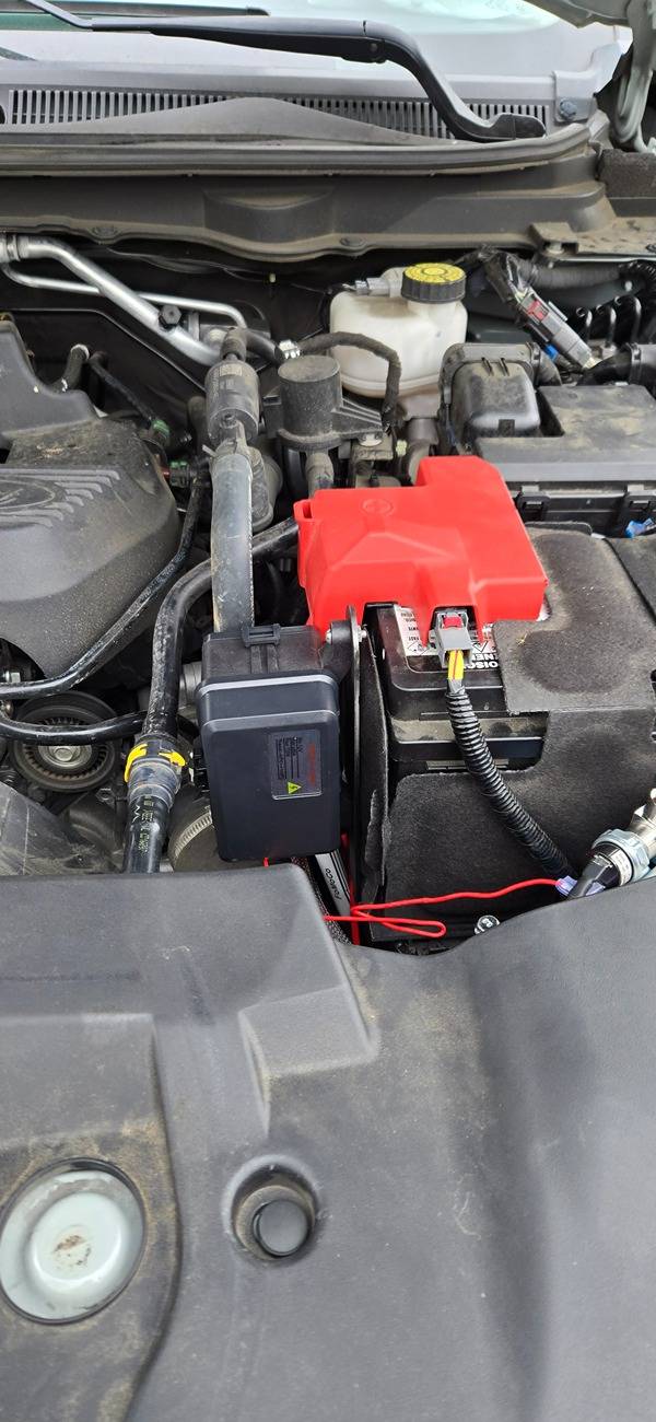

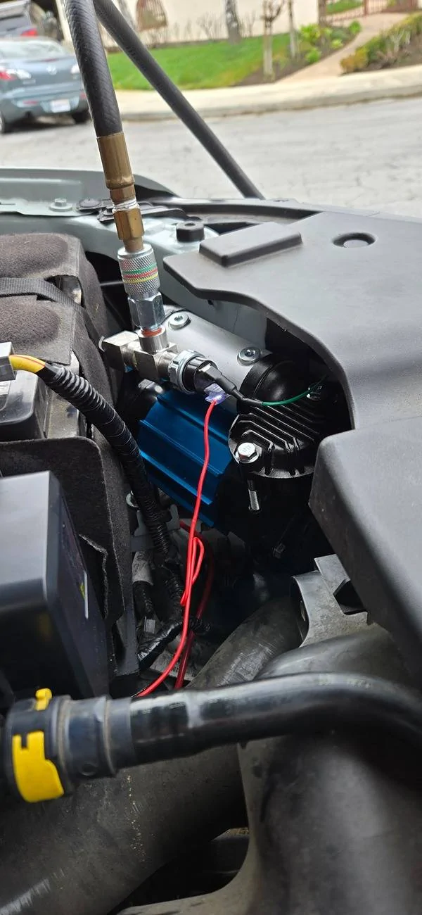

Reviving this. Huge shout to Dmeyer302 for the photos. I ended up doing similar to him and it works great! I mounted my 6 gang auxbeam with another custom bracket next to the battery. Just need some split loom to tidy up that trigger wire. I'll probably route the quick connect to the rear bumper as well..
