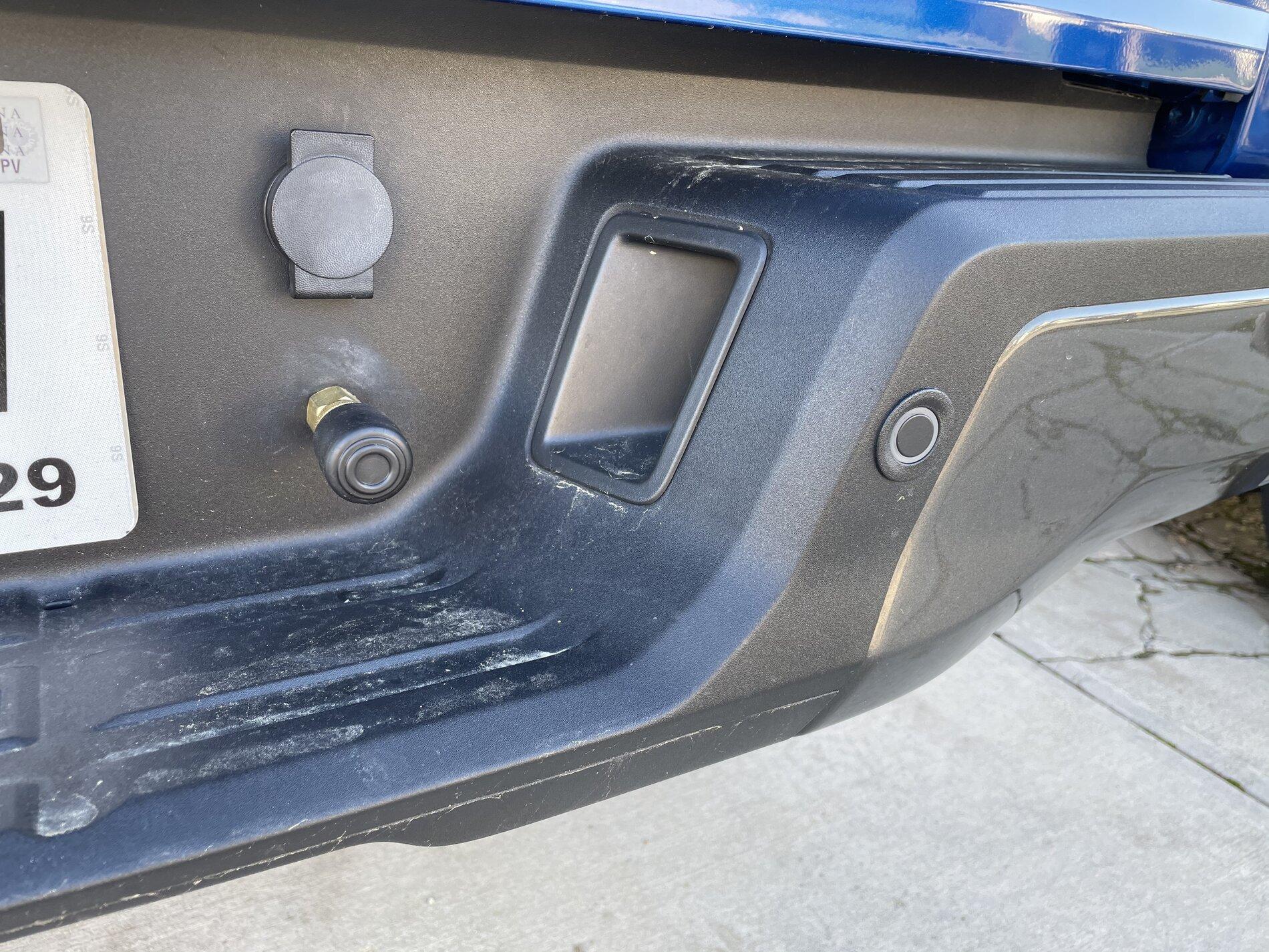

That's a really good point @SafetyDan . Your option is probably more stout, with the benefit of being able to tie the loose paracord end to something on the truck so you don't loose it, but a member on here had used the cap linked below to cover off the quick disconnect ends and said it worked well. I tried searching but can't seem to find who did it (if anyone can remind me, please tag them here!) I'll be throwing a dual ARB compressor into the truck as soon as I can get some time to mock it up, and I think that's what I'll use at the quick disconnects, since it requires less fab (and I can easily replace them if a rip/loose one...haha).
Here is the link to amazon: https://www.amazon.com/dp/B00DE8FDWK/ref=cm_sw_r_cp_api_i_us5KEbK3KE4E7
That is really nice as well. Point is to protect from crap jamming them up. I like PVC as it covers so Moisture doesn't get in. Those may allow water to seal in especially at 70 MPH in a rain storm. ;-)
dmeyer302
Daniel
Feb 18, 2019
686
1,646
Carthage, MO
2016 Odyssey, 2021 F-150
Mechanical Engineer
I have the Dixon rubber covers. They have a vent/weep hole in the middle. So they're not 100% sealed. I shoot some WD-40 in the hole periodically, and I'm expecting to have to change the couplers after a few years. Not a big issue IMO.
HoosierT
Tyler
Feb 1, 2019
958
1,559
Fishers, IN
I just went to Lowe’s and bought the smallest size chair leg covers. Comes in a four pack so I tossed the extras in my glove box in case I lose one. It’s a snug fit, actually takes a little wiggling to get it off so no way it’s coming off on its own.

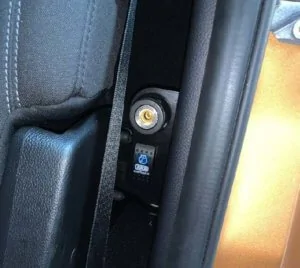

Wish ARB had more info about this! But they have a Ranger specific mount out now.
What is this and where did you find it?
Glocker
Feb 11, 2020
99
2,718
8,498
Boca Raton
Look on ARBs website in the air section. It's down with the vehicle specific brackets.
KnightRanger
KnightRanger
Mar 23, 2019
329
1,070
USA
2020 Ford Ranger, 2016 Harley FLSS,
It looks like they will utilize the space behind the rear seat.
Only issue with me, is from past experience running Arb twin...even with built in fan they get hot and its not a quiet compressor.
(noise level is kinda high)
I would imagine if you have passengers, they have to get out when using the compressor.
(noise level will reverb from the back to the cabin)
Kudos to Arb for making this...its a start.
But, I would’ve liked a bed specific mount rather than in-cab.
