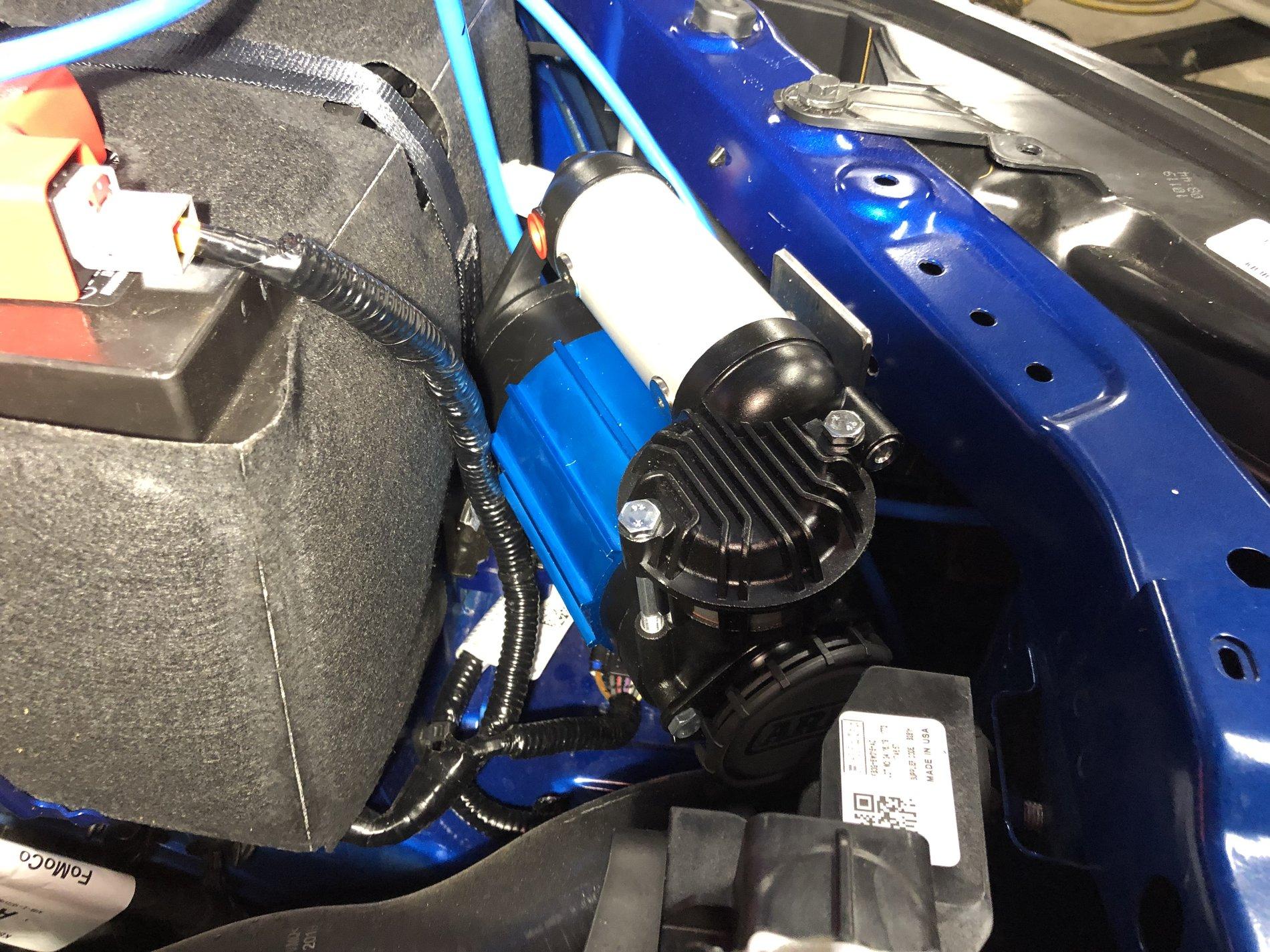

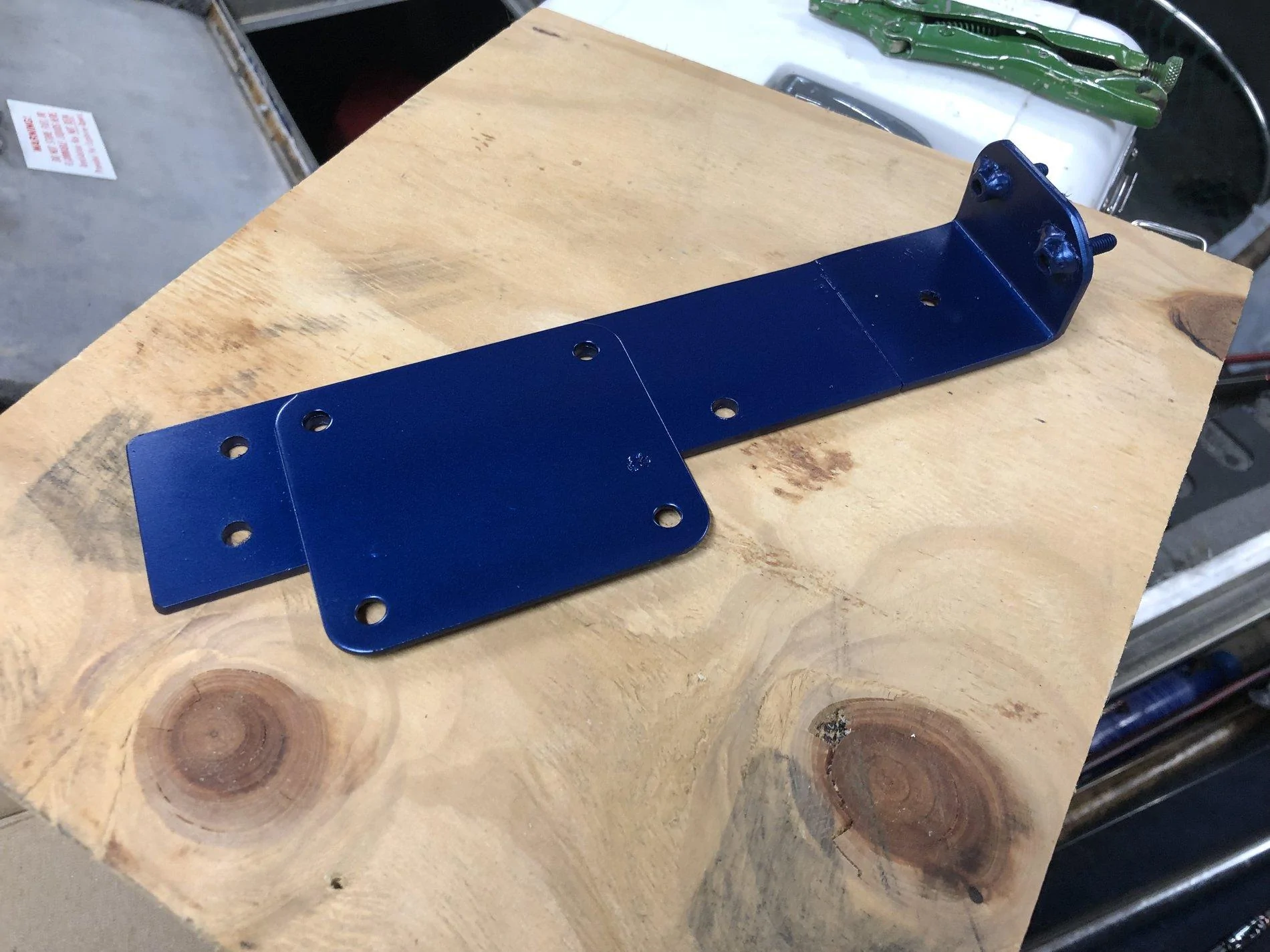

I decided I needed air onboard. No lockers or airbags here, but I recover enough old equipment and work on enough stuff out in the field that I thought it would be worthwhile. I'm going for a permanent install.

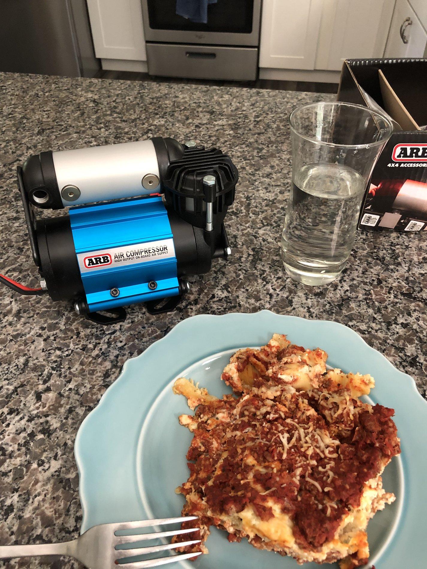

I didn't spend too much time researching, as it's pretty clear that this ARB CKMA12 unit is the way to go for me. If you've never handled one, it is really solid. The motor is serious business - it's basically a mower starter.
This will turn into several posts along the way, as it's going to be a several night project.
Sorry, my lunch is all you get for scale. It's pretty small, I thought.

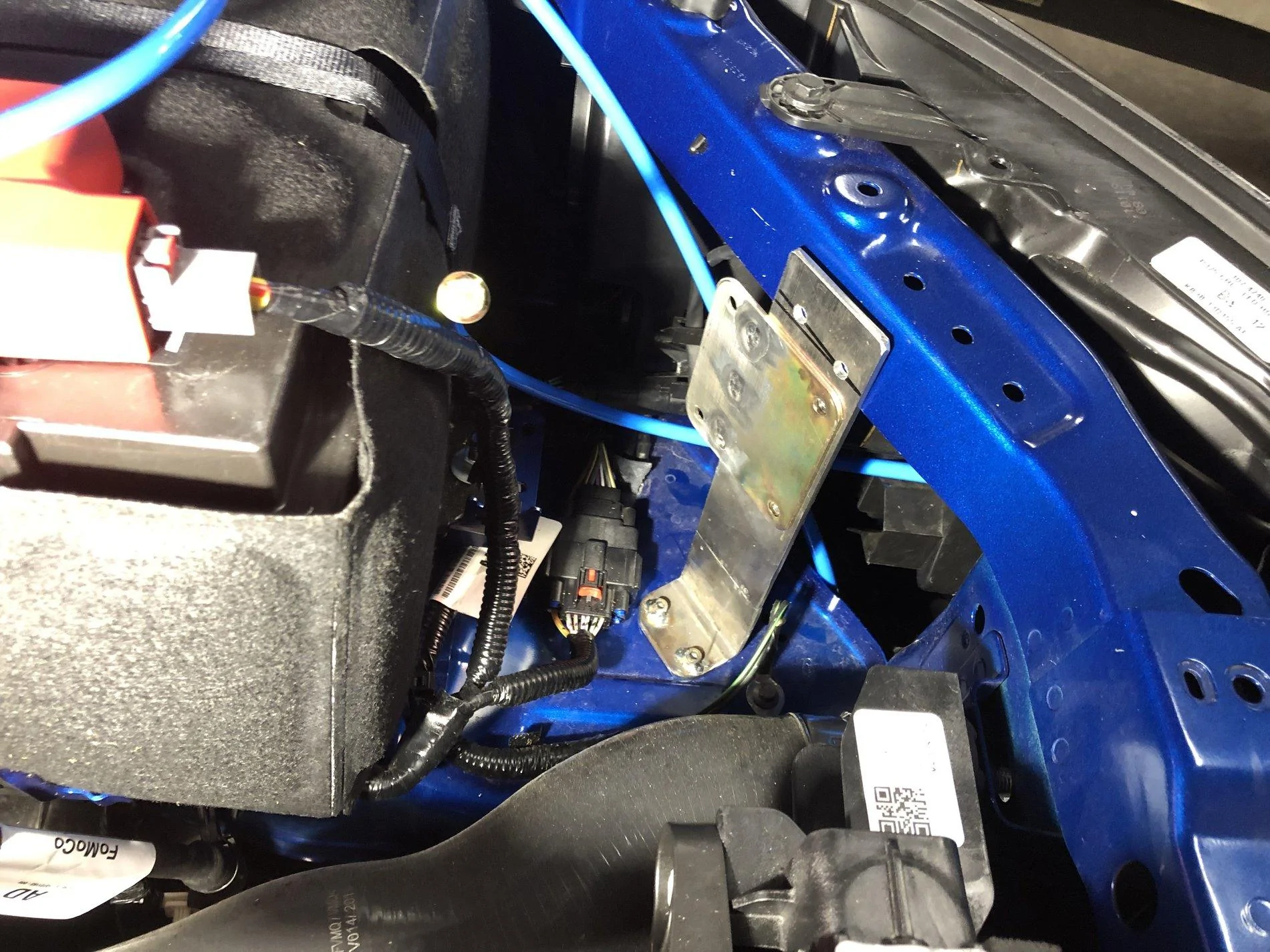

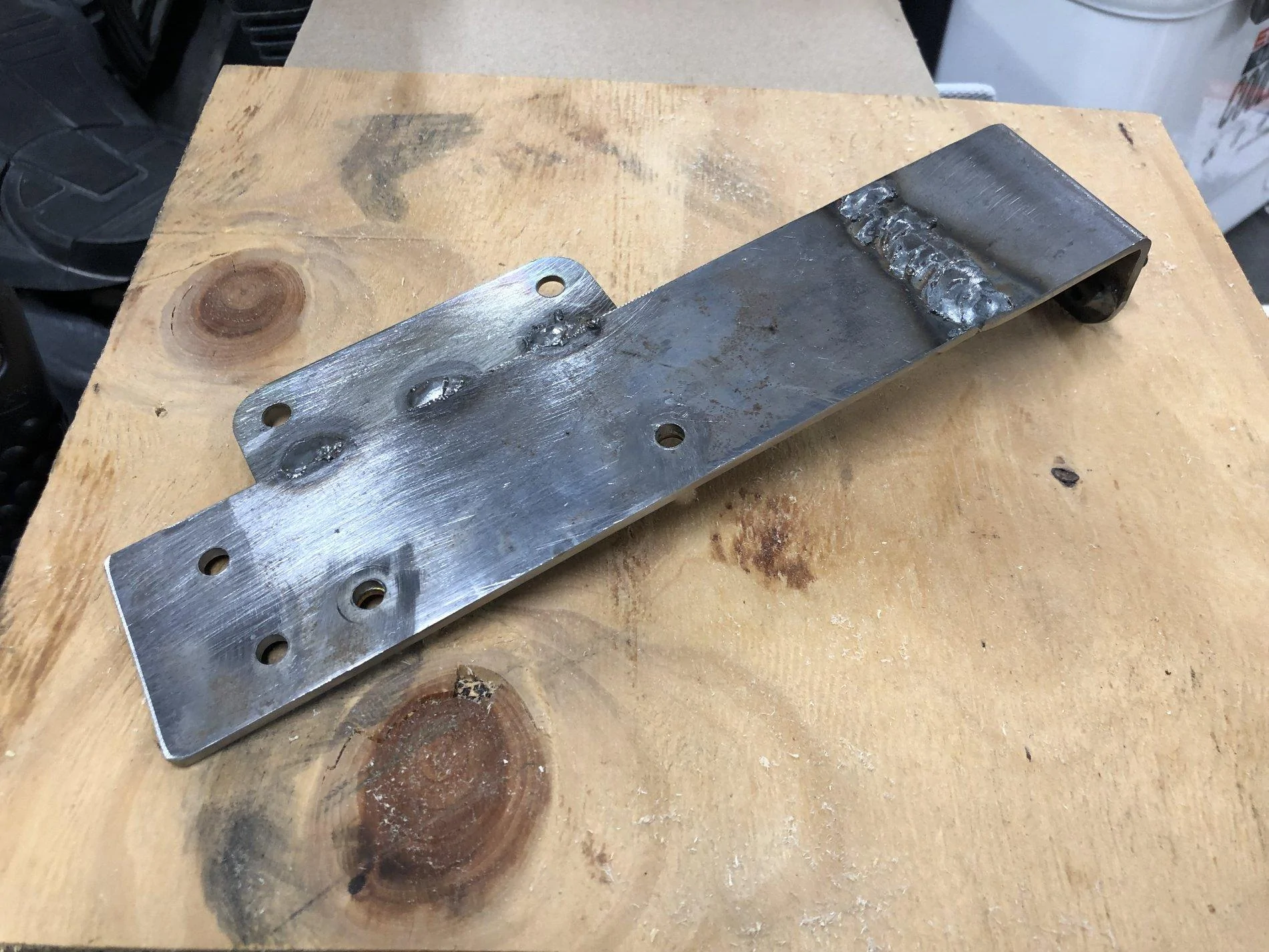

I am mounting behind the left headlight. There's room, but it's tight.

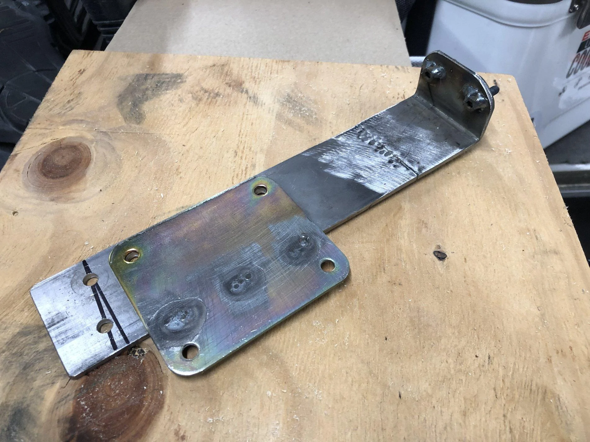

Notice the angle of the two holes at the top. This follows the core support. The yellow zinc plate came with the ARB kit; everything else I had around the shop. I don't plan to put nuts on the bottom two screws, they can just be locating pins.

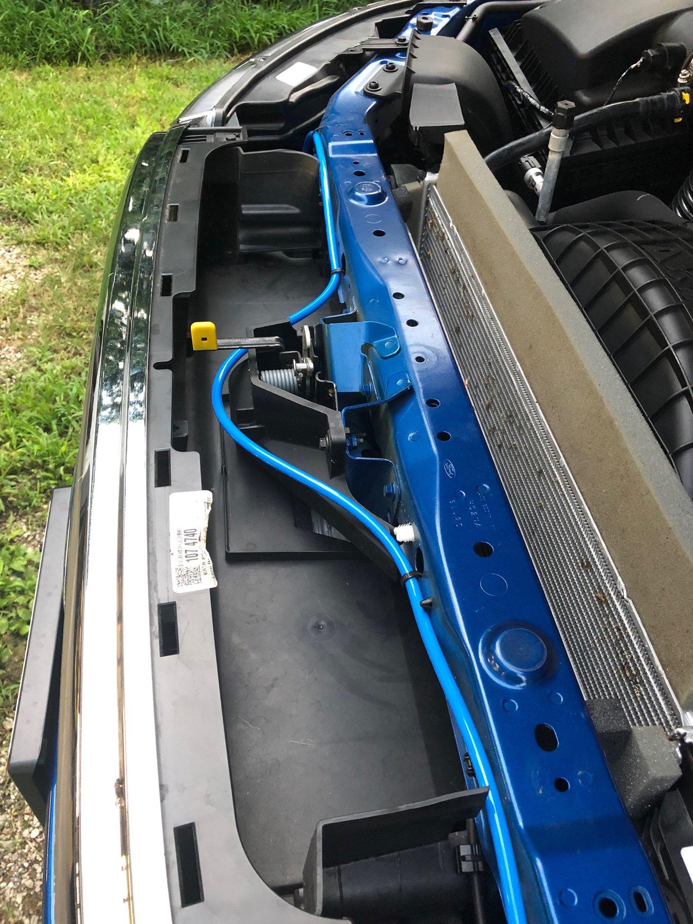

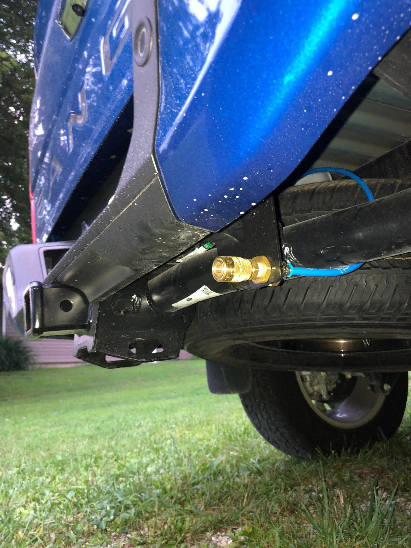

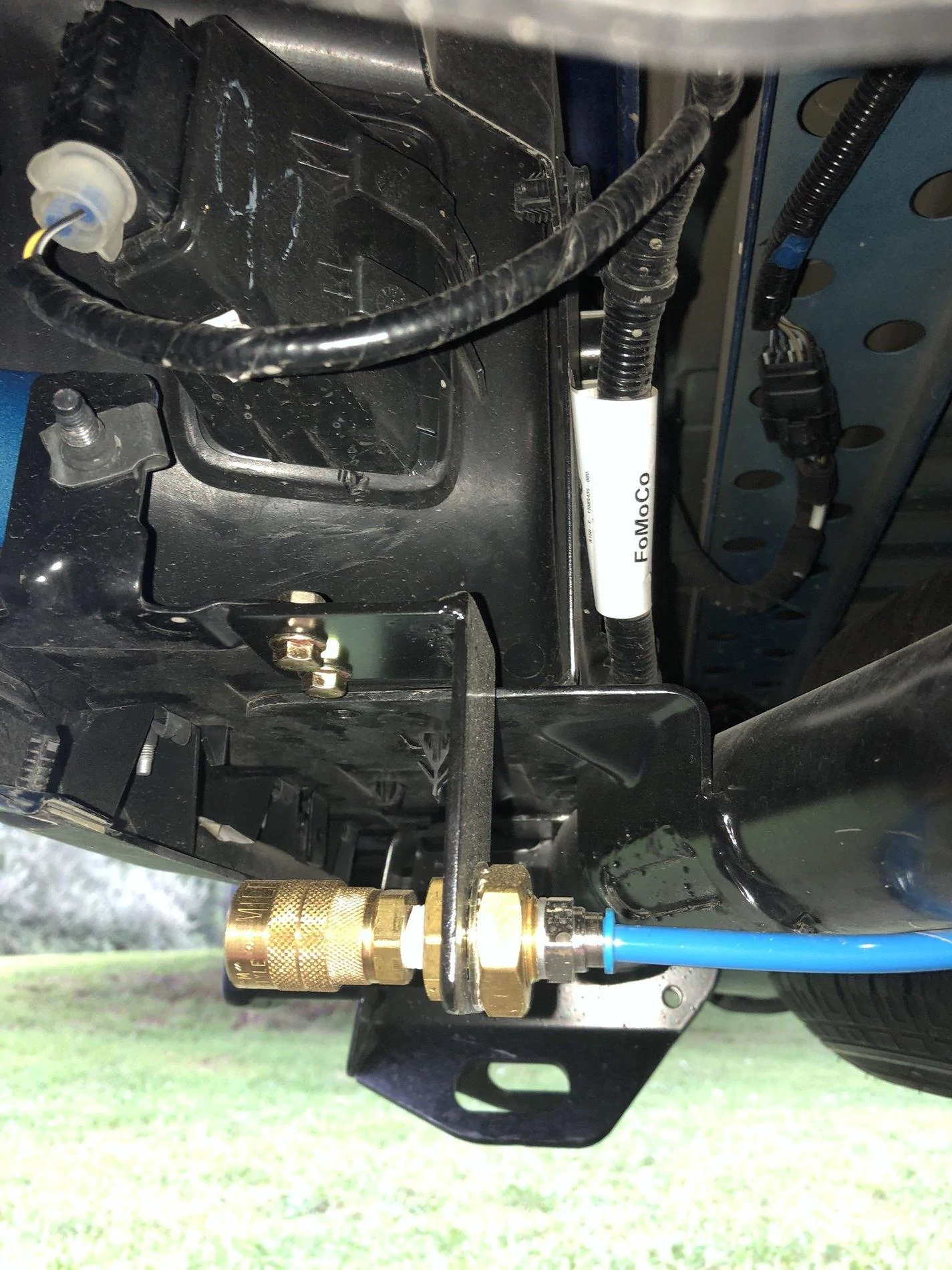

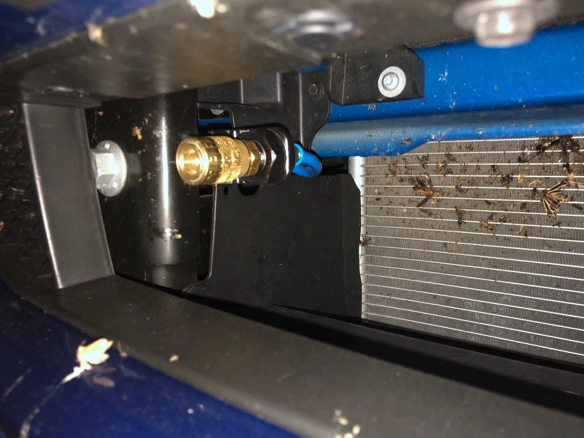

Couplers mounted. The front location did not require drilling; there’s an empty hole on the passenger side of the lower grille opening. The rear location did require drilling. Both are easily accessible yet out of the way and not visually bothersome. And they would totally disappear if you shot them with a bit of black paint.

Looks sick, thats exactly what I want to do, so I never have to open hood to get the coil, just pull the hose out and plug it in.

Does this compressor turn on and off with pressure? It appears the aluminum housing might be a small air tank but I can't tell for sure. Otherwise the way your system is designed you'd be dead heading the compressor, right?
The CKMA12 that I installed on my Jeep 3 years ago had and OEM pressure cutoff on it. Page 4 of this manual shows a pressure cut out switch: https://www.catalograck.com/ImgVD/ARB/CKMA12_24I.PDF
The aluminum tube is indeed the "tank". Obviously it is very small. Having an additional tank mounted elsewhere would be recommended.
